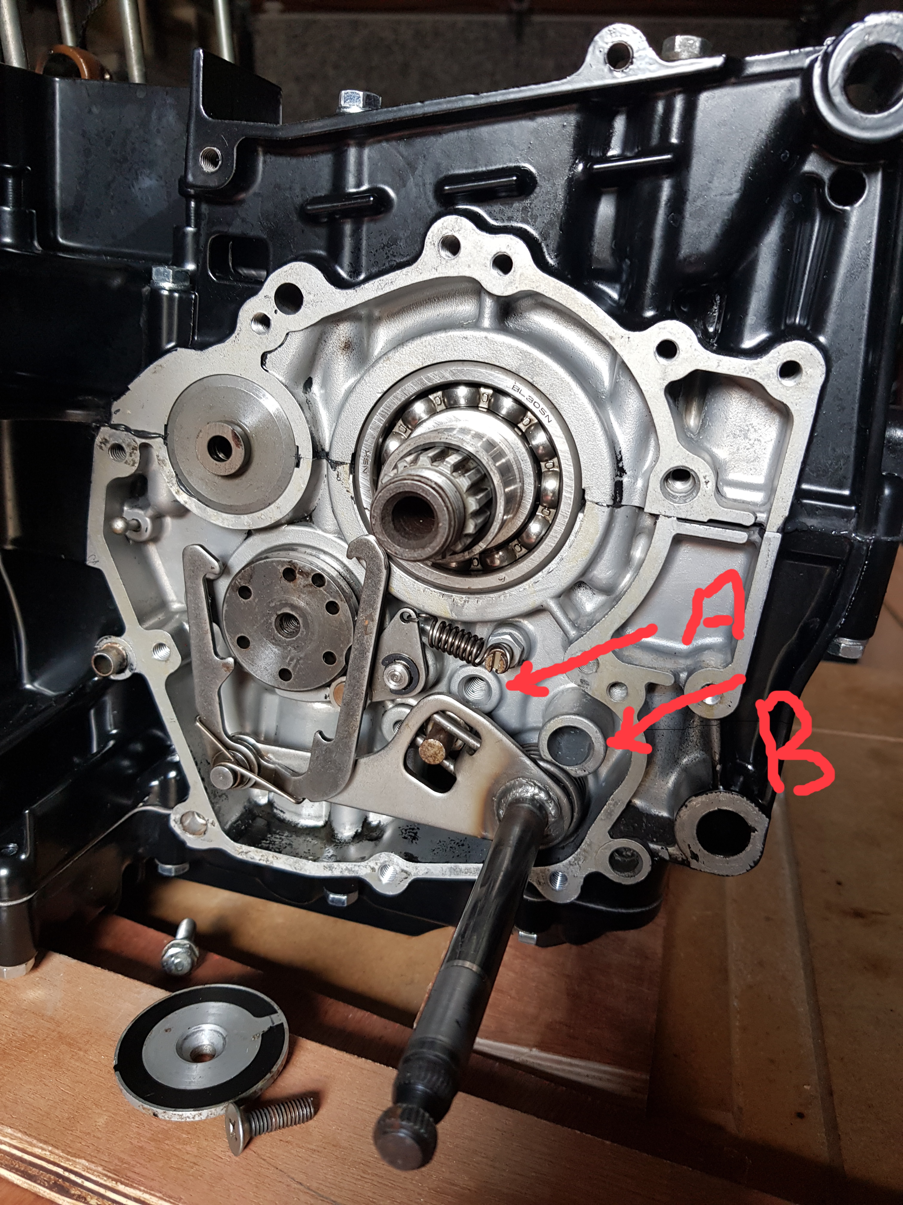

Help required. It's been ages since stripping this Z1000G motor and need guidance re correct location of the gear selector pins. The copy of the manual I have specifies the location of the longest of the pins but the picture isn't clear as to which hole it is. 7 hole and 6 pins ??
Also can anyone condirm what if anything should fit in the threaded hole A and plain hole B in the attached photographere. Cheers any help gratefully received.

I believe A and B are used to fit the gear selector shaft when it is a shaft drive configuration.

the longer pin locates into the back of the pin retainer disc so the neutral earth on the disc is in the correct position

That makes sense now.
