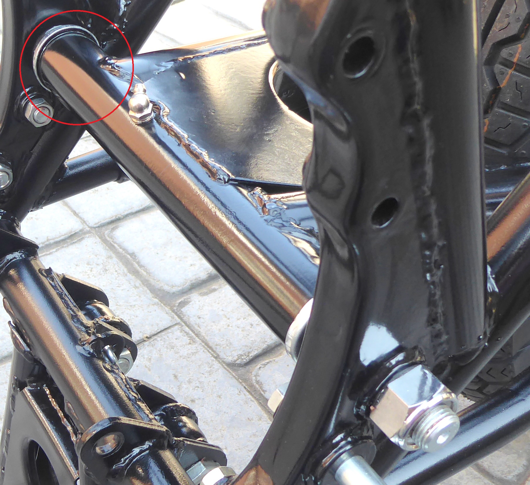

As Zed1015 says, the fit (with caps) should be a slide into the frame. The caps with o-ring should only add about 1-2mm per side as they fit over the swing arm.
Do you have the correct swing arm? Are the new bushes seated fully (don't forget the spacer inside the swing arm between bushes)?
Set up is as below. (note that your end caps will probably look different to the ones in the pic as this is the early type end cap)
