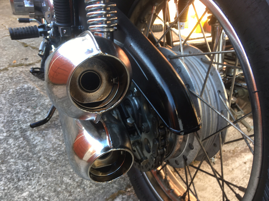

Sunday I didn't top her up, I cleaned out the pipe ends with paper and brake cleaner, and went for a test ride. This was the result:
The upside is that those two pipes will never rust from the inside. I should watch for drivers behind me putting on their wash / wipe. Its also on the rim, chainguard and the back and front of the number plate.
I'm guessing that, as the engine was rebuilt an unknown time ago, that the valve oil seals have perished and failed. When I stop on a ride I use the sidestand, which probably pools oil on that side too. If it were bores or rings, I'd expect smoke and oiled plugs if it were using that much oil. the fact it's not oiling plugs makes me think specifically exhaust valve seals, the oil is going straight into the pipes without being burned.

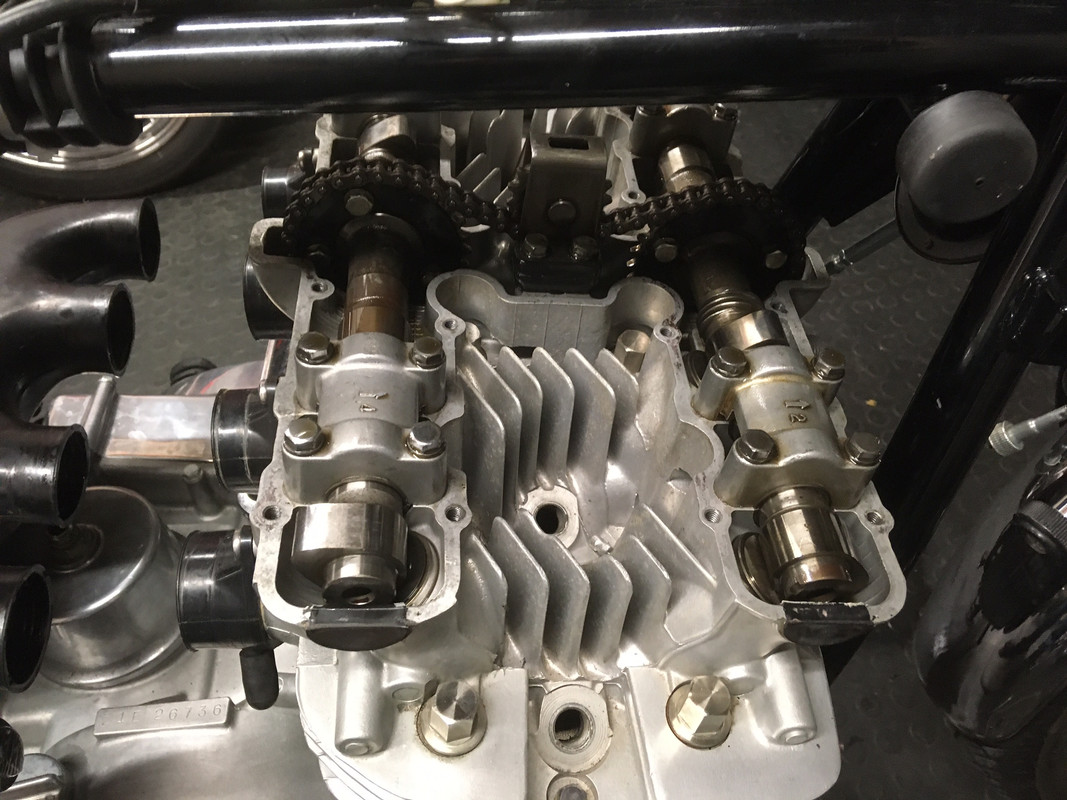

A pair of topless photos I took last night. Nothing much to report other than all very clean with no signs of scuffing on the cams.

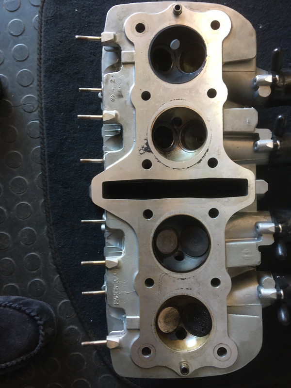

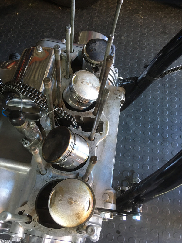

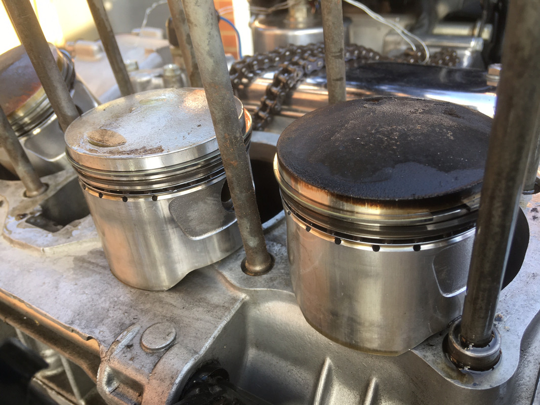

One of these things is not like the other....
I'm not sure if I should be worrying about the two pistons with NO carbon, or the two that have coked up that much in only 375 miles. Either way its not right, I'm glad I pulled the head off, I'm sure it wouldn't have lived a long and happy life like that. As far as I can tell I didn't have an air leak from the inlets, everything was tight, the rubbers are new. The plugs were pretty much like the pistons, pale and weak looking on #2 and #4, sooty on the other two.
Until I borrow some calipers, I can't accurately measure the bore to piston clearances. The piston thrust faces are lightly polished, as are the honing marks in the bores.
I'm wondering about the head gaskets. I had been intending to retorque the heads at 500 miles when I did a service, but when I took the head off I was surprised how untight the head nuts were, it didn't take much force to undo them. could the gasket have 'settled'? could oil and/or air have been getting into the bores around the gasket? That could explain both the air and oil where it shouldn't be? Air could get into the 'clean' cylinders (there was a whistle but I assumed it to be induction noise from the airbox), and or oil from the feed studs into the bores. Or it could just be the valve seals, which seemed to be hard and not a great fit around the valves, which had black burned oil deposits on them (they were new).
By the way, Saturdays test ride has produced my first Notice of intended Prosecution for speeding in many years. I saw the van, but too late, it must have been set to long distance looking down the hill I was coming up. At 42mph in a (deserted) 30mph limit, I just qualify for a Speed Awareness course, I looked up the limit and it is up to and including 42mph. Hopefully, it is up to plod's discretion.

#5 PostAuthor: zed1015 » Wed Jun 09, 2021 5:01 pm
2 and 4 look washed with oil and are the likely to be the worst culprits of the oil in the pipes.
The other two are at least getting to burn some of it.
It seems to be a lot of oil for just stem seals so i'd be looking at the rings too.
What do the plugs look like.

#6 PostAuthor: MrDavo » Wed Jun 09, 2021 5:27 pm
The plugs look just like the pistons - dark and sooty on #1 and #3, light and weak on #2 and #4.
The rings look to be in order, no gaps lined up, and no sticking or damage visible. I wonder if there may be head gasket issues, as I said It didn't take much torque at all to get the head nuts loose. I checked the head with a straight edge, it doesn't appear to be warped, thank heavens.
As one pot on each side seems to be running on excess oil, its odd that it only came out of #1 and #2 pipes, which are linked to each other. I've had a lot of cars and bikes in bits over the years, never seen this before. :rock

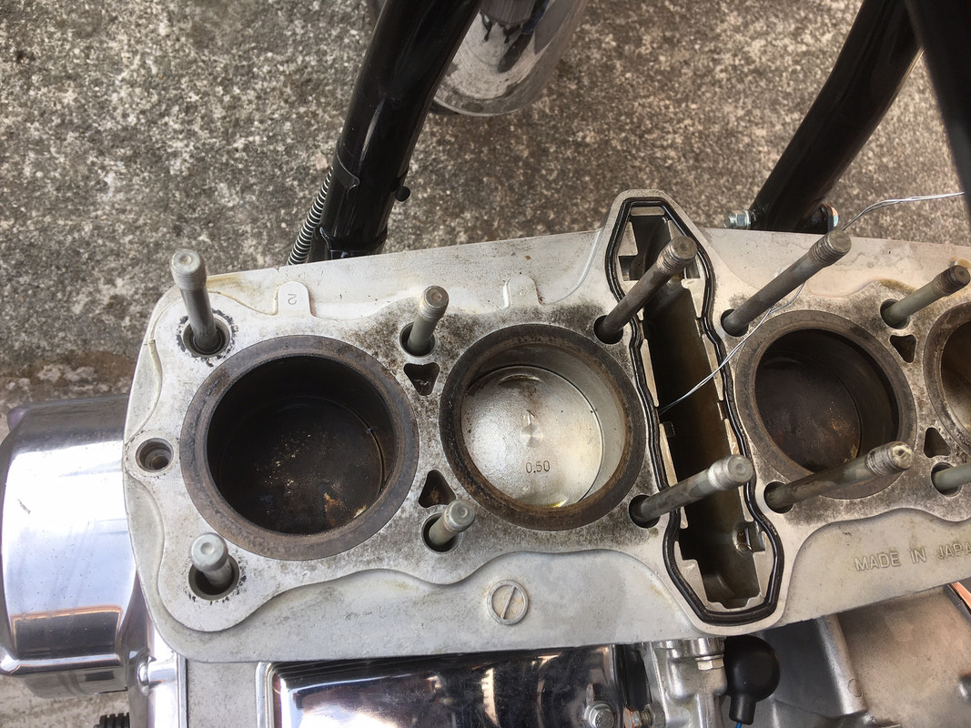

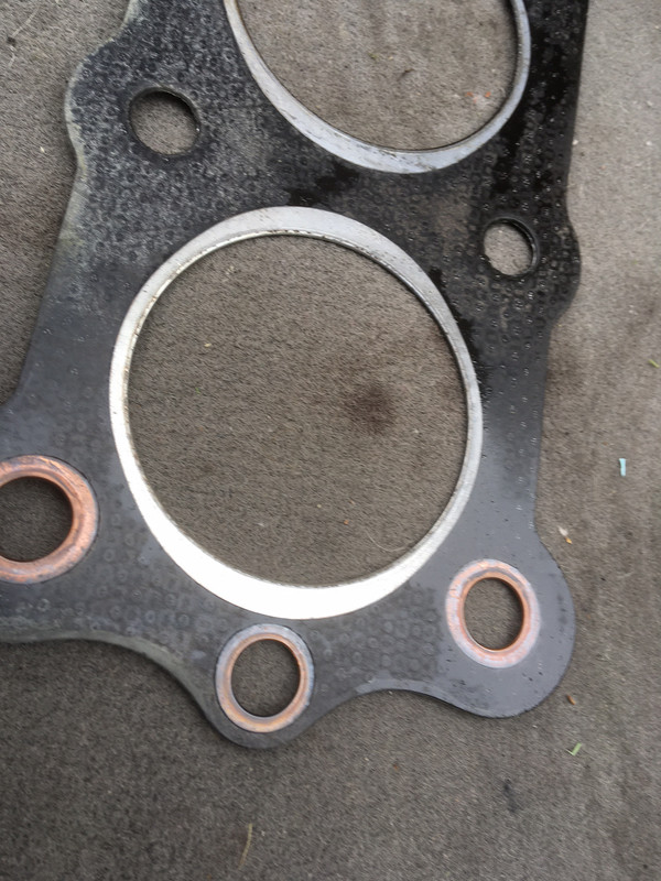

I may have found the smoking gun. The head gaskets weren't cleaned or wiped when I took the head off, they went straight into the parts tray.
First photo is the left side, you can see oil going from the stud, top right in the photo, across the gasket (and under the head) to #2 cylinder (the lower one )
This photo you can see a similar trail, from the front right stud to cylinder #4.
2 and 4 are my two 'wet' cylinders.
Am I right in thinking that the oil feed to the exhaust cam comes up the front outer studs? There don't seem to be O rings to stop it leaking in the parts book, and oil flow diagrams I have found are vague about the route up to the top end taken by the oil.

The oil feed comes up from main gallery at the rear of the block and up the two outer REAR studs BUT it is linked to the front outers via horizontal drillings in the head to the exhaust cams.

I'm going to bite the bullet and buy Kawasaki genuine head gaskets, the ones in my generic gasket set are no better than the ones I've taken out.
The real thing costs an arm and a leg (£151 pre discount and P&P) for the pair, however when I did my CB750 I paid over £110 for a real head gasket, because they work every time.
I'll never know for sure, but maybe I could have got away with just retorquing the head rather than pull it all to bits. I would still have been on knockoff gaskets and valve seals though, if I use the best I know I've done the best job I can. The Viton valve seals showed up this morning.

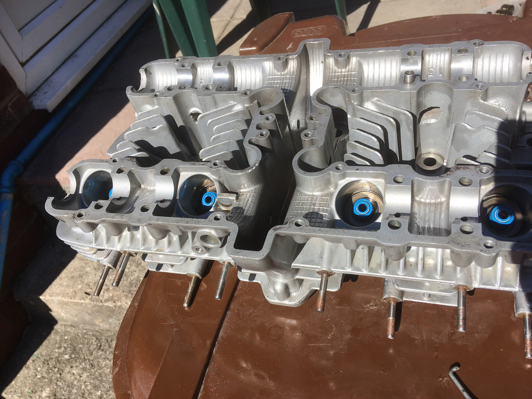

While I wait I need to sort the head out, here I have fitted the Viton valve seals, using the wheelie bin again as an outdoor workbench.
For the sake of my sanity and valve clearances I had been warned that under no circumstances should I get shims and valves etc mixed up. A root around revealed a tray (with lid) for dips, nuts etc that we inherited from my Mother in Law. Once at the centre of the dinner table, with its 8 compartments it turned out to be just what I needed!
