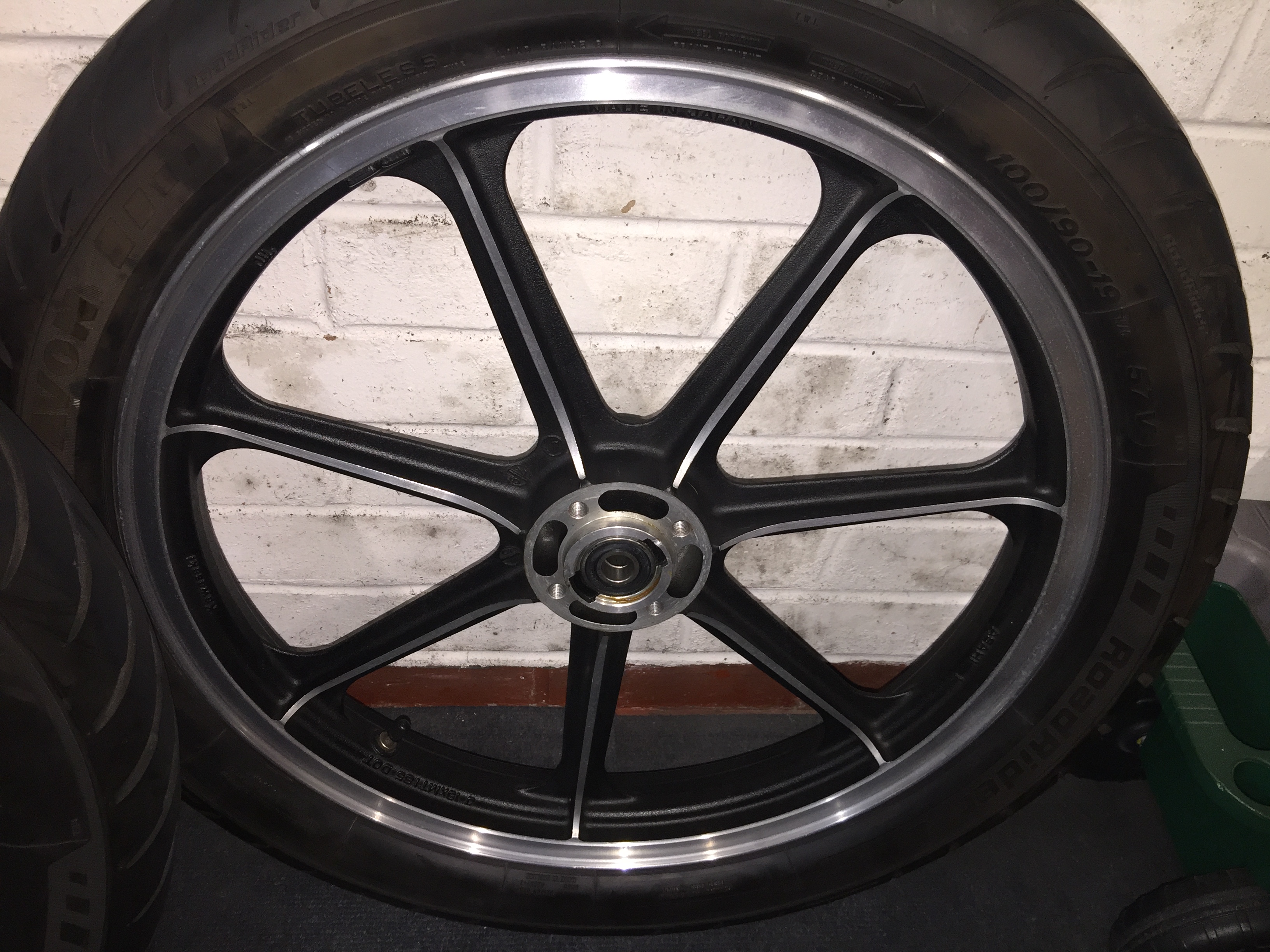

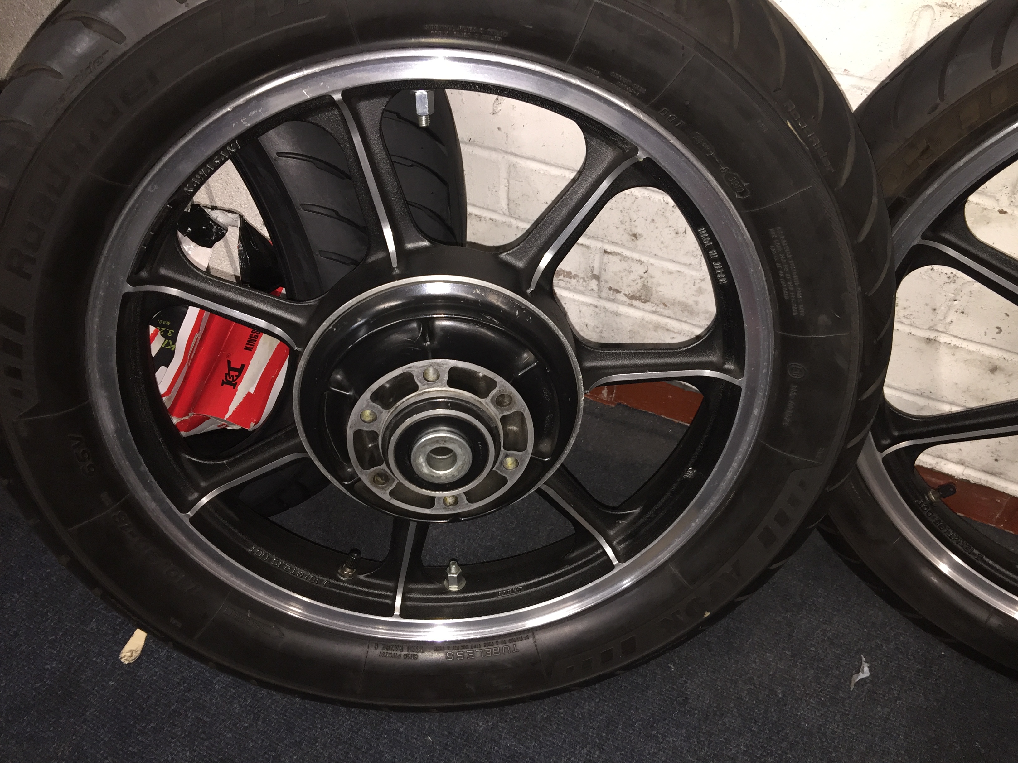

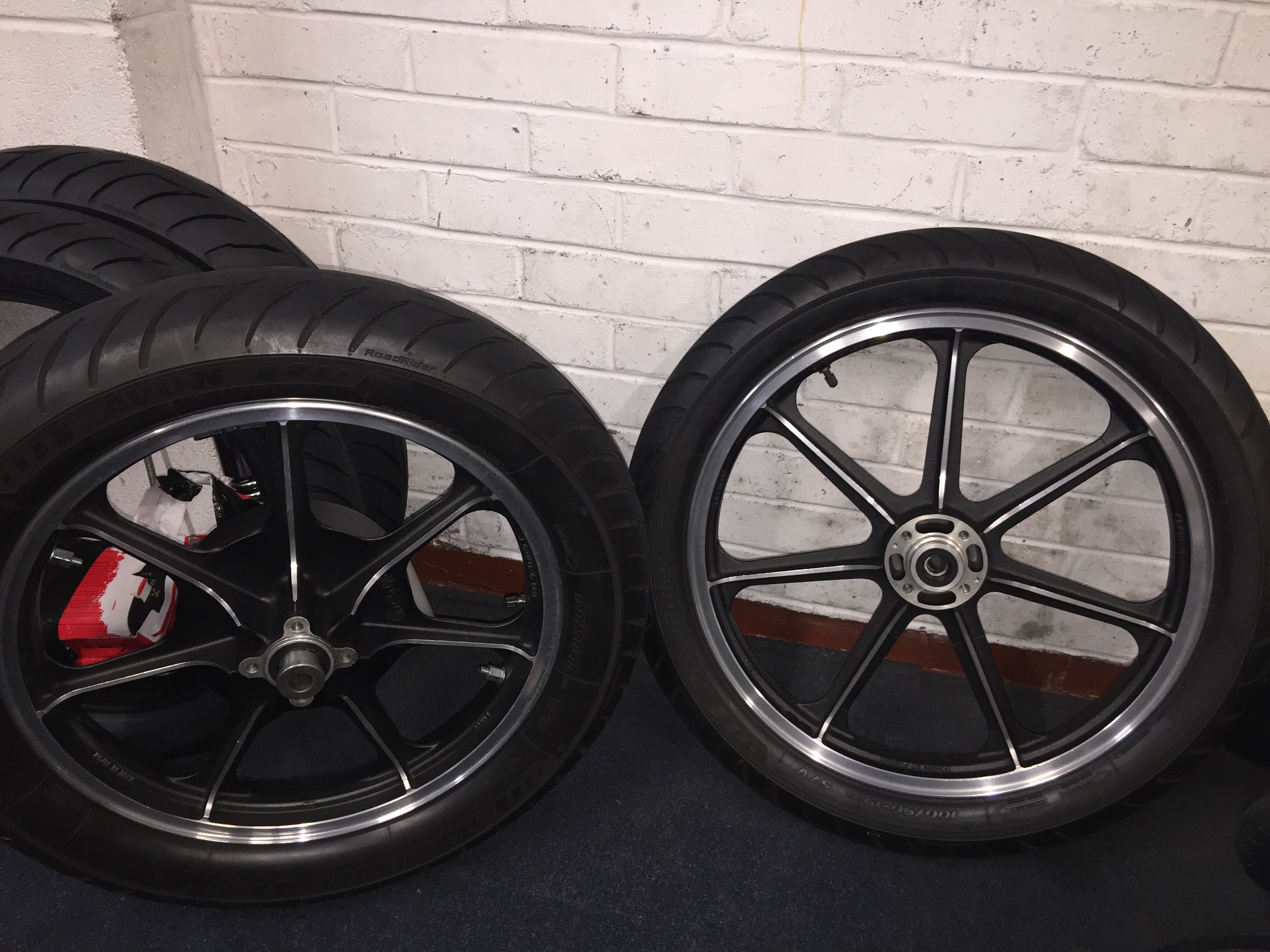

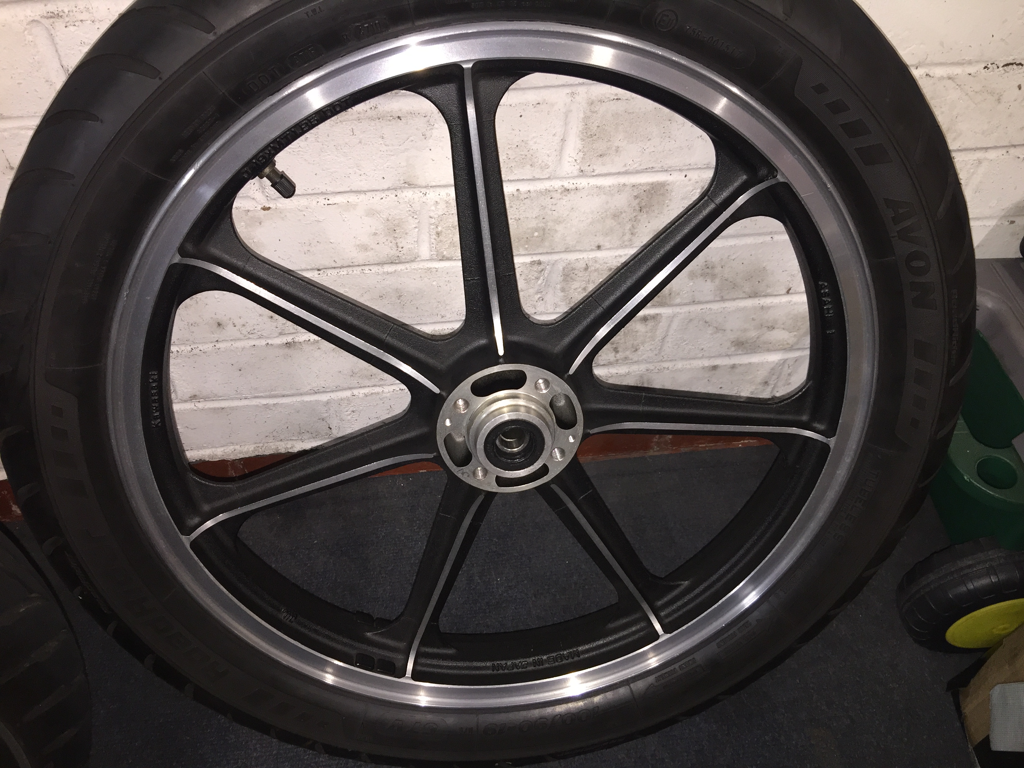

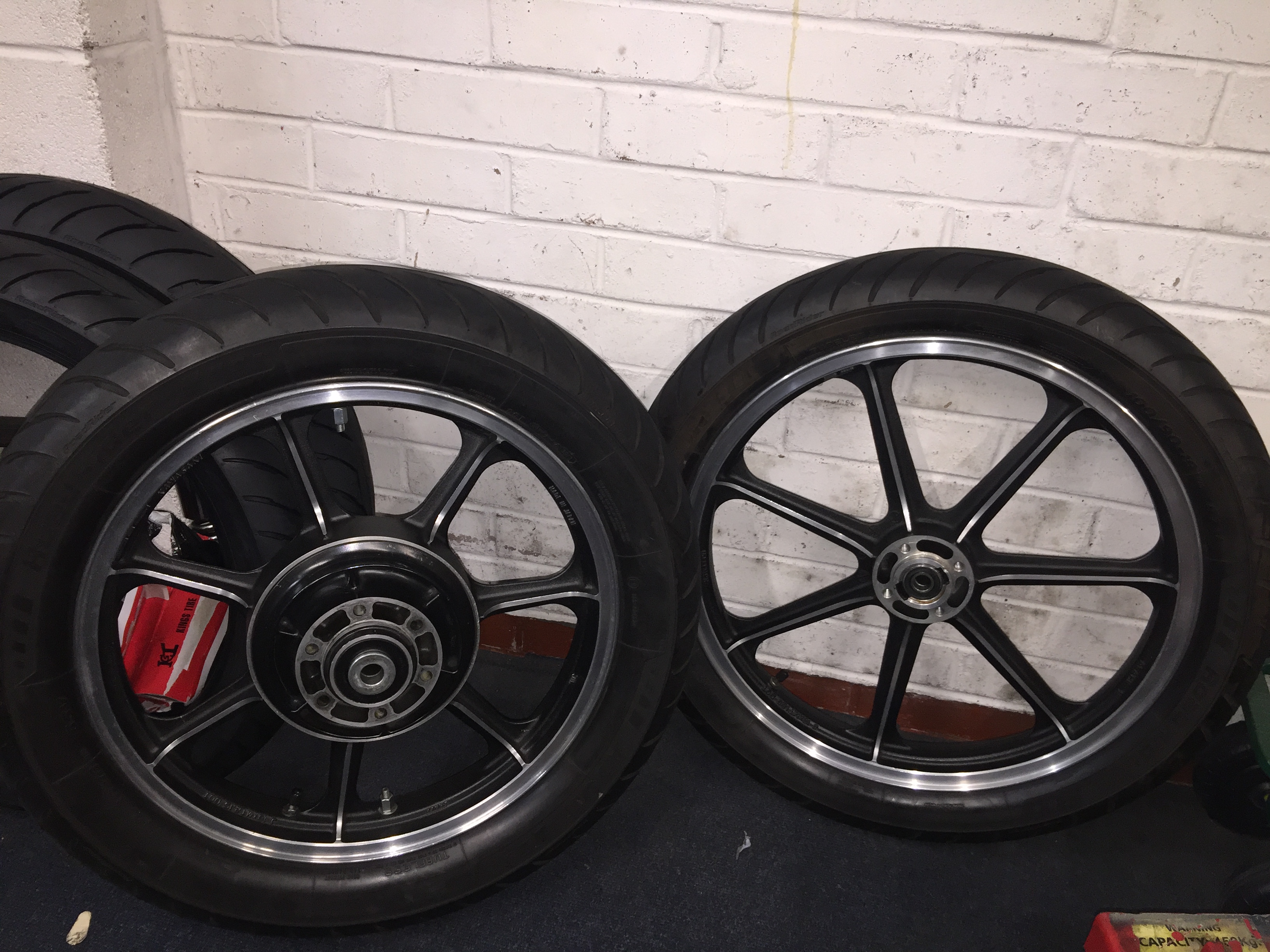

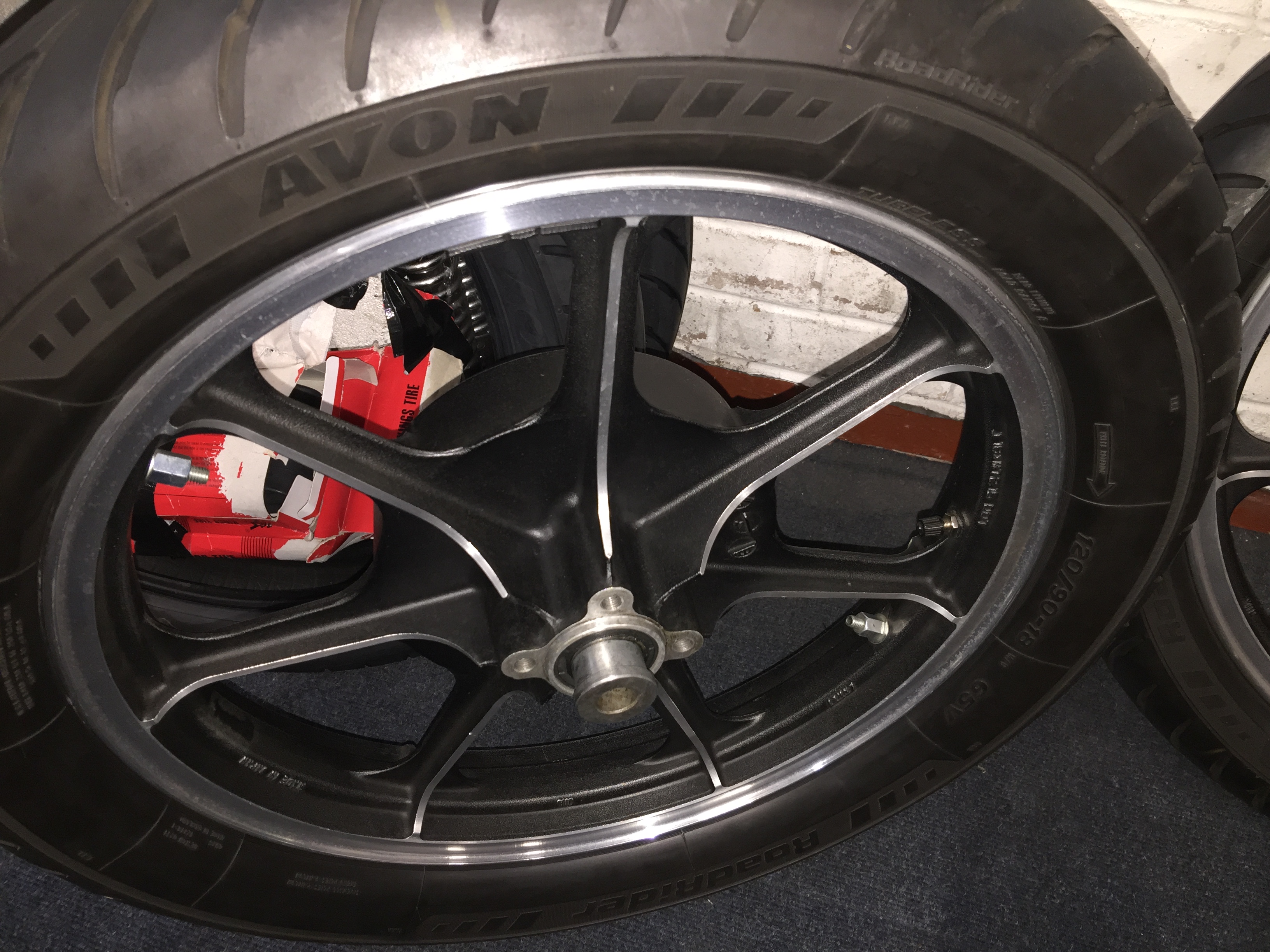

All,
I’ve just removed the wheels in the photos below from my Z1000A1 in favour of a set of spoked wheels.
I think I’d like to sell these Kawasaki wheels but to advertise them I need to know which model of bike they came from and possibly which models other than the A1 they will fit.
I’m not sure what they came from but they are 4 bolt disc mounting front and rear.
Any input would be great.
Cheers.

they look like z1000mk11 wheels

The markings cast into the wheels are as follows,
Front J19 X MT 1.85 DOT
Rear J18 x MT 2.15 DOT.
Hope this helps.
Posts: 4690
Re: Kawasaki Alloy Wheels
#10 PostAuthor: z1bman » Thu Nov 25, 2021 10:17 pm
same wheels are fitted to these models z650c3 / z1000mk11 / z1000d2 / d3. only difference is the outer wheel spacers are different/ sprocket hub / disc side spacer should also fit the z1000h fuel injection other than the colour which is gold

These look like MK2 to me.
I think that the Z1R wheels have a slightly different design where the spoke meets the rim.
