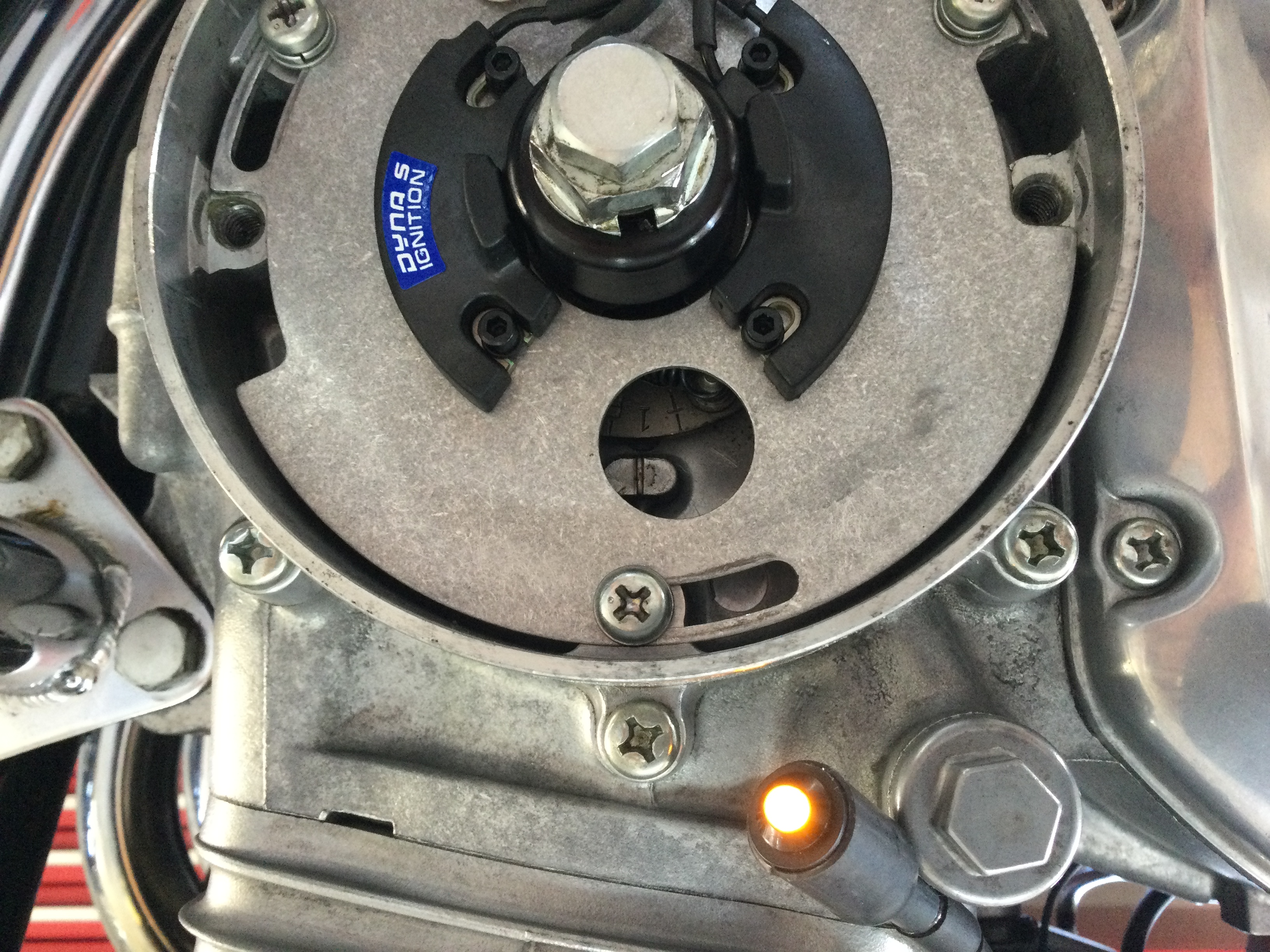

Please see the attached image - this shows the firing point for cylinders 1 and 4. This is the best I can get with the backplate rotated as much as it can.
Any thoughts or comments on this would be greatly appreciated.

This is a common problem.
The Z900/Z1000 Dyna's DS2-1's have a choice of two different rotors to suit the early or later ignition advancers.
One marked 3A for advancers fitted to the early Z1's and the other marked 3 for later bikes.
If you have the wrong rotor it will cause the problem you have which is well known.
It is also possible that the pick-ups are on the wrong side of the back plate and flipping it round may solve the issue.

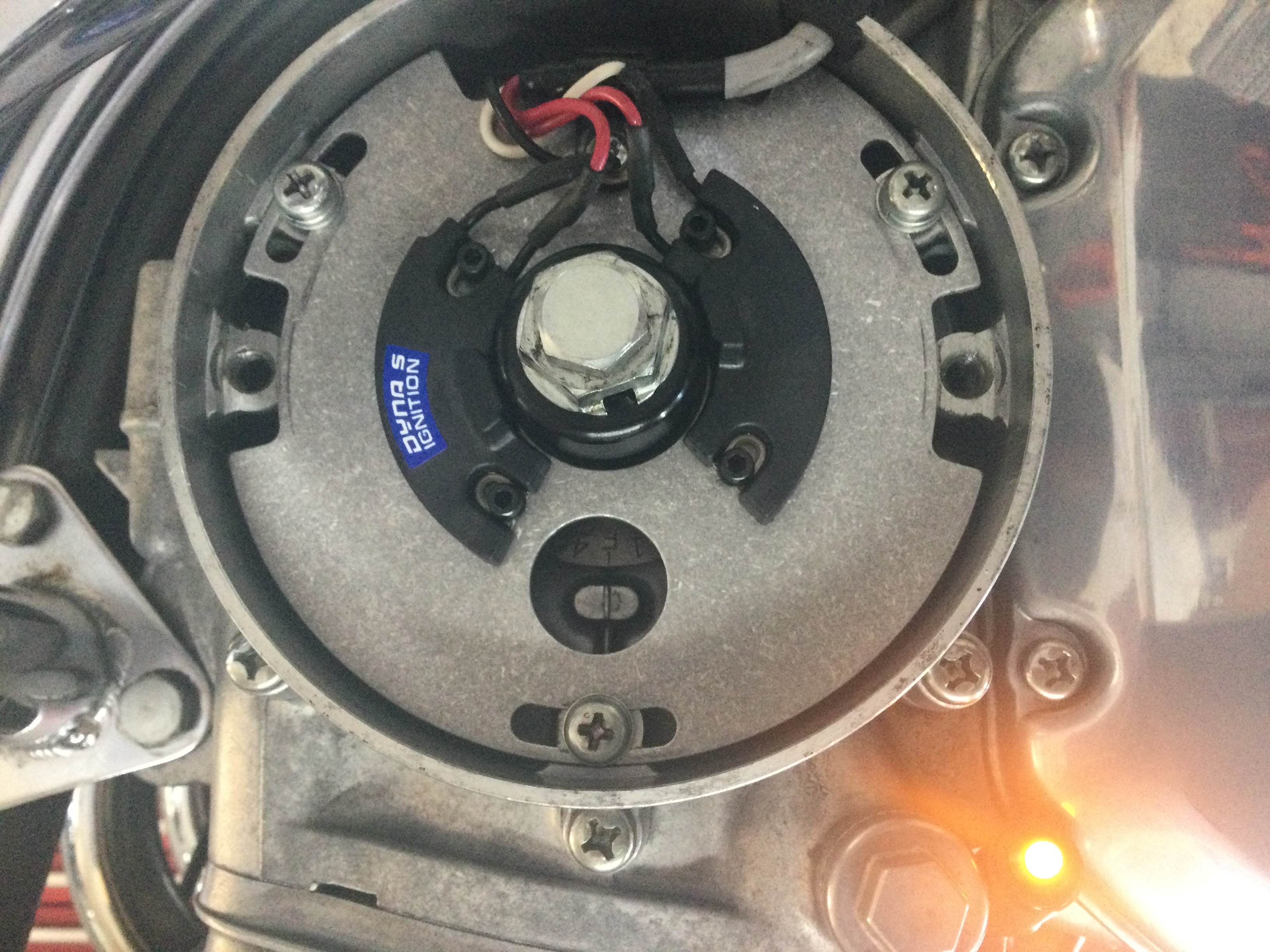

I followed what Zed1015 advised regarding flipping over the backplate.
I remove the pickups and flipped the backplate over, then reassembled the assembly back onto the bike.
I set the slots bang in the middle of the screws and checked the static timing on 1 & 4. It was almost spot on, the F marked is just a fraction away from the mark on the crankcase.
Needs a bit of fine adjustment to get it just right. Obviously I need to check 2 & 3 after this and adjust the Dyna module as necessary. I will check the dynamic timing with my strobe.
Strange that the bike was timed perfectly on the T mark on both 1/4 and 2/3. Whoever originally installed the Dyna and timed the bike must have been confused between the T and F marks when doing the static timing.
The bike did run ok, but it will interesting to try it now the timing has been corrected.
Please see the image - this is 1/4 which is now firing at the F mark.

Looking at the most recent pic , it was the backplate that was the wrong way round.
A few people have had them coming like that from the factory.
Firing on TDC will lose a lot of power and waste fuel so you should see a decent improvement in performance and MPG.
