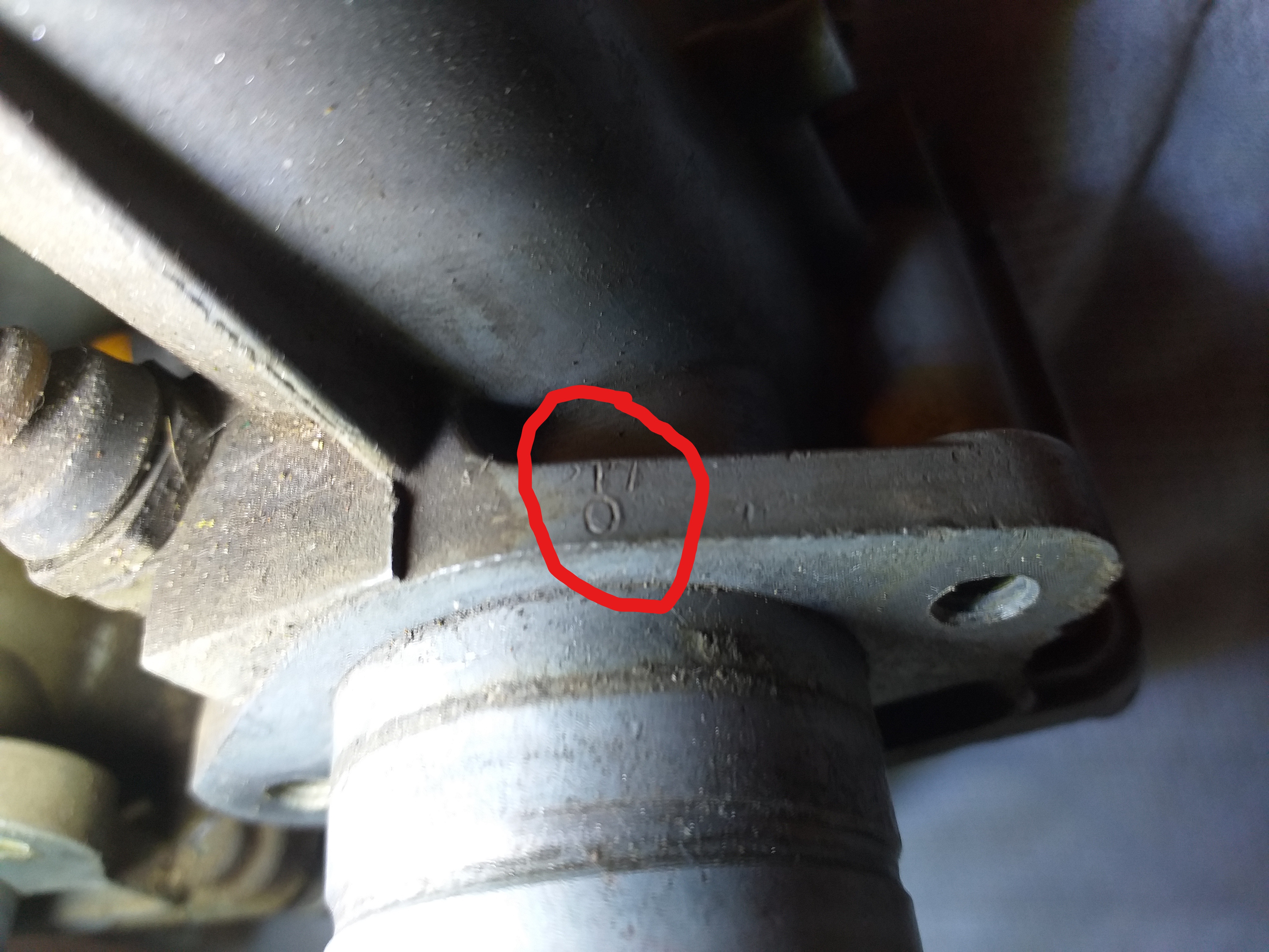

Not sure what you mean by bleed pipe (others on here may be familiar with the term) but you need to identify the carb first. Z900 used 26mm carbs but Z1-A and Z1-B used 28mm.
There were 4 variations of carb used on the Z1's and you can ID which you have by looking on the engine flange (see pic showing a 2170 type as fitted to the later Z1-A and Z1-B).
The numbers are 1470, 1472, 1473 or 2170.

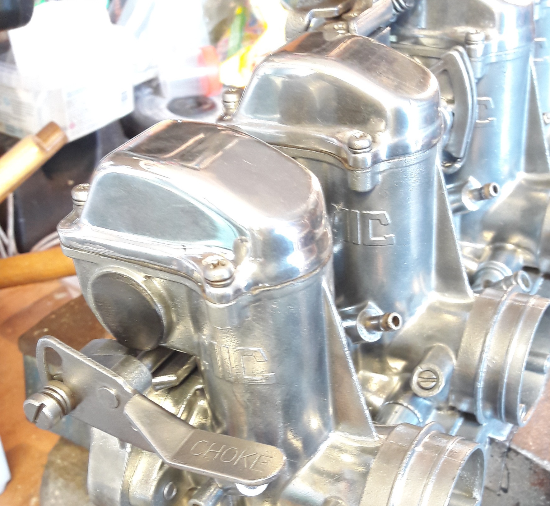

Hi thanks for the quick response but after my last post I thought I'd better go and see which models of carbs I had and I'm beginning to think I was sold the wrong ones. They were advertised as 28mm and were from an earlyish Z 900. I bought them quite a while ago and never thought to check them when they arrived ( mistake ) and they measure 27mm on inlet and the code on them is 1024A. Any ideas???? Thanks Stan. By the way I'm new to the Z world and obviously a bit green.

27mm on the engine side means they will be 26 mm at the slide as they taper slightly. These were fitted to 900 a4's and early z1000's.
Easy way to tell difference between 26mm and 28mm is the mix chamber cap on 26 is domed and 3 screw. 28mm are flatter and slope towards the engine side with just 2 screw.
Post a picture of them, side and underside. 26mm were fitted to several bikes Inc suzuki.

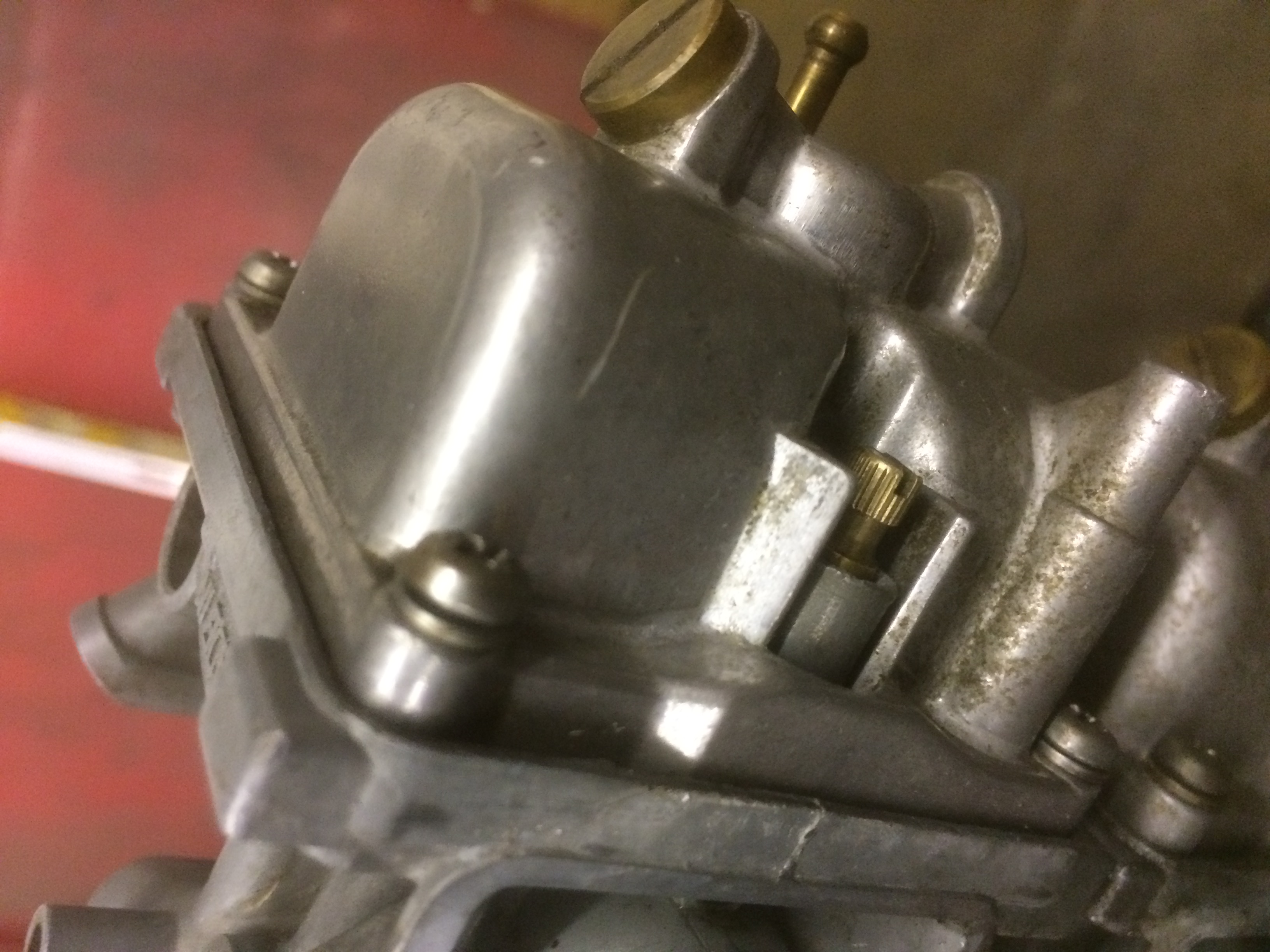

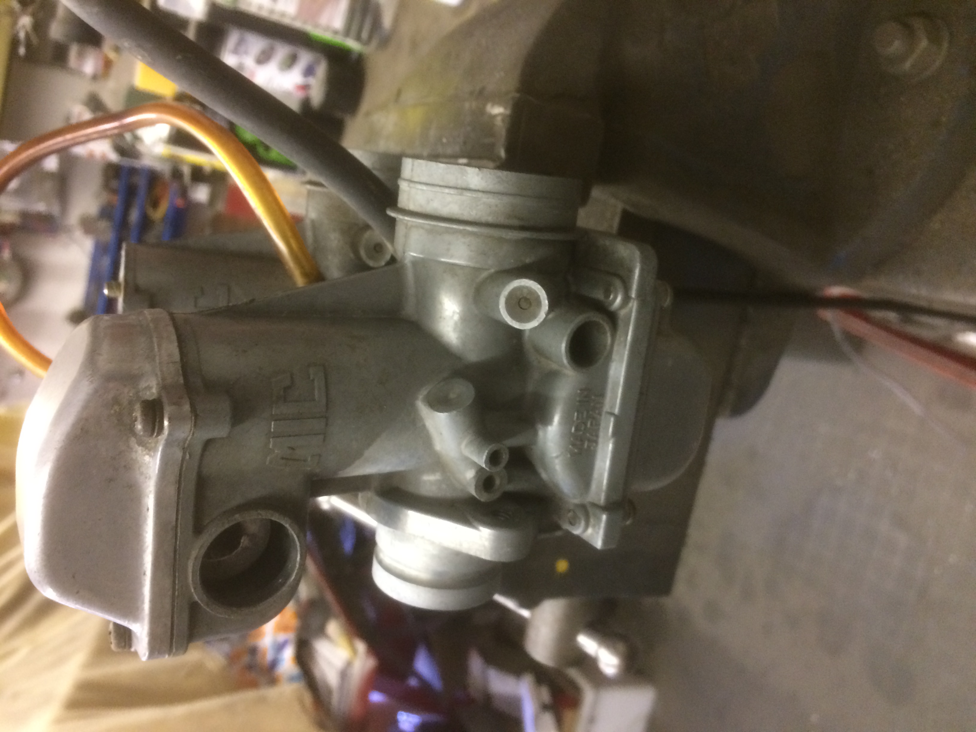

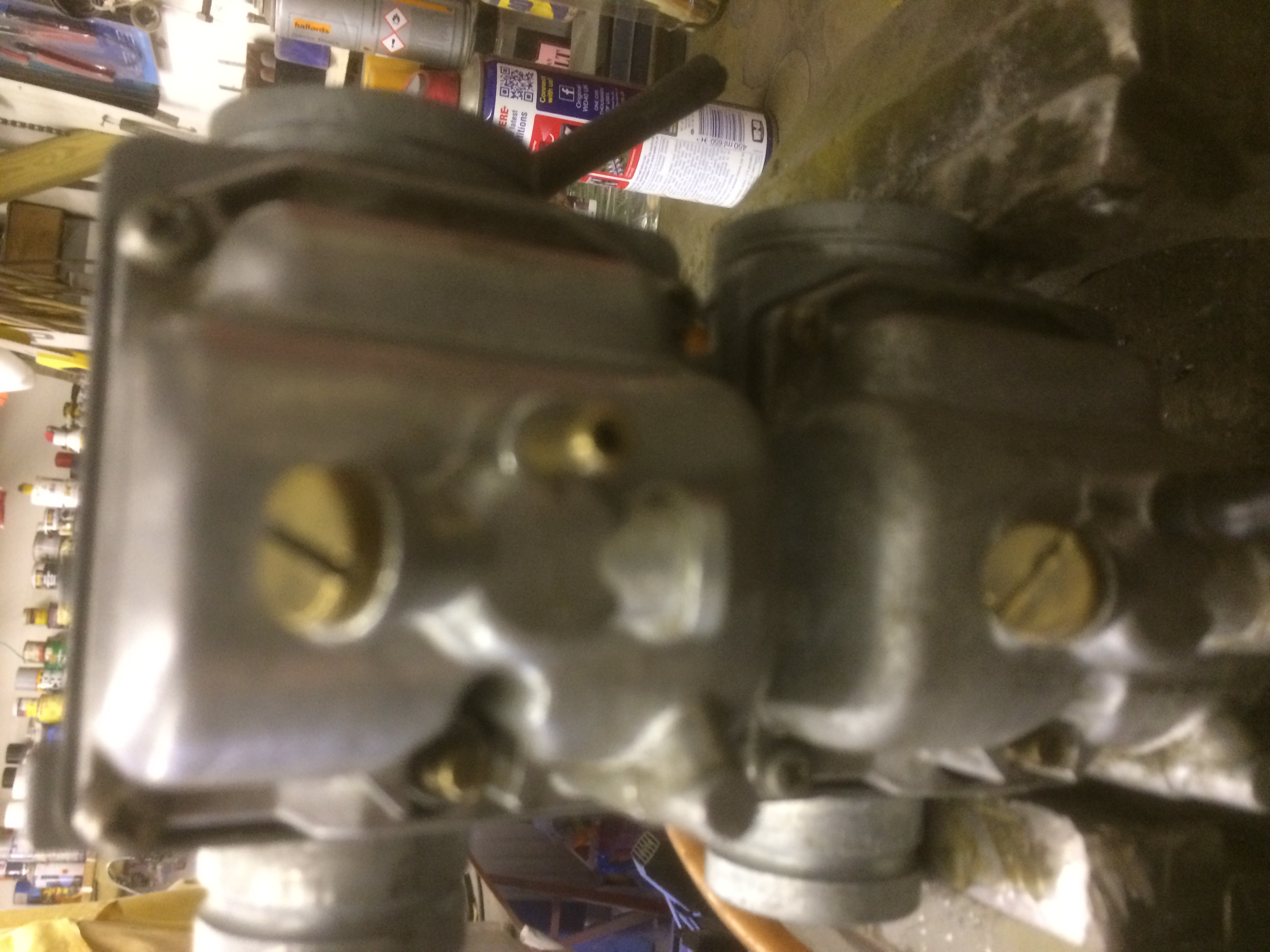

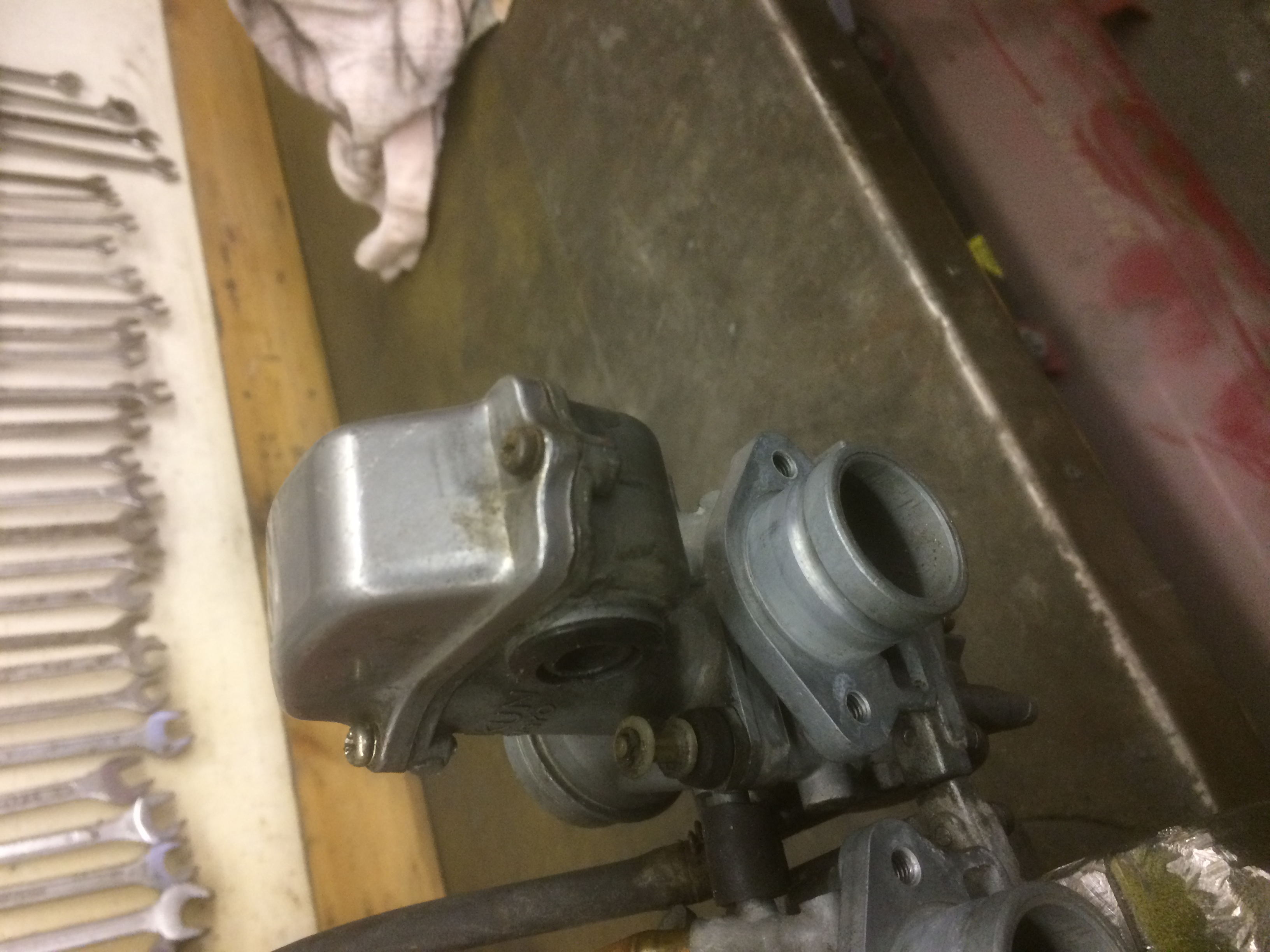

Hi thanks again for all the help/advise. I'm not the best with tech but I think I've added some pics of my carbs.

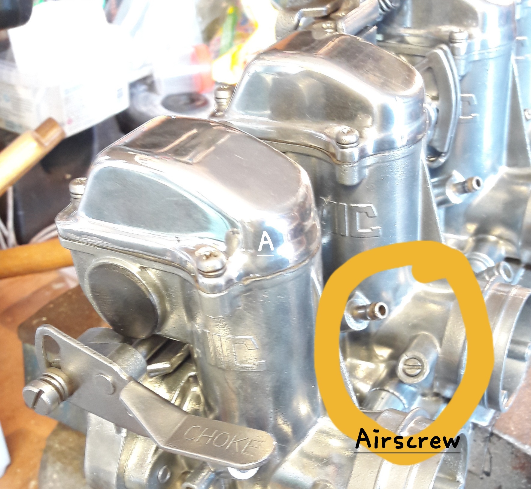

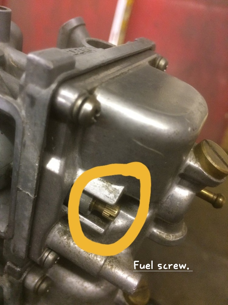

They appear to be vm26ss. Oddly appear to be fuel screw only, no air screw?
Not sure what make/model/market they were fitted too.
Just too confuse some Vm26 have both air and fuel screws!
