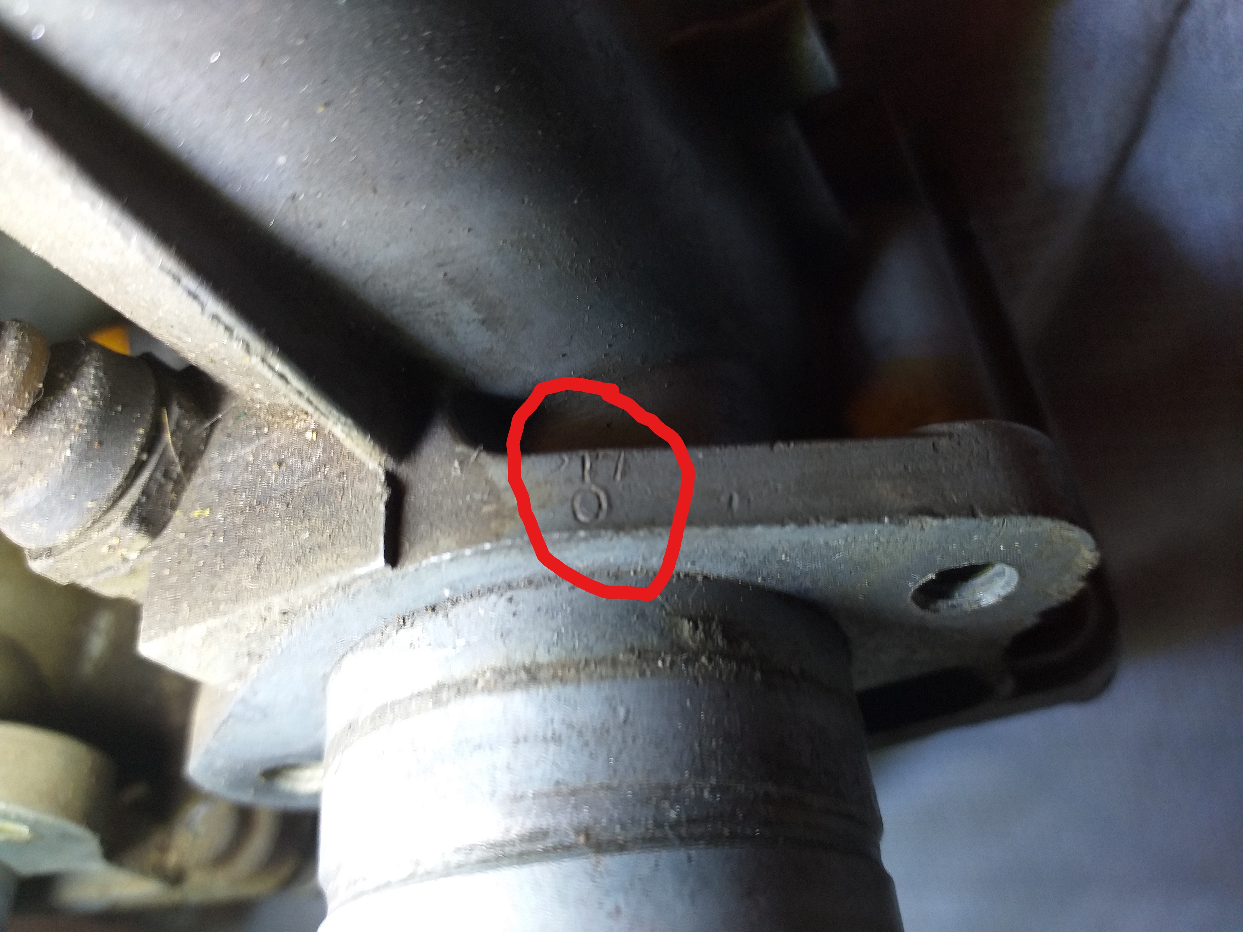

Not sure what you mean by bleed pipe (others on here may be familiar with the term) but you need to identify the carb first. Z900 used 26mm carbs but Z1-A and Z1-B used 28mm.
There were 4 variations of carb used on the Z1's and you can ID which you have by looking on the engine flange (see pic showing a 2170 type as fitted to the later Z1-A and Z1-B).
The numbers are 1470, 1472, 1473 or 2170.

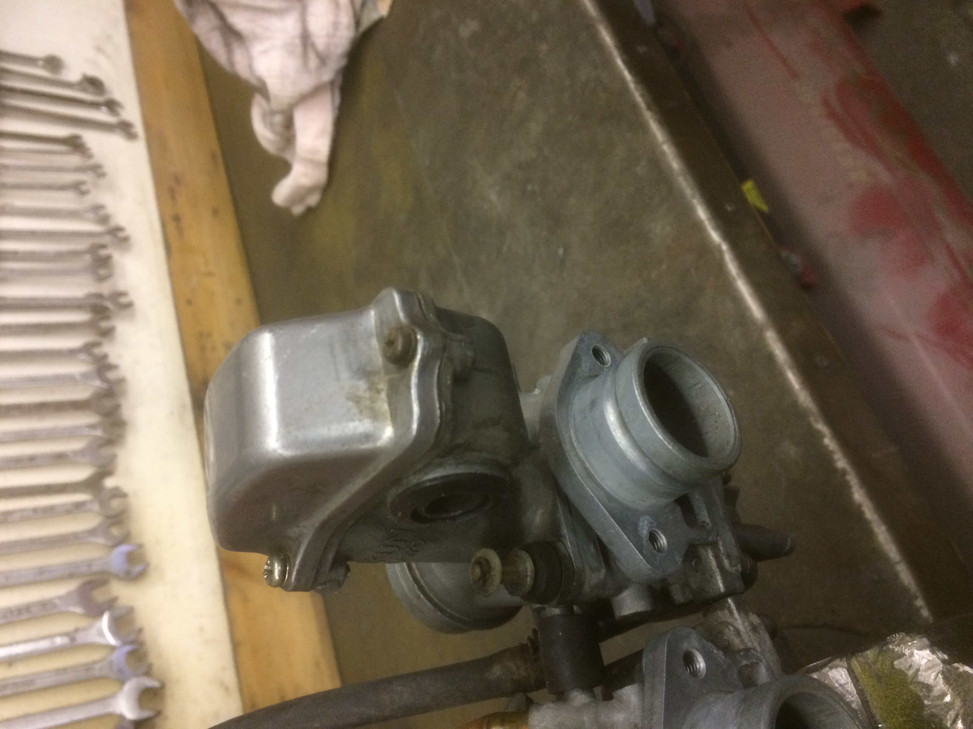

Hi thanks again for all the help/advise. I'm not the best with tech but I think I've added some pics of my carbs.

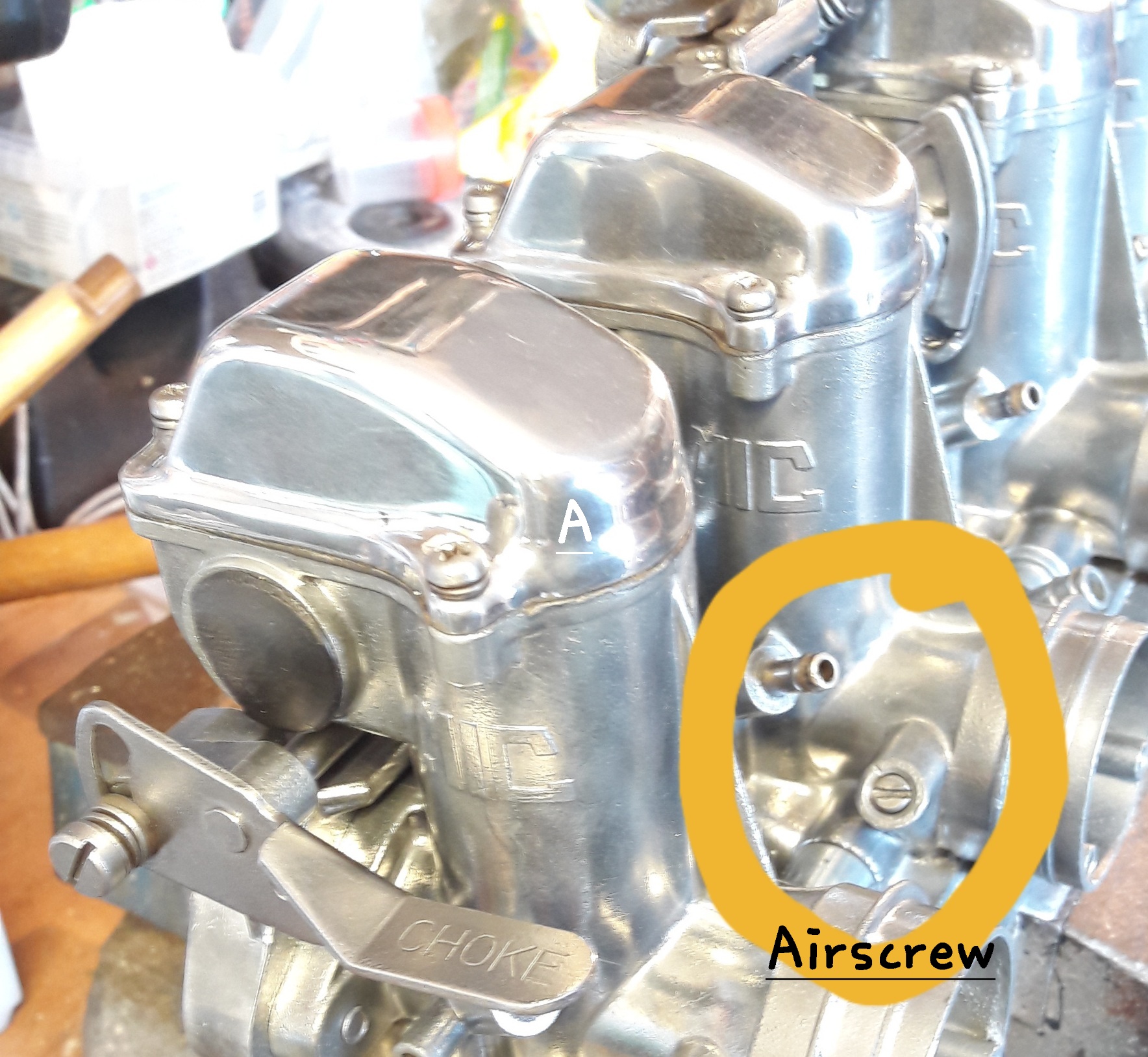

They appear to be vm26ss. Oddly appear to be fuel screw only, no air screw?
Not sure what make/model/market they were fitted too.
Just too confuse some Vm26 have both air and fuel screws!
