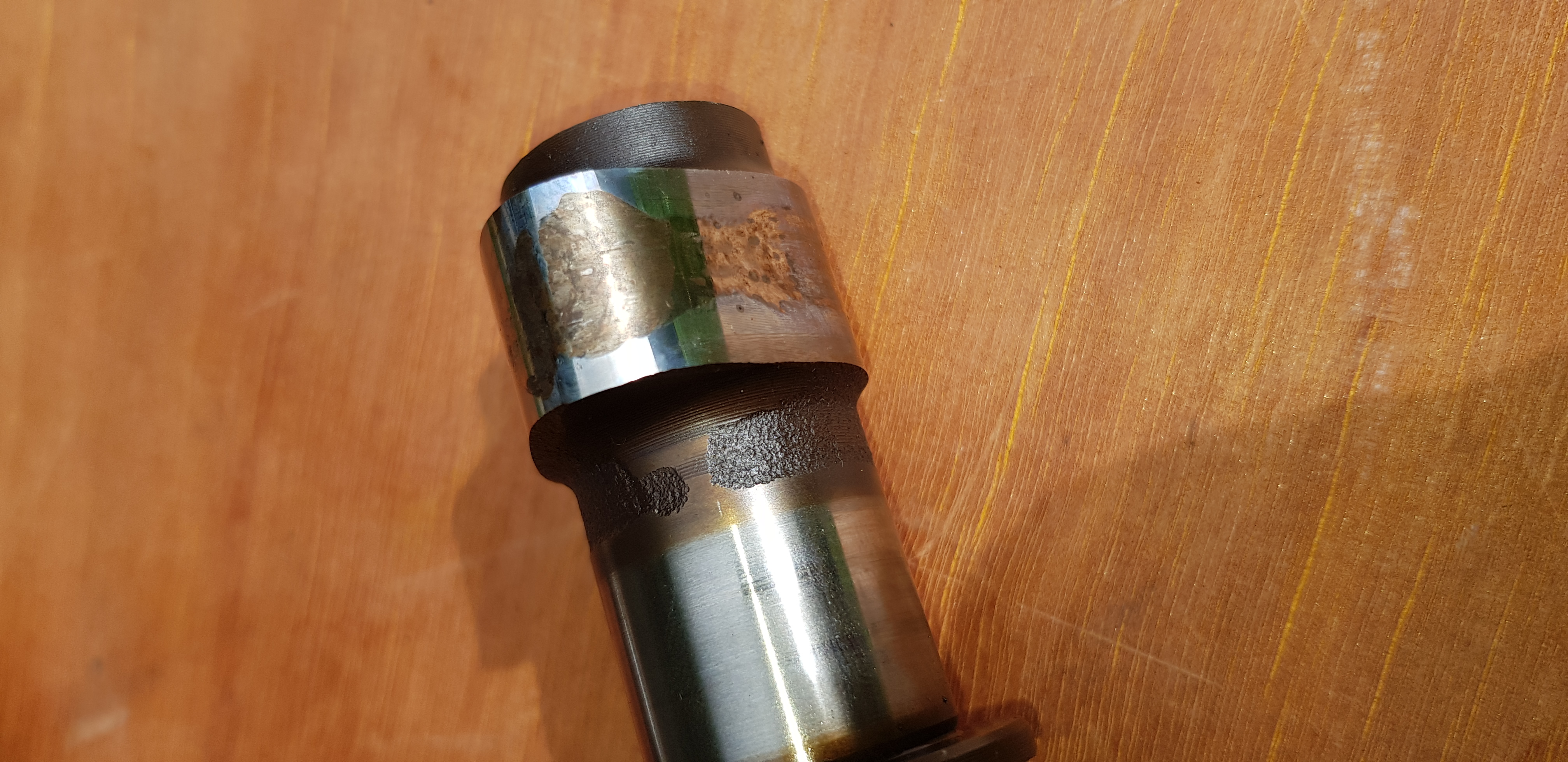

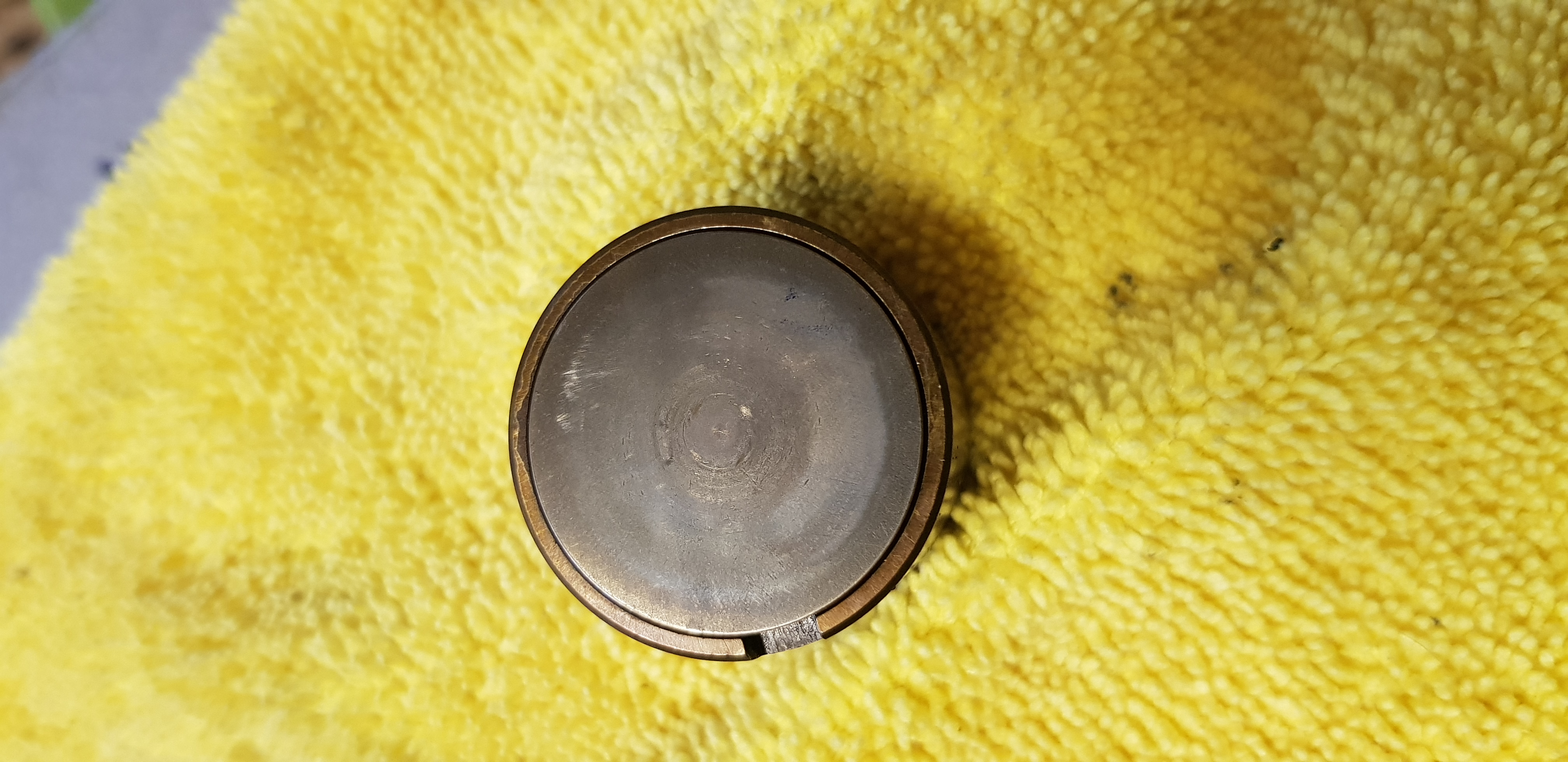

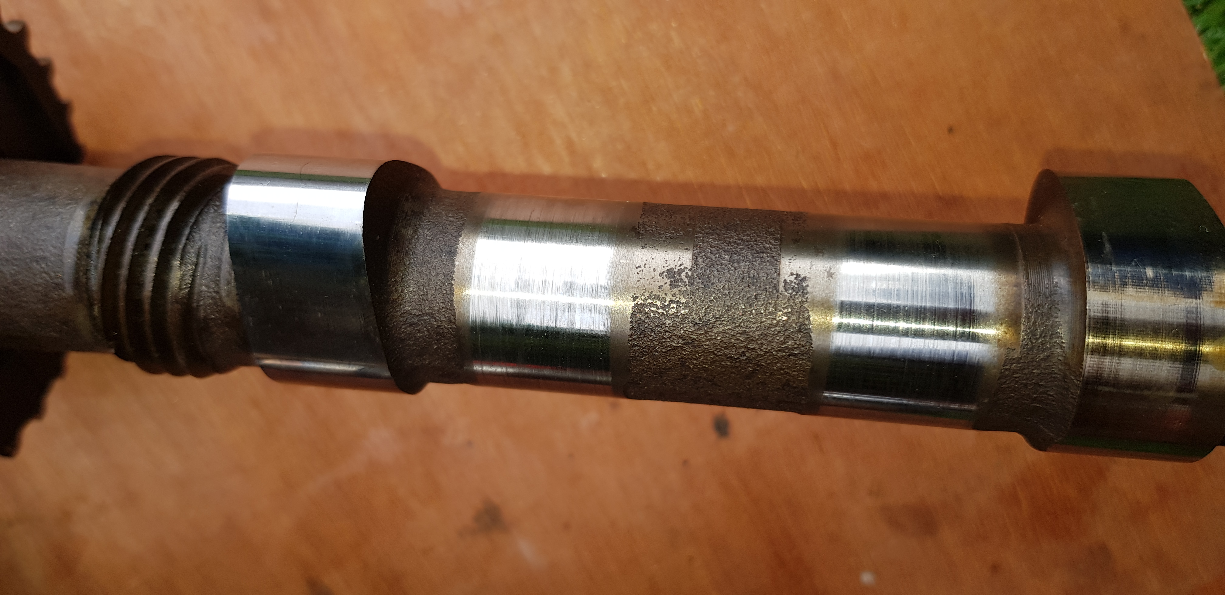

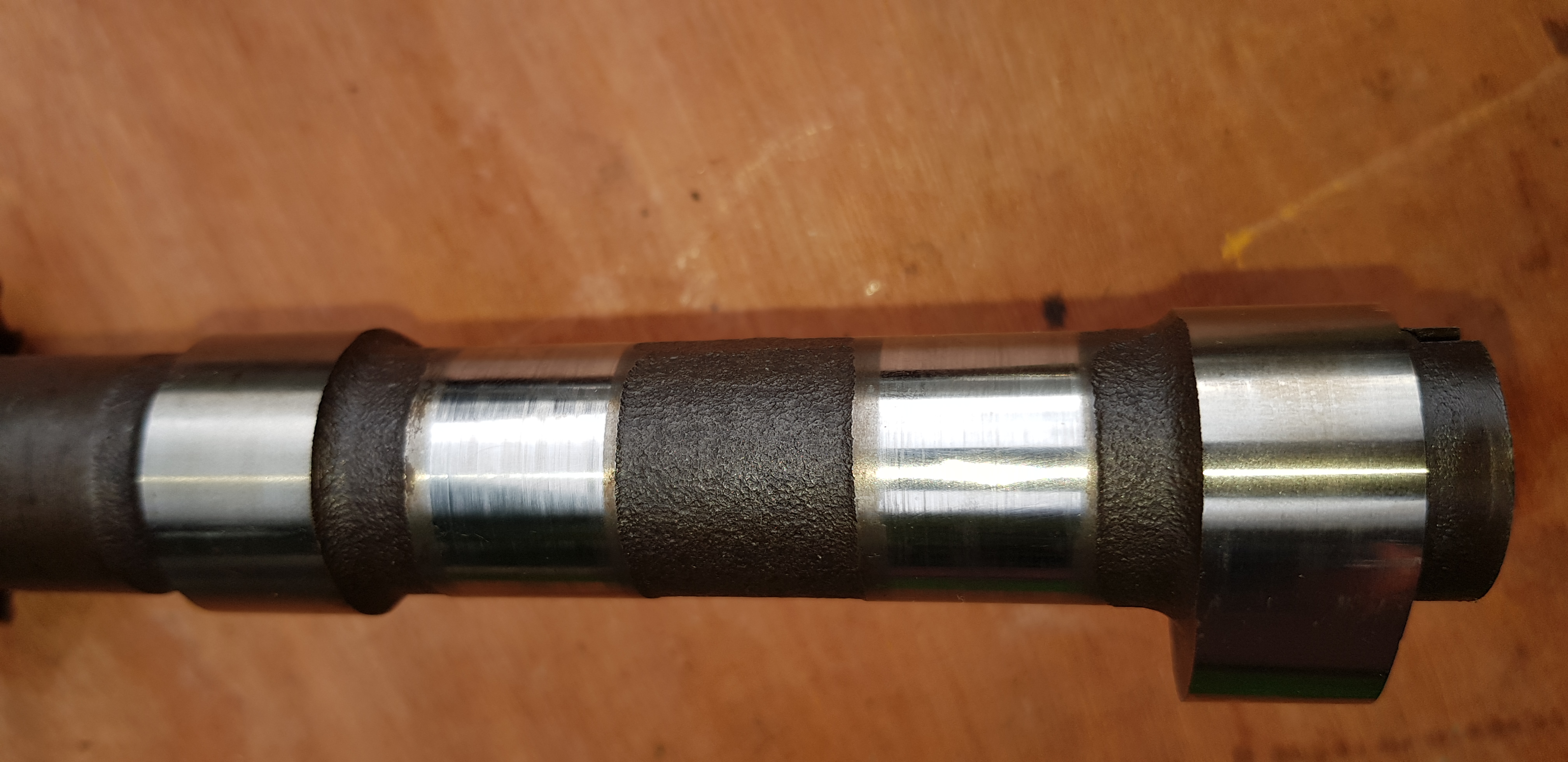

pictures of camshafts, the marking on the lobe is the exhaust cam , this is the cylinder that was oiling up and on examination has damaged vale stem oil seal. hope these pictures help, thanks again.

#6 PostAuthor: zed1015 » Mon May 23, 2022 9:19 am
The journals are fine if within tolerances, the cam lobe looks like the hard facing is mullered.
Possibly heat related and infrequent oil changes.
What's the shims like on the affected lobes.
Some aftermarket shims are poor quality and can cause lobe damage.

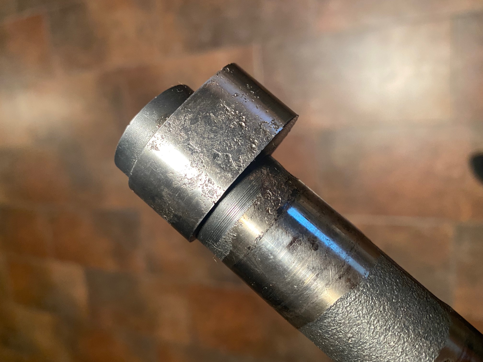

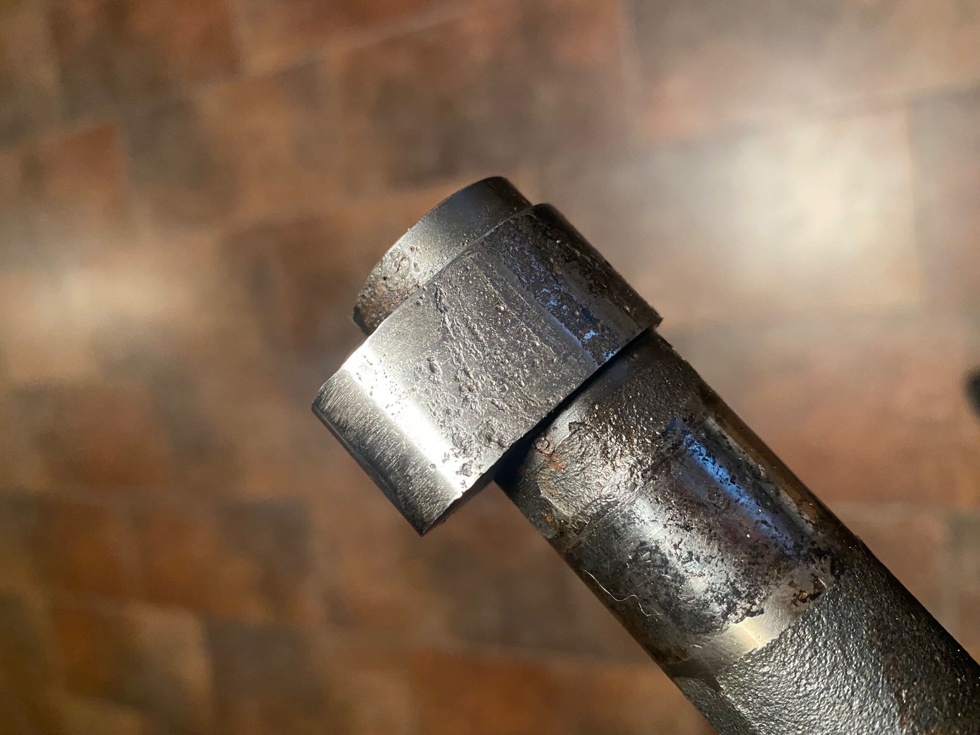

Thanks again Zed, iv saved 2 places to send the cams, this is what the worst of it looks like.
Posts: 2153
Joined: 3rd Apr 2009
Location: leverington UK
Re: camshaft repair / replacement question Z1000A1
#8 PostAuthor: kev edwards » Mon May 23, 2022 5:36 pm
Looks like they have spent a lot of time with water on them, but if they are stock it would probably be cheaper to pick up second hand ones.
Posts: 1042
#9 PostAuthor: Z1streetfighter71 » Mon May 23, 2022 9:49 pm
Oh they are Yoshimura Bonneville Poppy cams, fairly rare on the ground these days, the intake are in good condition but the exhaust are as you see.

zed1015 wrote:The journals are fine if within tolerances, the cam lobe looks like the hard facing is mullered.
exhaust shim , if the lobe hard facing is "mullered" is it something that is recoverable ?
Posts: 4040
#12 PostAuthor: zed1015 » Wed May 25, 2022 8:39 am
Cams cam be re-faced but the cost may be more than picking up another good used set .
You would need to contact one of the cam shops i mentioned to find out.
All the z900-1000 kickstart motor cams are the same spec with only fractional differences in lift ( nominally 8.7mm) due to manufacturing tolerances so they aren't hard to find.
That shim has been scuffed by the cam lobe and without having it in my hand it's hard to tell if it's ok to re-use.
