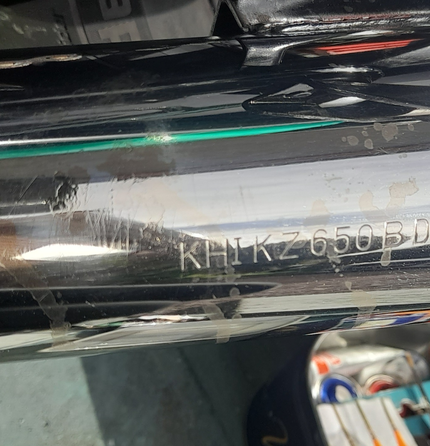

Battery acid marks on chrome exhaust. It's not bad but more irksome than anything. If I could make the marks silver coloured rather than tan I'd be happy. Silver foil seems to be the go to method, but really? There must be a better or more permanent solution than that.
Not bad enough to go the re chrome route but with winter fast approaching plenty of time to have a fiddle.

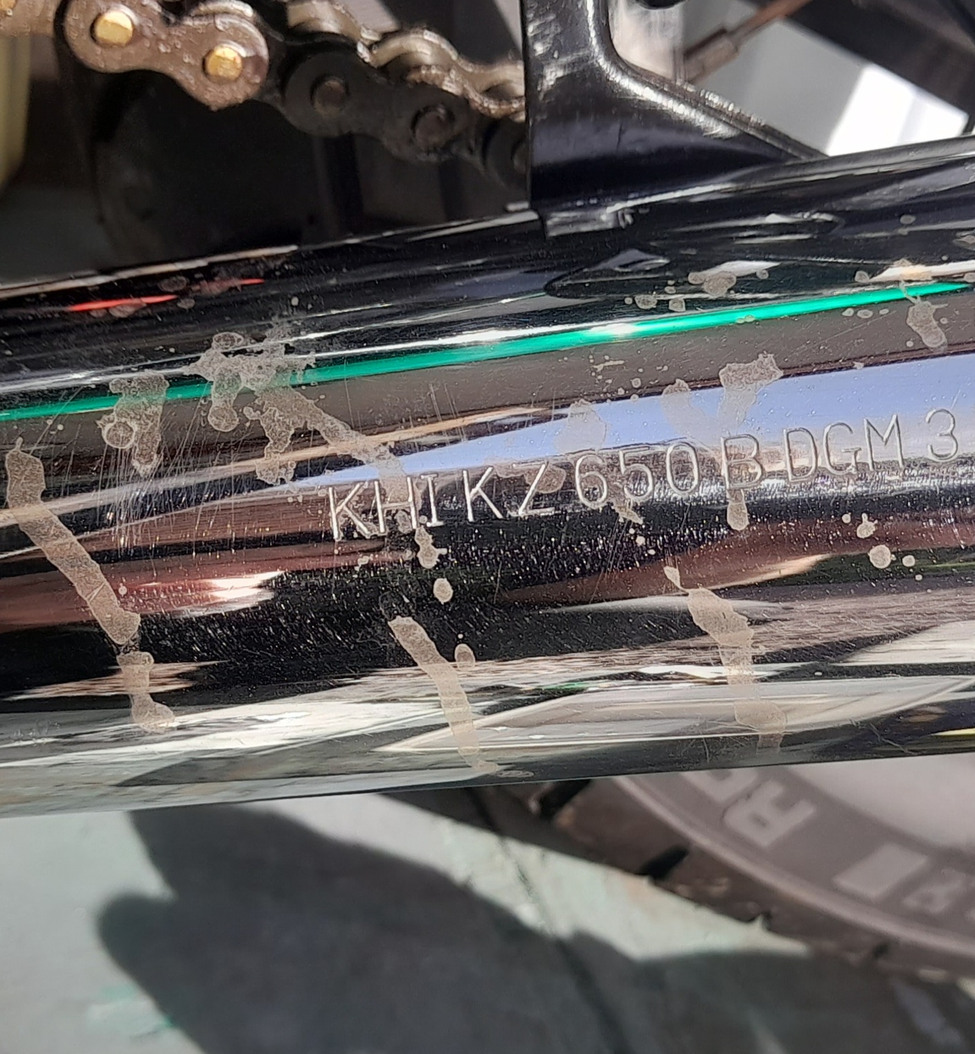

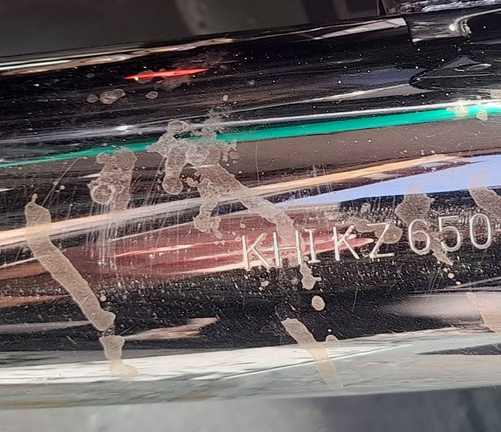

So we have a clear winner,
Starting point.
After tin foil and white vinegar.
After 0000 steel wool and solvo
Only tried a small patch above and to the left of the khi embossing. New tin of elbow grease to be opened then a quick glo polish to help seal.
