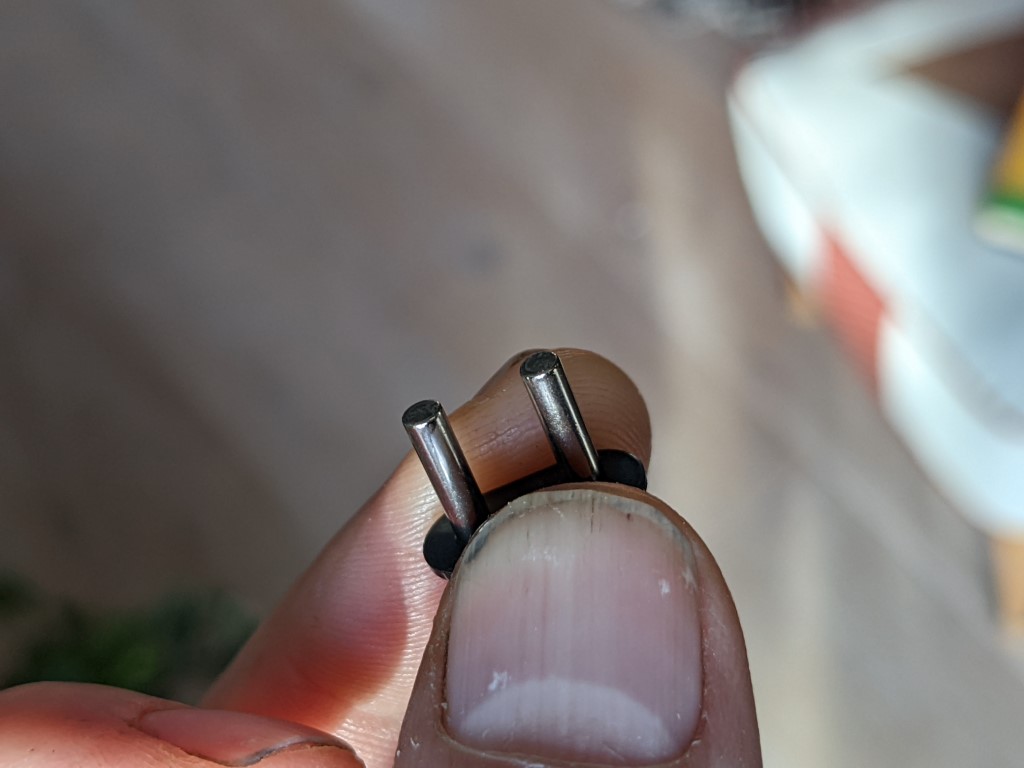

The rivet pins on the rivet link are just plain ended (no depression as per the drive chain version)

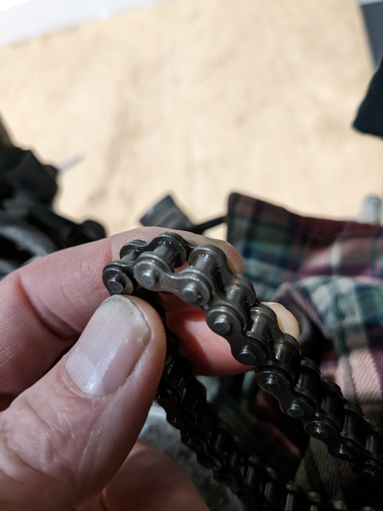

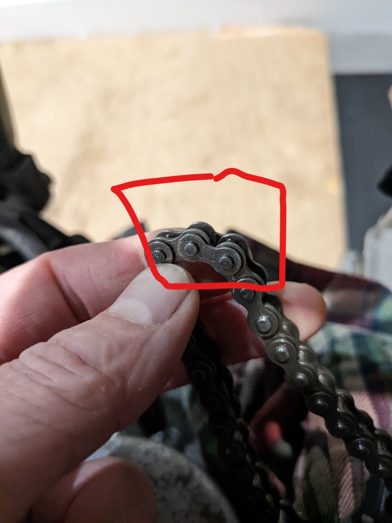

Please see pics attached.
Does anyone know the correct way to close the ends of these pins?

I have a breaking / rivet tool - but this only seems to work with the pins that have the depression in the centre of the end face, allowing the end to be spread / mushroom outwards.

However - I solved the problem by buying a new rivet link from Z power (I think) that came with the depression already in the pins.
So it was easy peasy to crush the ends over on the link.
