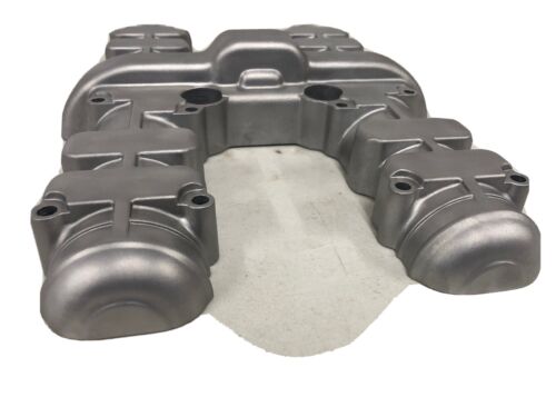

You should just keep the correct height mk2 idler and clearance the cam cover.
The only mechanical difference between all the round covers is the tower in the middle.
Early Z1 ones are straight and plain and later ones have a bulge either side to clear the sprocket bolt or rivet.
For the mk2 idler use this later type of cover and trim the internal rib.

Hello zed1015 - I had a "lightbulb moment" when I read your latest !!
I originally wrote : "ALSO Is there a rounded cam cover that fits the Mk2 ?? .... I think I can remember one time fitting a cover - I think it was from a Z1R and with one casting rib inside ground away it fitted .... I could be wrong !!"
Suddenly I remember it clear as day.....
I guess the "how much is the cam advanced" question becomes academic.....
Thanks for your response / help

(Google trigonometry calculator)
Chain pitch, is 7.77mm.
Therefore sprocket is advanced by 1/5 of one tooth ( 4.85 rounded) on a 32 tooth MKII sprocket.
There are 32 teeth on the MKII cam sprocket and 360 degrees on the crank.
360 divided by 32 teeth gives 11.25 crank degrees per cam wheel tooth.
Cam wheels rotate at half engine speed so multiply by 2 as crank travels at twice speed of cams.
11.25 degrees at the cam wheel x 2 equals 22.5 degrees crank rotation per cam wheel tooth actual.
We are estimating; 1/5 of a tooth, so divide 22.5 again equals 4.64 crank degrees for 1/5 a cam wheel tooth.
Z1000 (1015 motors) valve timing figures are;
Inlet opens 30 degrees BTDC
Inlet closes 70 degrees ABDC
This gives a standard 110 Lobe Centre (LC) for the MKII camshafts
Advancing the inlet for opening gives a new number at 34.64 degrees
Advancing the inlet for closing gives a new number at 65.36 degrees
Larger number plus 180, minus smaller number, then divide by 2 equals 105.36 LC
(65.36 plus 180, minus 34.64 divided by two becomes 105.36 Lobe Centre)
It looks like the advance in the inlet cam wheel alters the standard 110 LC to 105 LC which seems excessive to me but there it is.
Approximately.
The centre idler pulls the chain down by 2mm in the centre as stated.
This could be seen as equivalent to 1.6mm overall; 0.8mm per side of the ‘V’

Thanks again for some more number crunching Al.
I believe there'll be one or two engines out there with this set up from back in the day so its very useful to have a number to put on it.
