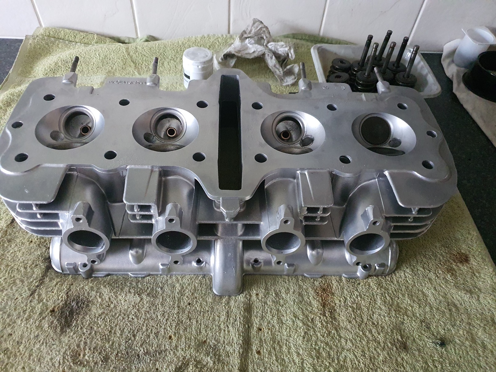

Good afternoon to all,
As you may have seen I'm in the process of carrying out a gull refurb of my Z900, whilst i have worked and restored both cars and bikes before, not specifically the Z900 hence my call for help from more knowledgeable people.
I recently fully stripped my engine as part of the resto, i have had all of the cases, cylinder head, barrells, sump etc vapour blasted and rhey have come up like new. There were several issues i have found collapsed cam chain rollers etc but thats another story.
Before stripping the engine ran fine and didnt smoke at all, i also did a compression test on all 4 cylinders which were all very similar readings.
The head has come back from blasting and ot has obviously been apart before and had new hardened valve seats fitted because of carbon you couldnt tell before but now you can see slight cracks in the plug hole threads in 2 of the cylinders. I have no idea if when the seats were fitted they were too tight and caused this, or whether this is normal wear and tear? It could have been like this for years, also theres no compression leaks currently and cracks are only at last 15mm or so of plug thread remainder is all intact.
Whats your thoughts guys, can it be left as is or does it need urgent sorting, could it spread up the hole? if so who and ruf cost.
Many Thanks

Re: Z900 A4 Cylinder head refurb (advice needed please)
Yours and just about every head out there Graham.
I wouldn't worry about it, it'll run fine., if your really worried you can get them welded.
What compression readings did you get?
It'll be fine.
Most heads have those surface expansion cracks.
How do you know it's had new seats fitted in the past ??
The stock seats are hardened from the factory.
Thanks for replies guys, i wrote the 4 cylinder pressures down, but cant find the paper now, its in garage somewhere, but from memory they were within a few psi of each other which usually means little or no wear or leaks.
Good to know the cracks are pretty standard as not seen that before, but then ive never stripped a Z900 before so nothing to go by.
As for Hardened seats i assumed these had been done by eng co. As i recently had a MGB head upgraded to hardened seats and looked very much like that.
Again nothing to go by but if you say thats how they came from factory then thats fine. Its def been apart before as had sticky glue stiff on all gaskets, nightmare to remove, oh and theres a helicoil in 1 of the plug holes, thats been peened over.
I will be re lapping the valves in the same place they were removed, just to ensure a gas tight seal, then do the petrol in chamber with plugs in place to check for seepage.
Its a lot of work, but hopefully be rewarding with a reliable engine.
I am still debating whether to replace the rings, even though good compression, as no idea how long theyv been in, bikes done 22k ish so may have been refreshed at some point but who knows?
Use diesel not petrol to check for seepage, maybe wrong......
Sorry excuse my ignorance but why diesel? I know diesels good for freeing up seized engines and bolts etc by soaking wasn't aware you use it for seepage. Do have both diesel and petrol so not an issue just wondering if theres a particular reason its better to use in this test.
moizeau wrote:Use diesel not petrol to check for seepage, maybe wrong......
I use paraffin.
Any particular reason for parrafin, rather then the other 2 forementioned liquids.
Im guessing you could use anything really even water at a pinch, anything will tell you if you have a leak, guess petrol does evap quickly whilst diesel and parrafin dont, just thinking out loud now
Petrol evaporates, diesel and paraffin don't, they are basically the same
Yes realised afterwards, ill use diesel as got some in a fuel container.
moizeau wrote:Petrol evaporates, diesel and paraffin don't, they are basically the same
