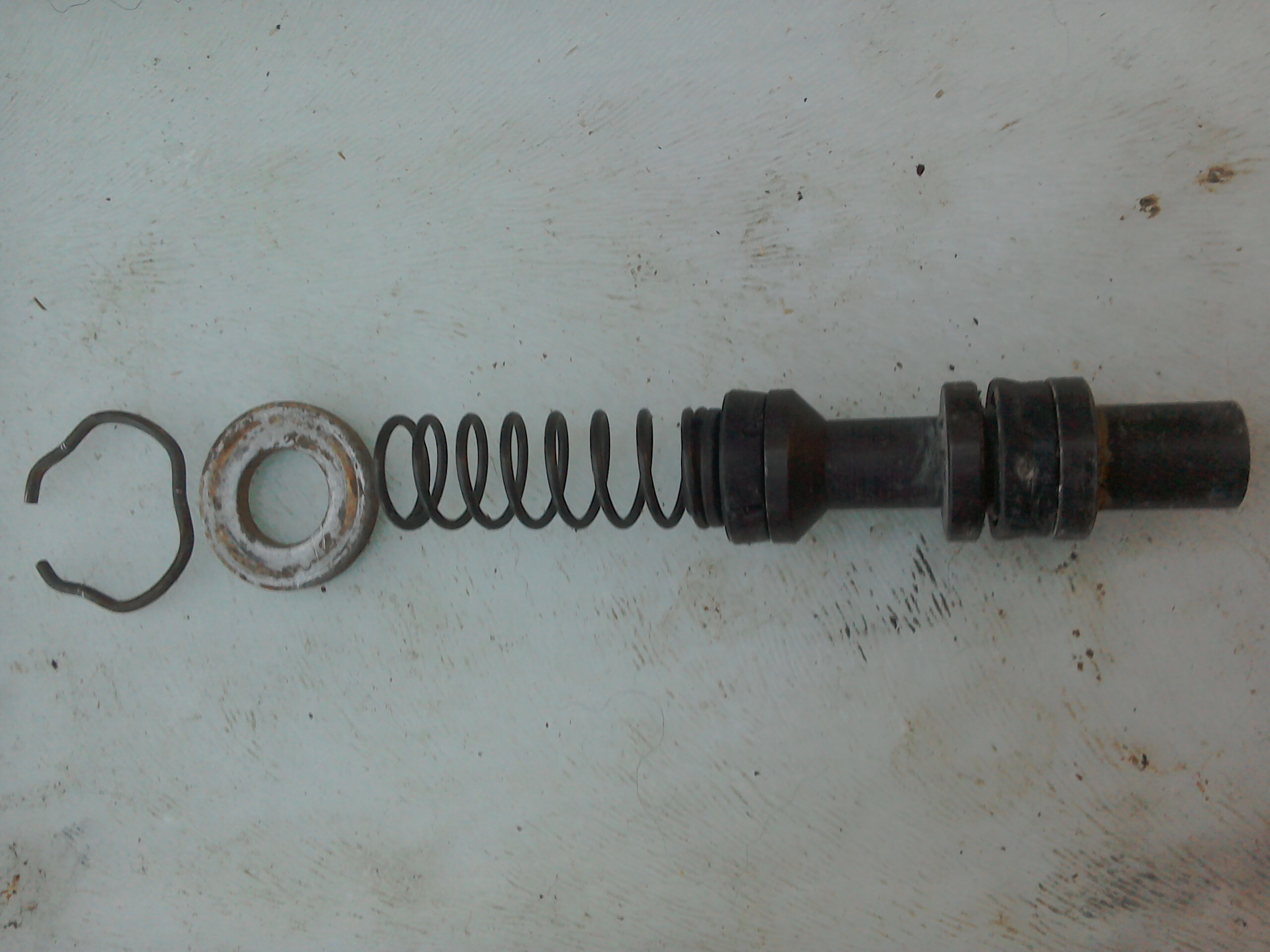

Got all the brake parts I need but can't find a seal/repair kit for the rear master if no longer available what are my options?

Cheers guys but z-power only have kits for the E1 with resivor built into master model mines a e2 which has a separate resivor connected by a short hose nobody seems to have one anymore.
So any suggestions on how to get round this problem would really be appreciated.

Yes I did but they don't have them either from what I understand the master cylinder (43020-1015) was only fitted for a very limited time but have found two places one in America £100 and Australia on eBay for £50 that can supply the two rubber seals.

According to csml the part no for the piston is the same as the z1000 a1 & other models so this should fit
https://www.z-power.co.uk/piston-rear-master-cylinder

Have already been advised this will not fit here's a pic of mine
