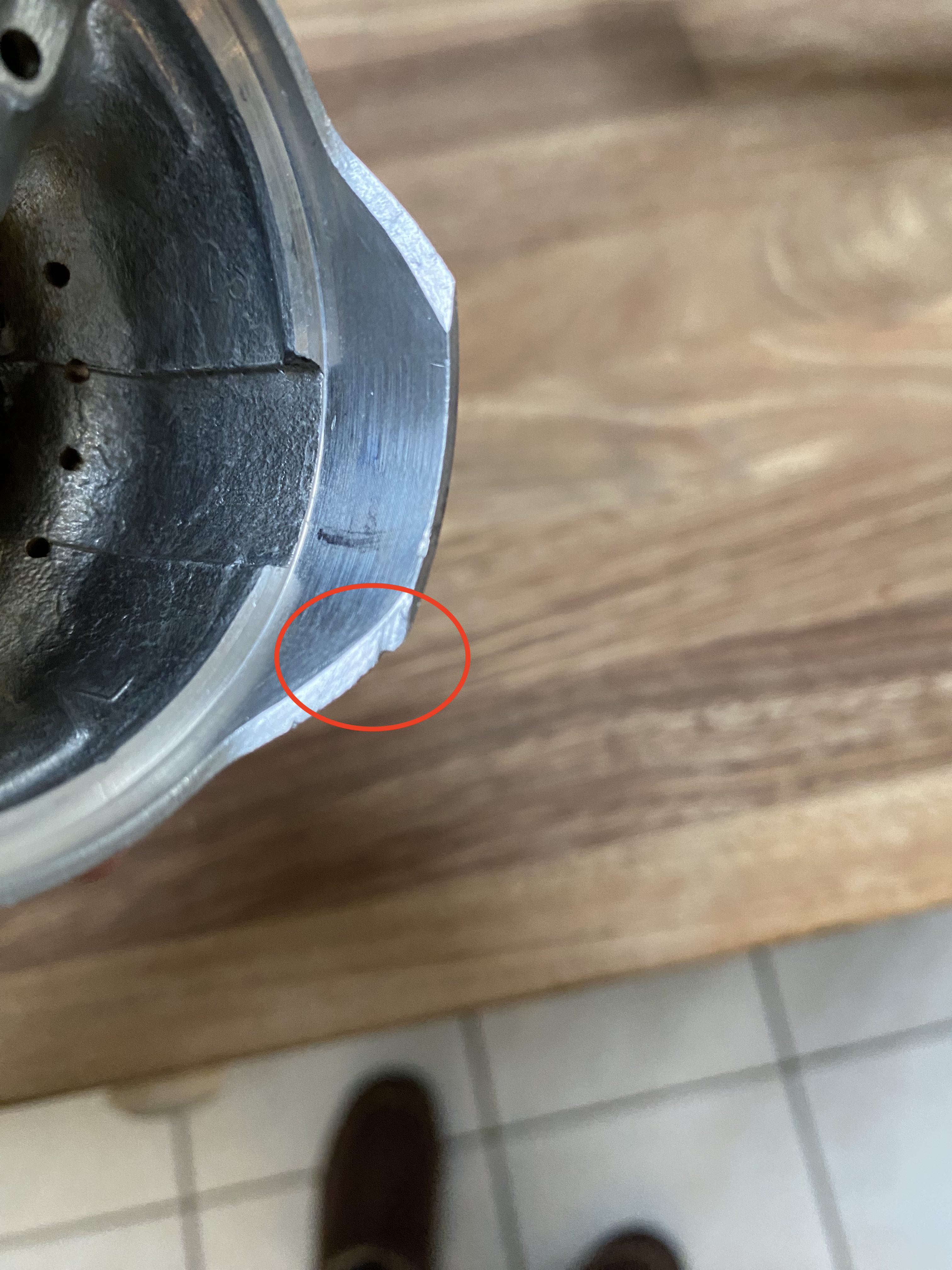

What I did spot was that the scoring/wear shown in the barrel in my photo posted yesterday, aligned perfectly with a little nick in the bottom of the piston (see new photo.) My assessment is that when onnthe table and the head was off but pistons still in place, that the crankshaft was turned and the piston moved down and basically snagged off the top of the crankcases causing this little nick (there are similar ones on other pistons. I’ll put money on the nick having flared the alloy out creating a minute protrusion which has caused that line in the barrel.
