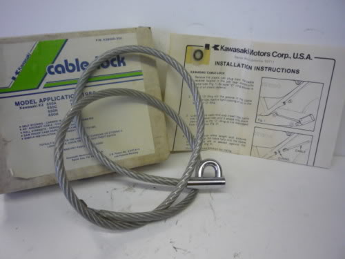

when the bike as new, you could buy a cable lock that was stowed away in the frame. Most didn't buy it and the hole was covered with a plastic cap.

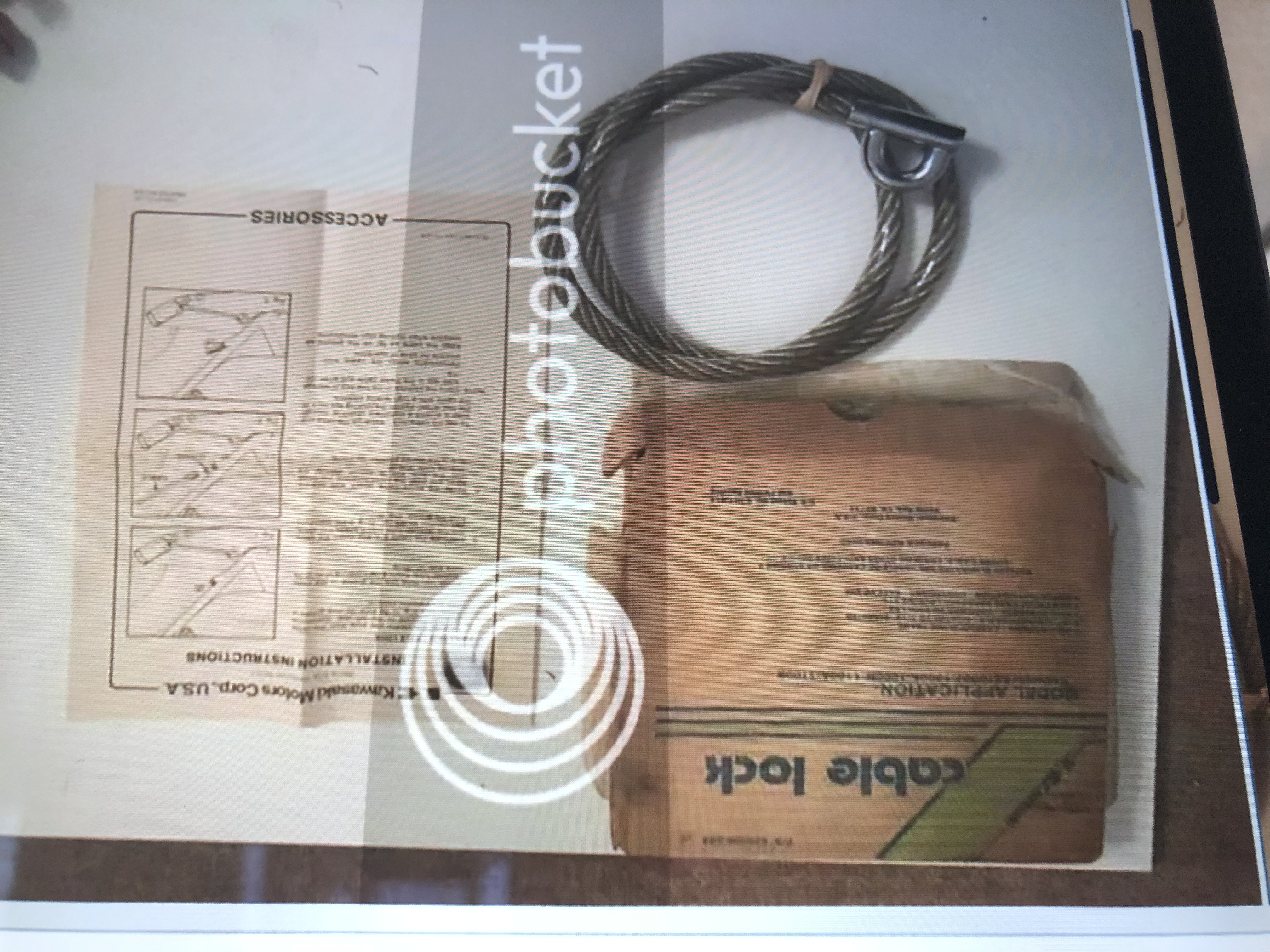

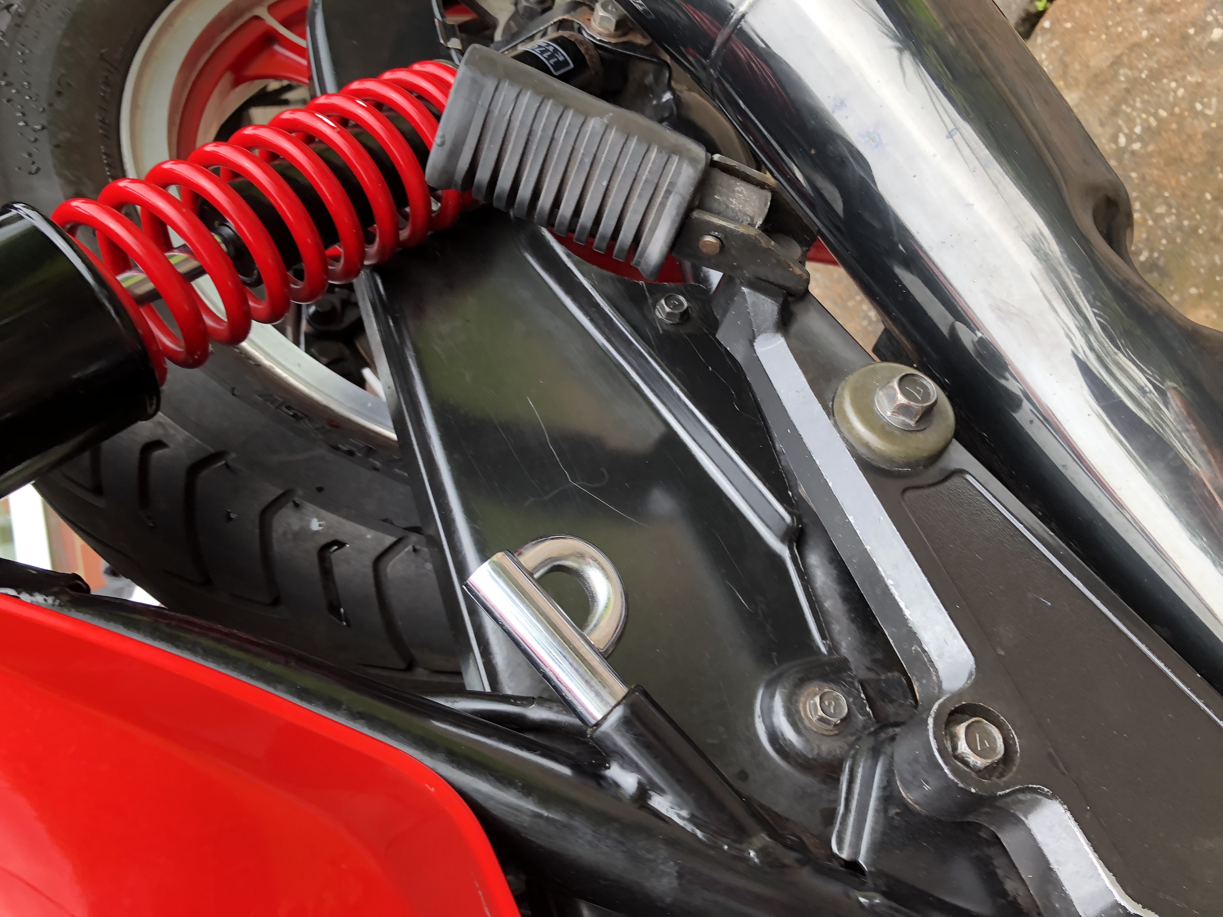

Hi Baff,cable lock was a Kawasaki accessory that slid down the frame ,a handy item for locking your bike up or helmets etc .Had one on my old gpz1100b2.
