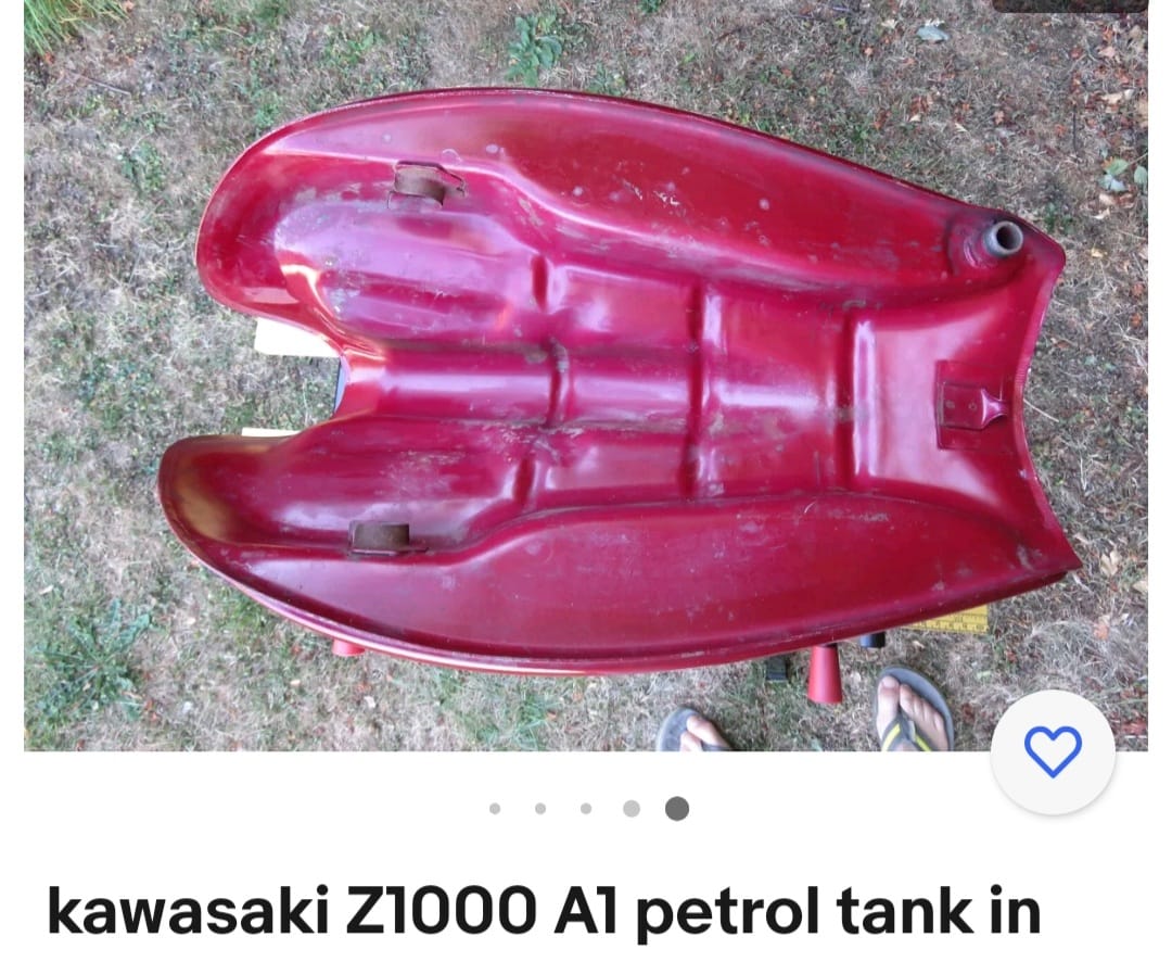

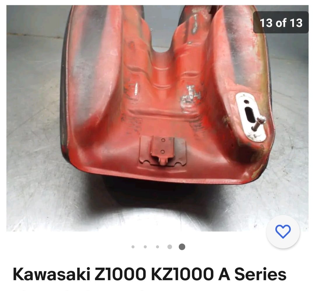

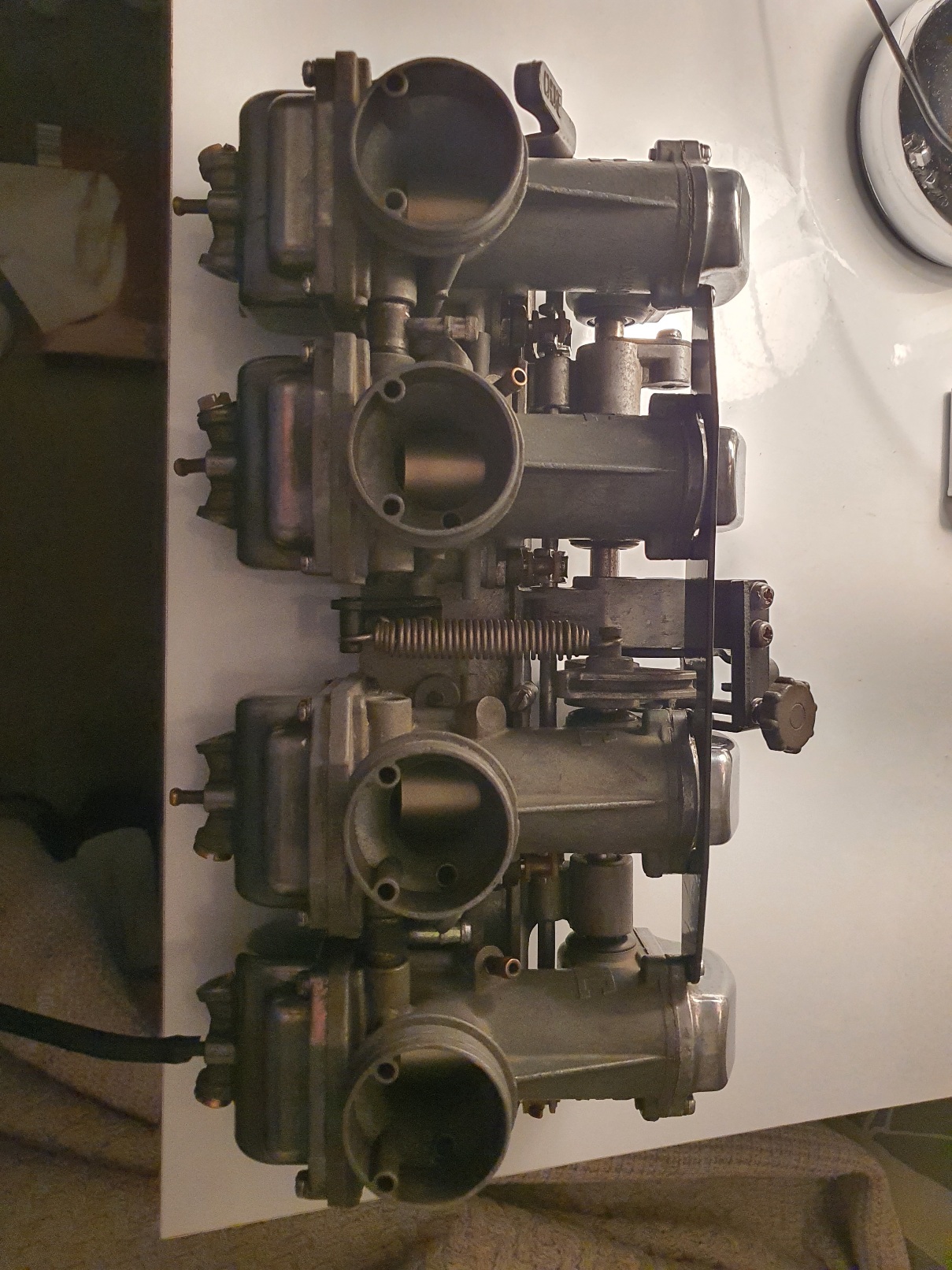

The one ive seen is different in that rather then has the threaded fuel tap it has the bolted on one, which makes you think its a Z650 but apparently later Z1000 A2 had this type of tap and the A4 graphics def fit on and look correct. The bolt on tap poses yet another issue as my Z900 has twin fuel outlets 1 for each pair of carbs, the bolt on 1 only has a single outlet, I could use a Y piece but not sure you would get enough flow at high revs to keep floats filled.
Also my fueal taps brand new the other isnt so may well leak adding to the cost to replace it. Or is there a better way to do it, i know later carbs have a balance pipe on float chambers but my carbs dont have this.

Just had another look at that ebay tank. It looks to be 1000 a2 not 650 as I previously thought.
Re: What other fuel tanks fit Z900 A4?
Yes that seems to be general consensus, it does look very similar to A4 and will obv fit the frame, its just the tap only having 1 outlet, whereas mine has twin, which feeds each pair of carbs, guess you could use a Y piece but not sure if you would get sufficient flow to carbs?

Don't think tap flow rate would be an issue. Imagine if the tank was full but off the bike. If you turned the tap on and let it flow to empty. It would empty in within 10 minutes.
If you used a tank of fuel every 10 mins whilst riding you wouldn't get between petrol stations.
There's this one on ebay also.
Item number 155420123713.
Either would need Sean's attention anyway.
Thanks Warren, think youre right, prob just over thinking it, guess when you've come up against as many issues as i have recently you look for things that arn't there just in case.
Yes seen that one, again its a collect only 100 miles away, and the badges recess and fixing holes been filled so you'd have to either try and strip filler off or glue badges on, not sure how secure that would be even with 3m tape, also you'd still have the screw holes in badge which would look unsightly. Then it may uncover other damage thats just been filled? Which means more work for painter so price goes up! Vicious circle
Everything you look at has pros and cons, nothings just straightforward, but guess thats trouble with 40+ year old parts!
