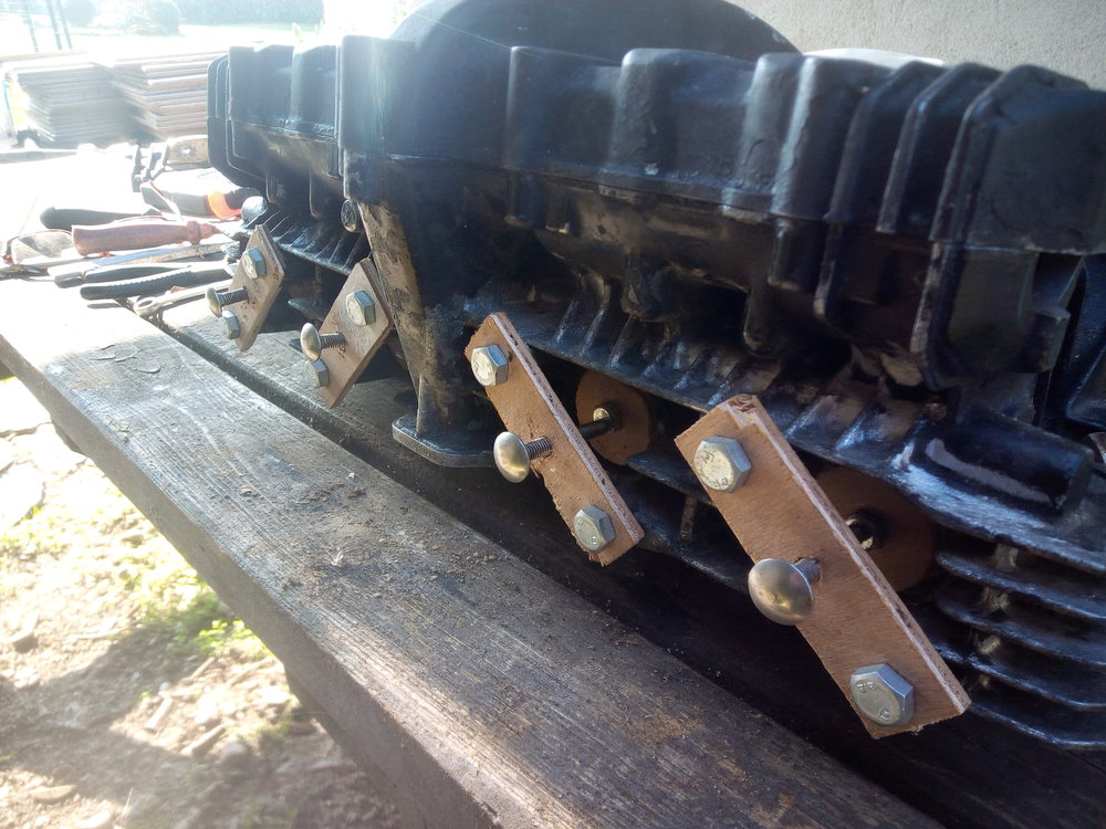

Continuing to strip the paint off the cylinder head on the GPz11 and I'm losing the will to live. Getting between the fins with nylon brushes on a drill with the help of thinners is doing my head in. (Philippe, you must have the patience of a saint)

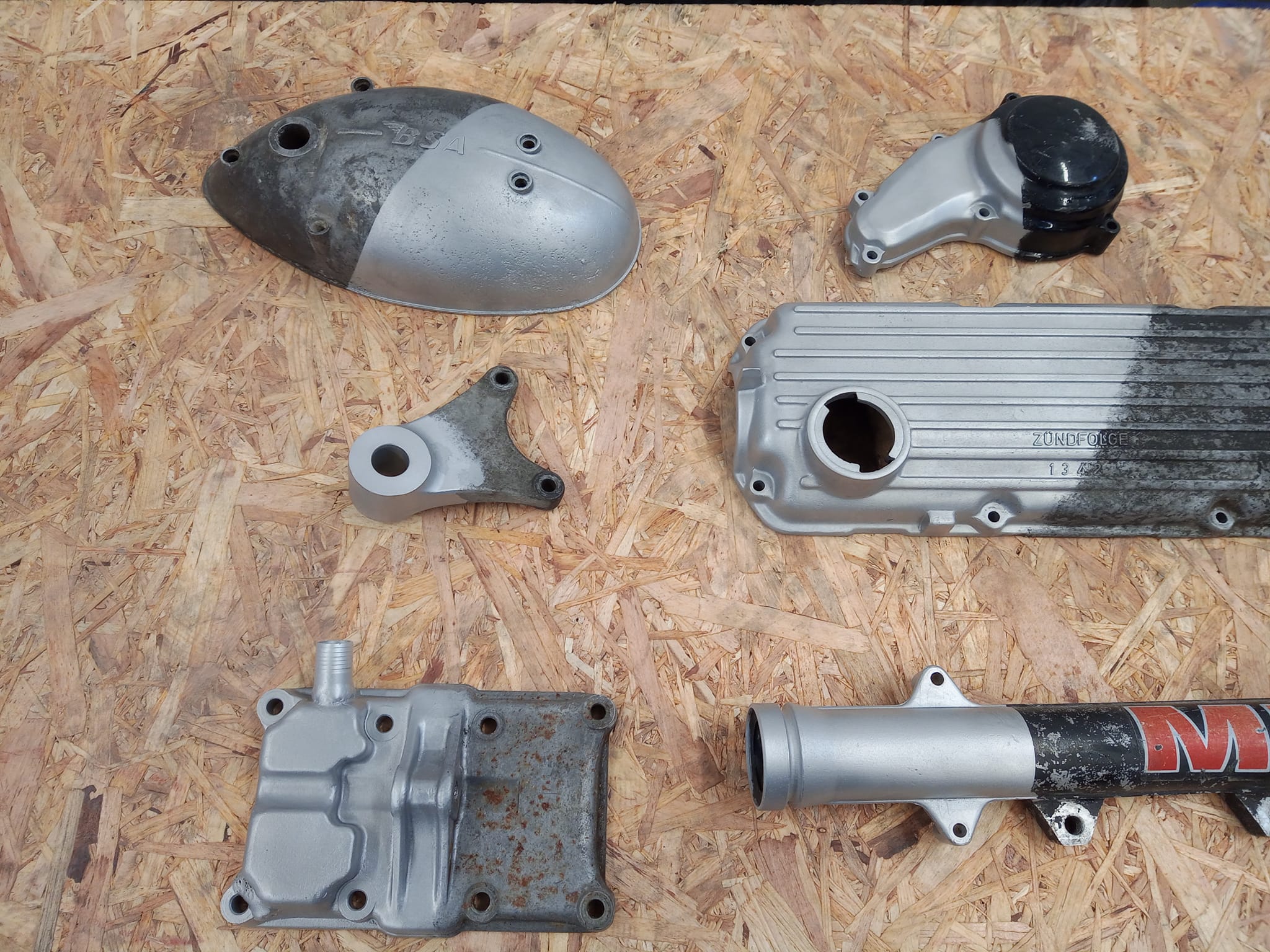

Anyway, I have a sand blaster (plasterers bath, not a cabinet) and have had very good results with the barrels, cam cover and sump. I'm leaning towards doing the engine casings and cylinder head with 0 grade SAND . I realise the implication of sand being left in the engine and wrecking it so everything will be gaffer taped to within an inch of it's life, then jet washed followed by warm soapy water and then another jet wash.
Question, is this OK or a very bad idea? I am quite happy to be shot down in flames but don't want the engine to be.

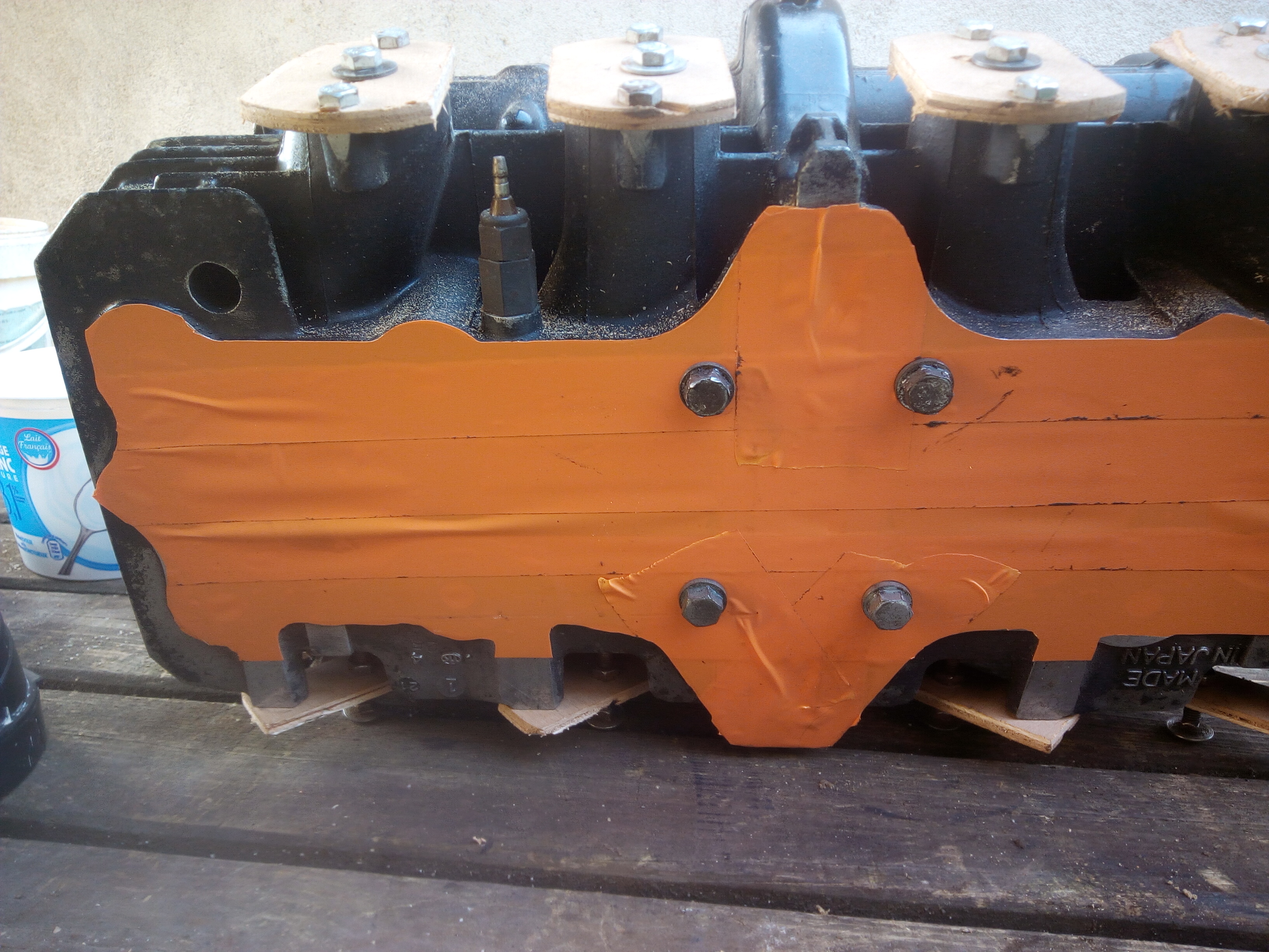

#6 PostAuthor: moizeau » Sat Mar 04, 2023 5:49 pm
Reckoning on stopping it getting in.or minimal

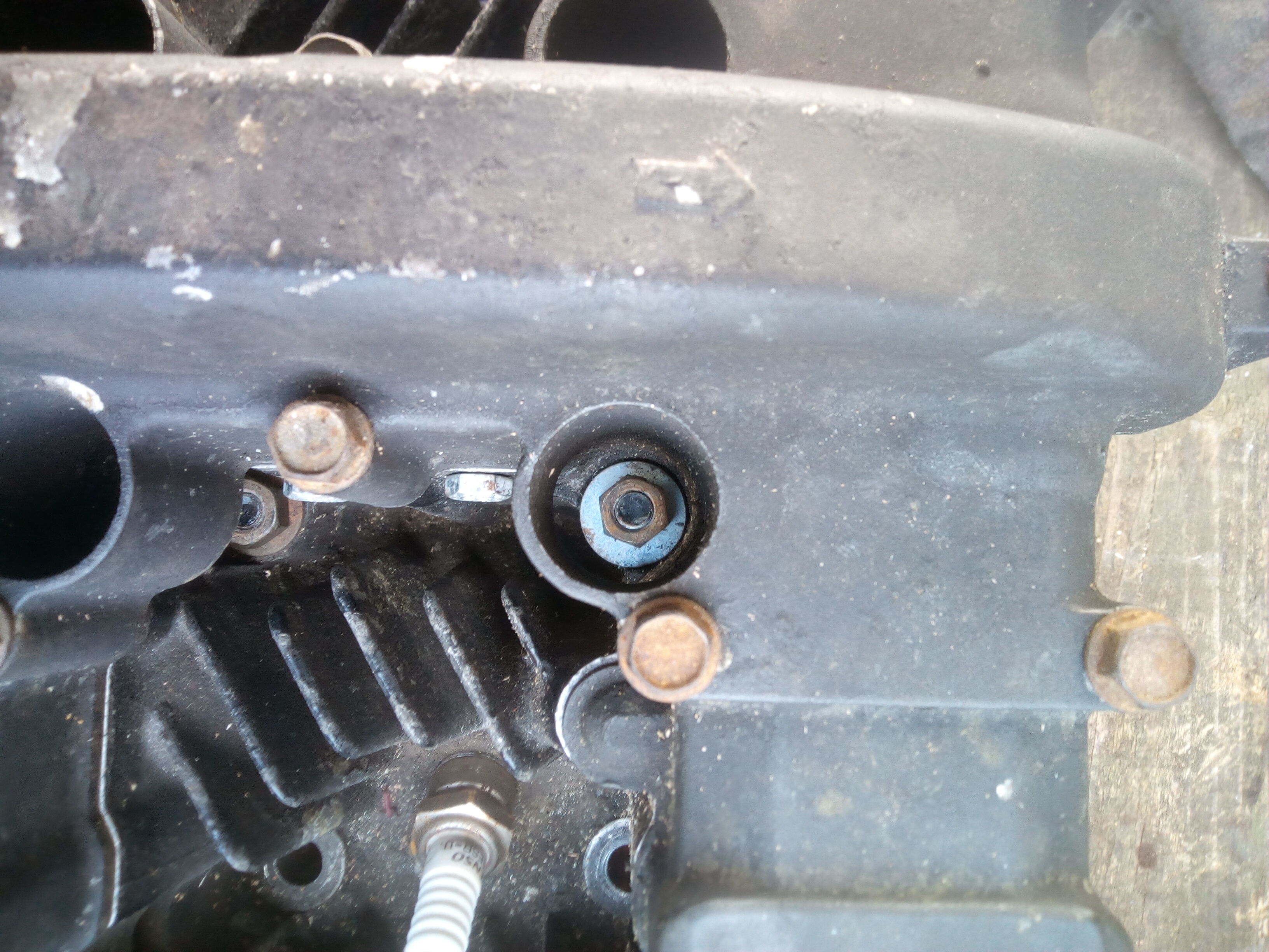

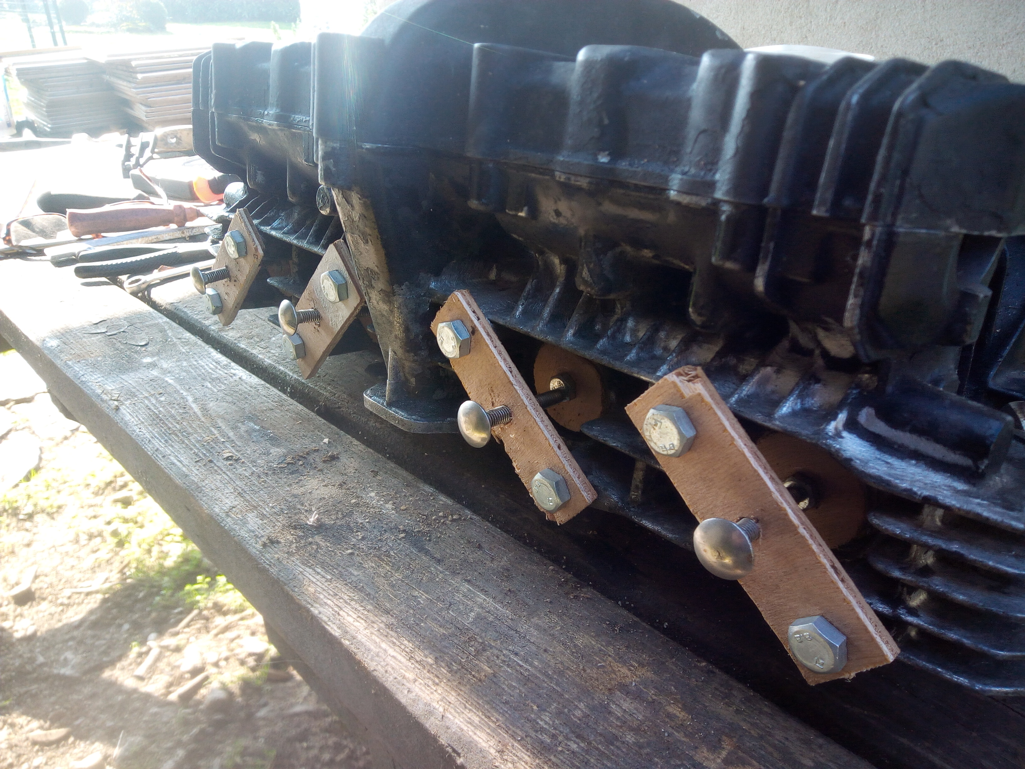

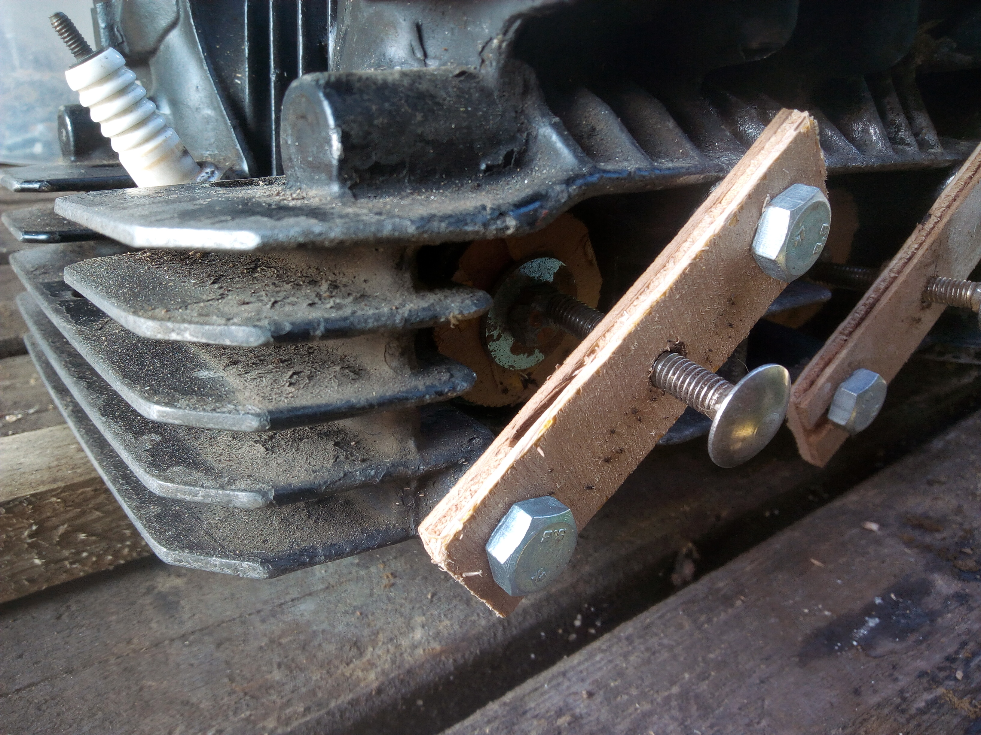

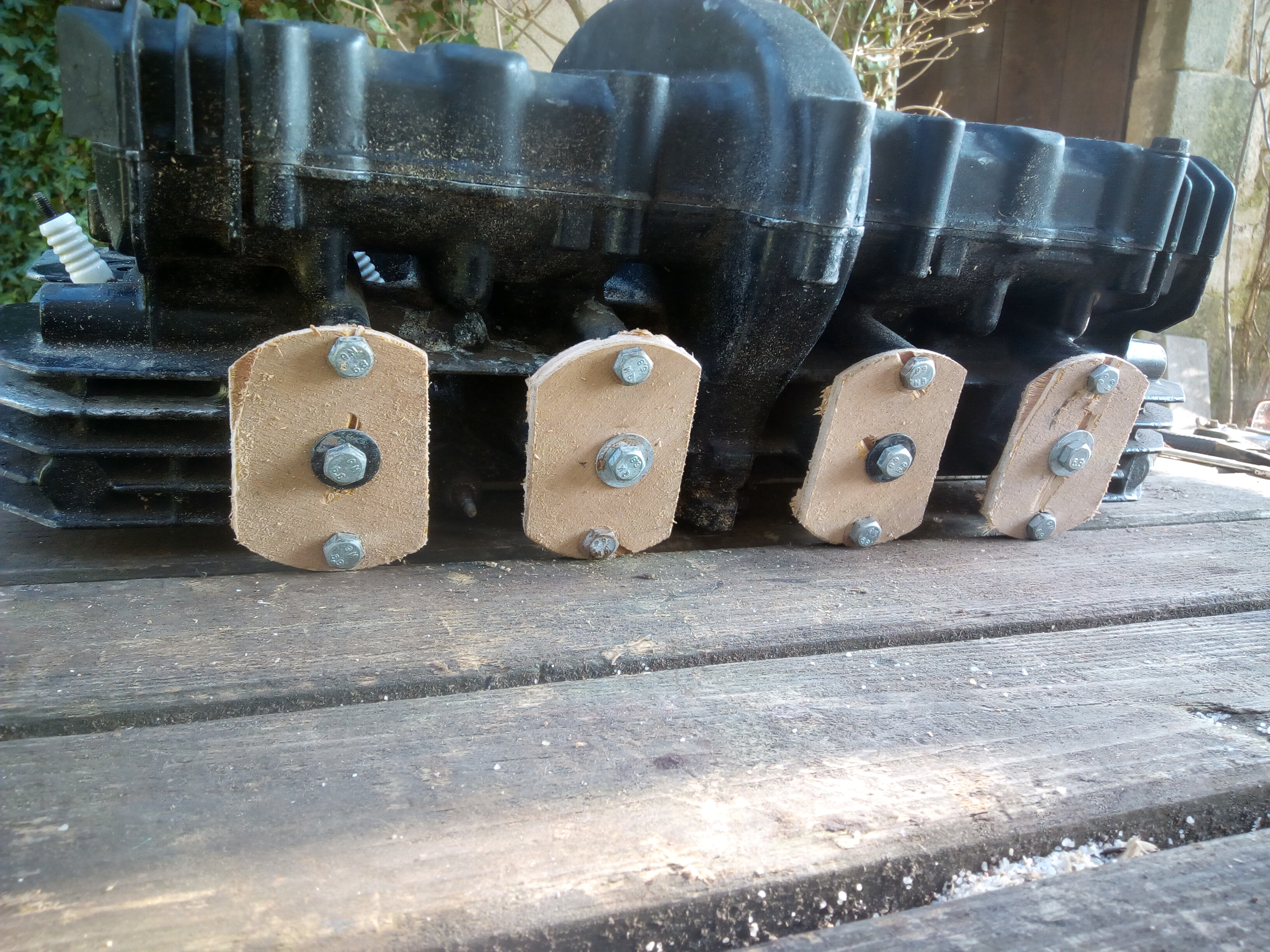

I've also put a sacrificial cam cover on, all the cam cover bolts, stuck rag where the cam end rubbers go and taped them and fitted the temp sensor.
Have I missed anything? Also some old plugs. The grade 0 sand is like flour, not very aggressive as in, no good for rust

#7 PostAuthor: Andy M » Sat Mar 04, 2023 9:54 pm
If the blaster has enough pressure to remove the black coating it will wreck the ply you are using on the port plugs . I blast items and have done heads and barrels etc . If you remove the valve gear etc there is no need to plug the ports , you will obviously have to clean it thoroughly after . I use crushed glass for dry blasting , have used ally oxide in the past. Dry blast only will leave a dull finish which will pick up dirt easily eg finger prints etc. You need it vapour blasted if staying bare .
