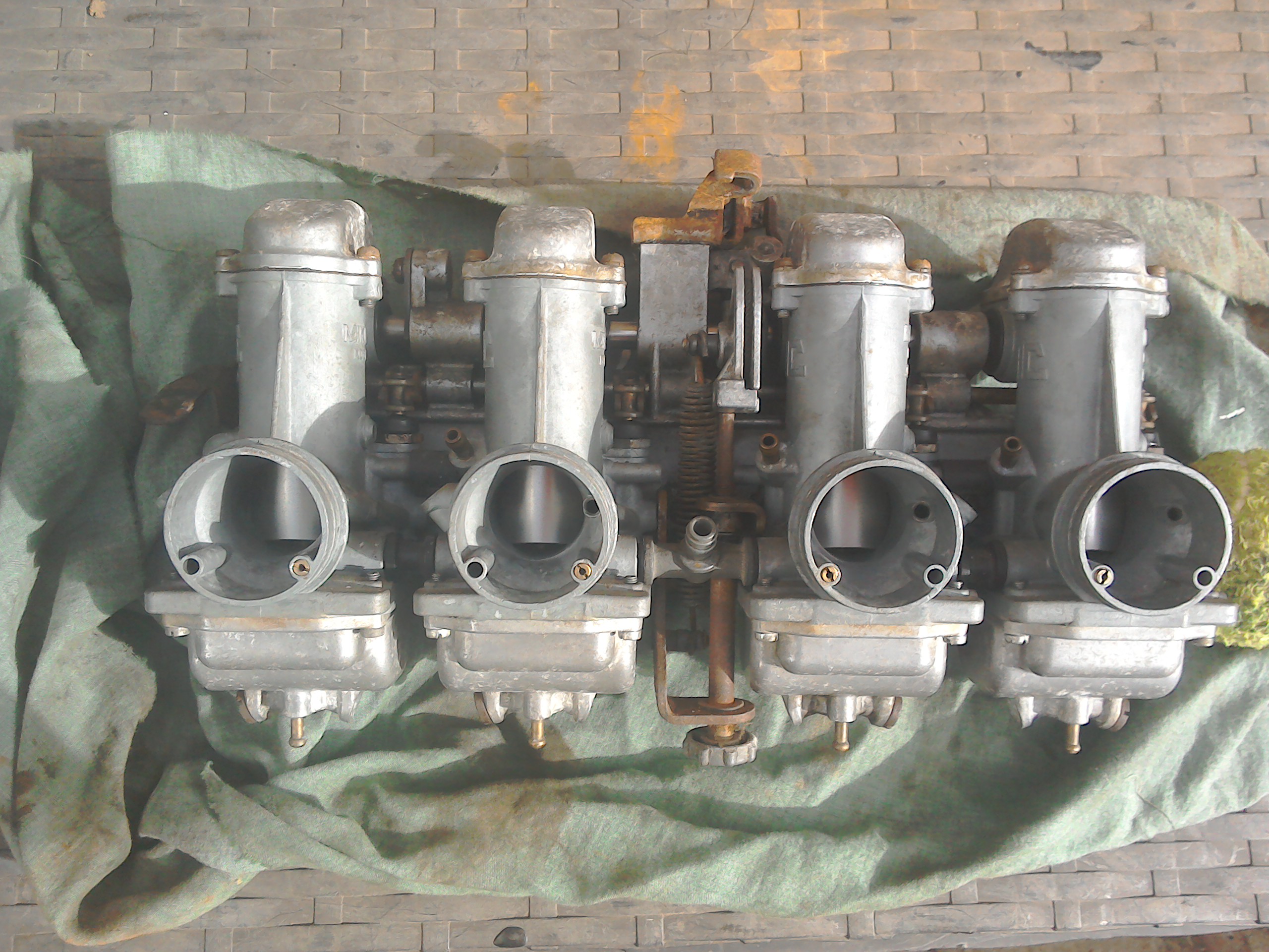

Bike was fitted with air ram foam rivers when I bought it just finished cleaning out the carbs just need confirmation these little correction jets are in the right location as just looks strange.

Yes! Those air corrector jets are in the correct locations.
Ideally they should be set flush or slightly below the surface of the carb mouth.
