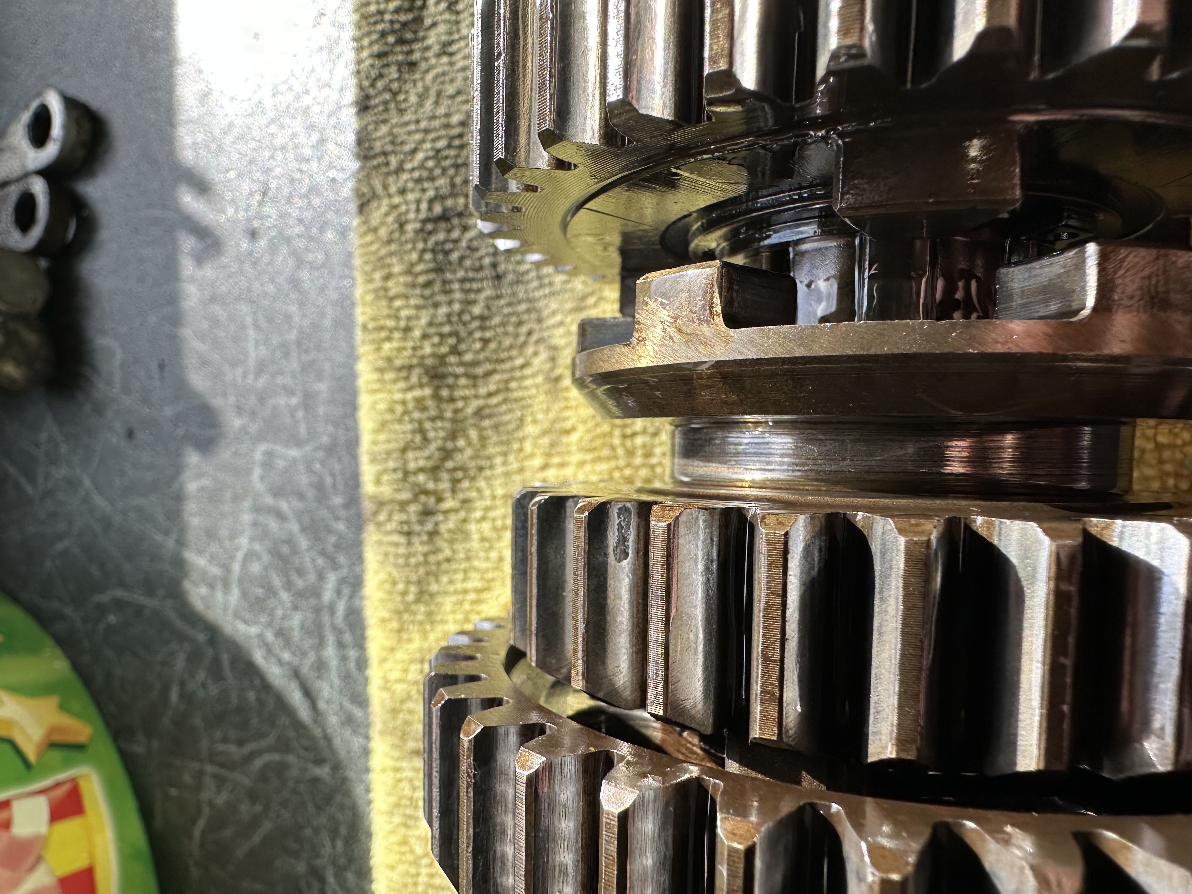

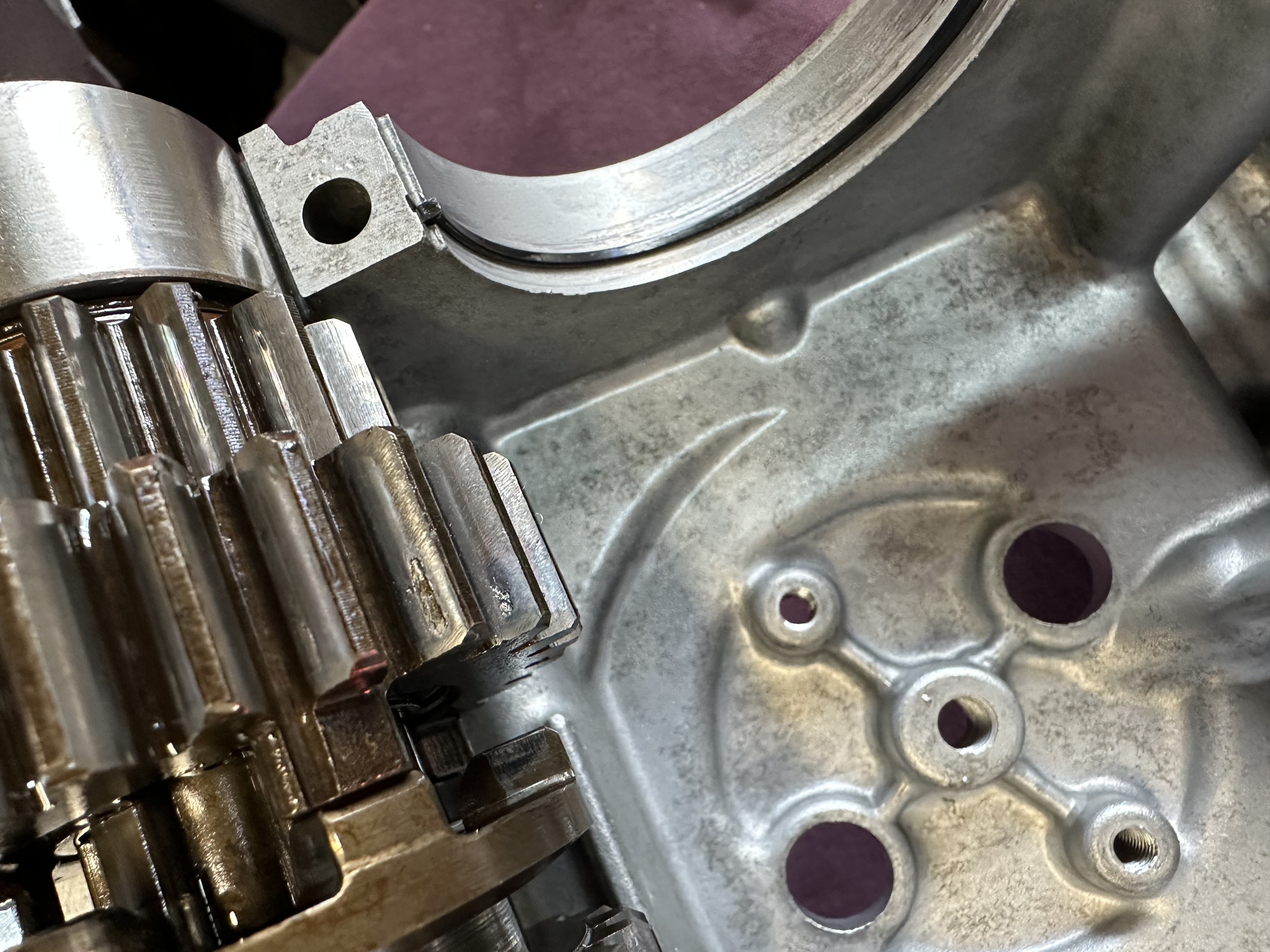

So I started the engine re-build today and while checking the gearbox clusters I see damage on the teeth of both 5th gear cogs, first question, is this a common issue? second question am I likely to find a decent pair of gears? anybody on here got some by chance?? I'm kicking myself because when I stripped the bike I found the gearbox main shaft bearing broken up and should have checked the clusters then
Pictures attached to show the extent of the problem.
I am not confident doing the strip of the clusters myself so ideally need somebody to do the rebuild of the clusters and fit the new bearings too. Anybody able to help please.

So is this something the 900 is known for?

PhilMill63 wrote:So is this something the 900 is known for?
No!
It's just high mileage or infrequent oil changes , hard use etc etc..

Thanks, I'll take some pics, its only 5th gear I think. I'll have a good look today.

If I can bump this back up, Warren looked at his clusters and they are different (different number of teeth) so I'm still on the hunt. I have found an NOS gear in the US (pt no. 13136-042) for the shaft on the clutch side but still on the hunt for the one on the sprocket shaft.
Another question, I cannot remove the bearing behind the sprocket, can anybody suggest a bearing puller that will fit in the small gap behind this bearing? don't want to buy something that will not fit, its quite tight there. Once I get that bearing off I should be able to strip the shaft and get to the 5th gear.
What's the thought if I cannot get the gear and only replace one? the one I can get seems to be the worse of the two but don't fancy doing another engine strip if I get noisy gearbox.

I did replace both in the end, managed to find them.
