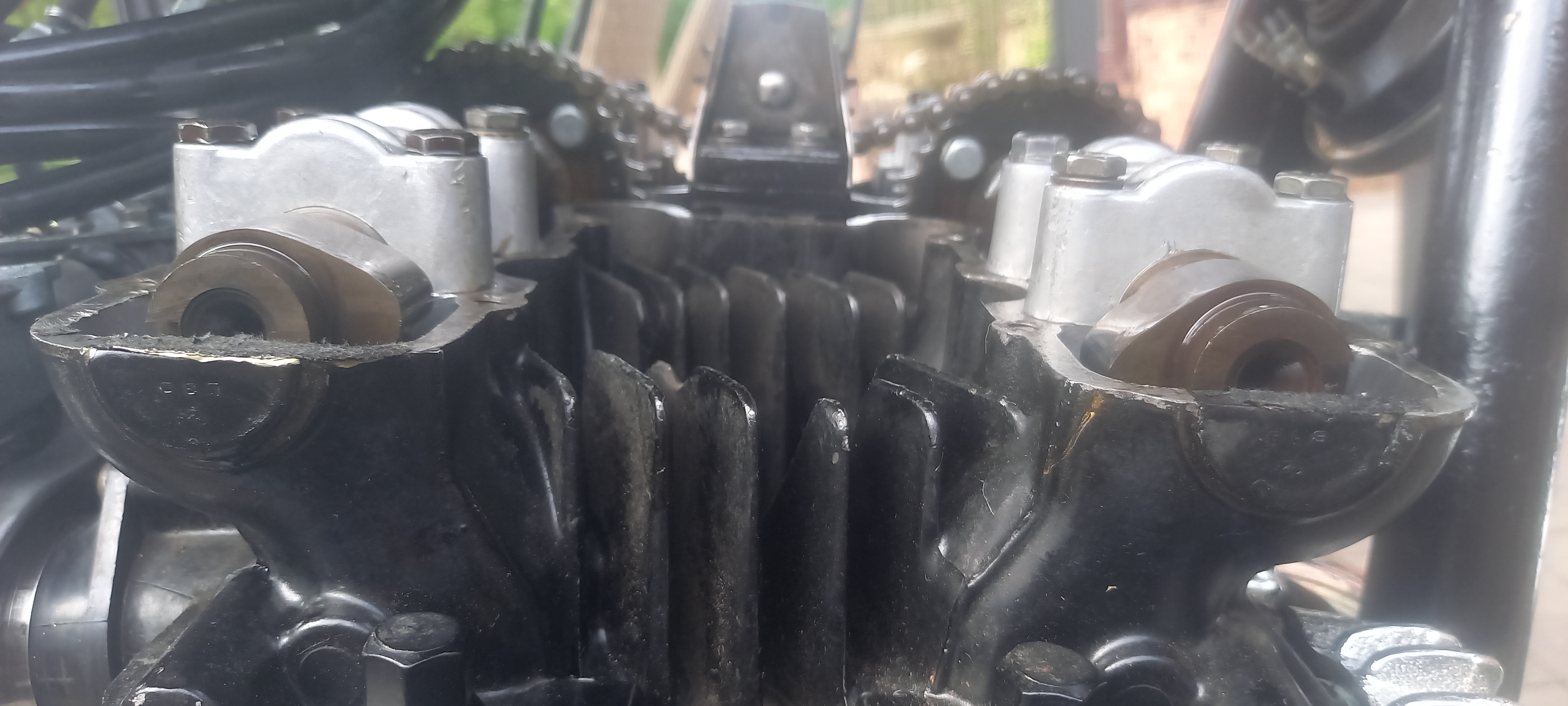

Set timing mark on ignition to TDC for 1 and 4.
Took cam cover off.

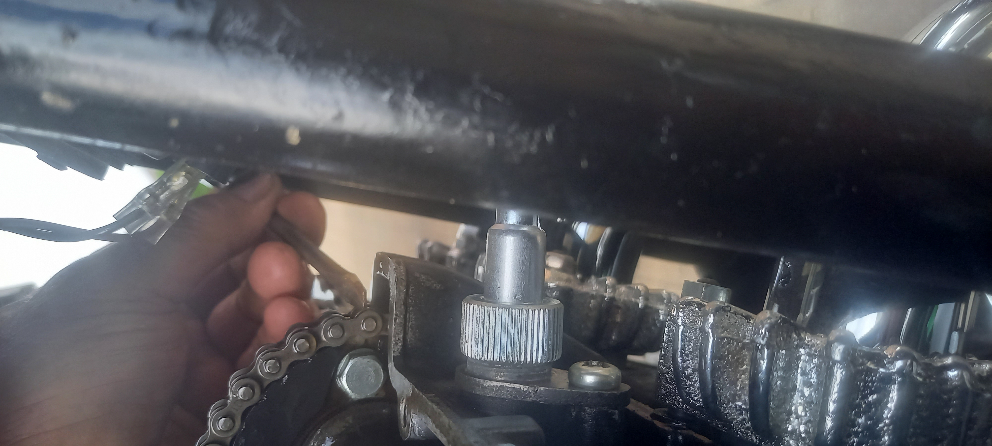

Lobes pointing towards each other .....inlet cam cut out was halfway and level with head.....but...exhaust cam cut is, in my opinion, sitting too high.
The cam sprocket mark is sitting a bit high too (mark at point of screwdriver) however I've counted 28 links from the one above the mark and it is fine.
Should the exhaust cam be taken out, moved to line up, then reposition the 28th pin on the inlet cam?
In my mind it should be but I just need clarification from people who know better.

If the timing mark is on tdc then i'd move the cams clockwise a tooth as you suggest.
It's better to have the camchain pin just below the gasket face than clear above it.
That way the timing can only drift closer to the correct timing as the chain wears as opposed to further out.

I've been caught out this way on occasion - looking at your photo of the screwdriver pointing at a pin - the screwdriver is pointing at pin ZERO then start counting from there. It's NOT number 1.
gray
