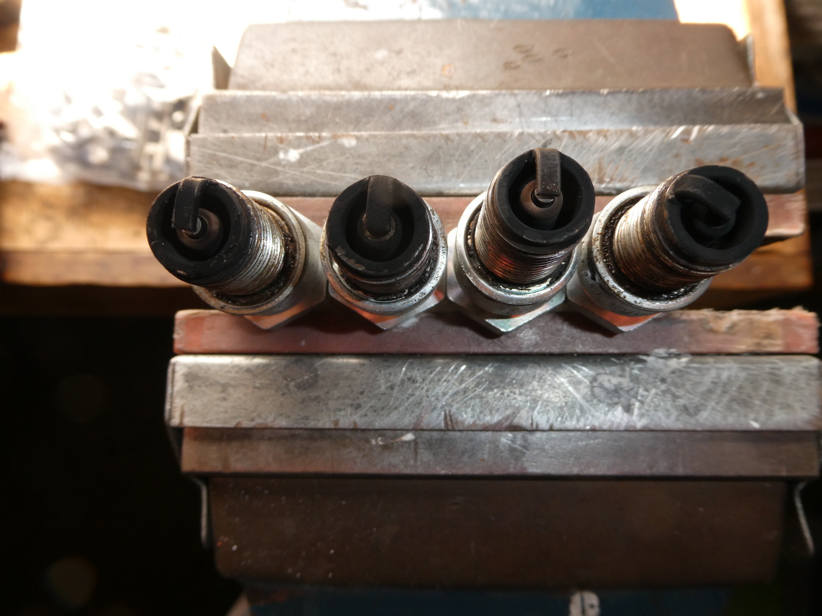

My UK 1976 Z900A4 is completely std, with std carbs, jets, air box etc and original exhaust. Fitted with NGK B8E S plugs which are constantly black and sooty, see attached. It is also fitted with electronic ignition.
Carbs have been stripped and cleaned several time together with the float levels but all the plugs remain black and sooty. It ticks over nicely at around 1000 rpm but stutters and stalls when coming off tick over or when closing the throttle and opening again when coasting etc. Above 2K rpm or so it picks up cleanly and rides well.
Any suggestions as to the likely cause and possible remedy?

Very possibly choke plunger seals.

Yes! At 40 years old all the seals will be worn regardless but some can leak worse than others randomly across the four cylinders..
Repairing them will either entierly cure or at least reduce your problem depending on whether you carbs have another issue but having them done always makes an improvement and the new Viton seal prevents against damage from the fuels ethanol content which the originals can't do..
The symptoms among many others depending on the severity of the leakage are sooty plugs, low mpg, poor idle, rough running, plug fouling when sat in traffic or persistent low rpms etc.
The seals are captive in the plunger head and were not a servicable part so need specific tooling to replace which i have developed.
They are £12.50 per plunger + return post ( £53.50 per set of four returned) and only the bare plungers need to be sent not the whole carbs.

Unless a plug chop was performed at high rpm the plug condition only indicates the a/f ratio of the pilot circuit at idle.
Sooty plugs are possibly due to pilot mix and incorrect mixture screw settings but most likely choke plungers seals are causing the rich running although there are other less likely possible causes.
A hotter plug shouldn't be needed.
Re: Z900A4 Black plugs
Hack, the amount of excess / un-necessary fuel you have used over the last 18 years could have bought you a colourtune. Currently around the £40 mark. If you get rich readings at idle speed with the colourtune and cant dial it out by the time you reach 2,000RPM using the air / fuel screws, you likely have worn choke plunger seals assuming everything else is ok; Correct size pilot jets and not worn out, not overly restrictive air filter, standard settings for needle and needle jets etc.
