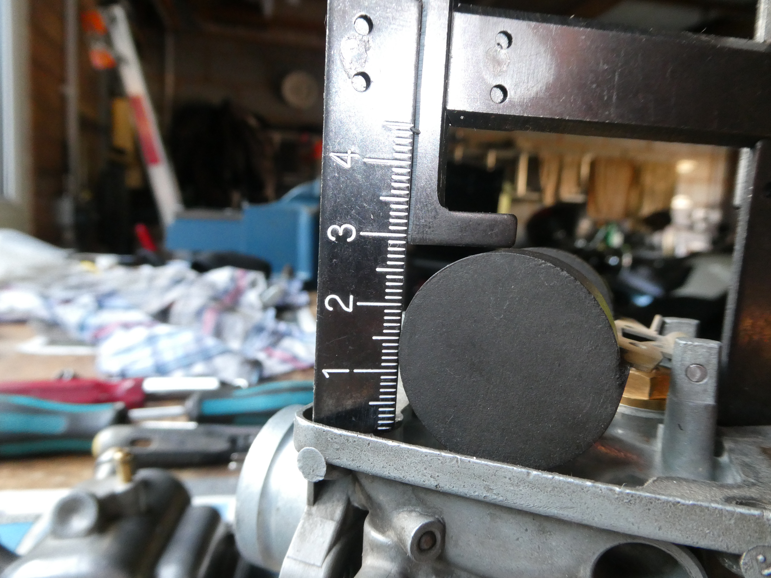

Looking to re-build the carbs and need to set/check the float levels, hence my enquiry which I have been advise should be 26mm from body face.
With reference to the attached mine are currently around 29mm from the face of the gasket, so around 29.5/30.0mm. So logically at that setting the petrol level will be lower than if it is set to 26mm which should be causing a weak mixture and not the rich mixture that I am getting.
So is 26mm the correct setting for the std 26mm carbs or do I have another issue as if I set it to 26mm I am surely going to have an even richer mixture?

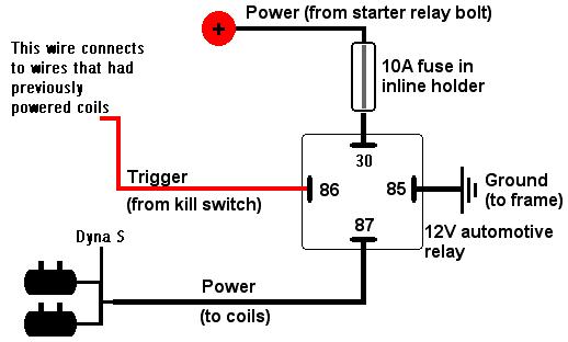

Have you checked the voltage to the coils? Low voltage will soot up plugs pretty quickly. As all four are the same all four carbs would need to have the same issue. If it were electical both coils and all four plugs would present the same symptoms.
If your only getting 10 - 11volts at the coil that would be enough yo soot the plugs.
Maybe time to fit a wired George relay mod to power the coils direct from the battery.

I did the 'George' relay mod some time ago, which initially seemed to help, but rich and sooty plugs remain.
However, at this stage I need some advice on the float levels as per my post and photo.

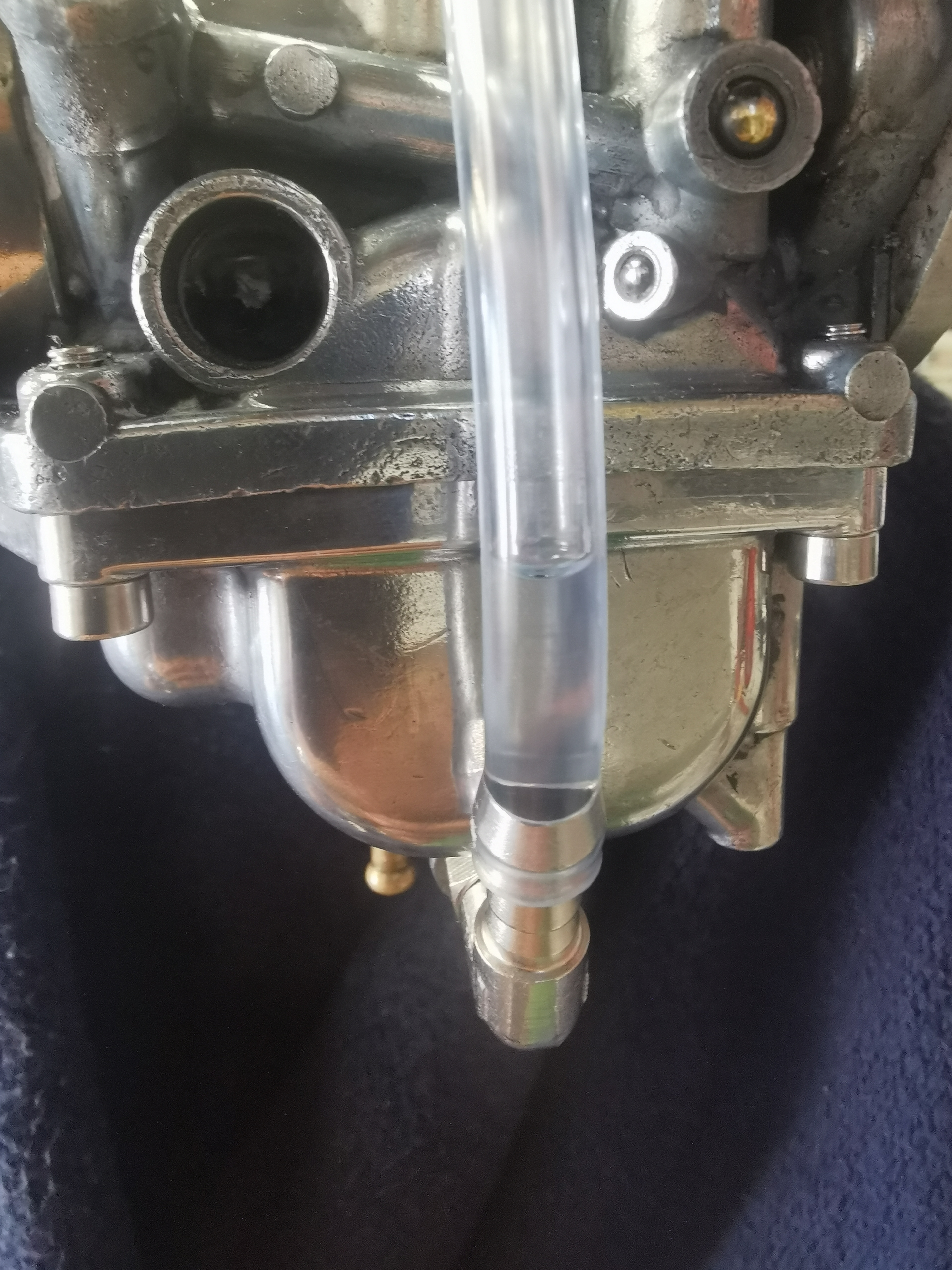

Seems little point in setting them upside down to a measurement to me as each float will behave differently under normal use and will need adjusting using the wet method anyway. The only thing worth doing in my mind at this stage is to ensure the floats are straight and leveled with its partner. Check all the brass hinges are straight and free and that the arms are not bent or twisted at all.
Regarding resetting the tangs I go for the tang to be bent towards the valve by the width of the tang metal. Ie if viewed level there would be no gap between the bottom of the tang thickness and the top of the float arm thickness.
This tends to mean that only a minute adjustment is required when setting them wet.

The low float heights probably indicate the previous owners attempt at solving the rich running..
They need to be put back to 25mm +/- 1mm which is correct for the A4.
The new Viton plunger seals will improve matters if not cure it entirely and future proof them.

Will set the levels to around 26mm.
Whilst the carbs are off I can do a wet level, which is much easier than on the bike, but it is such a tedious job and as another member has found very inconsistent. You do it once and think you have done it try it again and the level has moved which is why I would like to set to an initial static level but trying to understand why they are at around 29/30mm which would give a fairly low fuel level but I still have soot/rich reading plugs.
