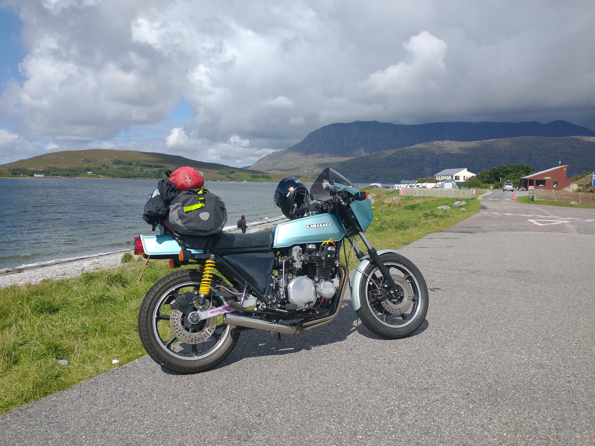

Might be a bit late to this - you've probably either got it or not by now! Anyway, here's a piccy of my Z1R complete with Metmachex - and yes, it's stamped Z1000. Of note - the torque arm off the original arm didn't fit the mounting on the new one (the casting is too wide to fit into the 'fork' of the torque arm). A chunky piece of flat bar sized to the same length makes a good substitute (or has done for the last 15 years or so
) - just make sure it's beefy enough not to flex if you use the back brake hard.
TTFN Grog
