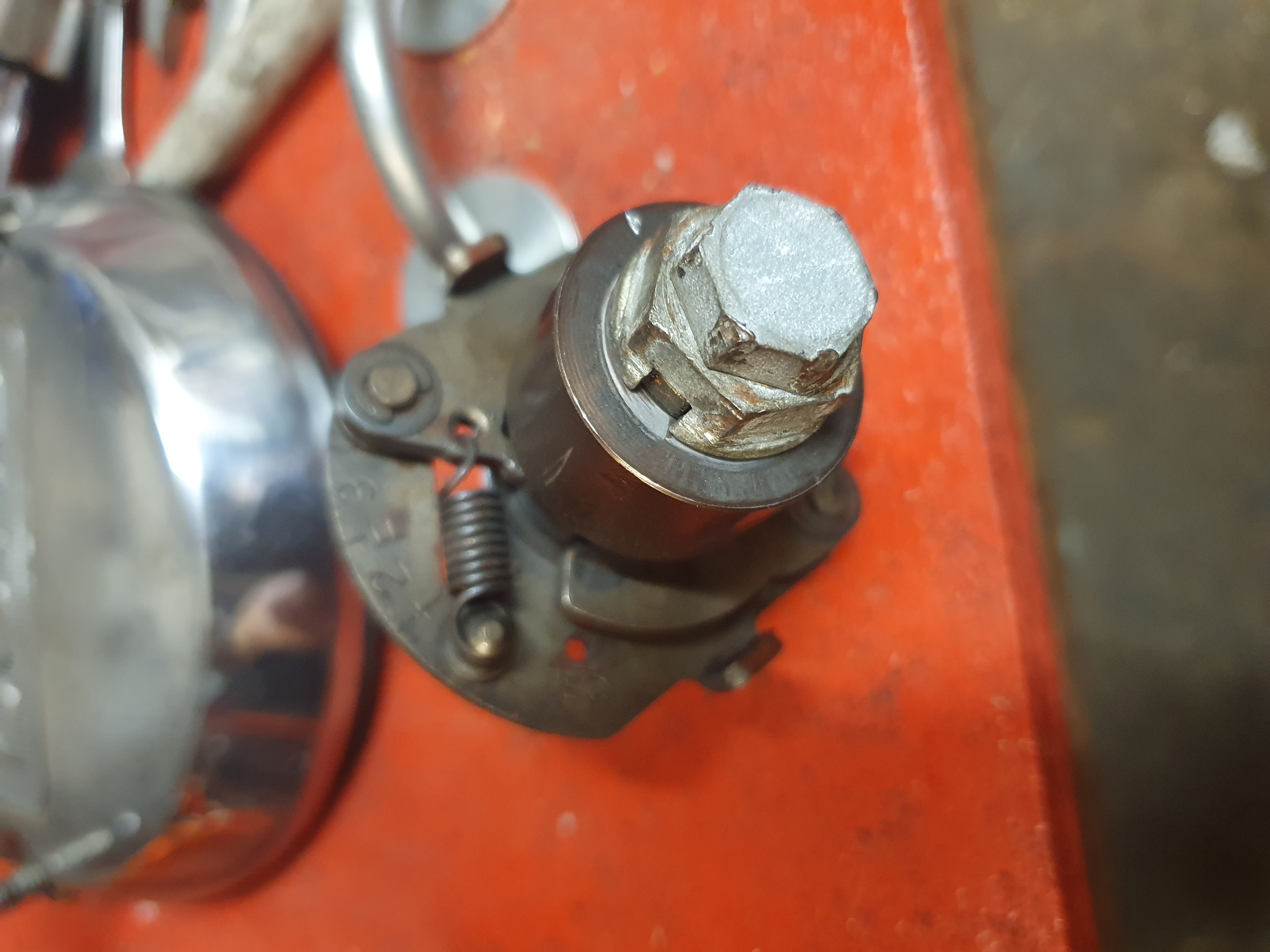

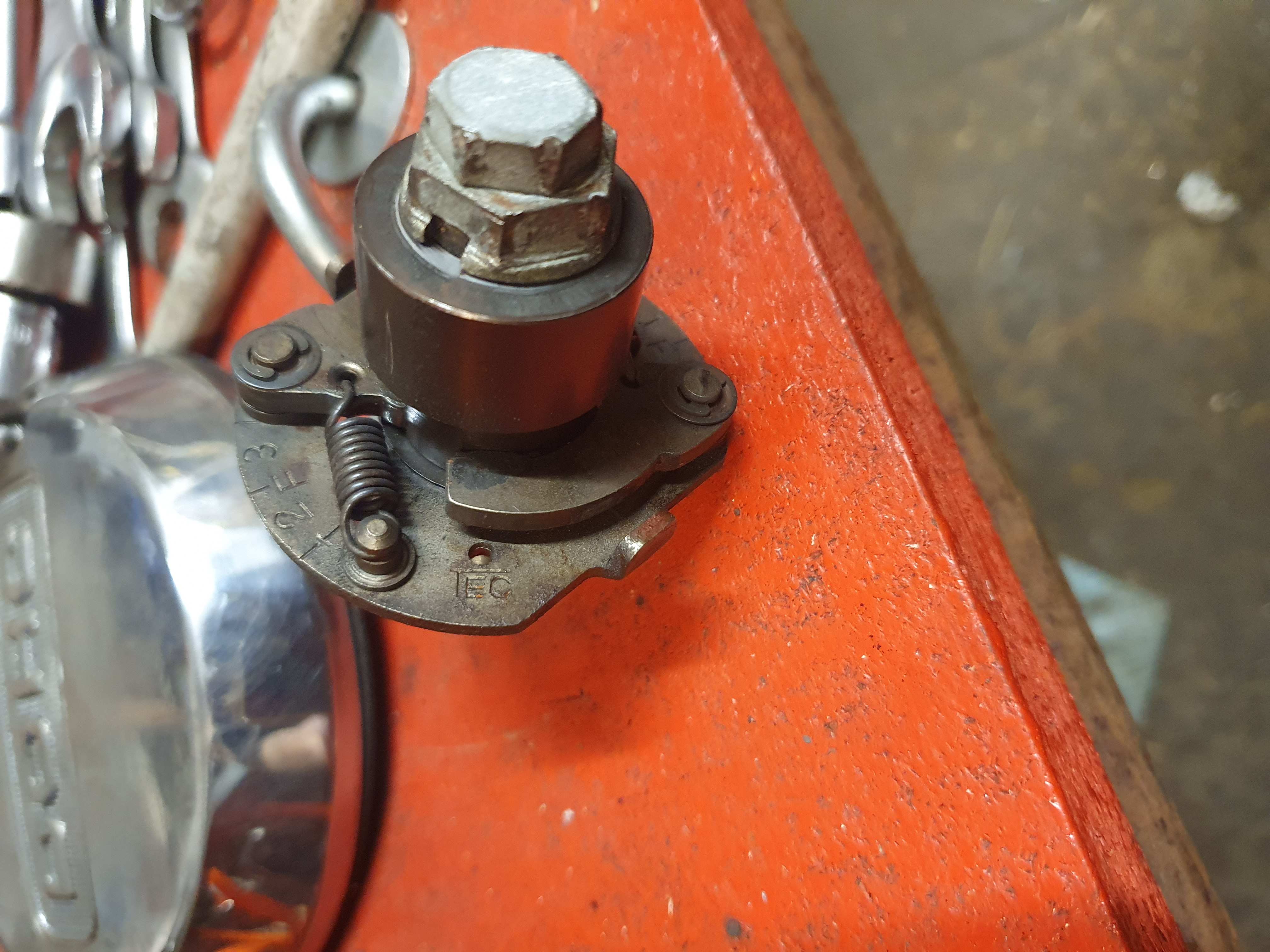

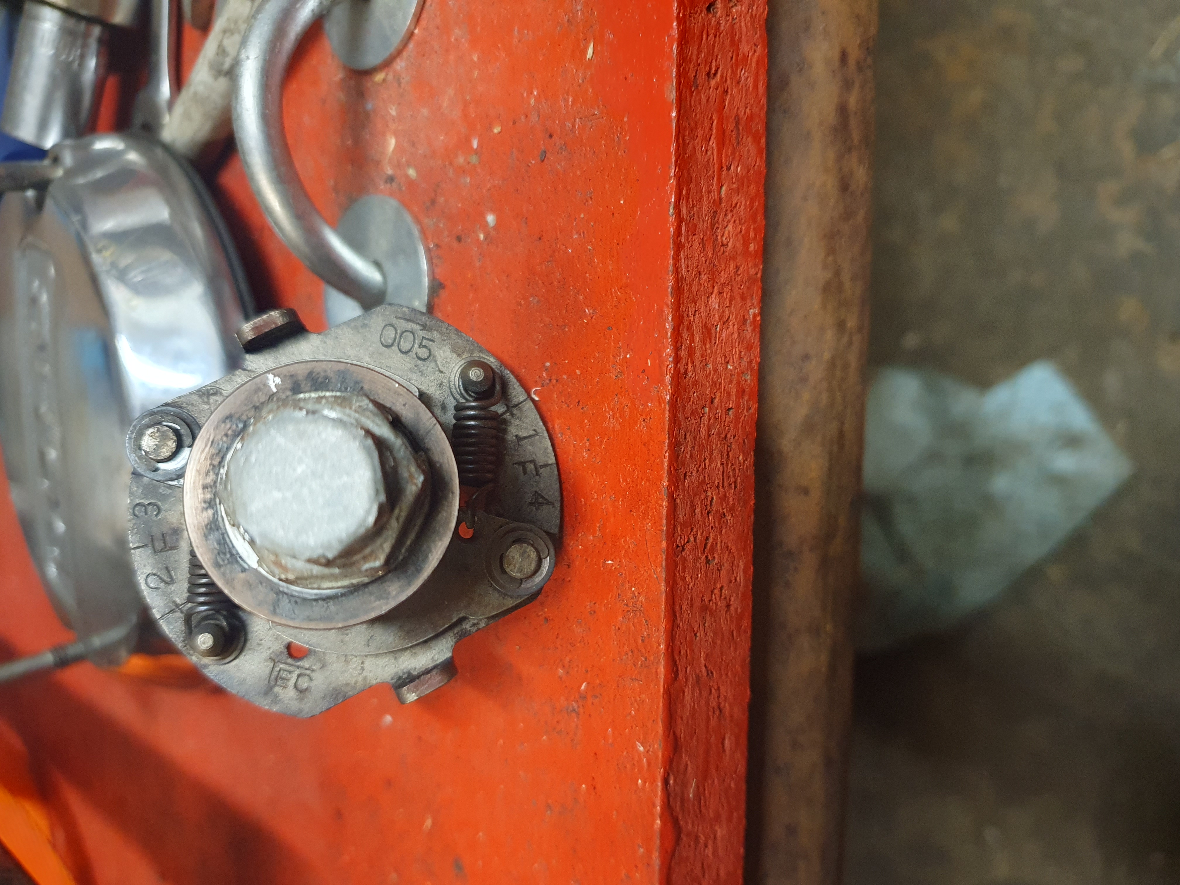

I have a KZ900 I'm trying to get going. It had a Dyna electronic ignition on it that was knackered so I am putting it back to points. Ive got the plate, points, condensers but the advance /retard plate doesn't look its original.
Could you knowledgable people have a look and tell me if its wrong and if so how I can get a replacement?

That is the correct 005 20/40 degree advancer for all Z900, Z1000 up to the Z1R D1 .
The rotor needs swapping for a cam though if you want to run points.
