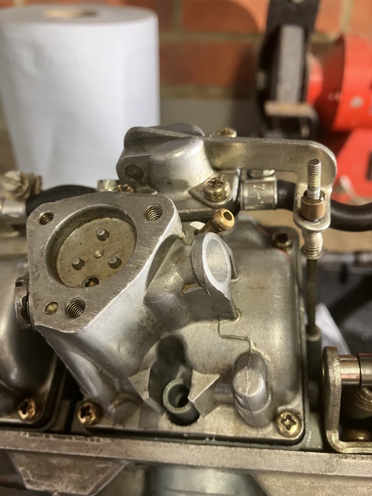

Hi all, I have never got my USA import 1980 Z1000 B4 LTD to idle right but once off the pilot jets it goes like stink. I have gone back to basics with new #15 pilot jets and 102.5 main and needles. There are no air leaks and the air suction gubbins is all in place. However, according to the Clymer manual for my model the pumper arm lever is supposed to have approx 10.8mm thread exposed after the nut. There is no way this is possible without pulling the valve fully open. Also, on my bike should there be a check valve with three screws? Its missing and what is there looks all capped off. Included in the rebuild kit I got a new diaphragm for it in addition to the pumper diaphragm but there is nowhere for it to go. I have added a photo (hopefully!) Thanks,

Swiss Gaz wrote: Also, on my bike should there be a check valve with three screws? Its missing and what is there looks all capped off. Included in the rebuild kit I got a new diaphragm for it in addition to the pumper diaphragm but there is nowhere for it to go. I have added a photo (hopefully!) Thanks,
Which size carbs do you have ?
They should be VM28's and have the triangular sensor diaphragm casting unmachined and not functional..
If they are VM26's they will have the casting drilled and it will need blocking off if you don't have the cap etc.

Hi, Yes, they are VM28s. What you see in the picture is the bottom of carb #2. I am assuming there was never a check valve fitted as there is no hole down the centre of where the check valve diaphragm pin would fit so I am assuming that's how it came from the factory. Its the 10.8mm setup on the pumper arm that has me scratching my head. I cant believe Clymer manual is correct right. 4mm looks more like what it needs to be. I am thinking this is just a red herring to my idling problems.

Swiss Gaz wrote:Hi, Yes, they are VM28s. What you see in the picture is the bottom of carb #2. I am assuming there was never a check valve fitted as there is no hole down the centre of where the check valve diaphragm pin would fit so I am assuming that's how it came from the factory.
Yes! The 28's used the same bowl casting but unmachined and no valve etc because they didn't employ the triangular sensor diaphragm..
