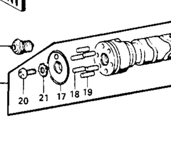

Re: Z900 A4 Strange gearbox issue, anyone help?
If memory serves, the round plate in the end of the selector drum ( the one with the raised dimple which triggers the neutral switch) sits on top of 5 or 6 posts, and is held on by a crosshead screw ( I think). If it has been put on in the wrong place, 4 posts further on, you will get the symptoms you have found ( but it shouldn't be possible to put it on wrong as 1 post is longer)
Lean the bike over to the R , take off the gear-lever, footage then sprocket cover. Remove the sprocket then the alloy plate behind it to get access to the gear pawls, and end of selector drum, remove the end and see if it fits better 3 pins round . then your indicated neutral will match actual neutral

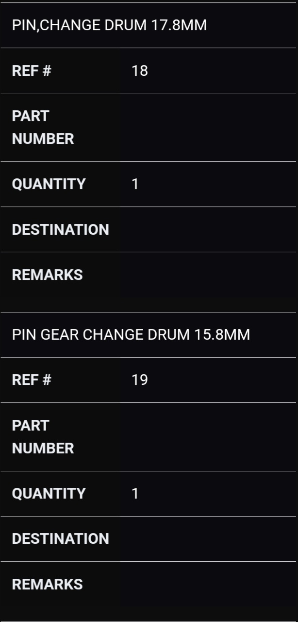

Parts 18 & 19, only 2mm difference in length.
Mmm! That makes sense i will give it a try tomorrow.
Thinking I've probably put plate on wrong hence why i now get 2 Neutrals, never mind the lamp not lighting when it should.

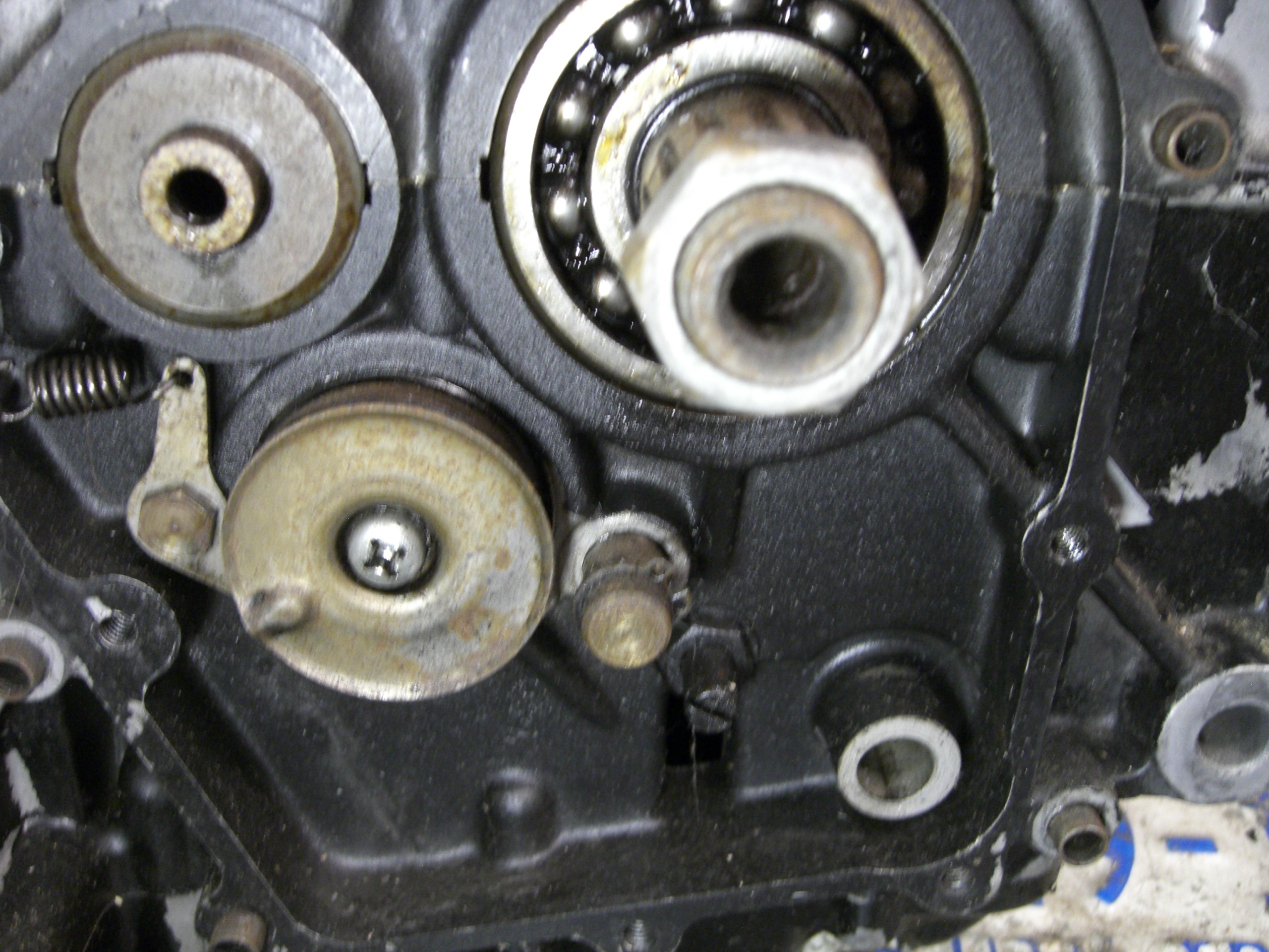

Just taken photo of my Z9 A4 in neutral as engine is in bits on bench
