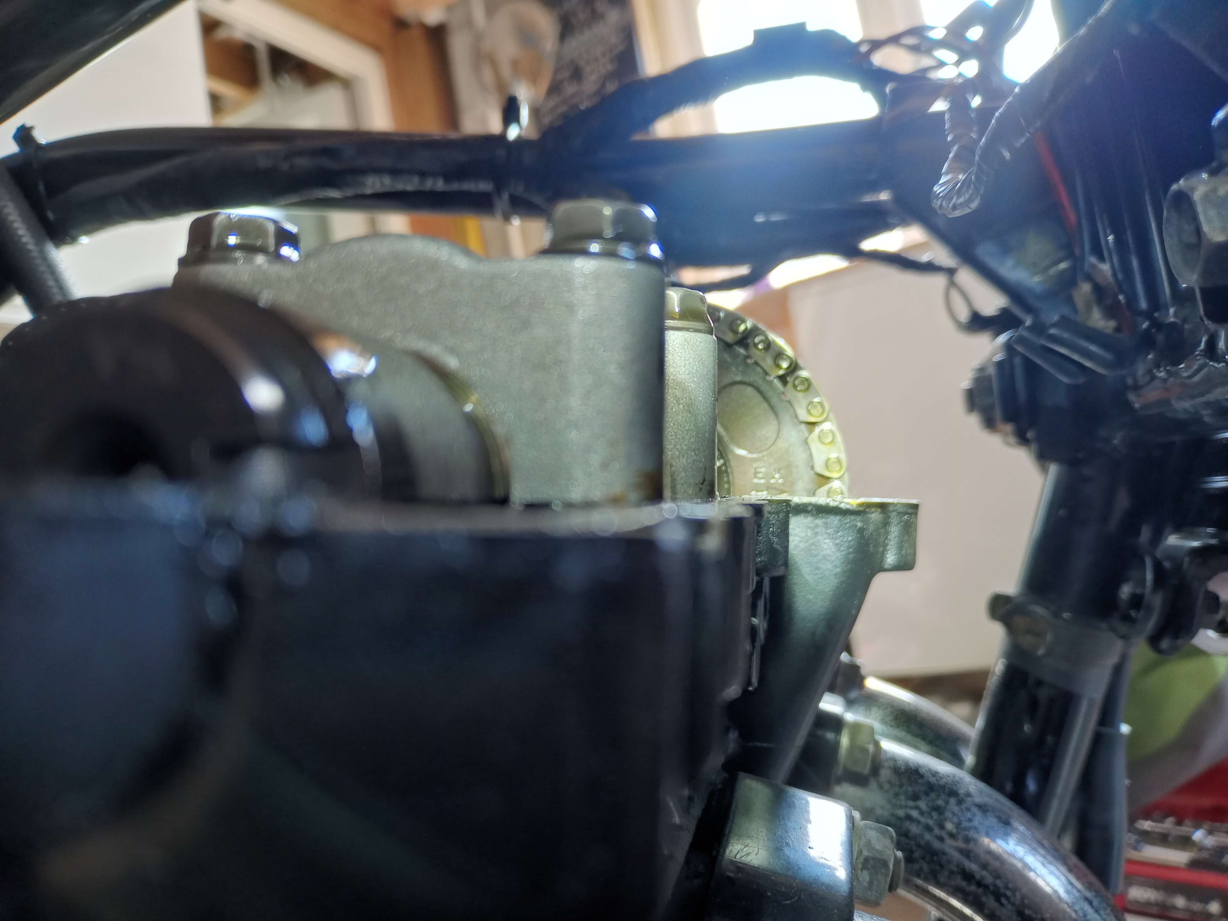

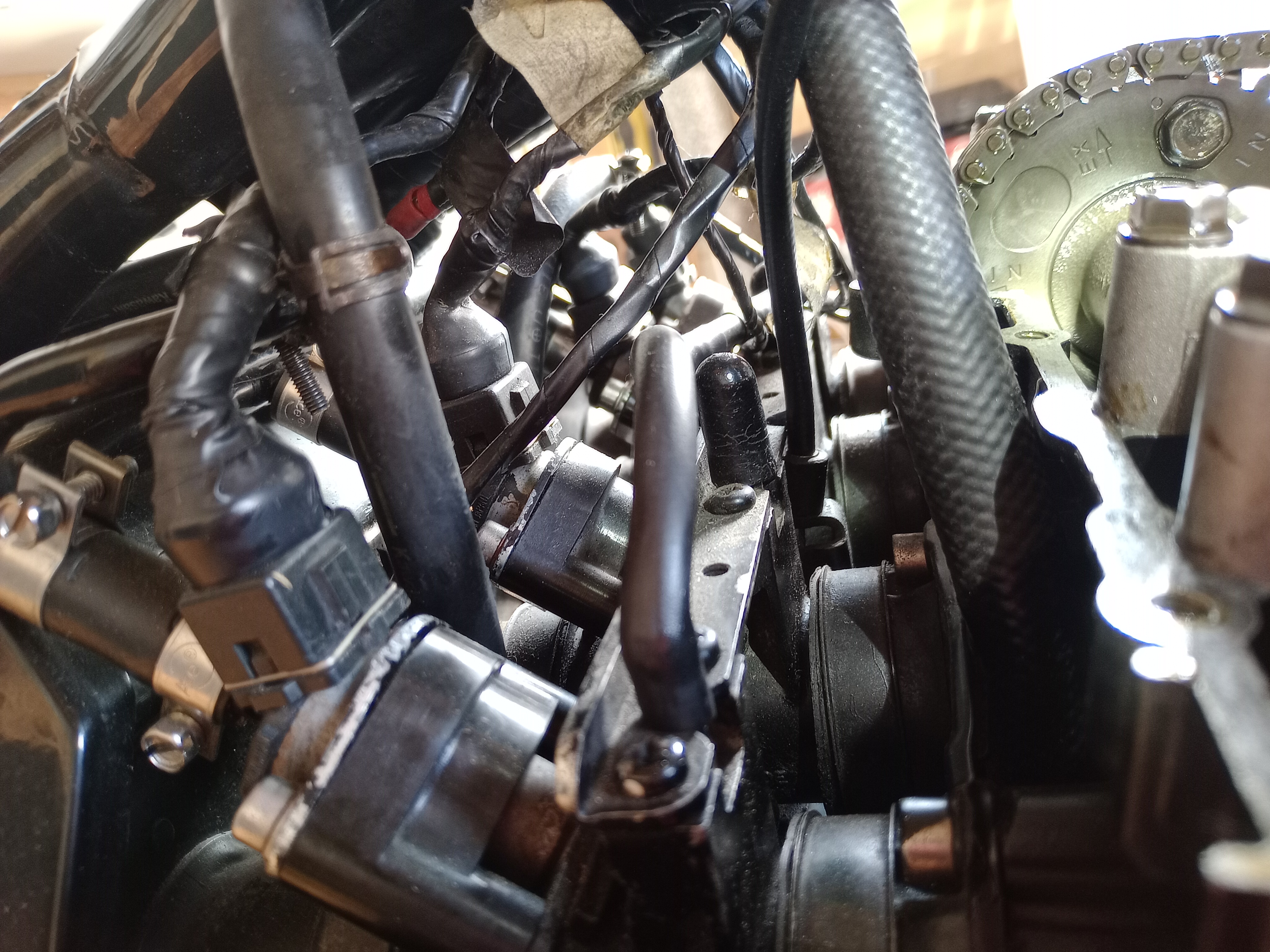

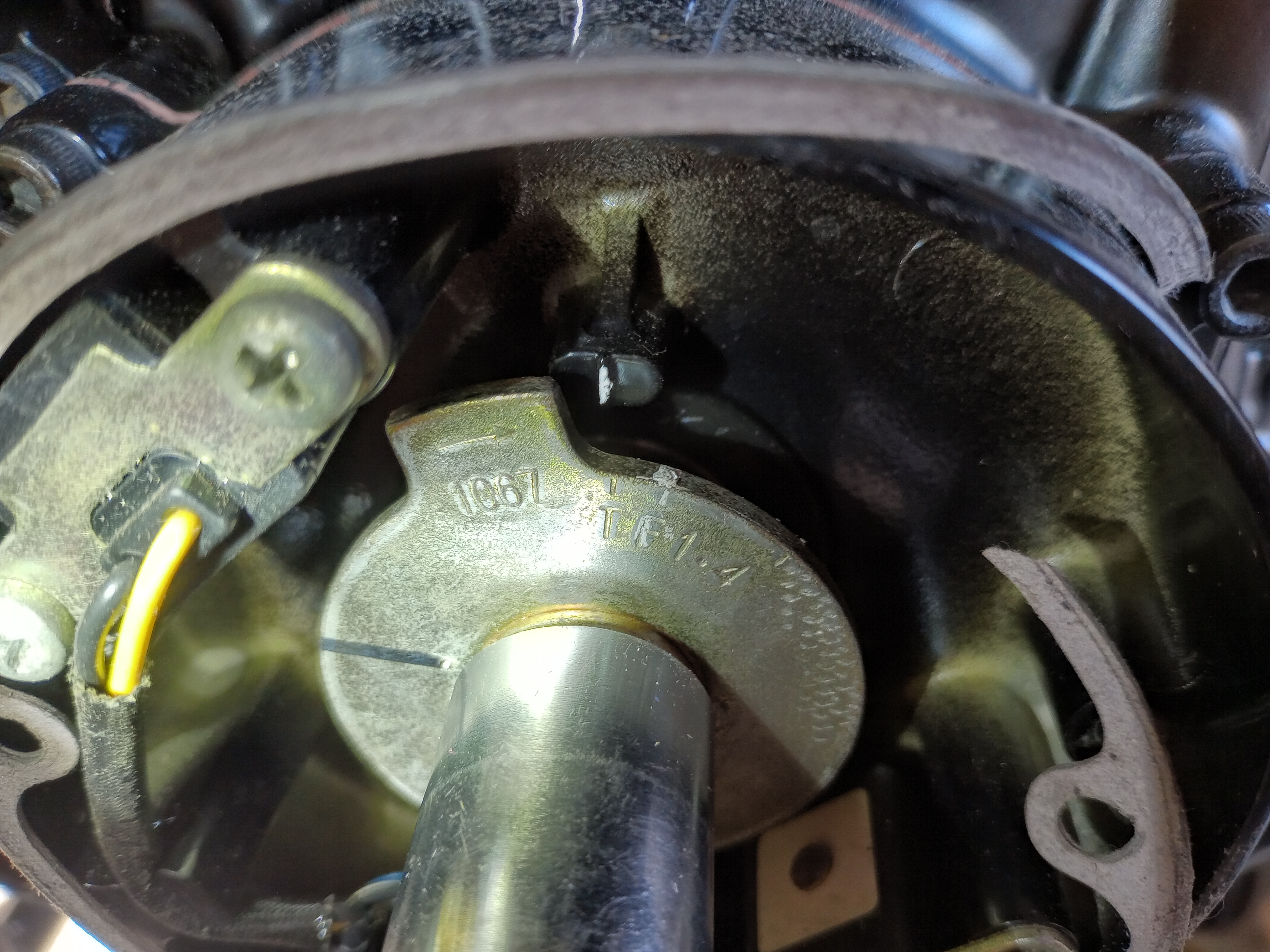

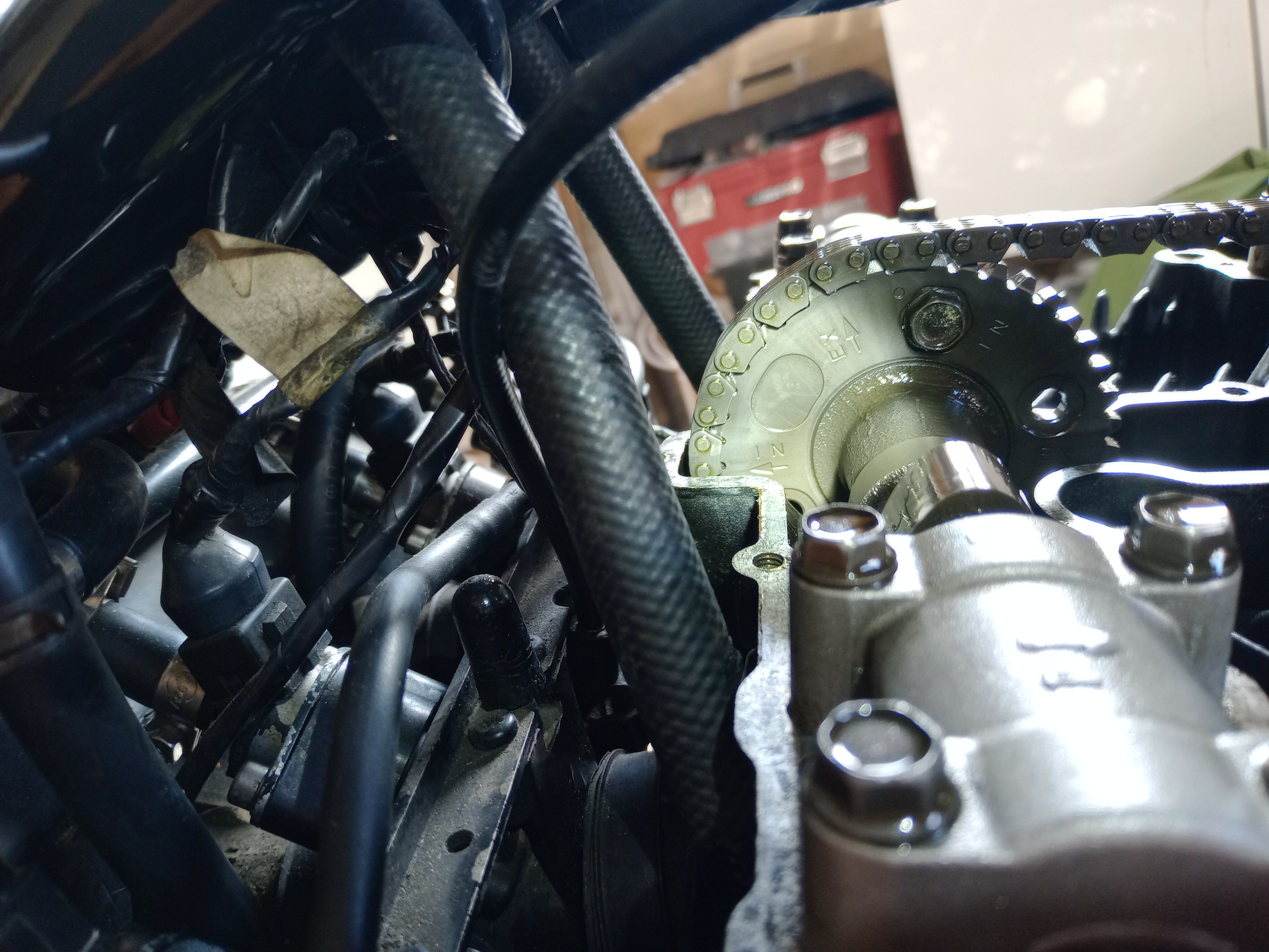

I submitted a previous post re starting issues and after I put a new starter motor in, it started but was boggy so I wonder whether I have moved the timing whilst changing the starter motor as it was a bugger to get in.
I've removed the cam cover and cam adjuster and if I turn the crank so the TDC is on the mark, then the EX and IN line type arrows don't line up 100%, they are very slightly out. There are 4 photos that relate to this.
If I do it the opposite way for comparison and line up the EX and IN line type arrows then the TDC mark is out, as per the photo that has the socket still attached to it.

Re: GPz 1100 A1 Unitrack timing
Hi Stu,
I had a similar discrepancy after reassembly of my 1000r. I was advised that minor variation is to be expected and when the top guide thightens down it may improve the alignment.
That is perfectly ok and you wont get it any better than that. Even if it was a little further out it would not effect it in a negative way ~ it would just be 'different'.
That is not the reason it is running less than perfectly, something else is the cause of it.

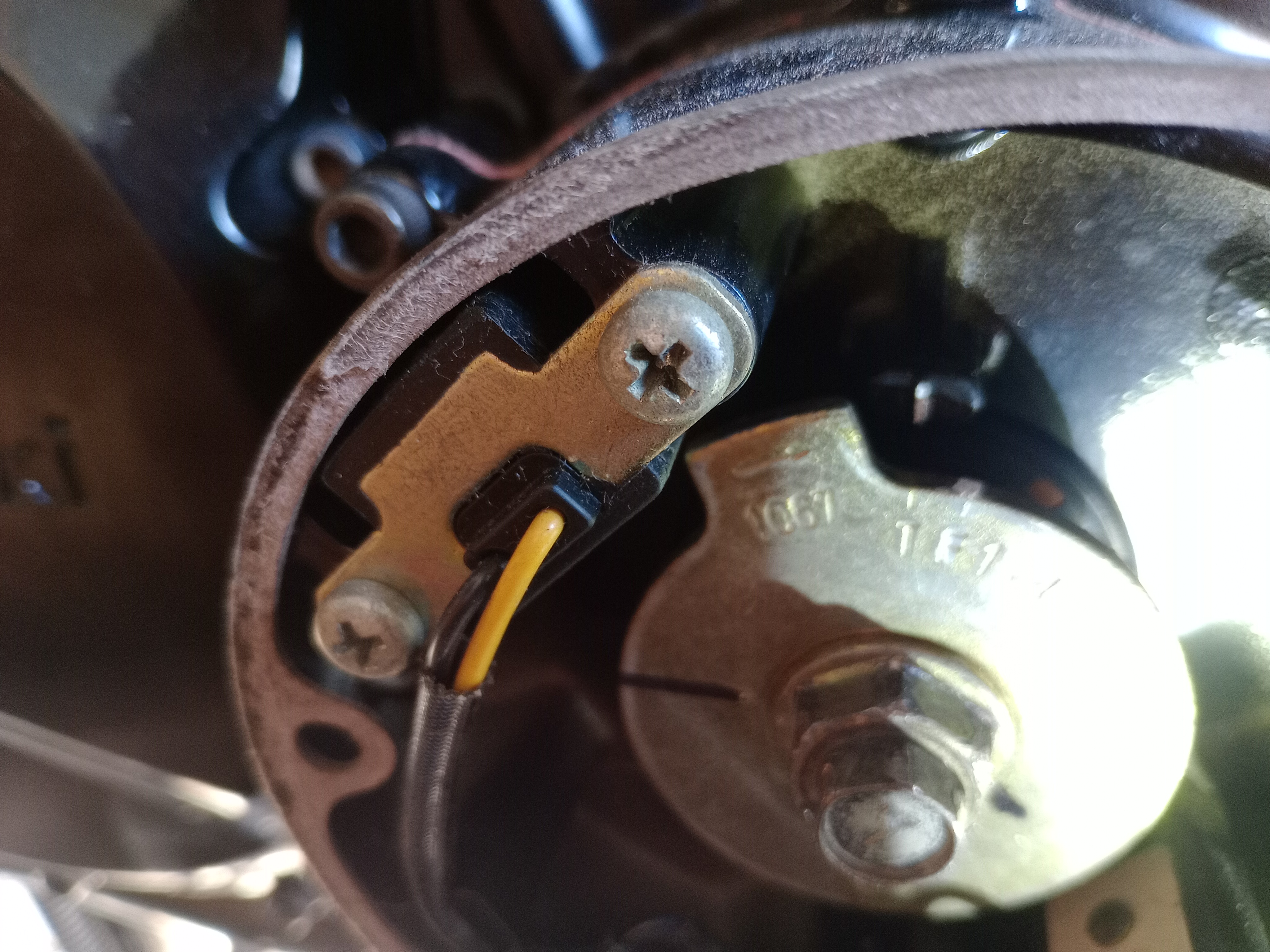

From the workshop manual is says that; the gap between the rotor tip and the pickup magnet should be in the range 0.4 to 0.6mm. Difficult to tell from the photo but your one (s) looks a little big perhaps. Its in the other thread. From my own limited experience, those reluctor / hall sensor 'contacts' (or whatever definition they fall into) are intolerant of any dirt or corrosion on their 'passing' surfaces and must be clinically clean..
DYNA 'S' is similar in that it needs a certain size gap to operate correctly and if its incorrect then the timing can change or fluctuate as it does if the voltage to the pickups is low and it reads either off the front or off the back of the passing magnet at will.
In both cases the manual and instructions say to move the pickups to correct the gap!

It's back together and I think the timing is good, I moved the pickups and they are within the tolerances mentioned above.
