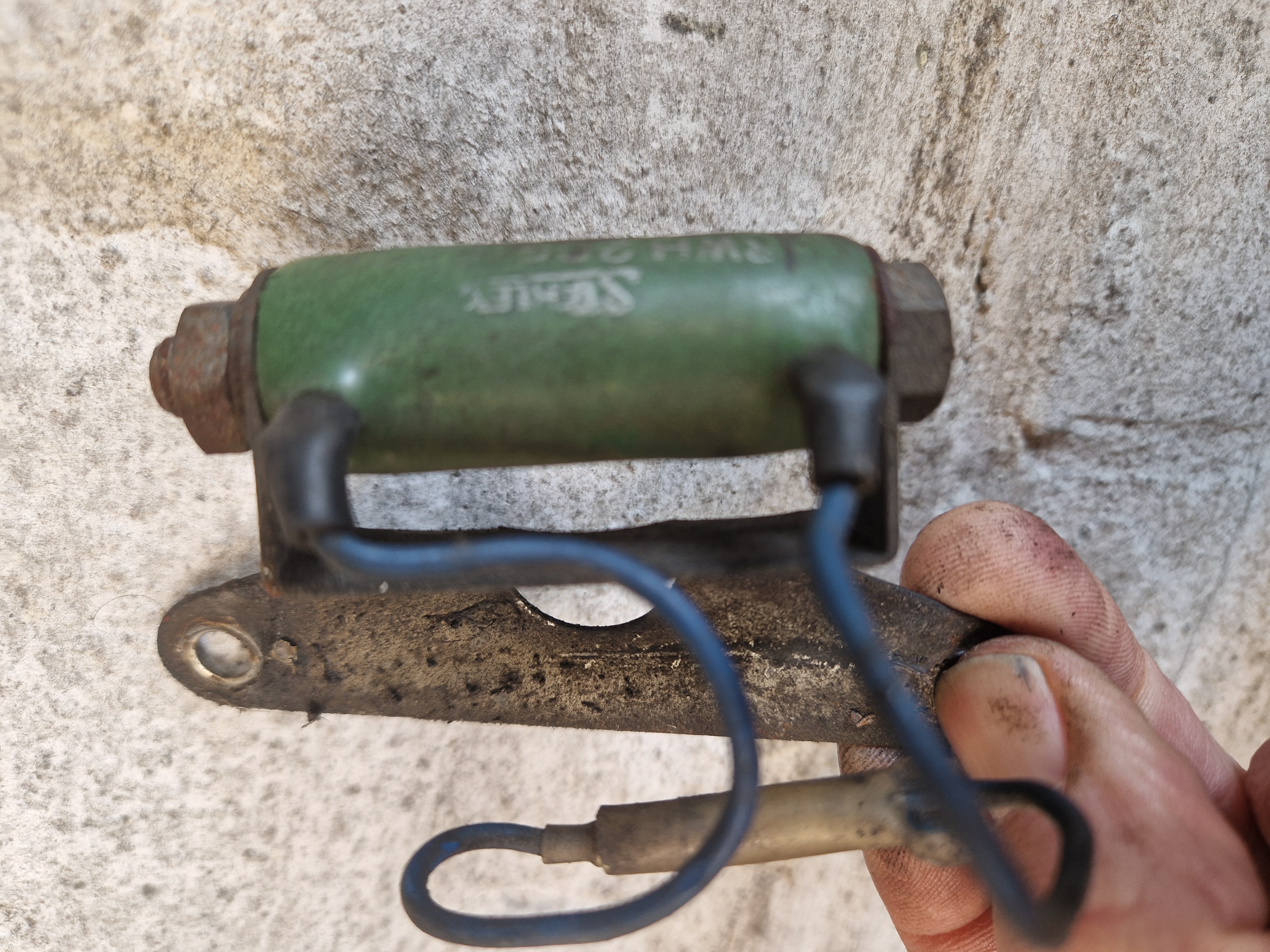

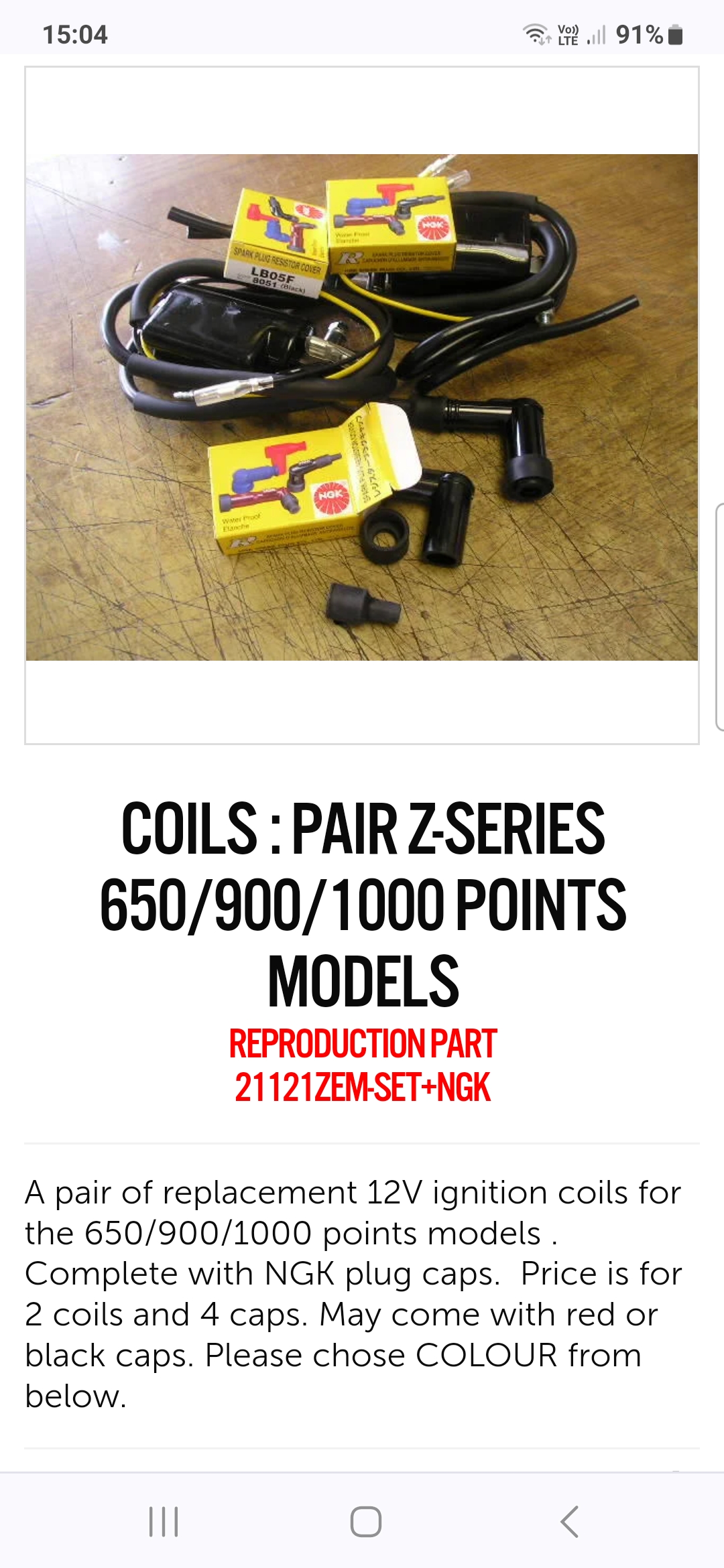

Just in the process of changing the coils, I'm replacing with Z Power parts shown. Is this a resistor? There is only one mounted under the right coil, cylinder 2/3. Do I still need it? It would have been like this since the late 80's when the frame was sprayed. I'm using NGK B8E S sparkplugs. The more I read up on resistors the more confused I get!!

It's nothing to do with coils. It relates to the headlight. It connects to the blue wires on the RH and LH switch blocks

Thanks a lot, I will junk it then. It's had its wires plugged together since....

I bought this coils and caps kit from Zpower a couple of weeks ago. The red caps option was not available so it came with black NGK plugs.
My black LB05F plugs are stamped 5K ohm so black plugs having no resistor is not a hard and fast rule.

I remember when I was restoring an XL185 it has a "ballast resistor" connected in the headlight circuit. it was broken so I deleted it and just joined the wiring ends together , but then it started blowing headlight bulbs - turns out it damped down surges in voltage/ampage when revving , which could lead to blown bulbs through overload. Prob was sorted when I found one and refitted it. So it may actually do something - if you delete it then watch for electrical issues elsewhere

gray wrote:I remember when I was restoring an XL185 it has a "ballast resistor" connected in the headlight circuit. it was broken so I deleted it and just joined the wiring ends together , but then it started blowing headlight bulbs - turns out it damped down surges in voltage/ampage when revving , which could lead to blown bulbs through overload. Prob was sorted when I found one and refitted it. So it may actually do something - if you delete it then watch for electrical issues elsewhere
Many thanks, I discovered it as pictured, the blue wires are connected together and have been for 30 years.

Kev1R wrote:I bought this coils and caps kit from Zpower a couple of weeks ago. The red caps option was not available so it came with black NGK plugs.
Just something to be aware of.
