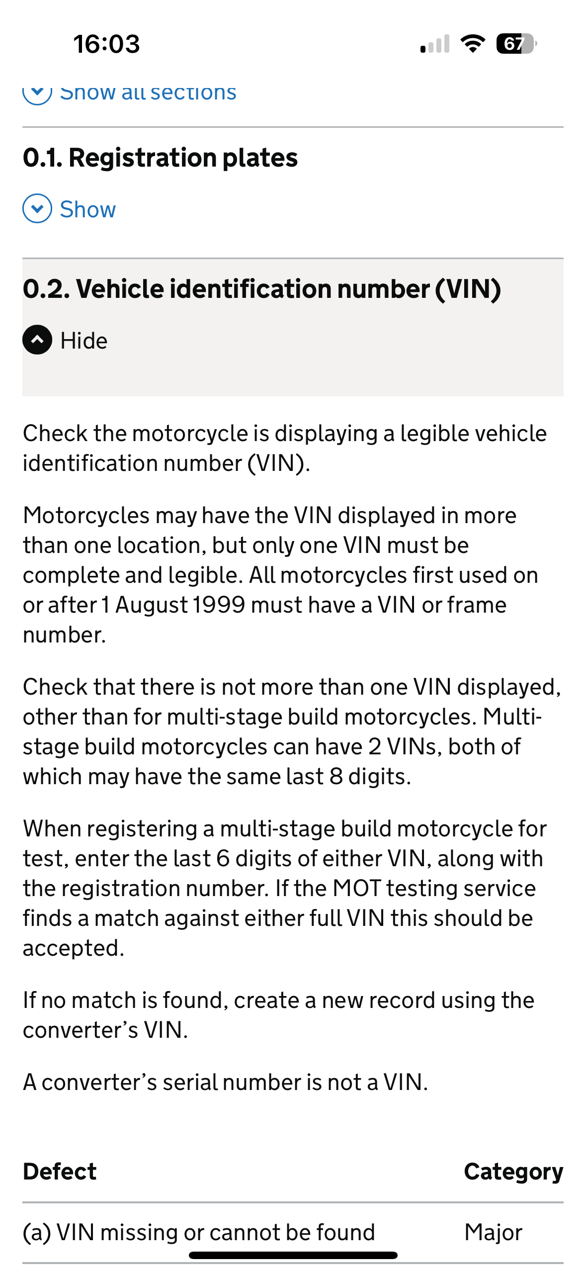

bin there before. just make a vin sticker & stick to other side of headstock.
worked for me.
quote from mot testing manual
Motorcycles may have the VIN displayed in more than one location, but only one VIN must be complete and legible

Thanks Zed1015. Attached is the extract from the MOT Testers Manual that led me to believe it was not needed for pre 1999 bikes. My error I guess.

I had this when I took my Z1000 for Mot after rebuilding it. Vin hard to read because of frame powder coating. I only took it for Mot as it had been off the road for so long.
The Mot tester was not going to test it, but after checking up he found as you have that pre 99 bikes don't need to show a VIN.
I took a copy of the V5 and he used that for the test.
It's now registered Historic so don't have that problem now.
