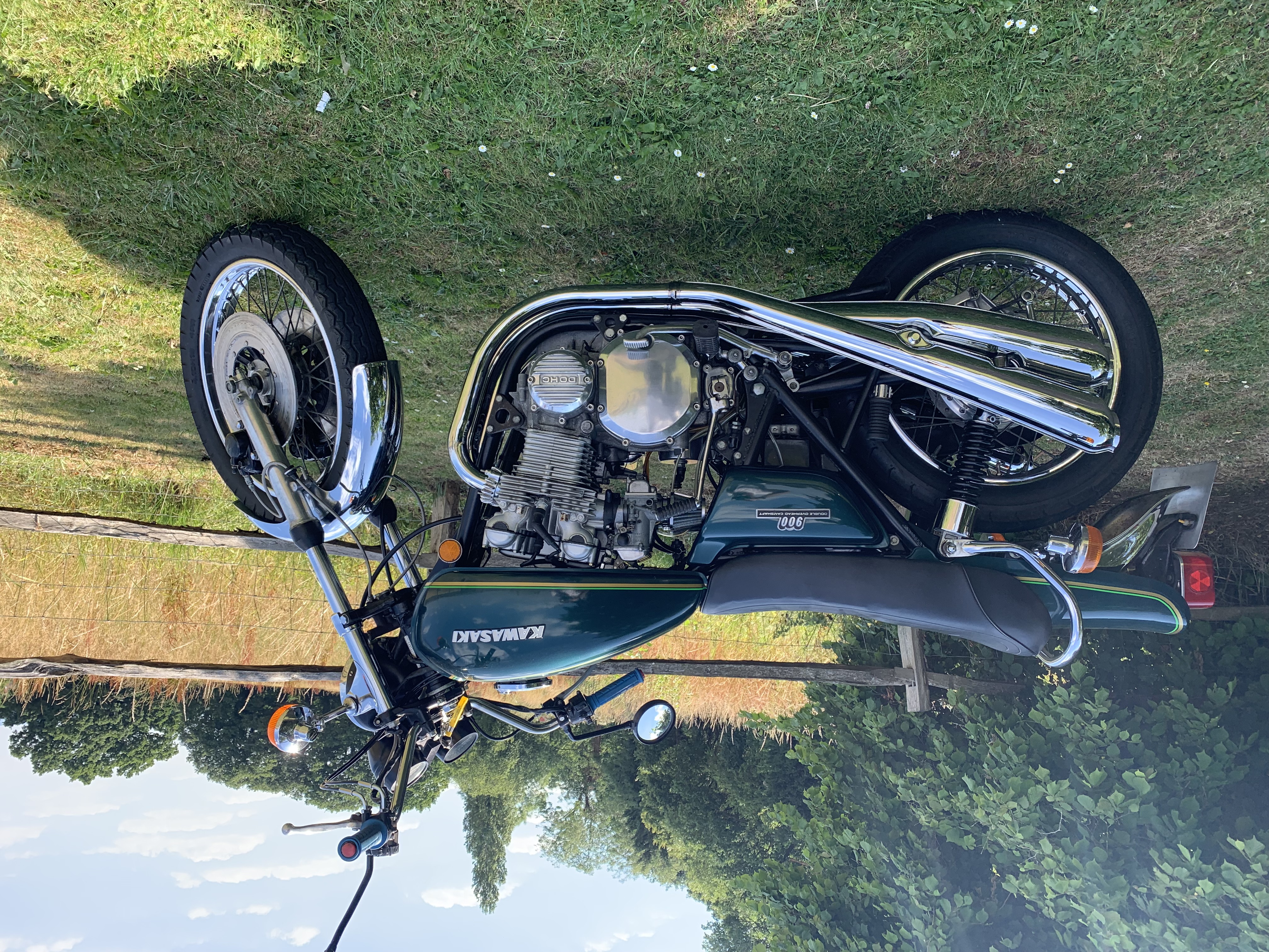

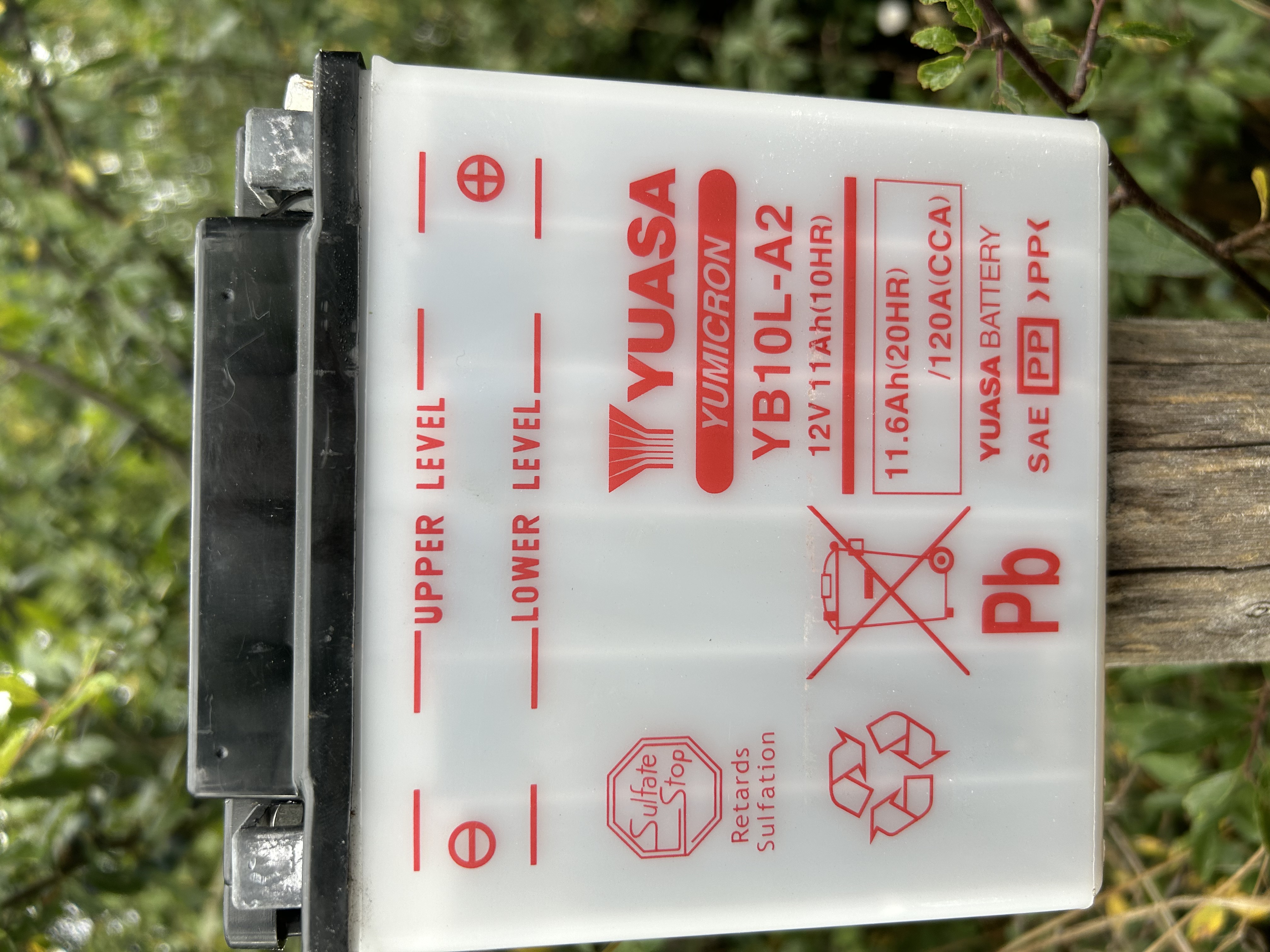

I have existing battery which is struggling to turn it over,could be the high compression pistons producing 160 for the compression,have attached photo .Probably need one with a bit more power does anyone use a stronger one ? Now my engine has been sorted I notice that the clutch is a bit noisy which reduces when lever applied.Is there anything than tends to go in the clutch area that I might need to look at.Apart from that the bike is running great, the carbs have been balanced

Battery, motobatt gel for a bit moe ooommpphhh.

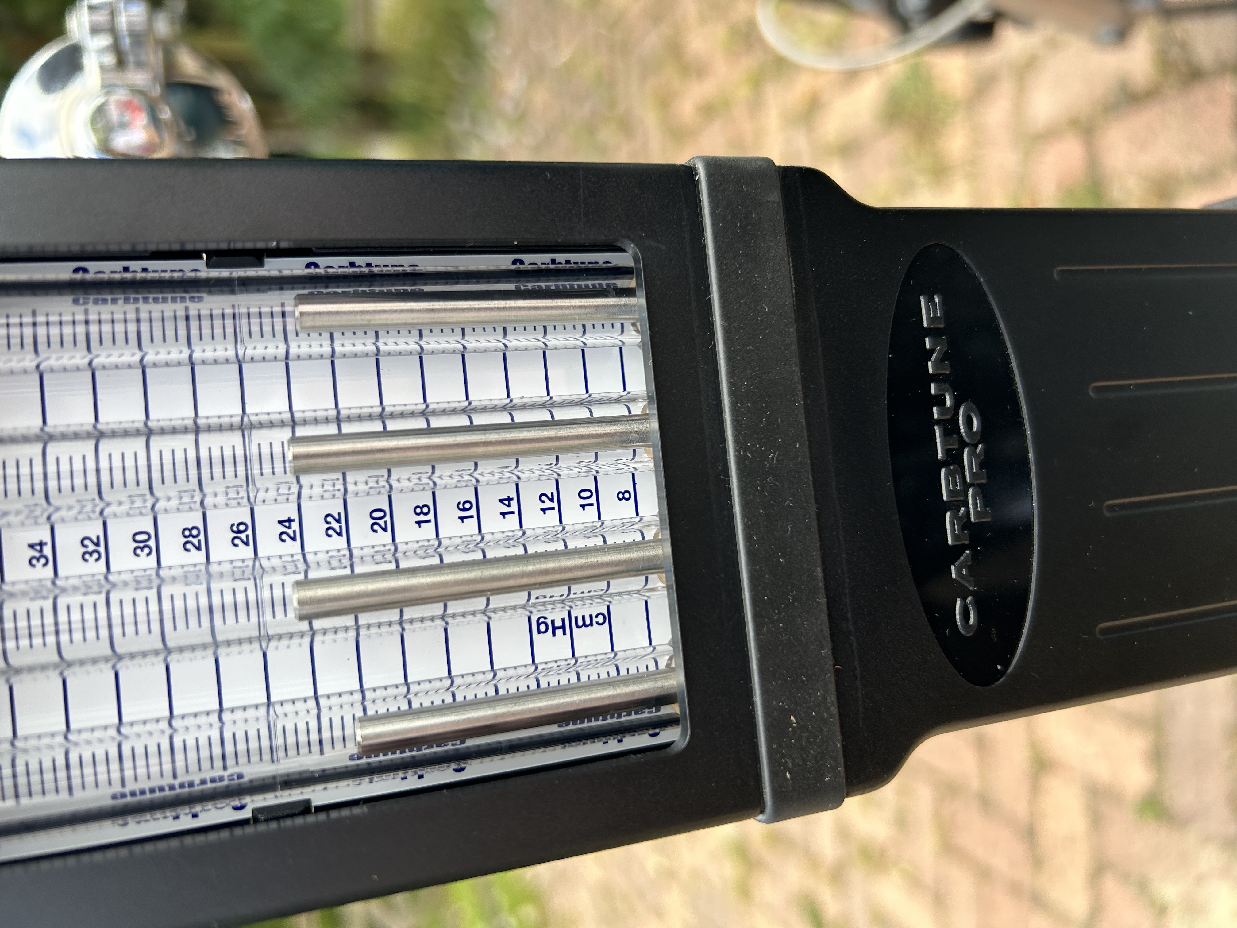

Thanks for the battery answer will go for that on winter service,tending to go through one a year.The carbs are balanced with carb tune are within 2 hg of each other

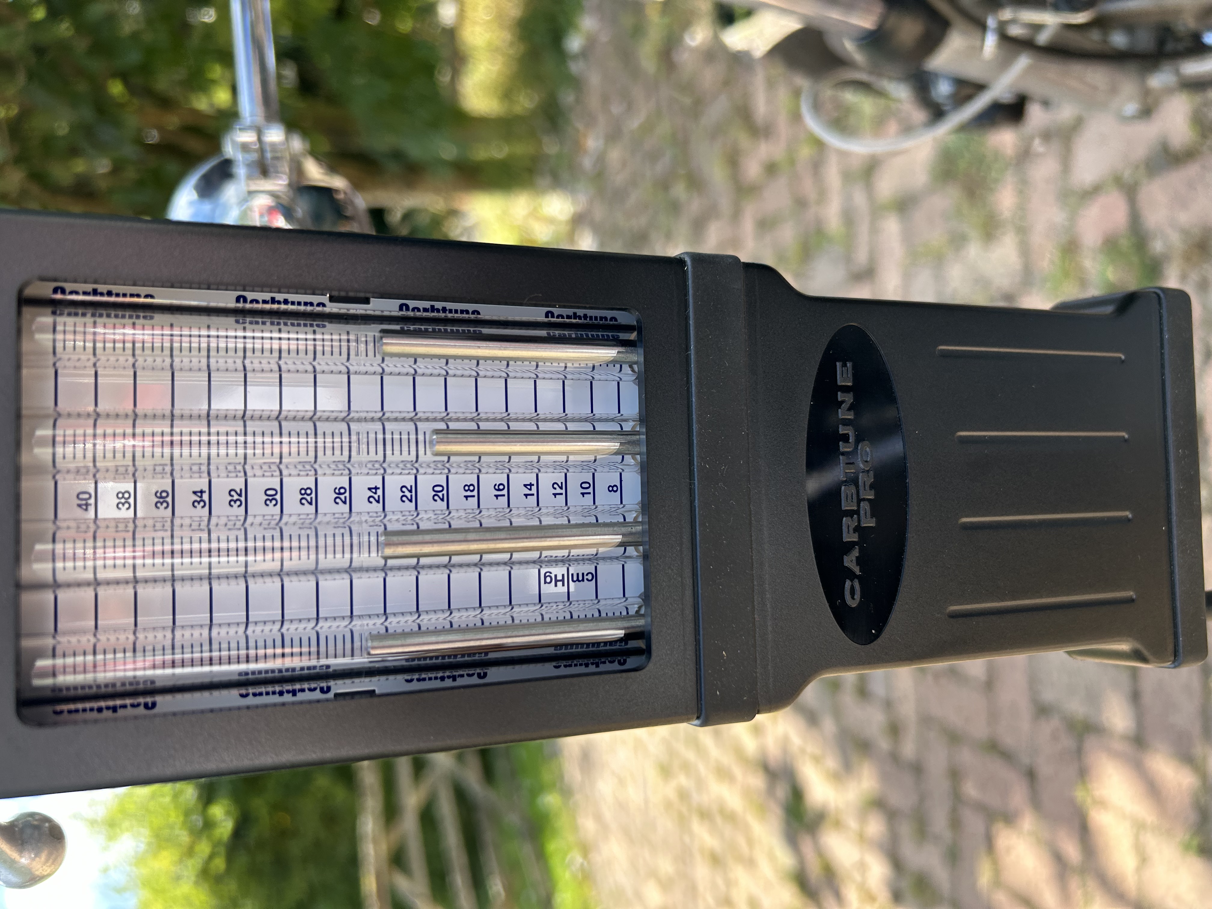

Taken before and after carb balance,clutch still a bit noisy compared to my z650.Perhaps a job for the winter,it’s probably the only bit that hasn’t been taken apart this year!!!

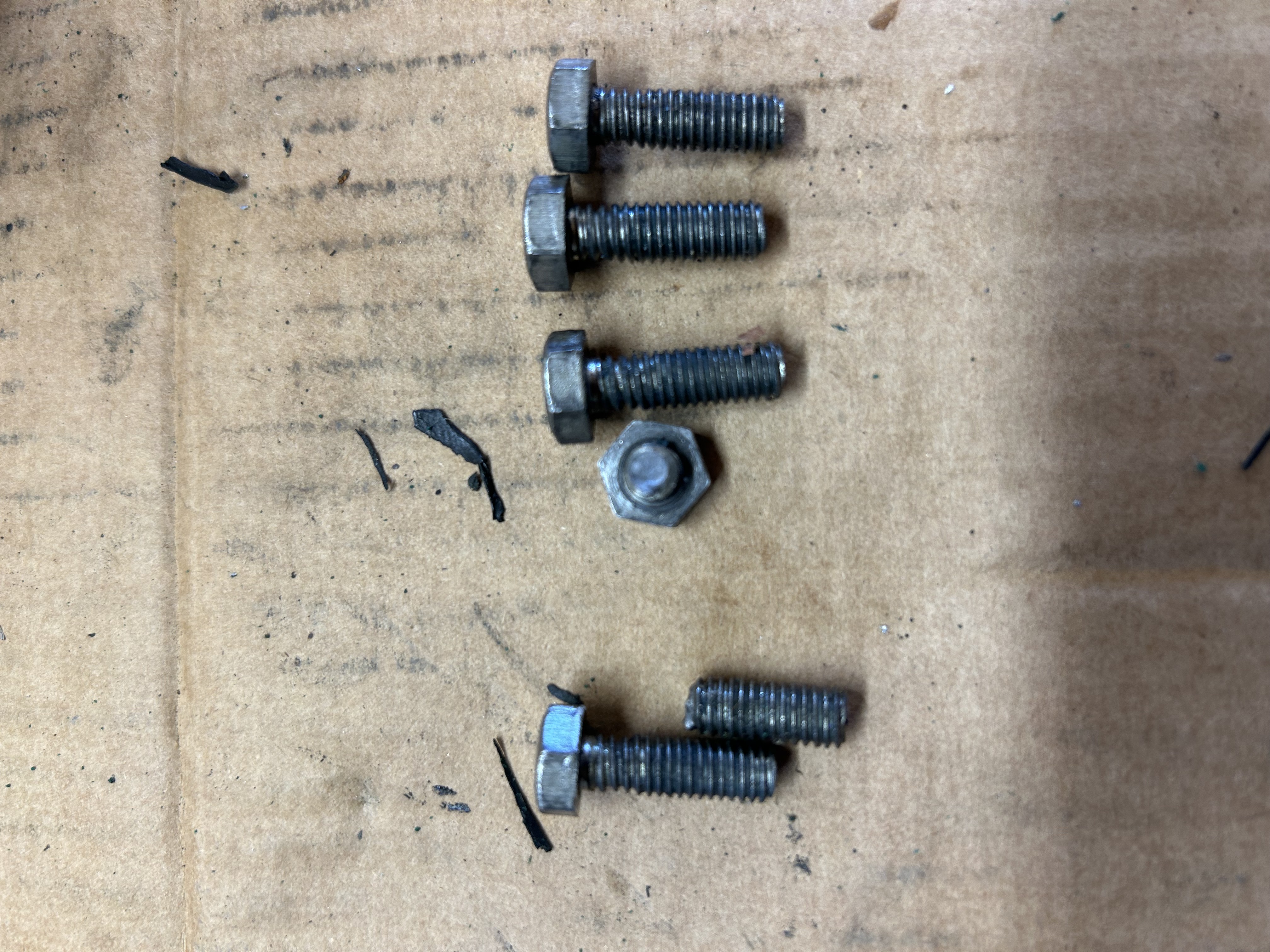

#15 PostAuthor: Mark W » Tue Aug 20, 2024 8:43 pm
