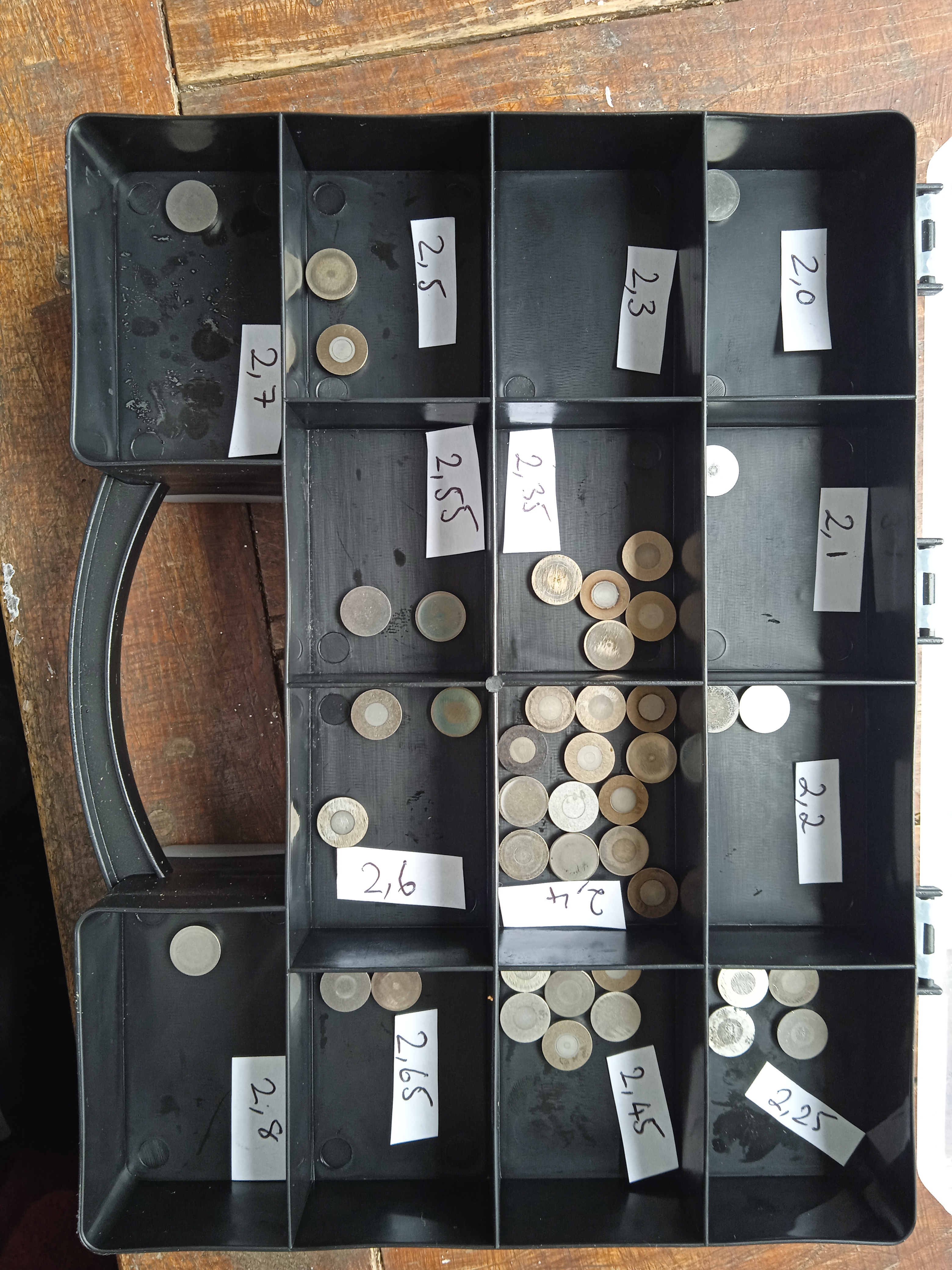

Will post also in the wanted section but......
I'm in need of 4 x 2.3mm 13mm shims, I have the others required.
Have a look in the box and see if you need any?
One other option is to pull my spare 650 engine to bits but I doubt I'll have 4 x 230s in there.
