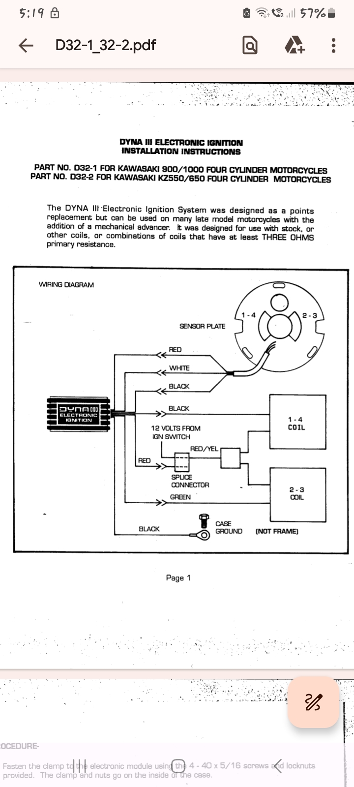

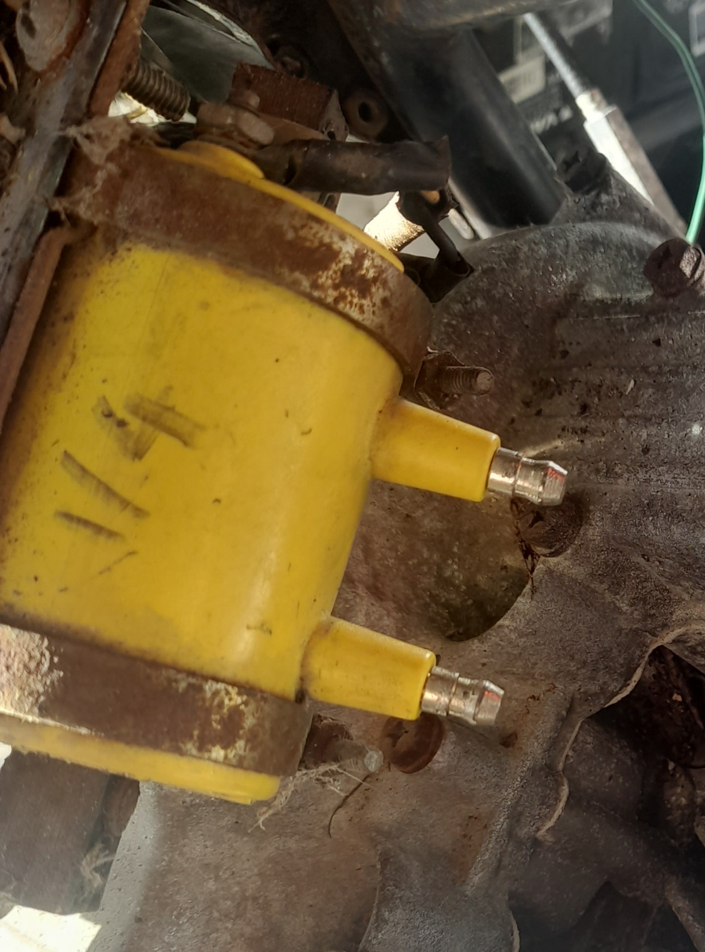

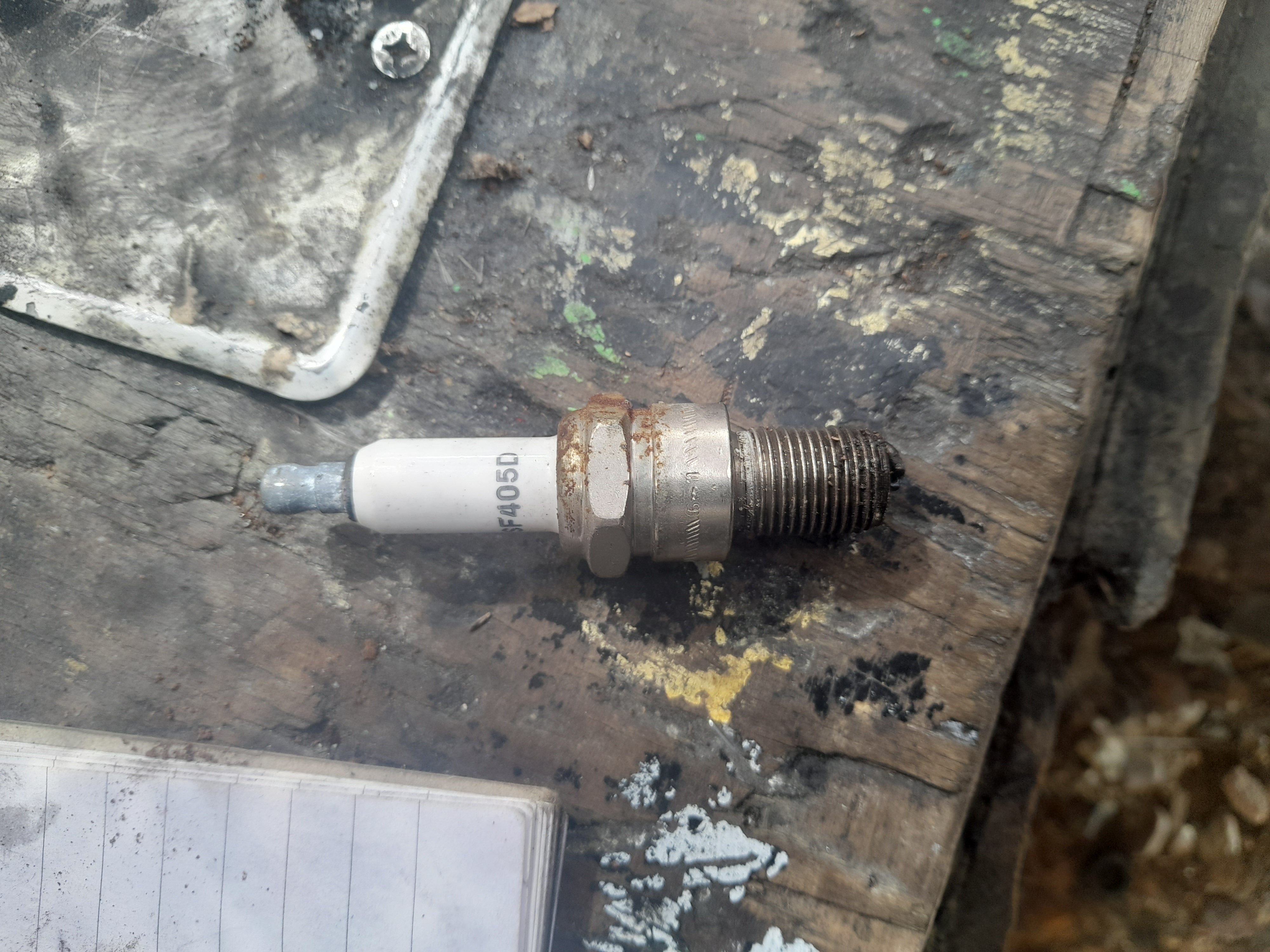

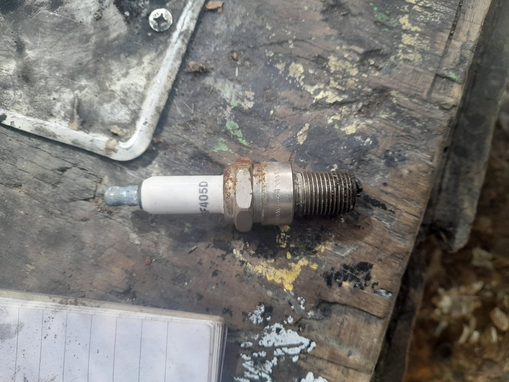

Fitted with Dyna 111, coils (as pictured) and Split fire 405D plugs ( never heard of them!). Generally the loom is a mess with no ignition switch so I've hot wired it.
Not getting a spark so need to test the Dyna module but can't find any info on how or it can be tested. Anyone point me in the direction of a test procedure?

I had Splitfire plugs in my 1st Zeph11. A forked electrode, in effect giving me 16 sparks. This was about 1993. Apparently they are American (from what I remember) and were originally made for big American muscle cars to help get a clean burn. No idea if they made a difference or not.
Got them from the NEC. There seemed to be some good advertising for them at the time, then they disappeared....probably snake oil on a normal engine. I do remember they cost £5 a plug so £40 for the Zeph. Expensive back then.

Thanks guys, I managed to track this diagram down which once I'd checked all the connections it occurred to me the coils had no live feed. Sorted that and I had spark
