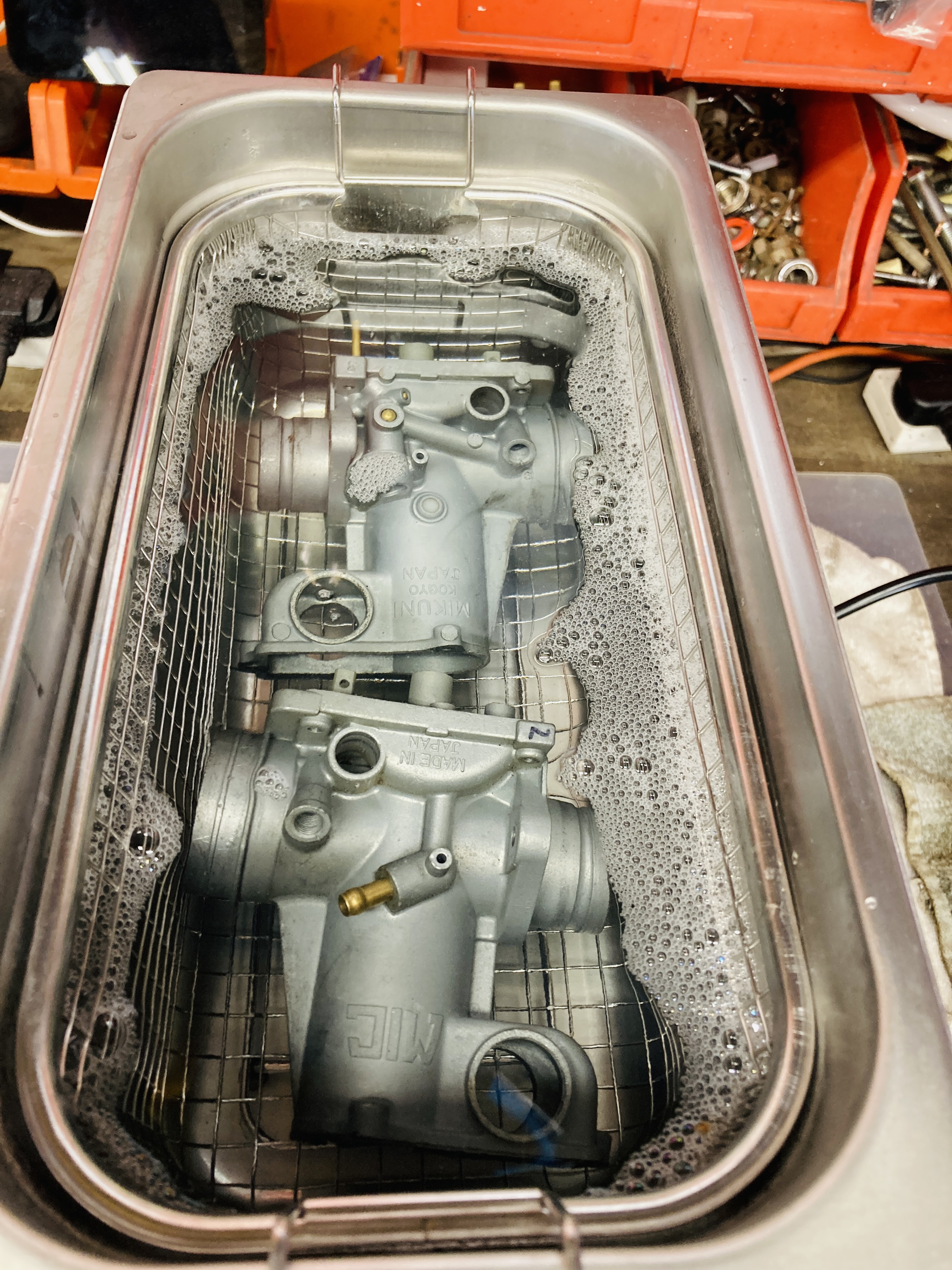

Got my carbs dismantled down to individual bodies and parts to ultrasonic clean and renew parts.

Carbs been through first clean in the ultrasonic cleaner , will drop in the float bowls, tops and brass parts next.

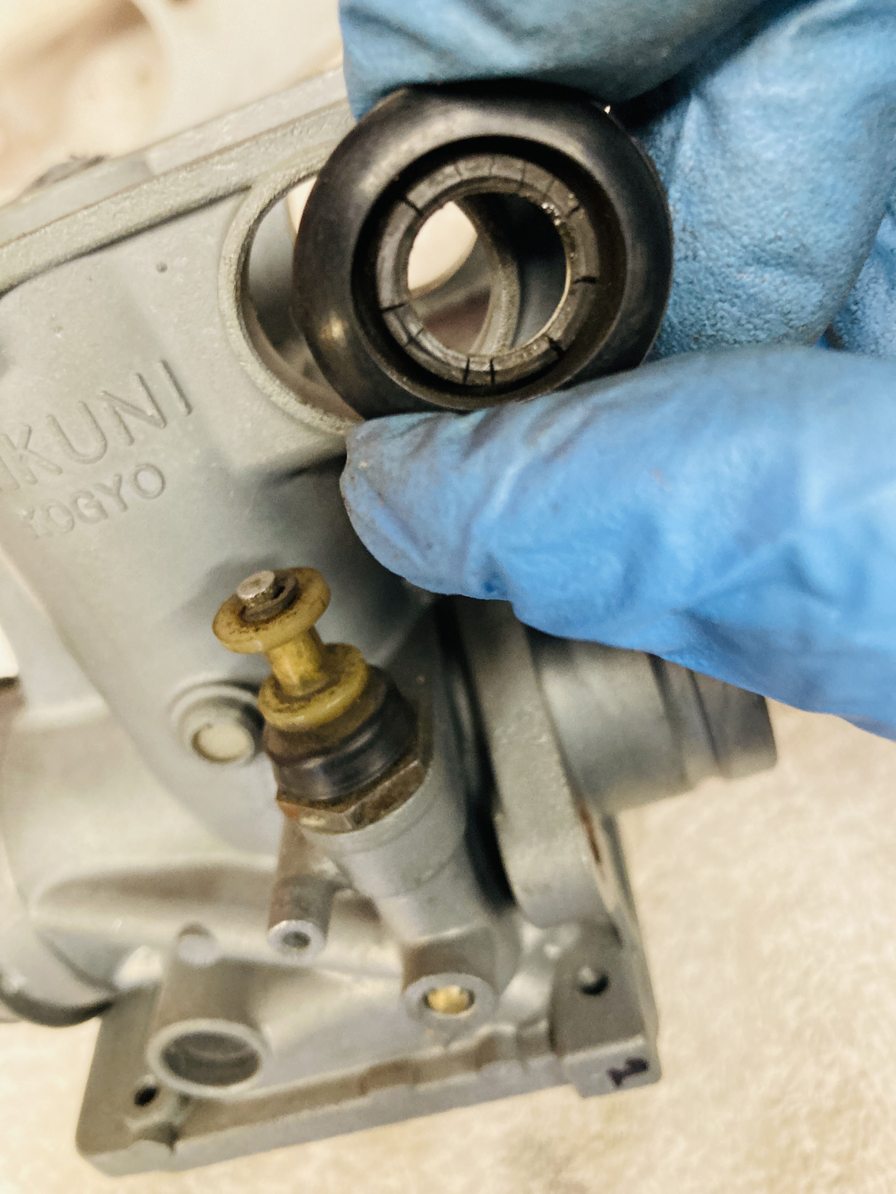

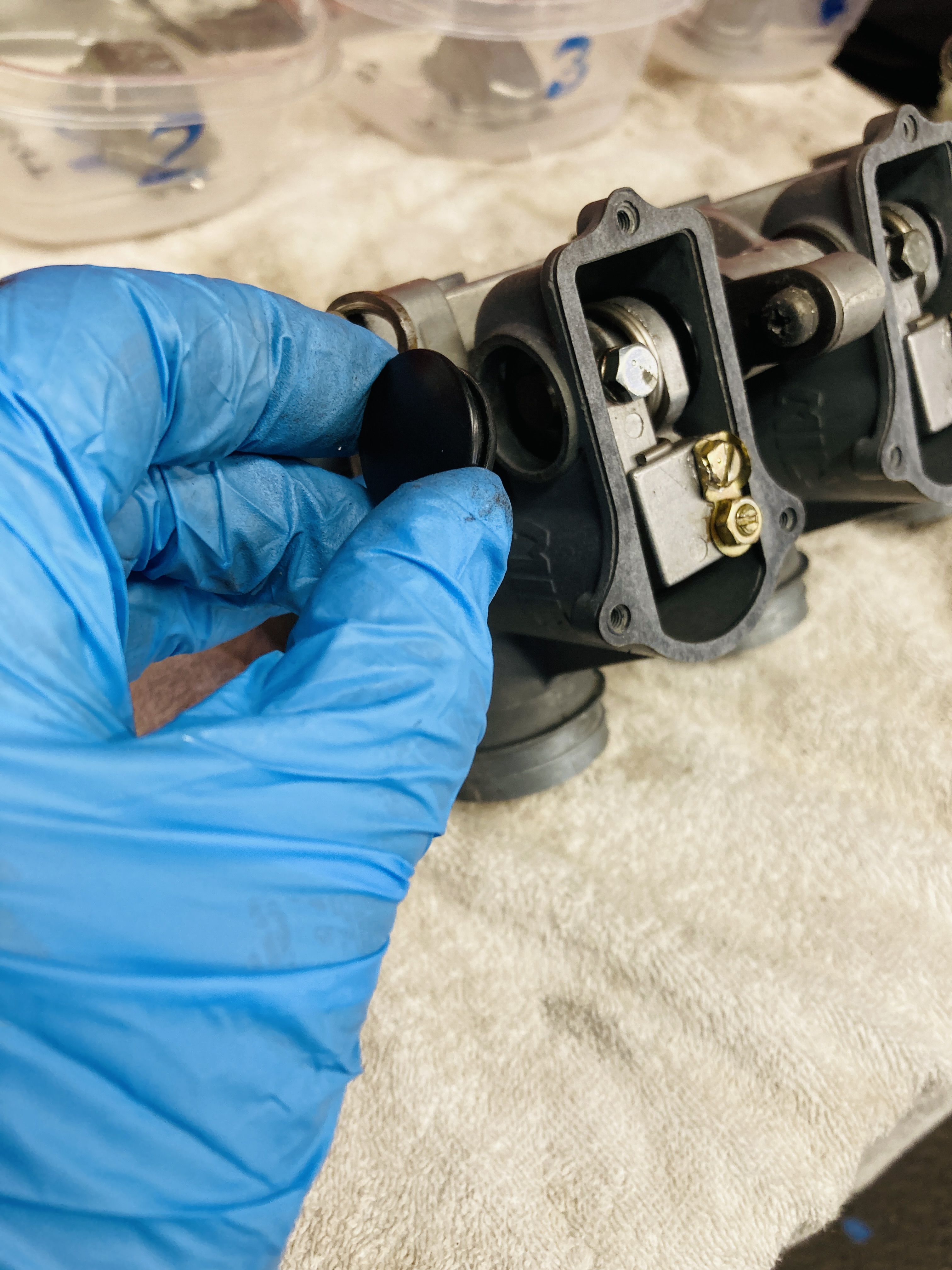

Need the rubber grommets that go in the carb tops that the carb link shaft goes through , any source known for these would be greatly appreciated.
Part numbers 16039042 Blank rubber grommet & 92071104 rubber grommet with carb shaft hole.

NRP in Manchester has the throttle shaft seals.
No problem, I have loads of good used grommets if you don't want to purchase new.

Thanks very much, bought the genuine Mikuni ones new from NRP.

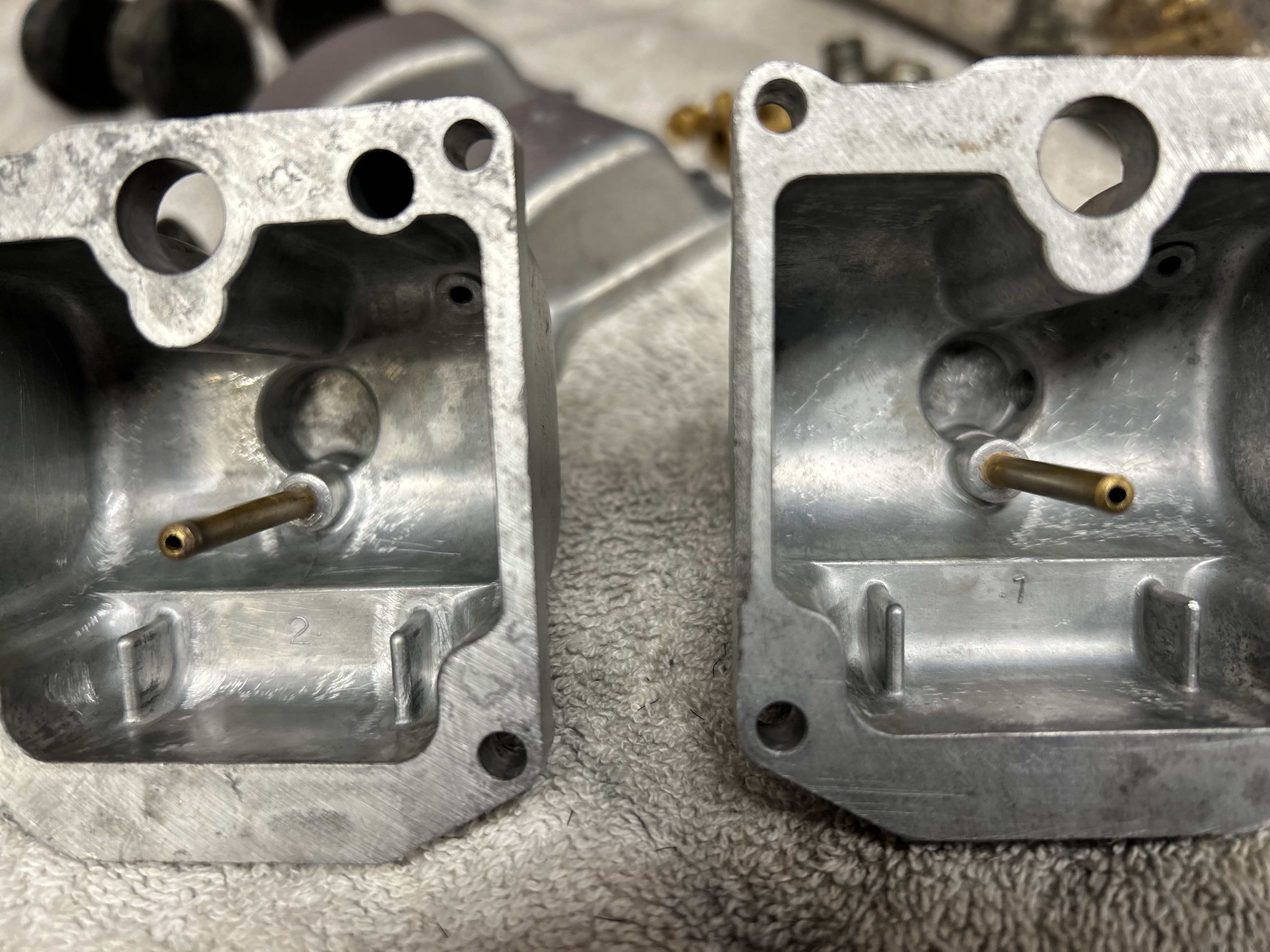

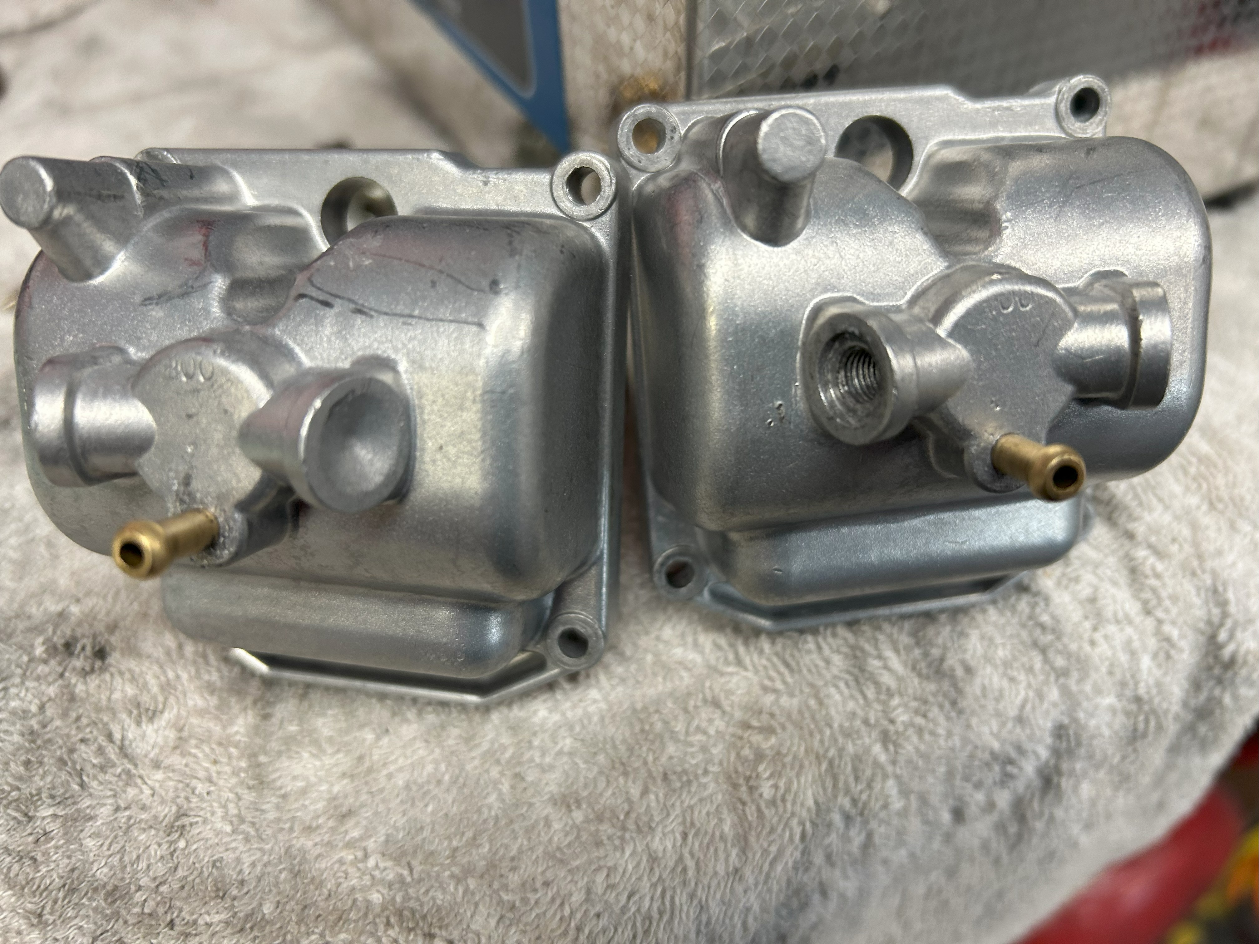

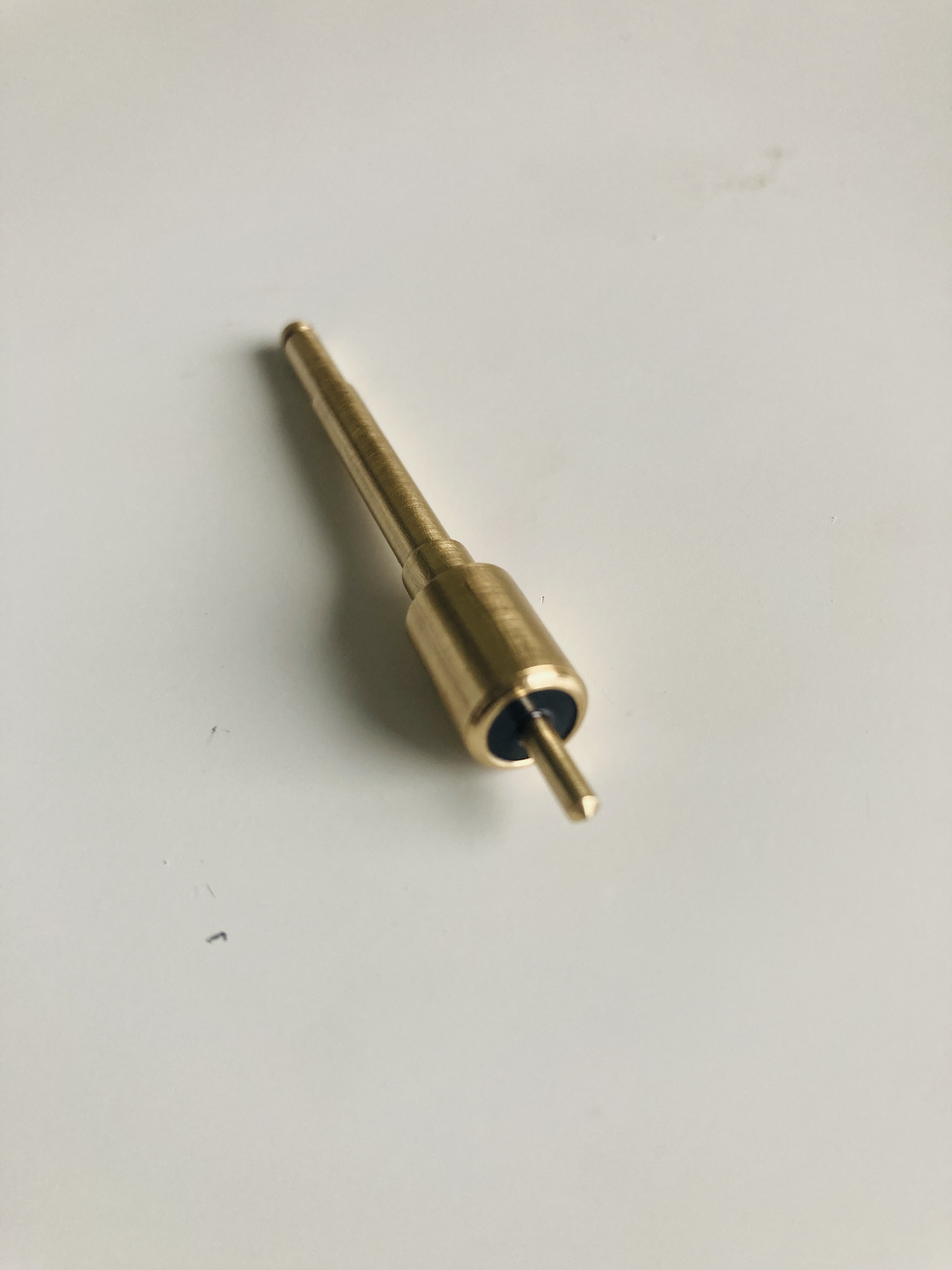

Need a bit of help here , looked at my float bowls and noticed inside one is stamped with number 1 , all the others have number 2. All 4 are stamped on the outside with number 100.
I don't think it matters other than having the drain screws pointing the right way ? or does number 1 have to on carb 1?
Another thing with VM26ss , I have never had an O ring on the emulsion tube, and cant see any in the part numbers or diagrams for them. Is it only later models that had the O ring fitted?
Any help or info greatly appreciated. Thanks.
Re: 900 A4 VM26SS carb overhaul
Doesn't matter where the bowls go except to have the drain screw pointing outwards.
Some emulsion tubes use an 'o' ring and some don't.
The ones that take an 'o' ring have a groove between the hex and the thread.
