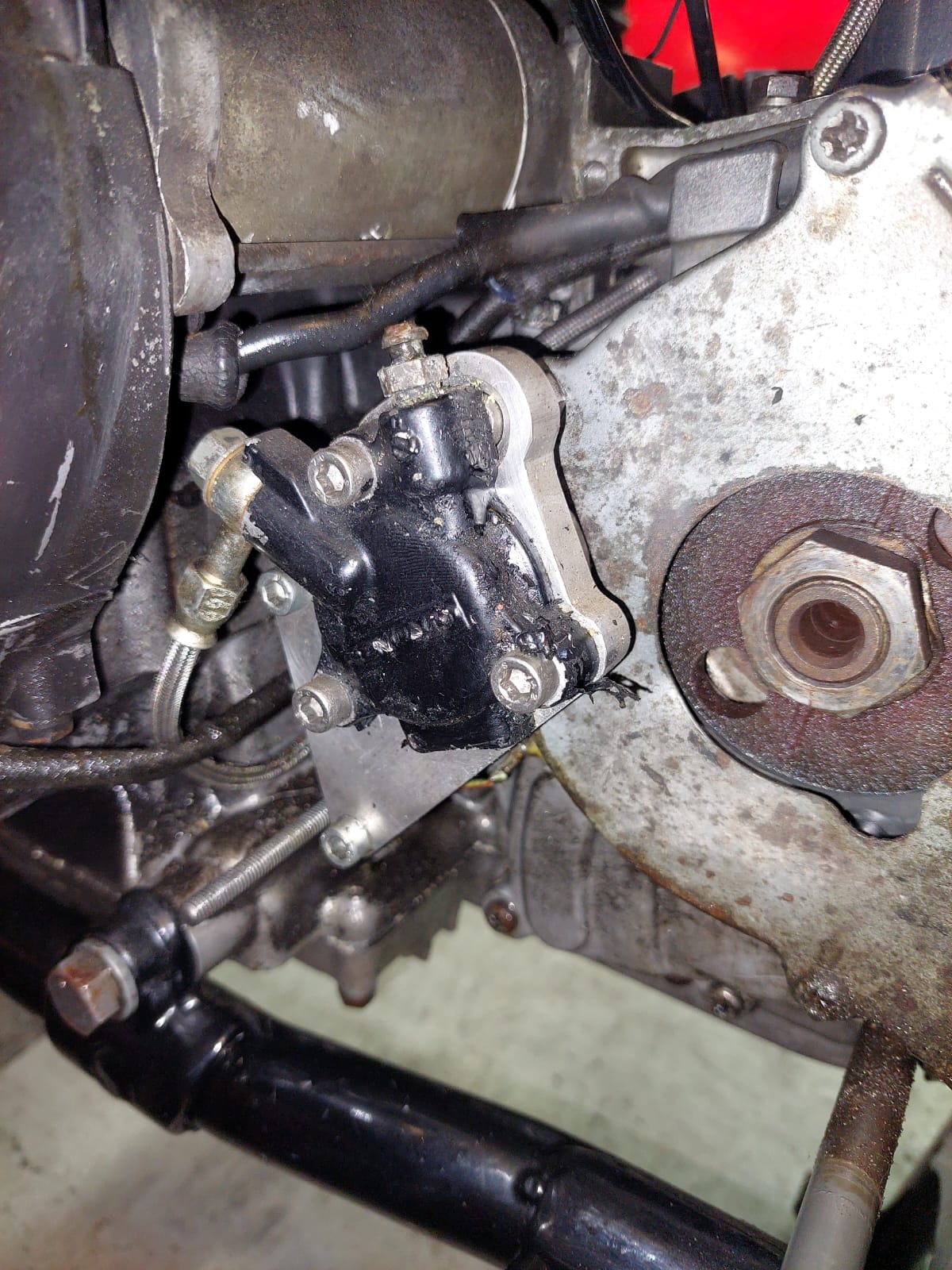

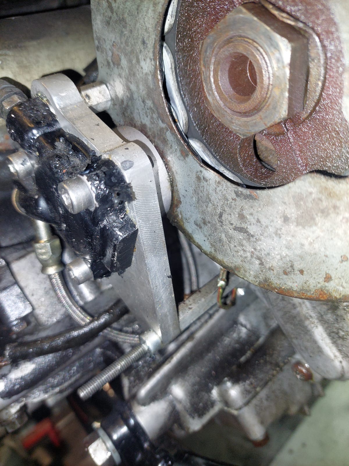

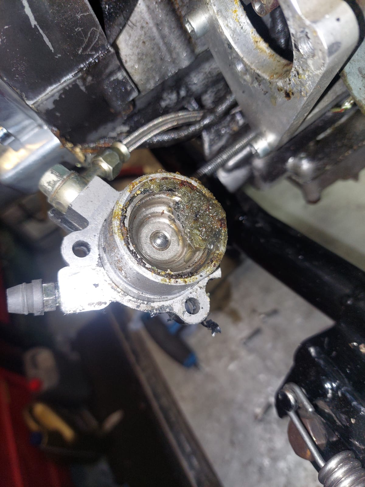

Help! Recently purchased a 75 Z1B that had all the mods we used to fit back in the day. Brembo twin discs/4 into 1 etc. It has an Hydraulic clutch and the slave cylinder has a failed seal. I can't work out the make or type to try find a replacement of seal kit. It looks very similar to a GSF1200
Can anyone out there assist in identification?

Looks like kawasaki

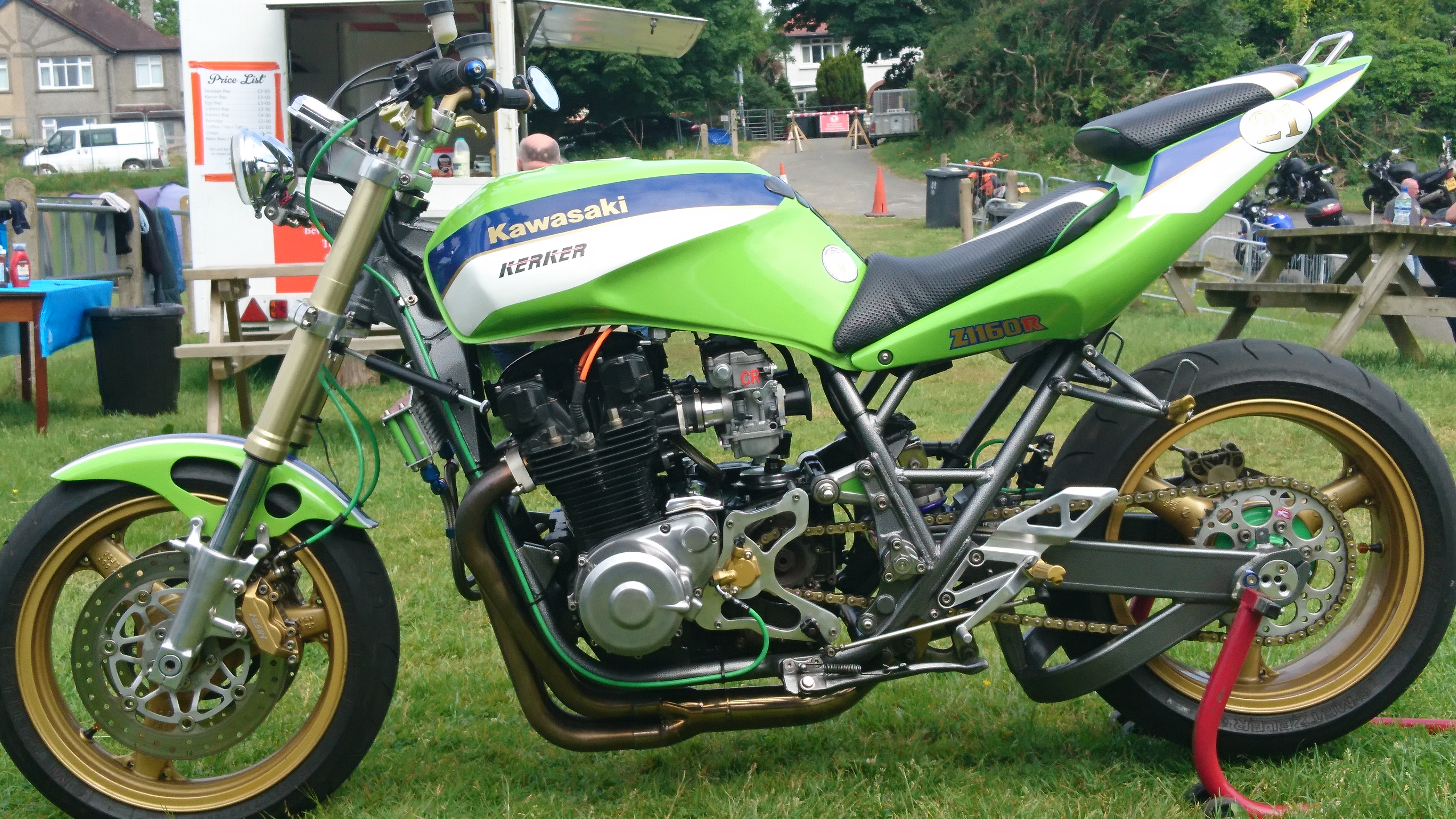

Same as Gus zxr750 or zx7r as fitted to my 1262

I've looked around and the Kawasaki ZX10 slave looks identical but still not sure.......... It's a three bolt fixing so yours looks like a 2 bolt

its not a bandit GSF one, they are 2 bolt.

The three bolt one is GPZ900R / GPZ1000RX/ ZRX1100-1200 / ZZR1100 / GTR1000 etc, etc, etc.

Thanks for the input guys, we'll have a try with the ZX10 which seems the closest match unless anyone out there has any better plan!

its a ZZR1100 D model slave cylinder

zed1015 wrote:The three bolt one is GPZ900R / GPZ1000RX/ ZRX1100-1200 / ZZR1100 / GTR1000 etc, etc, etc.
This is the correct answer. As I have a ZRX1200 one on my Zed.

We fit these to the Z1300 as a modification.
As someone mentioned earlier, its the same as :-
