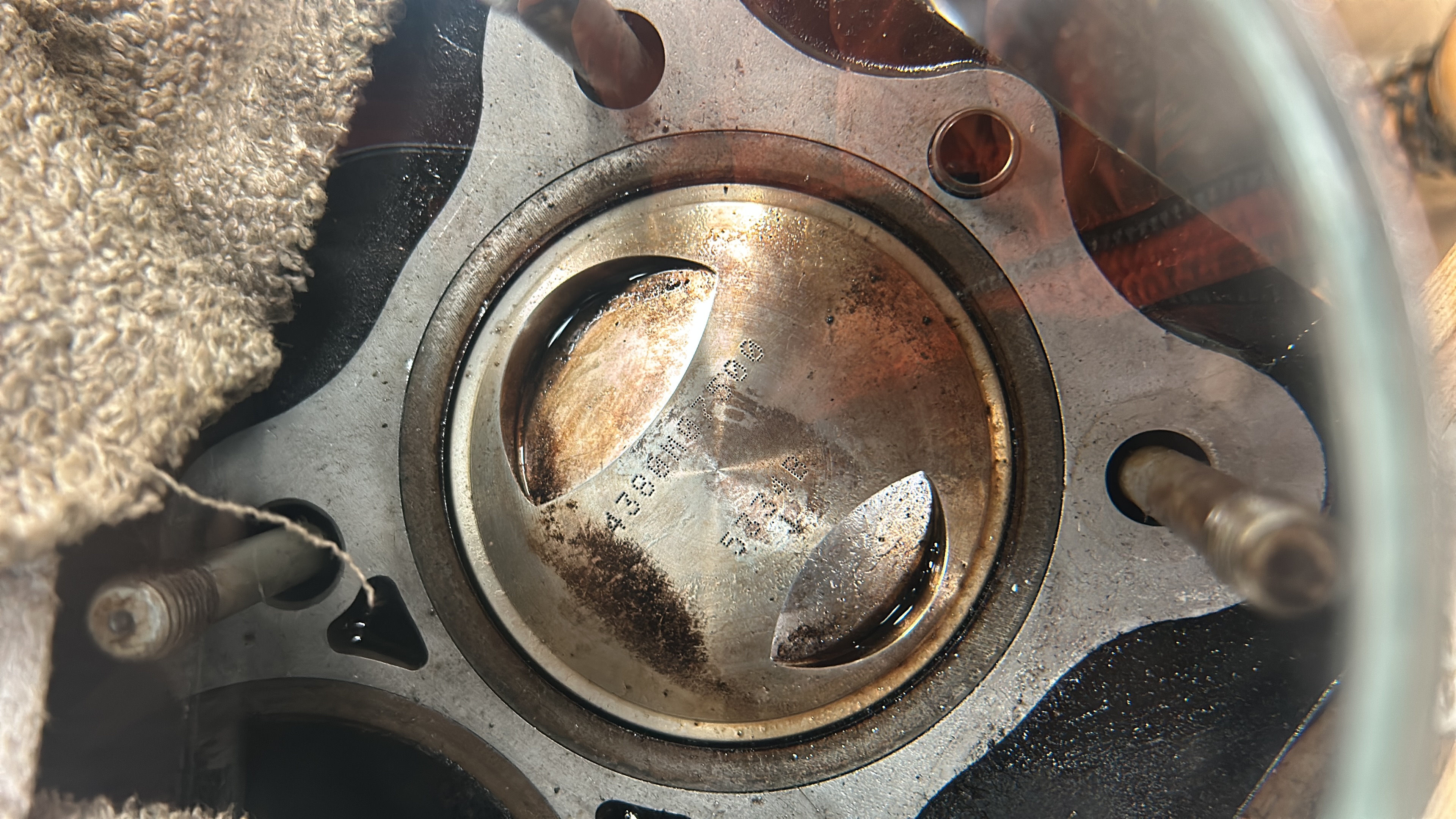

I have a wiseco big bore on an A2. It’s approx 75mm. There should be numbers on the piston crown which will tell you what compressoion ratio you are running it could be 9.5/1if nos are 4380M07500 or if it’s 10.25/1 they are4255M07500. I’m sure there are other variations also. Also check stud diameters. This may affect oil delivery if they are larger and block was not reeked out to suit and also torque will increase if you have larger studs and higher compression. Hope this helps.

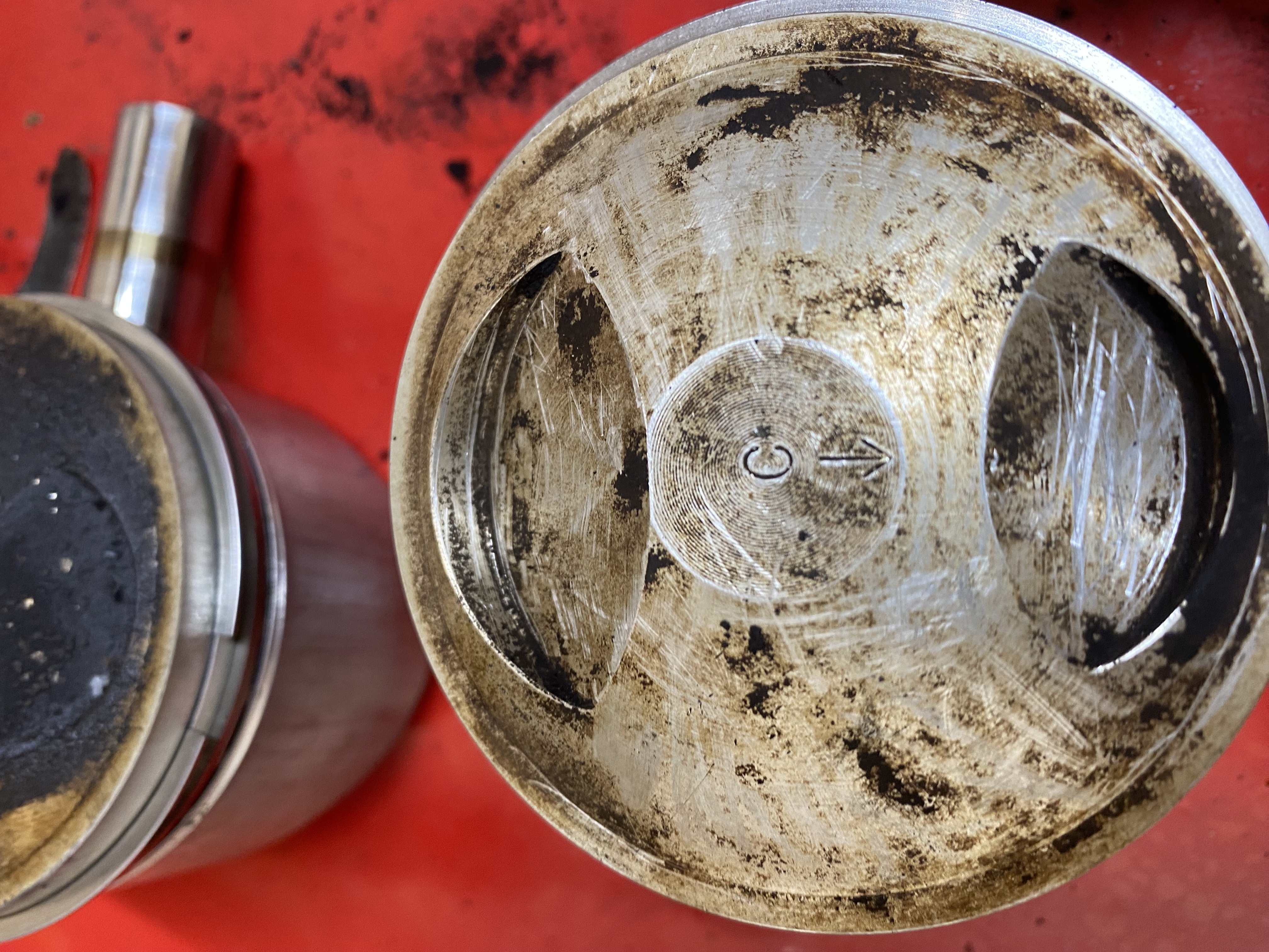

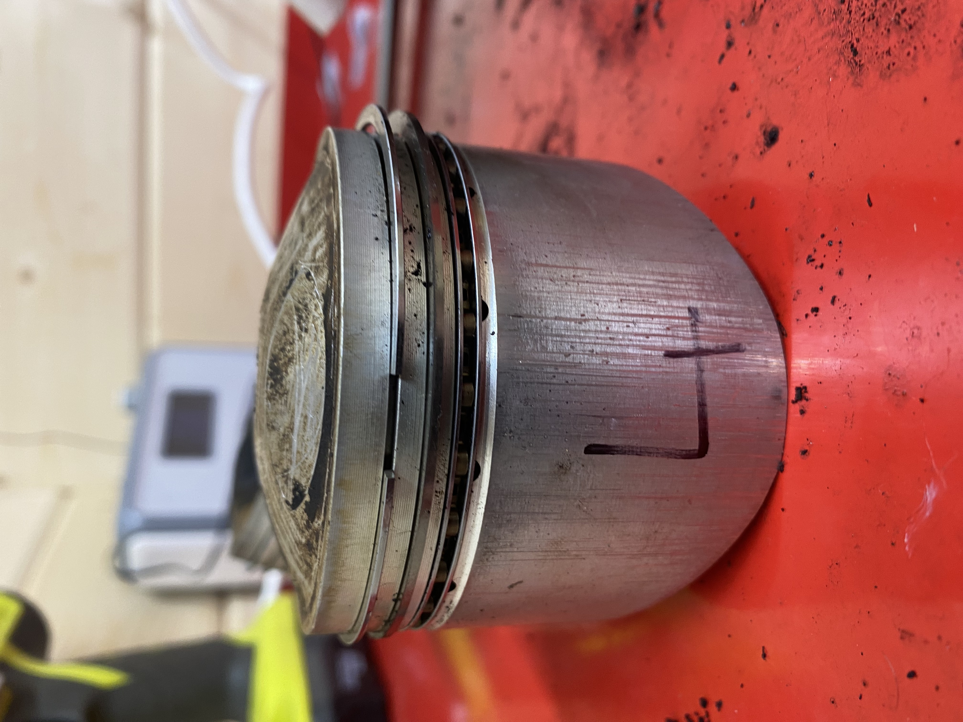

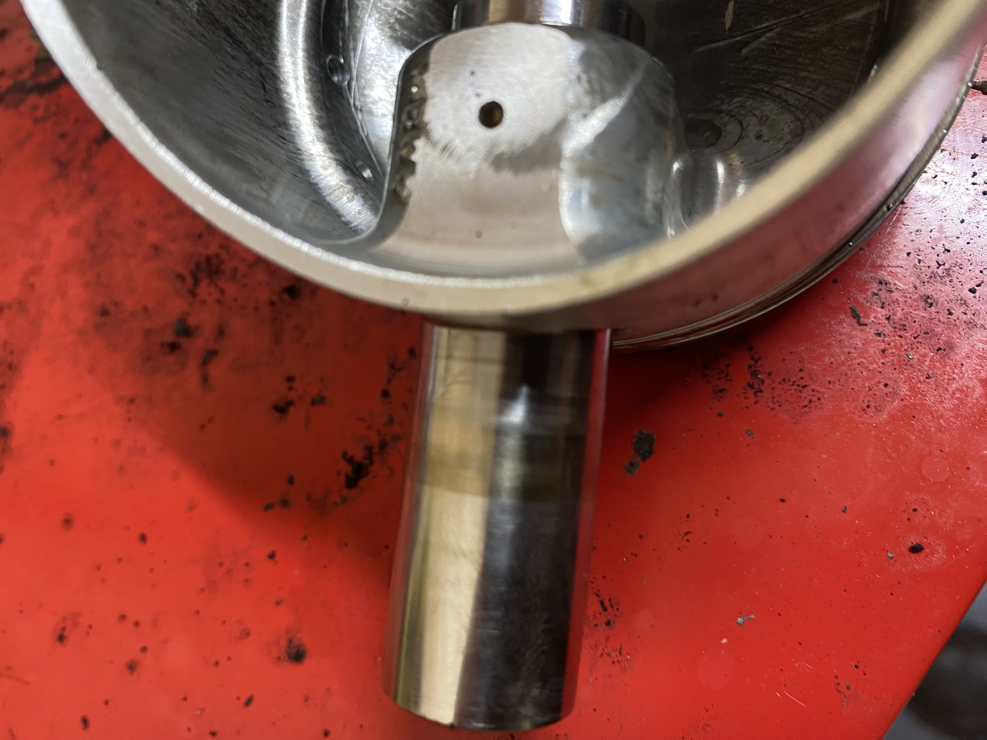

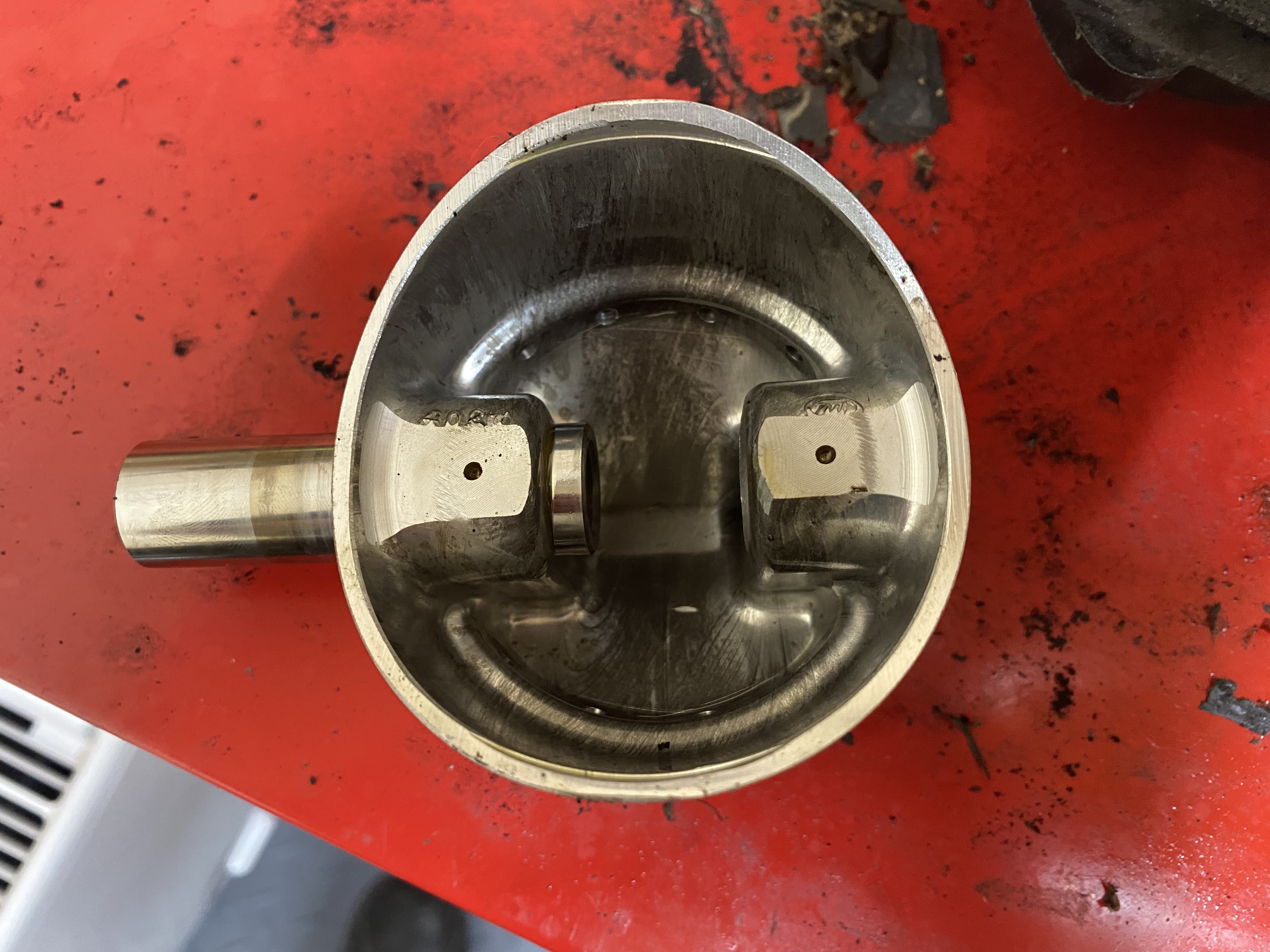

Here is some pics of the pistons can anyone identify them?

#10 PostAuthor: Robw » Mon Jan 27, 2025 6:30 pm
Look like Wiseco pistons to me.

#11 PostAuthor: stusco » Mon Jan 27, 2025 6:36 pm
High compression piston how could i tell?
It had low compression (115-130psi) and smoked a bit before I stripped it

#12 PostAuthor: Robw » Mon Jan 27, 2025 6:40 pm
Low compression, i have high comp in mine and the dome is much more pronounced

#13 PostAuthor: Robw » Mon Jan 27, 2025 6:46 pm
As you can see these 1170 wiseco pistons have a high dome. I had 1136 on my b1 and they had a dome similar to yours and they were low comp. J

#14 PostAuthor: Skid Mark » Mon Jan 27, 2025 6:59 pm
I agree with Robw. Mine look very similar to yours and are 9.5/1. Mine have two sets of no.s across the crown ( can’t upload from my phone) these appear to be laser etched so perhaps just new then yours.

#15 PostAuthor: Skid Mark » Mon Jan 27, 2025 7:01 pm
Skid Mark wrote:I agree with Robw. Mine look very similar to yours ( but without the small flat on the crown)and are 9.5/1. Mine have two sets of no.s across the crown ( can’t upload from my phone) these appear to be laser etched so perhaps just new then yours.
