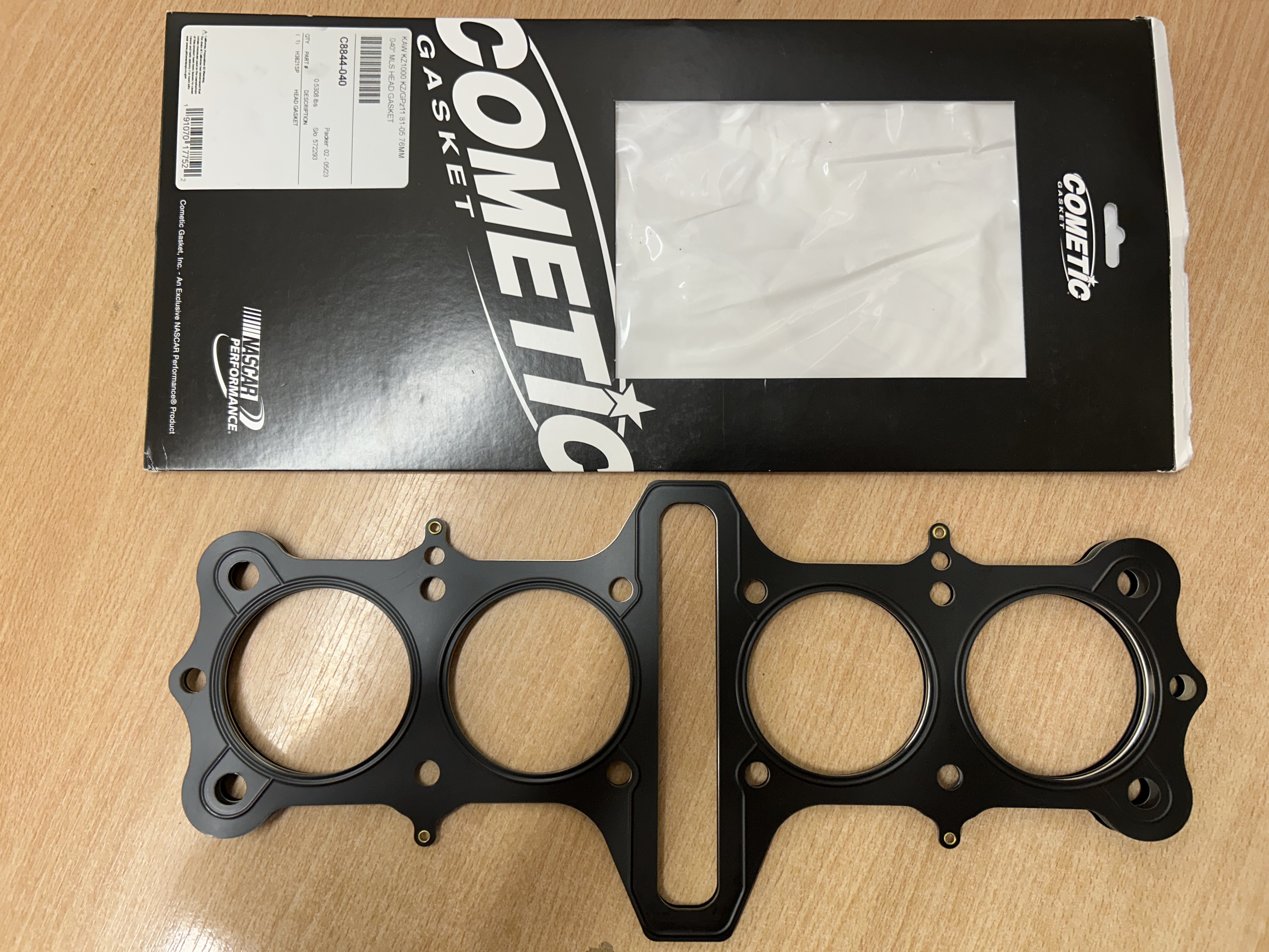

I finally got the head gasket for the GPZ1100 uni.
I know there are no guarantees that you can re use but to give the best chance, I have been told to use a spray on adhesive, I have heard copper spray and also to use nothing at all. Any one got anything else to say, just to really muddy the waters?!

You may have a chance of if sealing when re-used it if was coated with Loctite 3020 but for the first use do not coat it with anything.

zed1015 wrote:You may have a chance of if sealing when re-used it if was coated with Loctite 3020 but for the first use do not coat it with anything.
Thanks for clarifying, that maybe where the mixed messages came from! I wasn’t listening!
