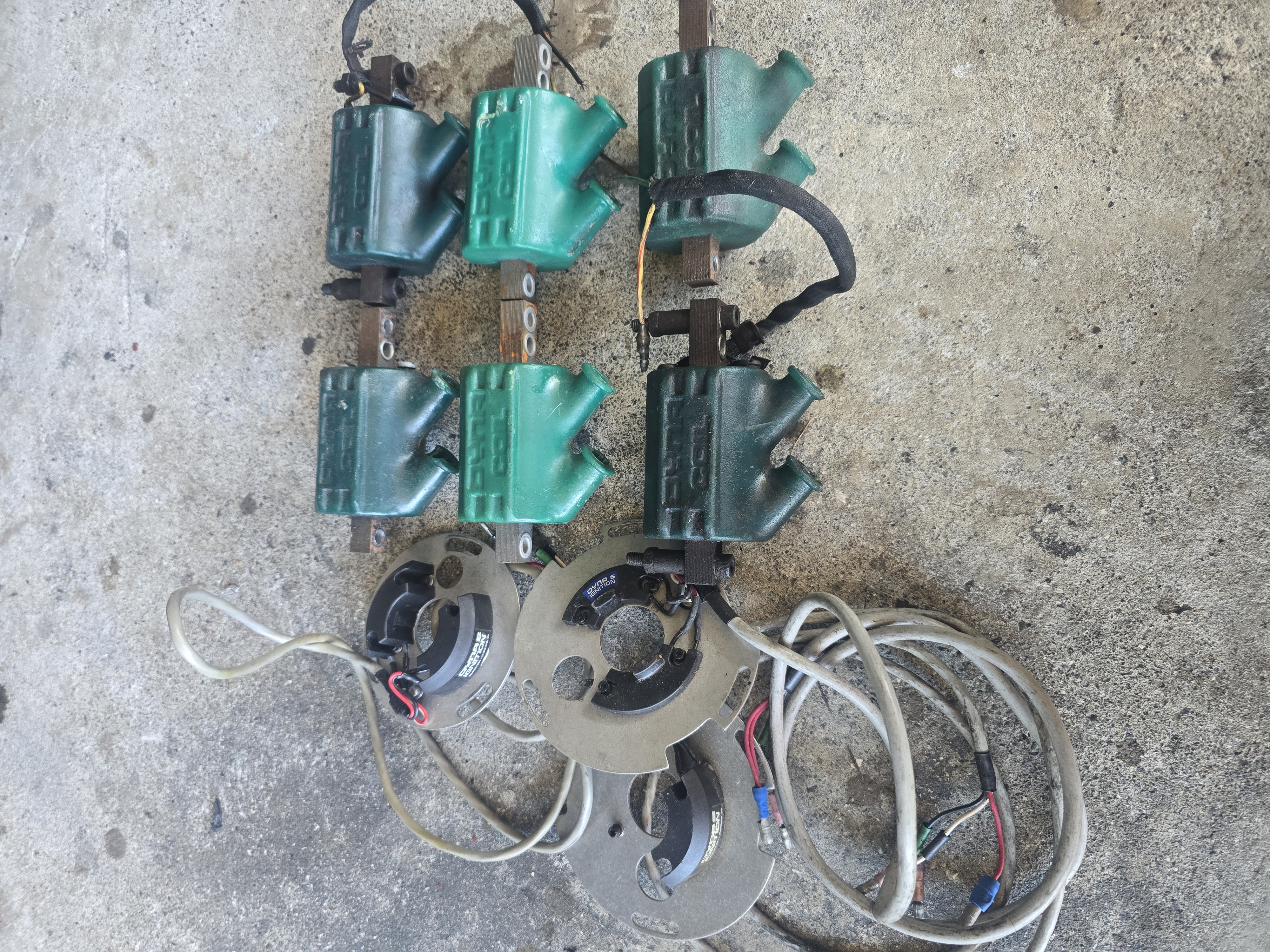

Yes I've had two fail of the past few years burnt out and melted.
I've been told from a very well known racer and restorer (now retired) in these parts.. That this is common you get one's that go forever and you get one's that go fizz! I guess what do you expect from something made by Randy in Bum F#@k Alabama.... p.s the coils are very prone to failing as well!
I see that you can now buy what looks like the same pick-ups from Aliexpress, maybe that's where Randy is getting them from in the first place?
Here's a picture of a load of dead ones and I only have 3 bikes, steer clear I say.. oh two of them are still running Dyna ignition but
now with standard coils, it took all those dead ones to make them work!
