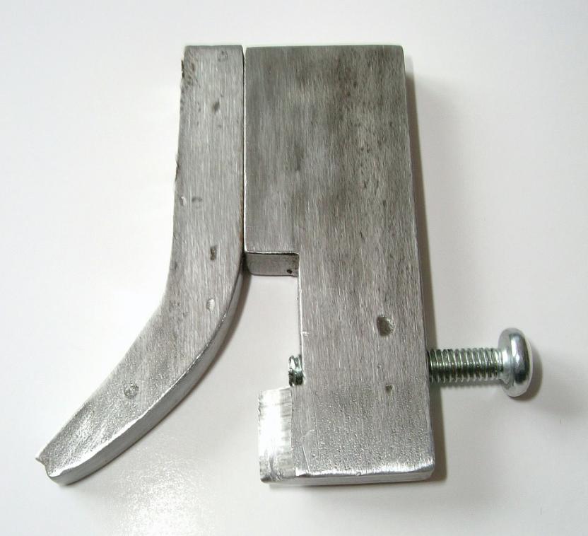

Just came across an old post on KZR about changing shims using a cable tie. Beefy cable tie bent in half and crimped with pliers then put a bend in the doubled over end. Open the valve and having removed the spark plug slide the 'special tool' between the open valve and the seat via the spark plug hole, reverse the crank and lift out the shim?
Anyone tried this or is it better to buy the real tool which varies between €30 to €100 depending on who makes it?

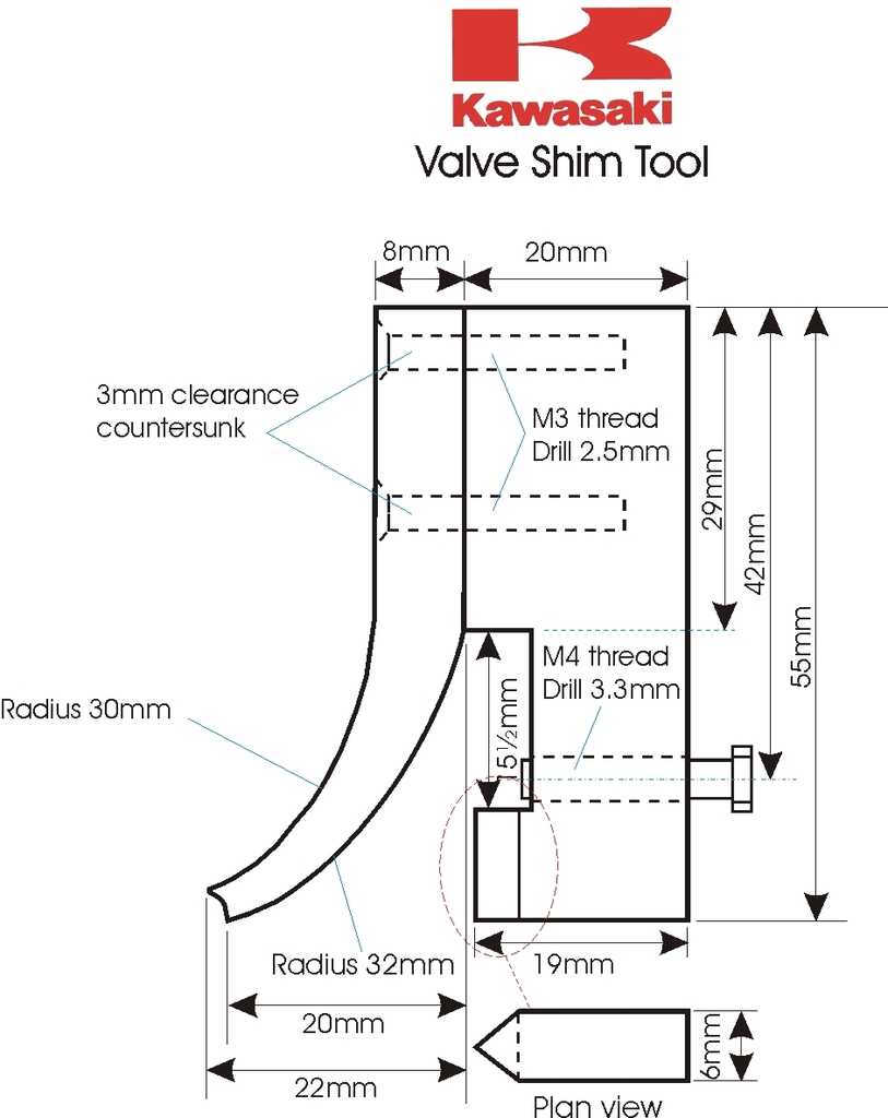

Voila fais-en toi meme :up

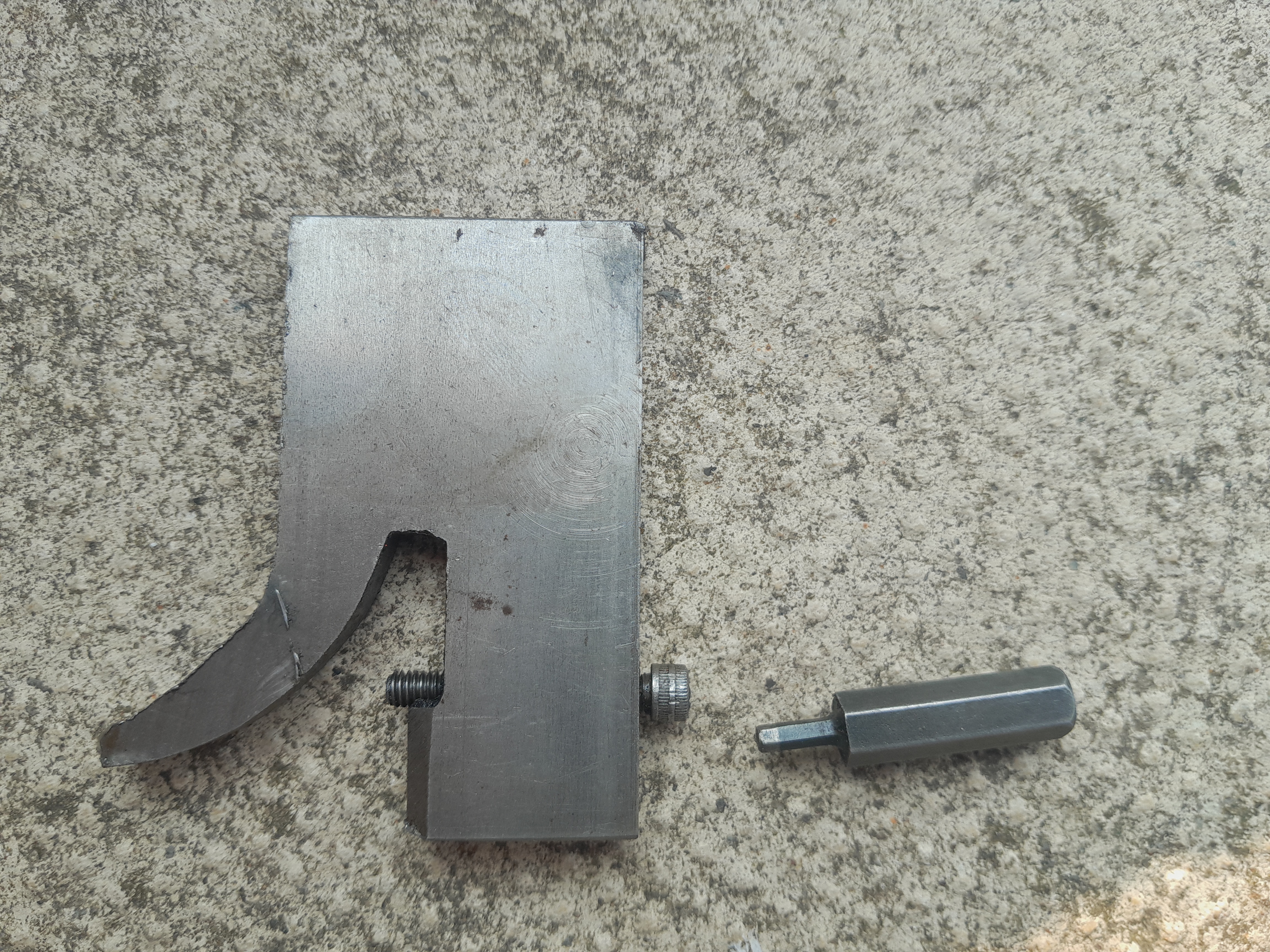

My dad made me this one in 1979 for my A2 and I am still using it on my J2. My local kawasaki dealer loaned me one and dad took it to work without telling me and came home with 2.

Keith, thanks for the eng drawing, nice and detailed.

There is a second tool it is ‘W’ shaped and it usually comes with a small lever. I have both but only use the one pictured above. But the lever is handy for removing shims. Not sure this info is much use but may be less expensive then the one above. But one session of setting shims and it’s paid for regardless of what you use.
