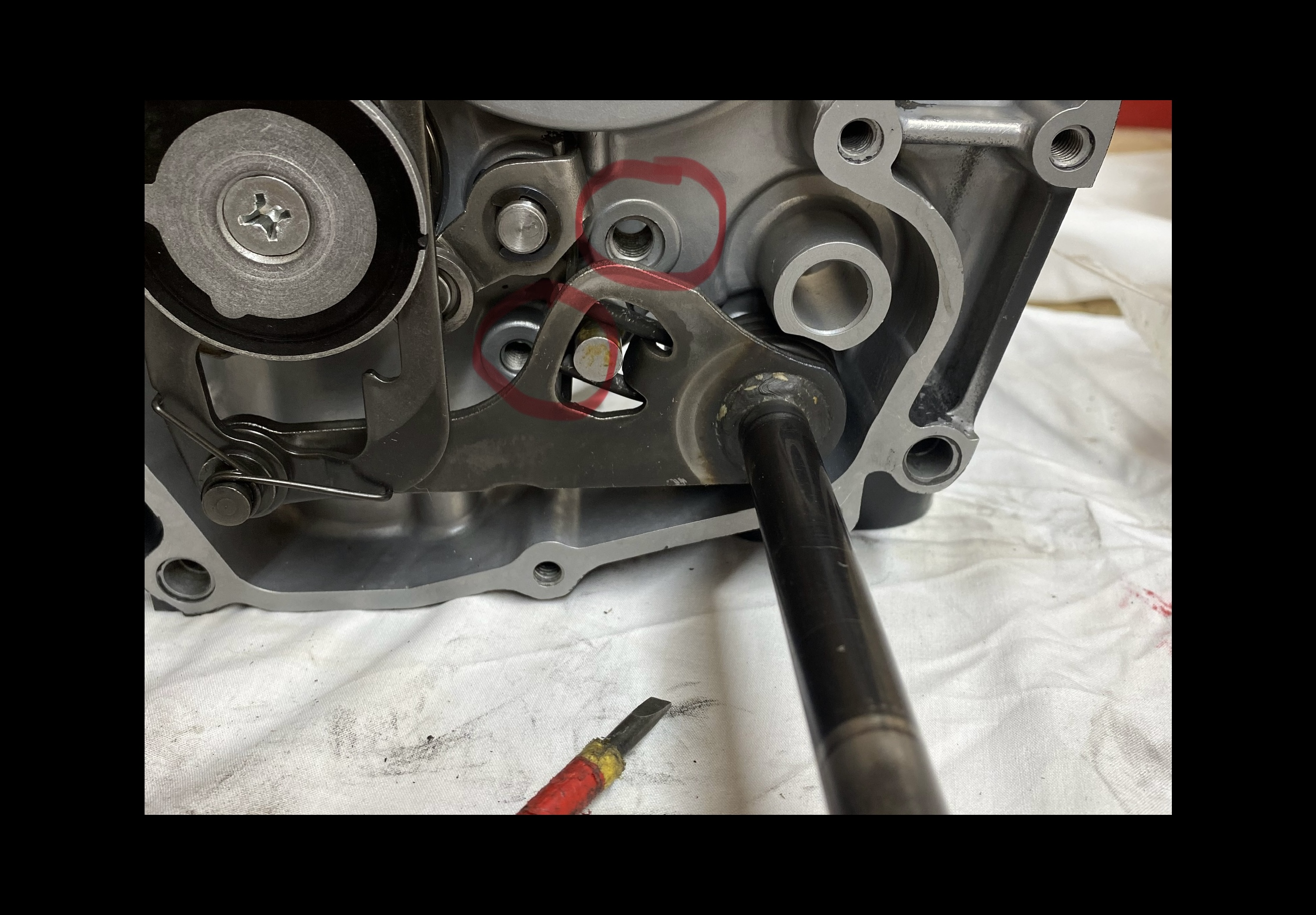

What are these holes for ? Ive managed to loose my pictures of this area when I stripped the engine

Those mk2 cases are common for both the chain drive machines and the shaft drive ST's.
The spare holes and the alternate position for the gear selector shaft are only used on the shaft drive version.

#3 PostAuthor: stusco » Mon Jun 09, 2025 3:38 pm
Cheers quick with the answer as usual thanks again
