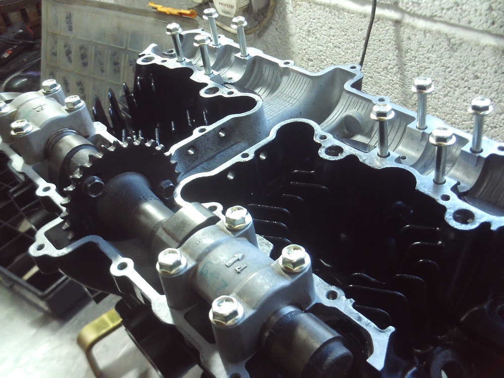

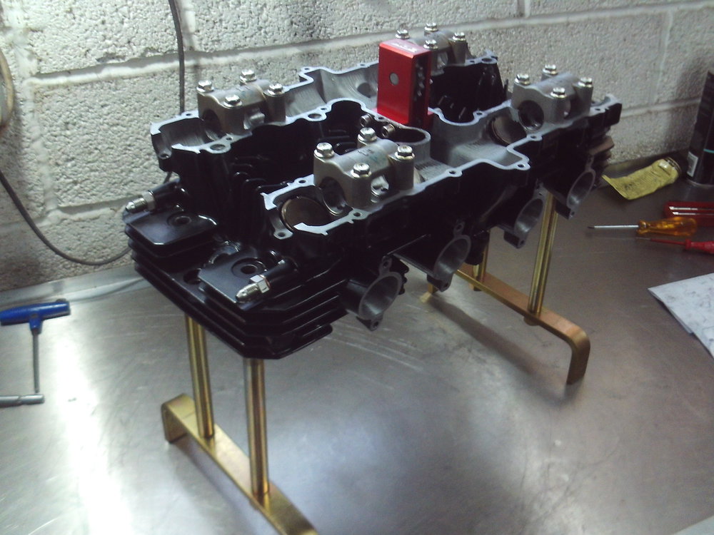

The stripped threads should be an easy fix.
You can actually drill the holes deeper if needed and fit 20mm helicoils.
The genuine Kawasaki bolts are around £4 each but you can buy exactly the same spec bolts at 28p each from the link below.
You can pick the length you need ( 50mm if you fit the 20mm helicoils )
https://www.ebay.co.uk/itm/114307030889 ... 4558257426
Here's a pic of the latest head i've done.
With the bolts being longer there is a lot more thread engaged in the head before they start pulling the caps down so no need to clamp the cams as some people do.
They are never going to strip again after this..

Guys, thanks for all the interesting advice on how to go about resolving this but as luck would have it I managed to obtain a very good 2nd hand R2 cylinder head today that can go straight on once I've lapped the valves in a put new valve seals on as a good measure.
Thanks and let the good times roll again, Pip :D
