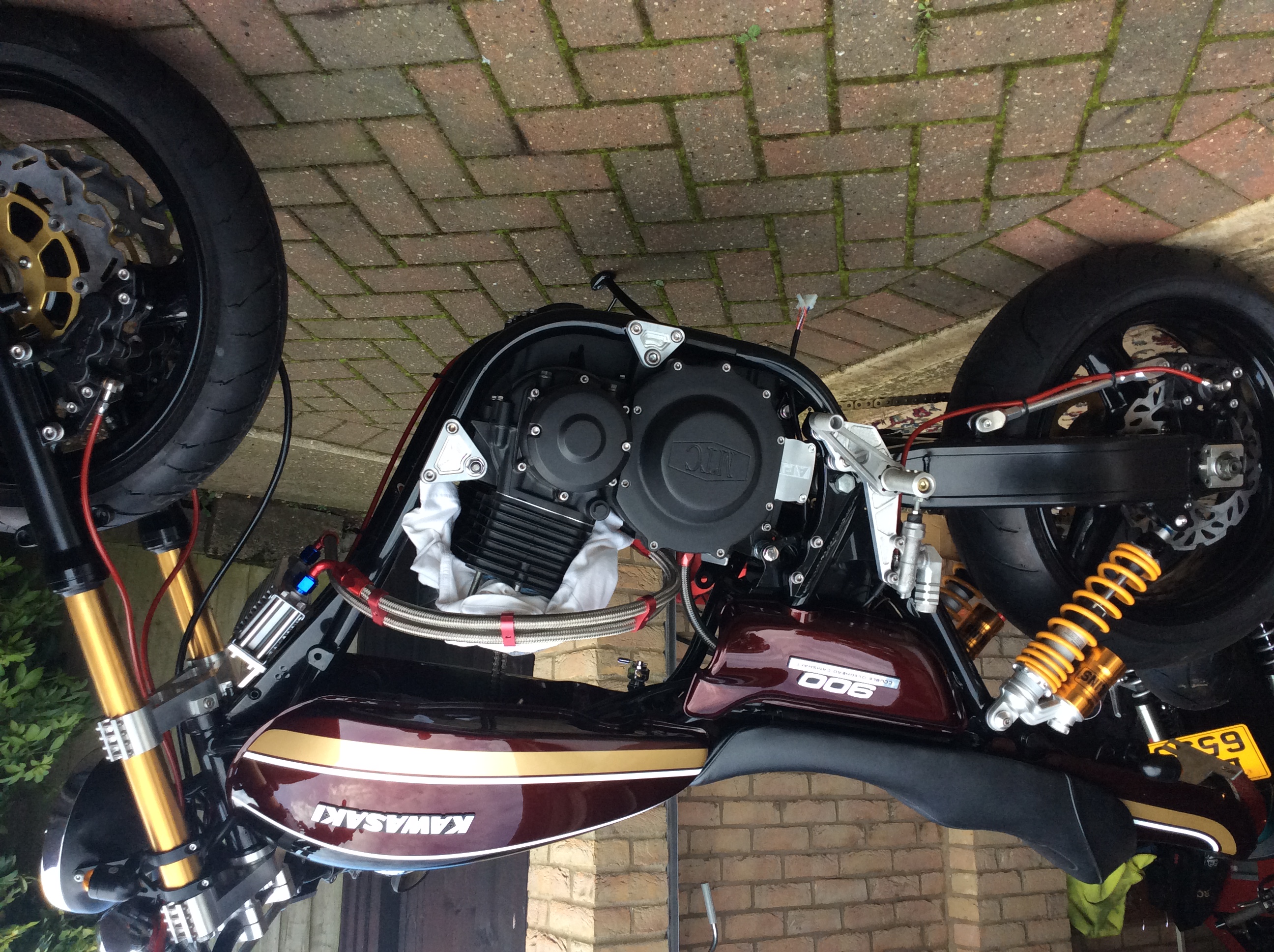

Pics of my new build outside for first time

Very nice job

Those must be serously grippy tyres :)

its being built in australia. :D
Re: My new build
#5 PostAuthor: Ultim8pc » Sat Mar 04, 2017 9:28 pm
As I said on BookFace - very nice indeed!
