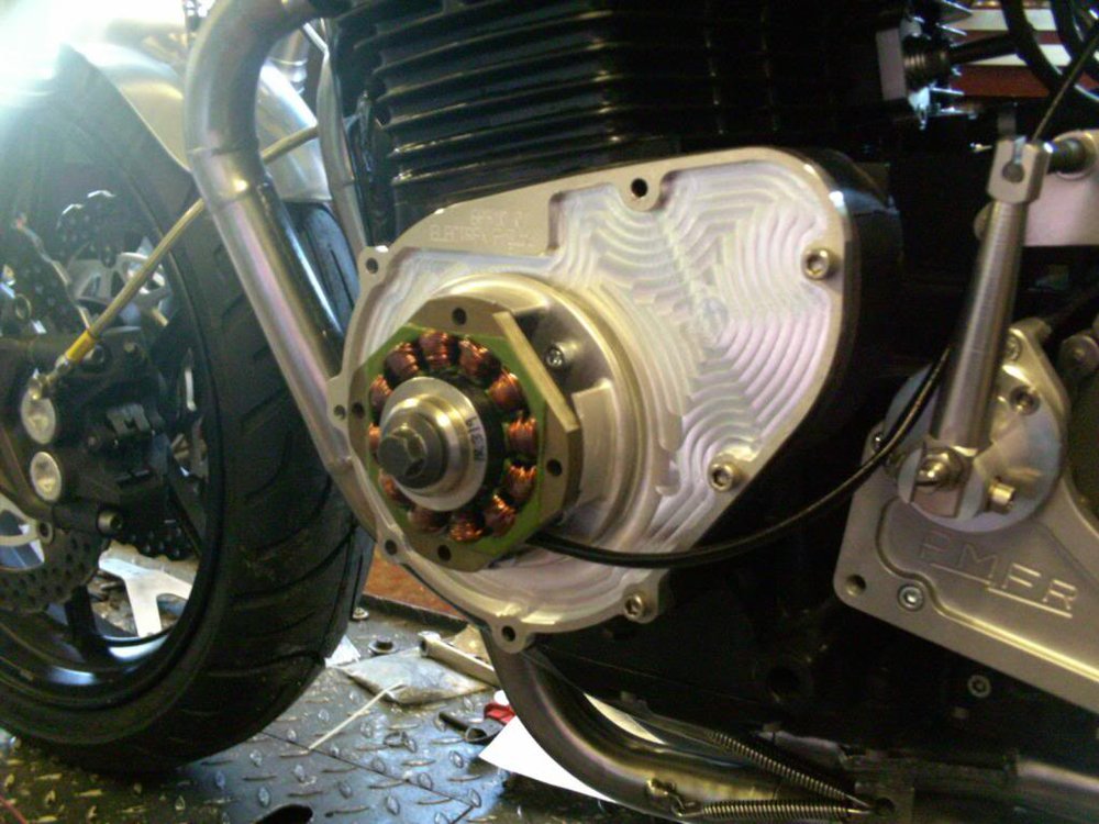

This is the RPK3190 kickstart only version that i run on my alloy cafe.
The oil gallery issue of the starter motor version isn't present with this one and once i sorted the misalignment of the rotor and stator ( 6mm off center of the magnetic field ) which severely affected the output it's been faultless ( touch wood ) for the 10 years i've been running it.
The lighter rotor makes a noticable difference to the engine response too .

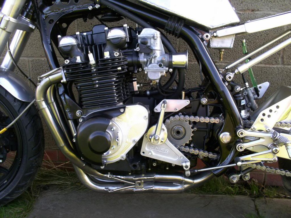

Thanks both Al and zed1015, that has been a great help. One final question , I am presuming from the catalogue and the picture of zed1015's bike that the RPK3190 is designed to run with no outer cover. Is this correct?
Re: Charging
Steve M wrote:Thanks both Al and zed1015, that has been a great help. One final question , I am presuming from the catalogue and the picture of zed1015's bike that the RPK3190 is designed to run with no outer cover. Is this correct?
Yes! It bolts to the cases with the stock gasket and has an oil seal on the crank behind the rotor.
I modified a spare alt cover to act as a stone guard etc.
If you decide to buy one then read post 389 and onwards in this build thread regarding the rotor / stator misalignment , undercharging and oil seal position.
It will save you some grief further down the line..

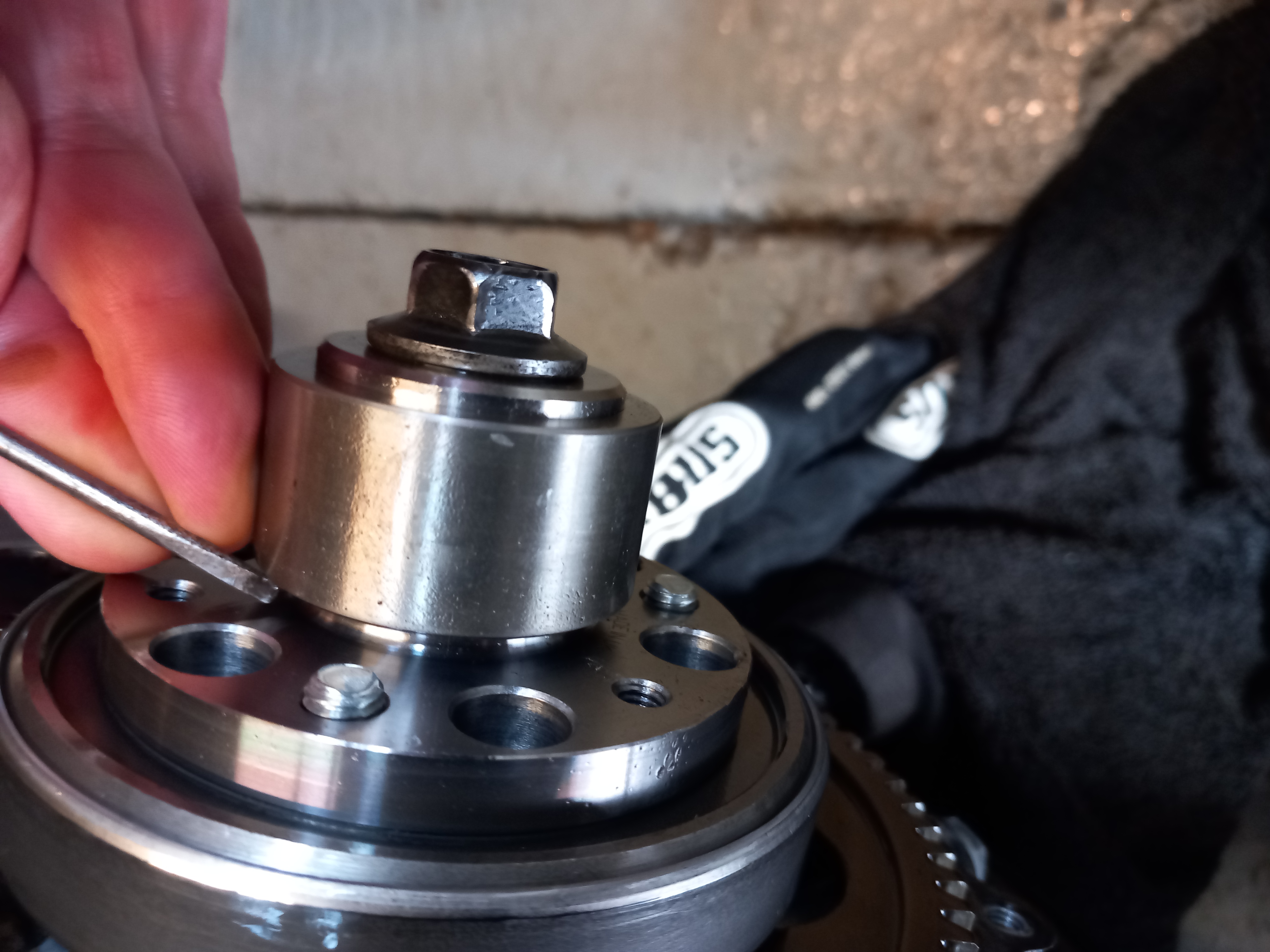

Just had a chance to test the location of my rotor to stator situation. I replaced the rotor last year (reasons a little above this post).
It was apparent that when putting the outer casing on,.. the cover with the stator would be snatched out of my hands and slam itself shut. I took the rotor off and put three x 1.5mm washers behind it and tried again. With that extra distance the cover would resist closing fully and would spring back out just a little so i removed one of the 1.5mm washers and that made putting the cover on 'neutral'... no pull and no push required to have it seat correctly. So i have ended up with it being 3mm further out than fully home. These tiny rotors are not mass produced so i cant say if the bias of 'magnetic centring' is the same for all.
There is still plenty enough room for the crank centre bolt head not to hit the outer cover on the inside.
3mm gap

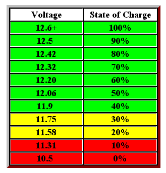

Something else i have been meaning to do for ages; electrical tests. Really no idea what i am doing here but i'll leave you to interpret it.
Started off with a battery static voltage of 12.55 Volts everything conected but not running.
Turn on ignition and get volatge down to 12.49 Volts.
Start engine and get around 12 volts at 1500 RPM.
Rev engine to 3,000RPM and get 13 Volts and climbing nicely with revs. Below 3,000RPM its fluctuating but around 12 or a tiny bit more volts but not enough.

DC V at battery, generator reconnected;
Static battery voltage 12.45V
2,000RPM 12.0 DCV
4,000RPM 13.6 DCV
5,000RPM 13.8 DCV
6,000RPM 13.8 DCV
The battery Voltage drops off below 2,000RPM because of the draw by the Dyna 2000 ECU and doesnt begin to rise above 12V untill above 2 to 3,000RPM
