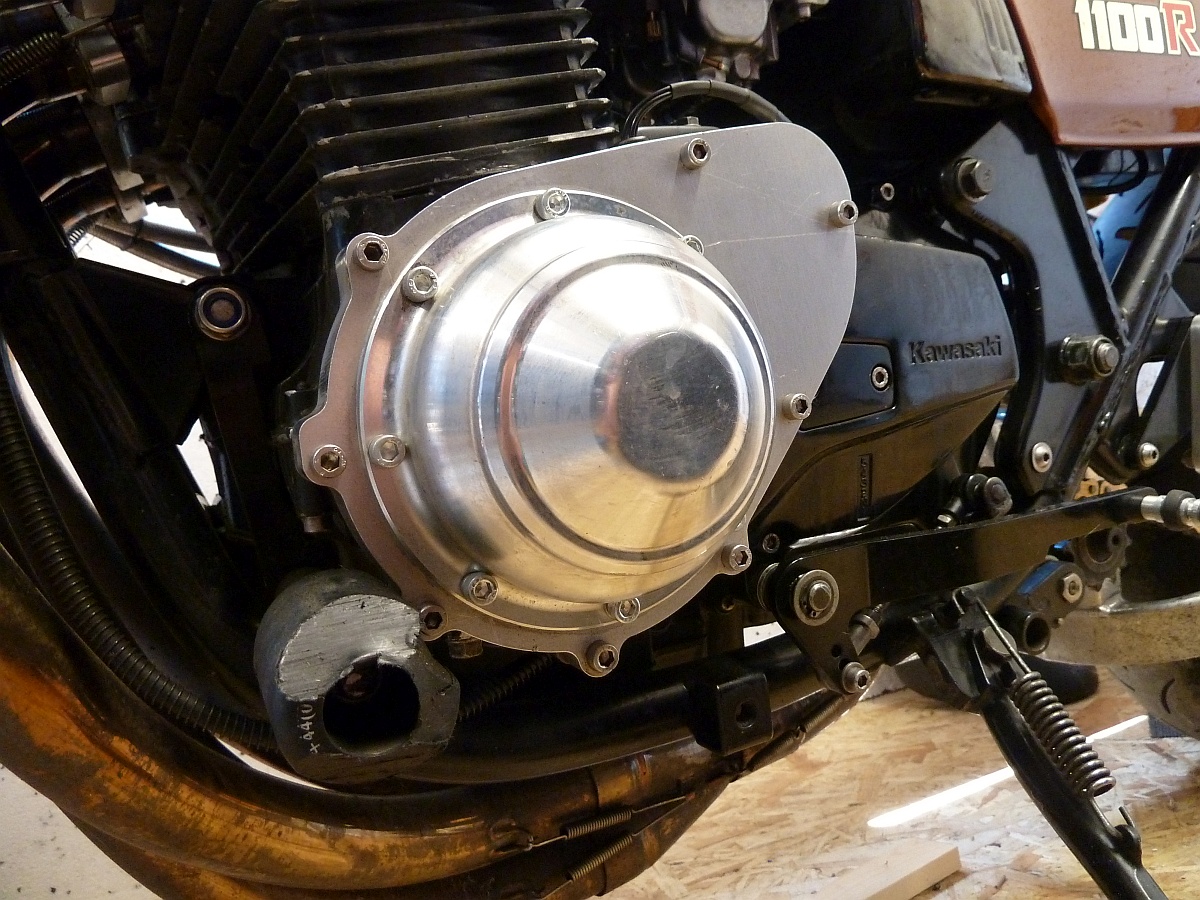

Agree Rob and i know that Brian1100 just bought one for the 1100R the same as the one i intend to, but it had bits missing and there aint a lot to it.
The extractor was absent, the standard centre fixing bolt is too long and the outer cover appears not to come with a gasket! Its also not obvious what torque setting to use for the bolt as this does not feature in the fitting instructions.
He cut down the original bolt, glued the cover on (hub cap from a MK1 Escort) and eventually they sent the extractor.
WRT torque setting; he used a reduced value so as not to crush the magnet rotor core. Standard is a massive 116 lbs /ft and i think he said around 80 lbs/ ft and its been fine.
I think the difference with this one compared to yours and Martins' is that for the extra £100 you get to keep the starter motor and the unit itself has the cover provided (see above where they probably get them) so its fully sealed. I think it all runs in oil so the difficulties you both encountered arn't there with this version. Hope not anyway or i'll be over to Reading on a day out.
Another bonus is i dont have to take this bastard great thing every time i leave the house :D
Here's a pic of his one fitted. We both intend to have the inner cover painted black!

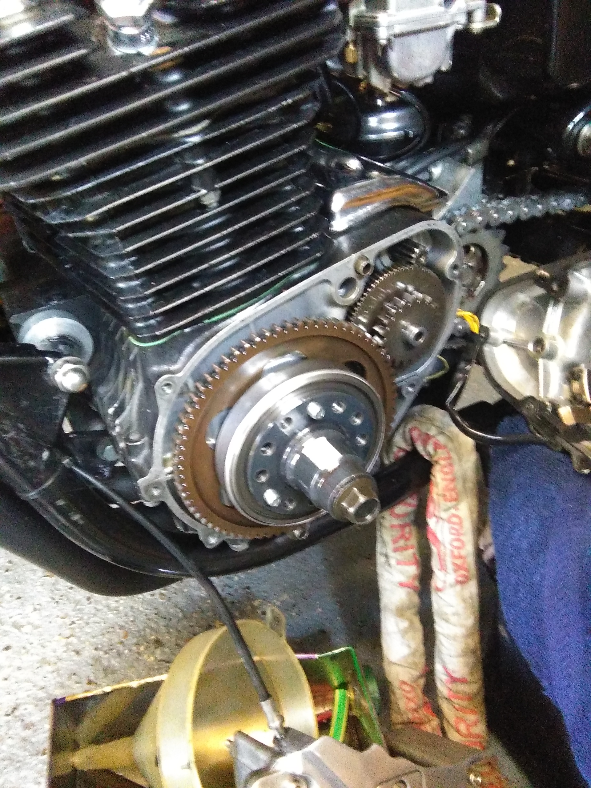

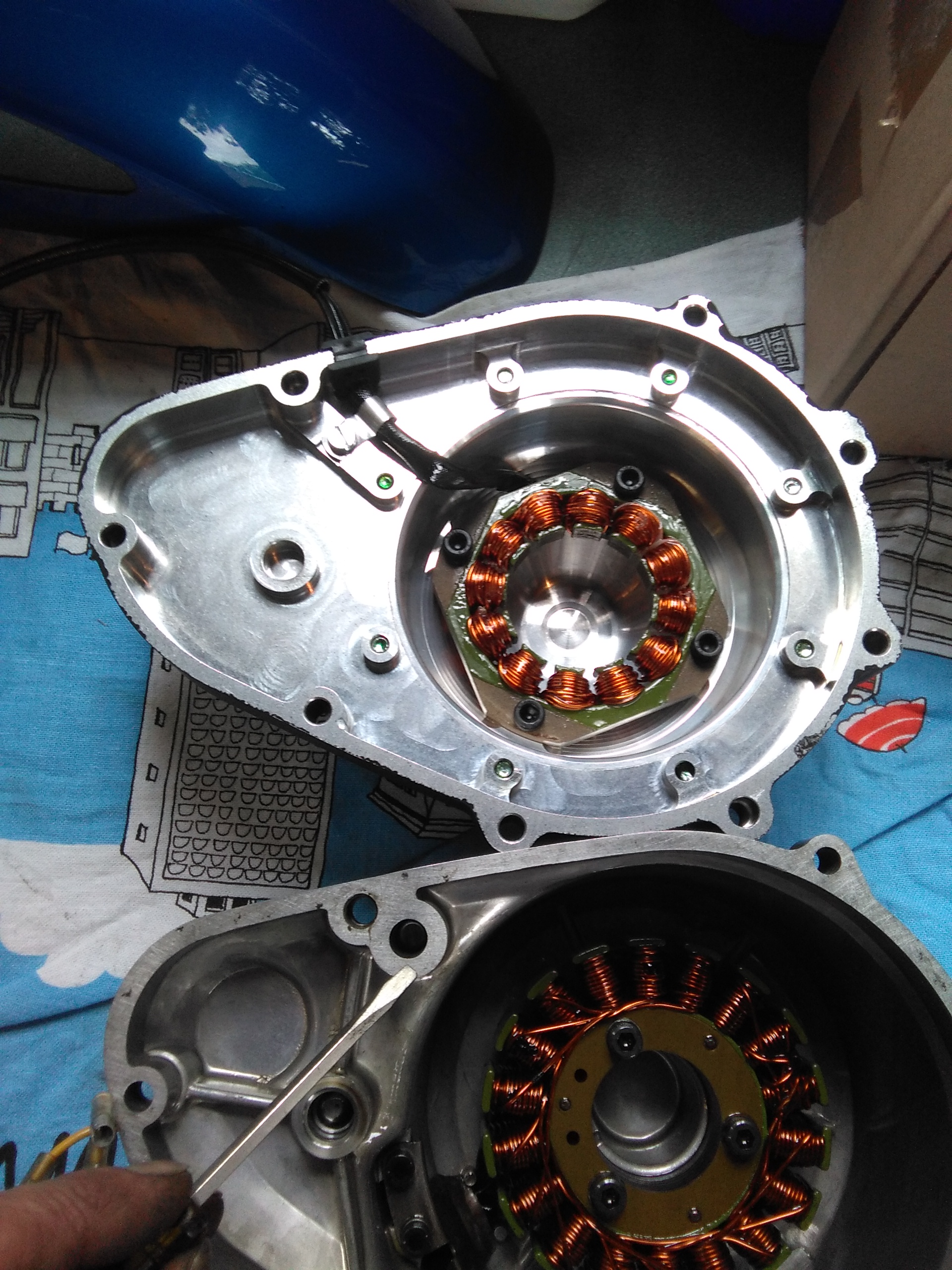

Stripped off the old alternator and cover.

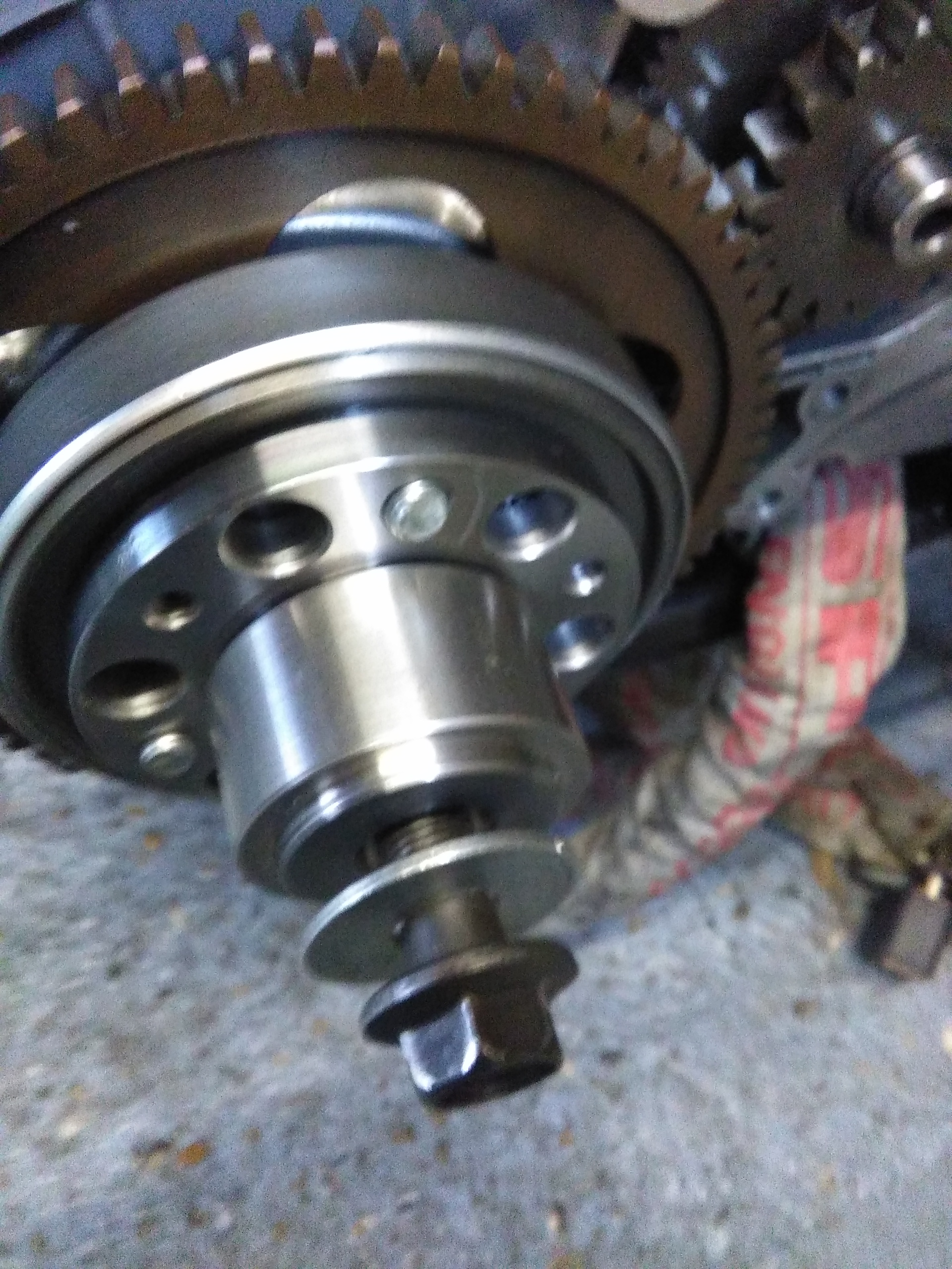

Mounted the new drive flange with the original starter clutch and decided it needed lapping in.
After lapping it in i found that the free wheel wasn't and then that i was missing a very large diameter shim from between the starter clutch and the new drive flange. Never had one before but found one laying about so used it and got the right clearance for the freewheel to do just that.
With the new tiny rotor mounted to the drive flange it was apparent that the centre bolt was too long so i trimmed 7mm of its length.
Now discovered because the new rotor assembly is shorter that the original the plain shank of the bolt hit the threads in the end of the crank.
No problem i'll just add a washer as i dont have a 12x1.25mm die.
This is the standard J rotor with the magnet body removed.
This is the EW drive flange and tiny internal permanent magnet rotor.

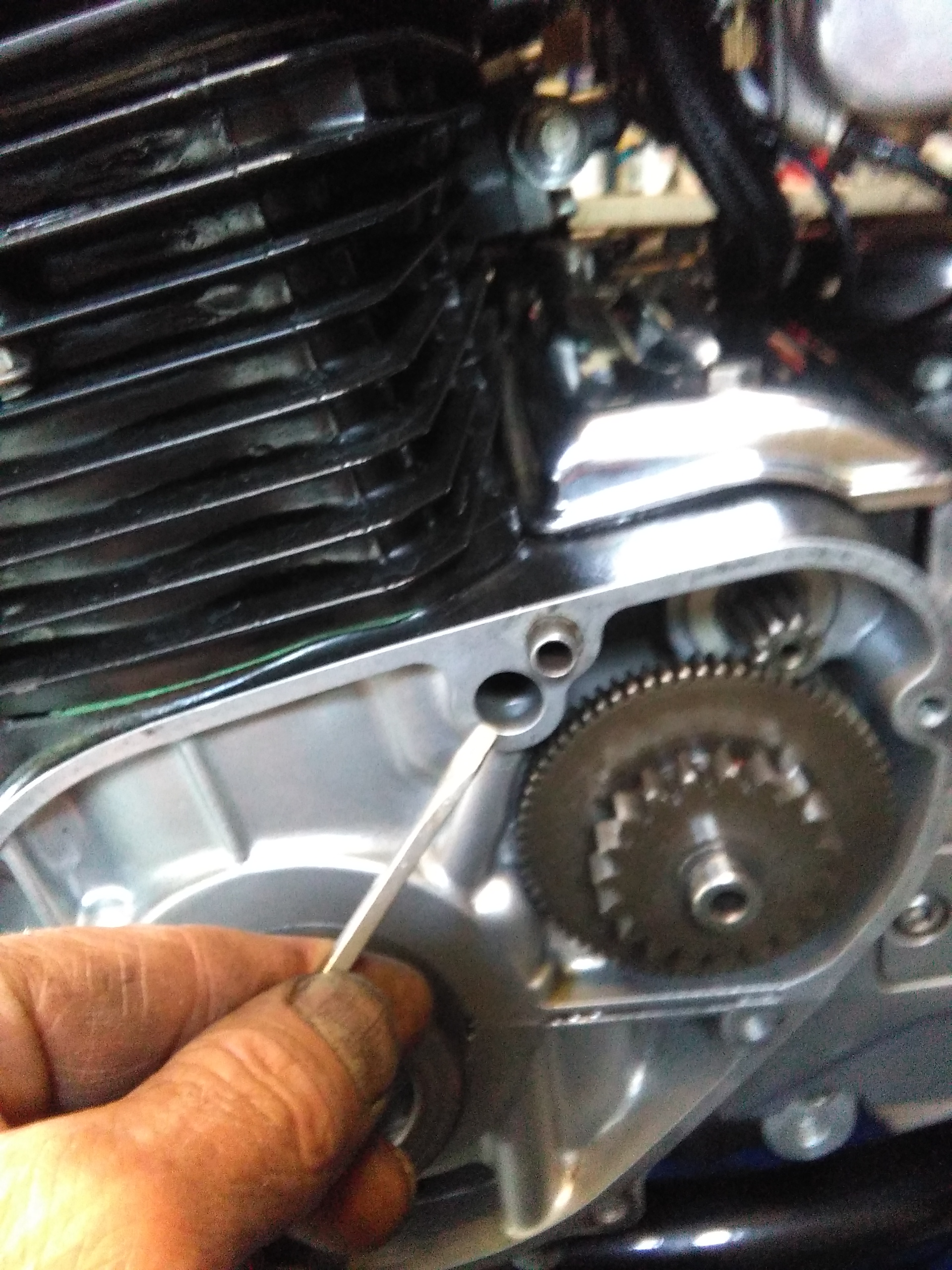

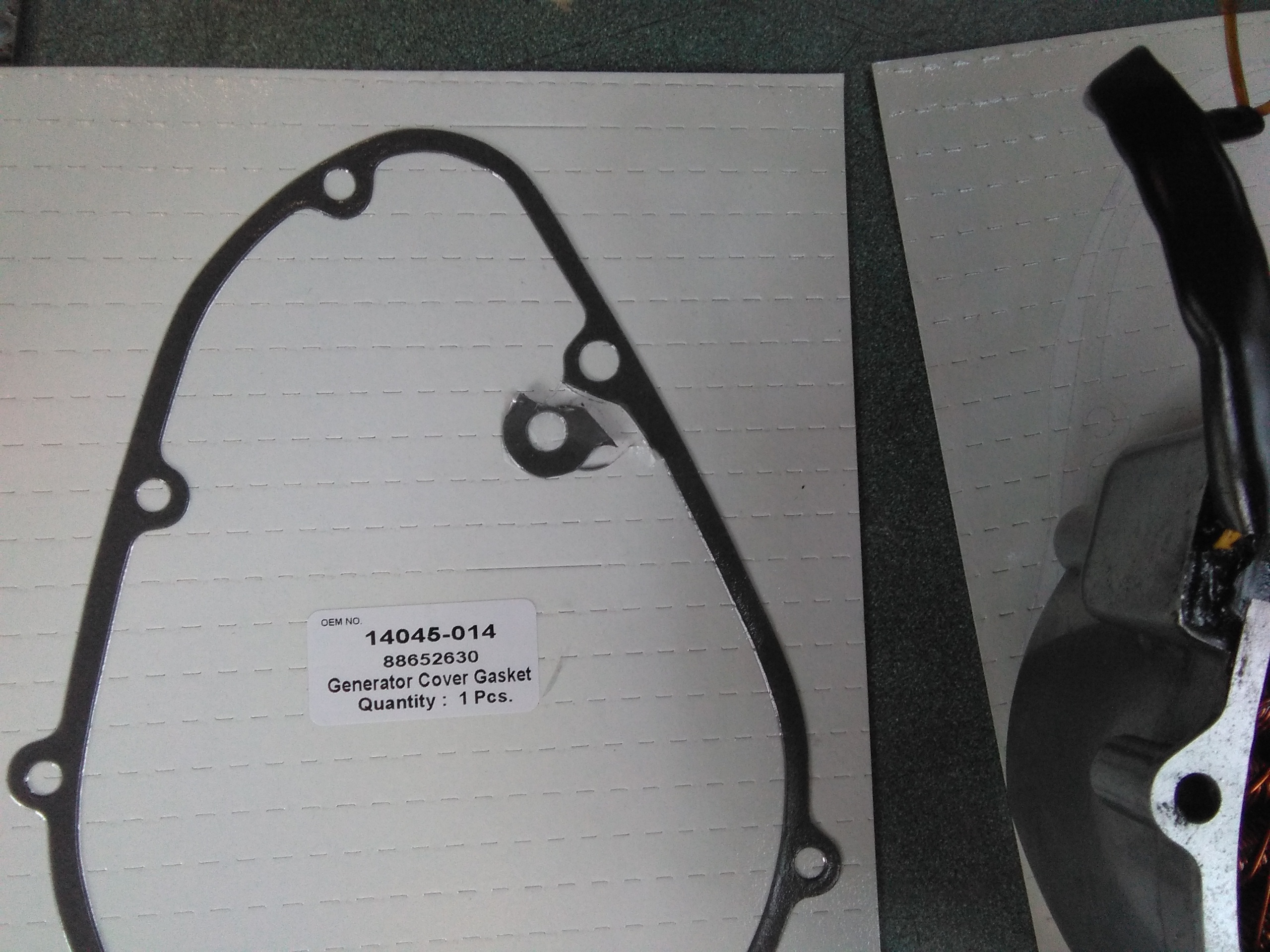

So looking about i noticed that the original outer casing has a 'blind' cast boss which blocks off the main oil feed gallery which runs along the back of the barrels in the crankcases.
The new EW one does not. Worse; its where the wiring grommet for the output has been placed.
Had a quick reality check and pm'd Rob zed1015 and he agreed that
with it left open the full flow of the pump would just empty itself into the new casing and short circuit back to the sump!
Cross drilled oil feed gallery.
Screwdriver pointing to 'blind' boss which blanks off the gallery.
Above it is the EW race alternator with the wiring grommett in the location where the boss should be.

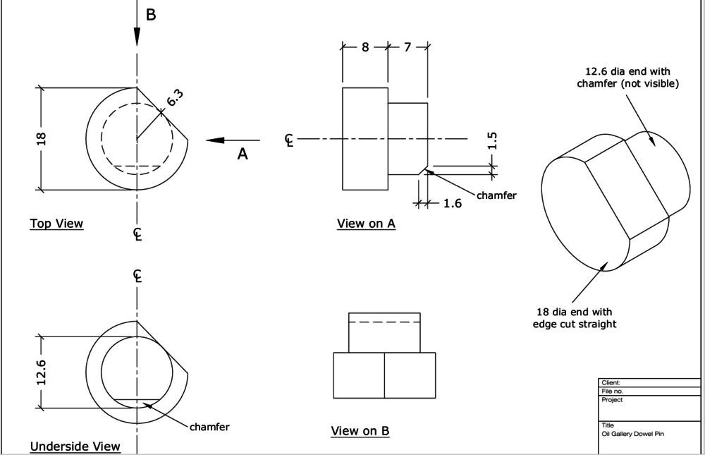

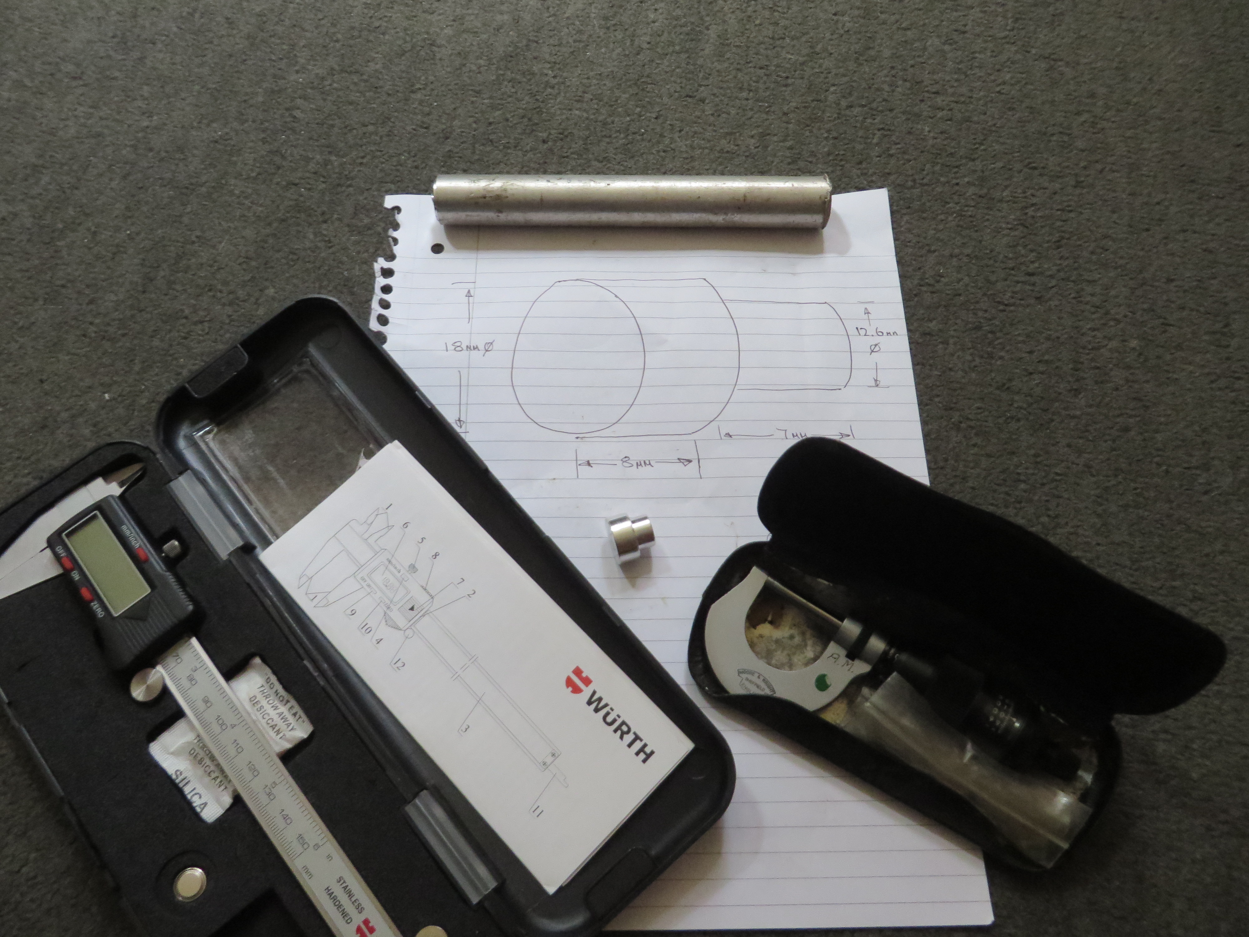

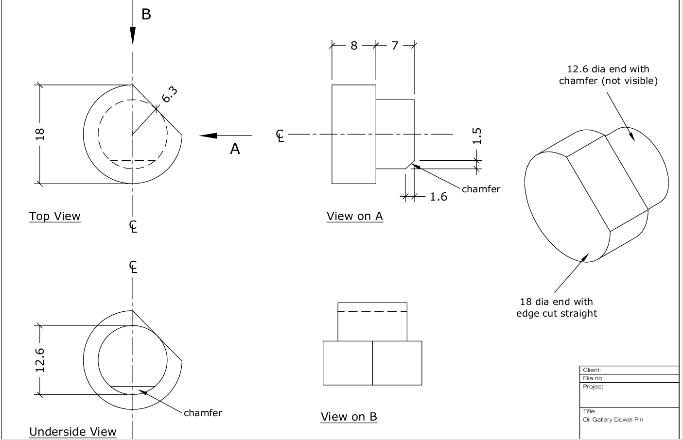

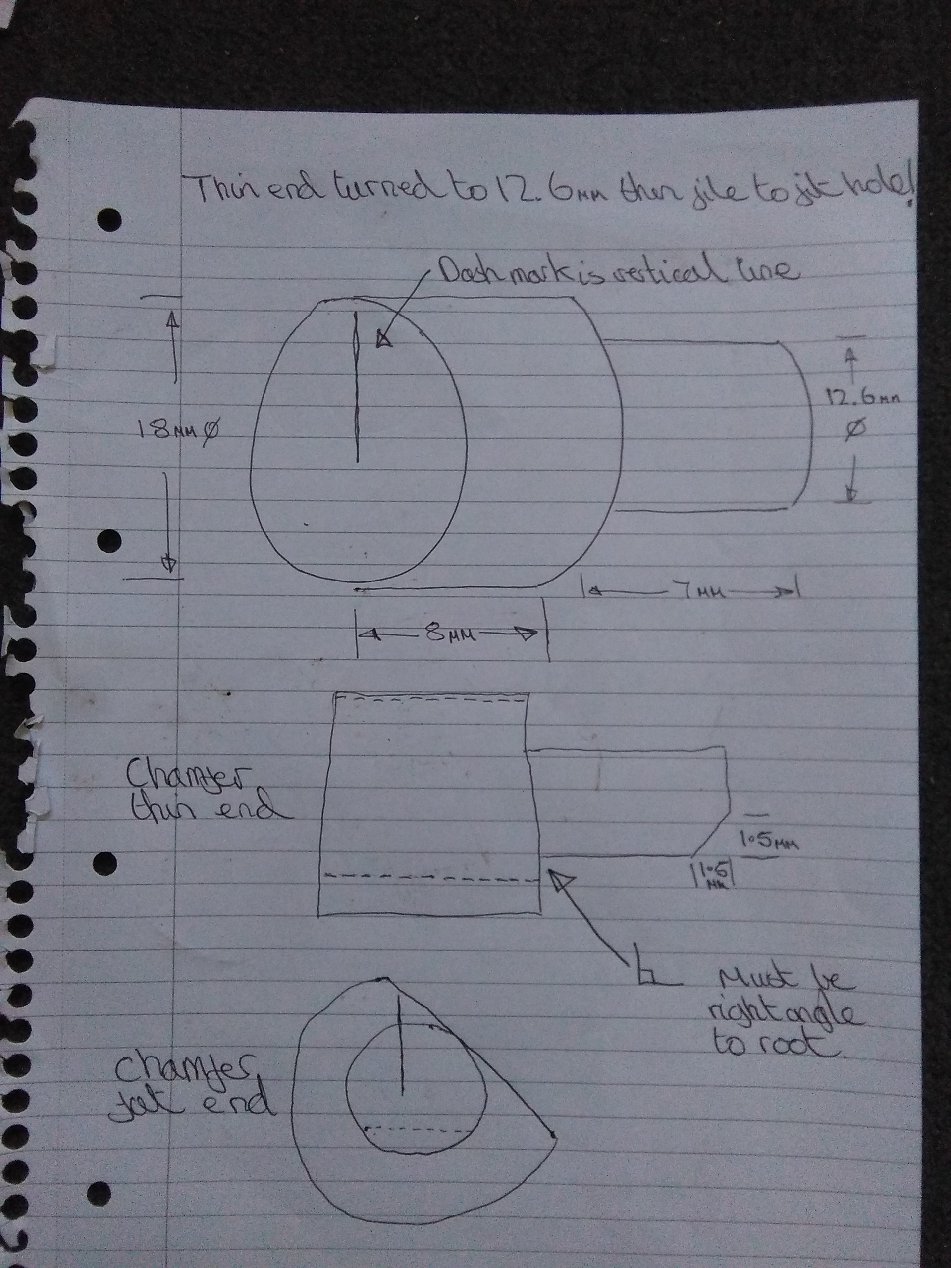

Rob zed 1015 had suggested a bung or plug for the gallery and that is what i have done.
Fortunately for me we have a lathe at work but had that not been the case and likewise for others there would have been another cost implication.
Here is the plug made up

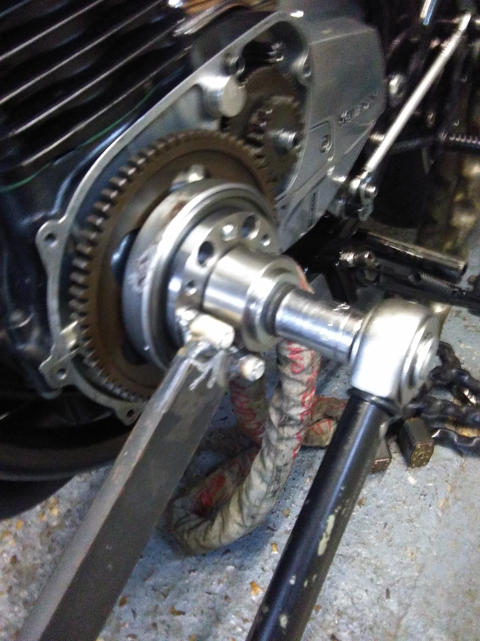

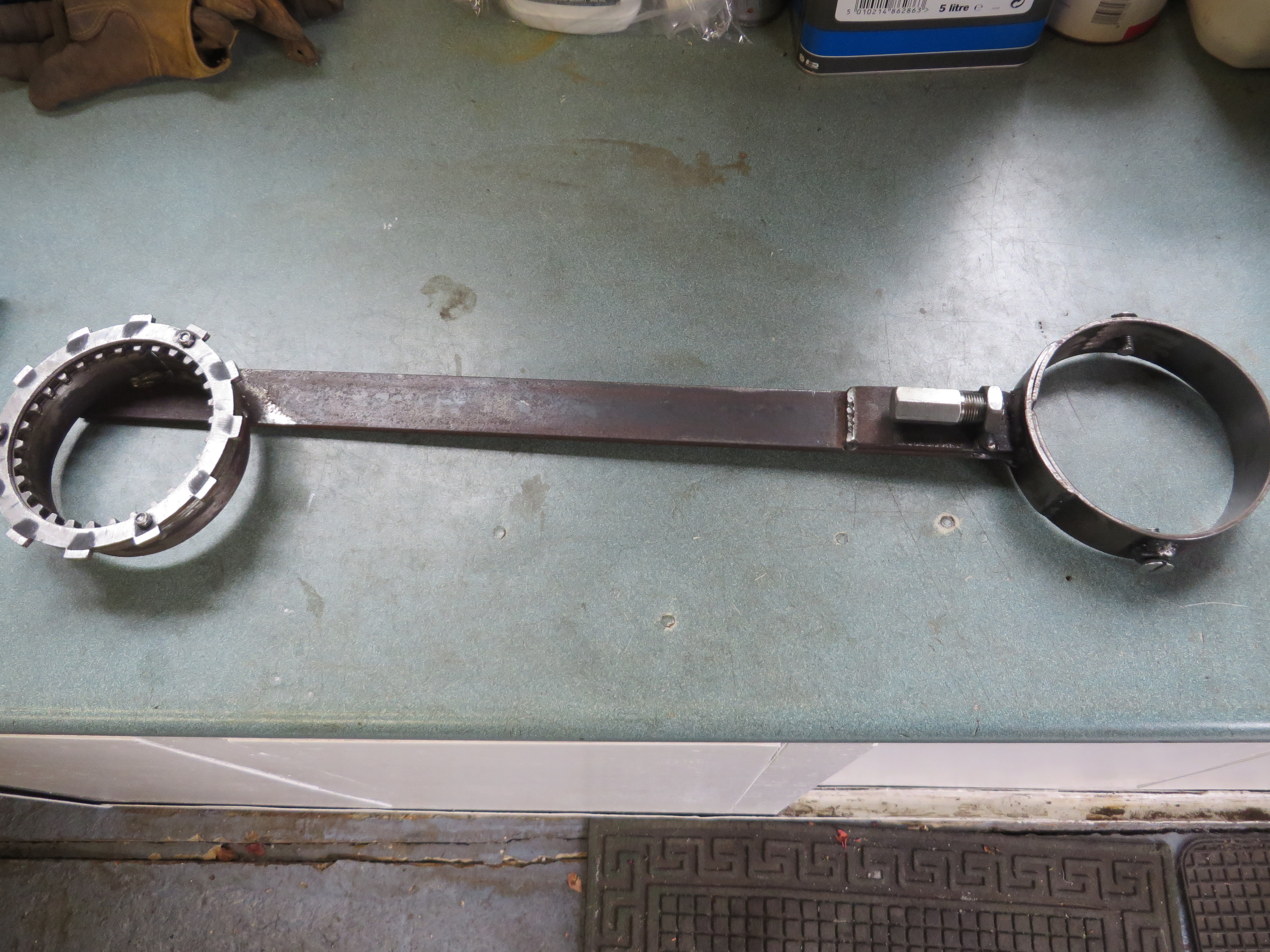

And fitted. Made up a simple holder for the rotor as there is nothing to grip whilst tightening / loosening the bolt
Using a bung in this way requires that the gasket be cut down to fit round it not under it.

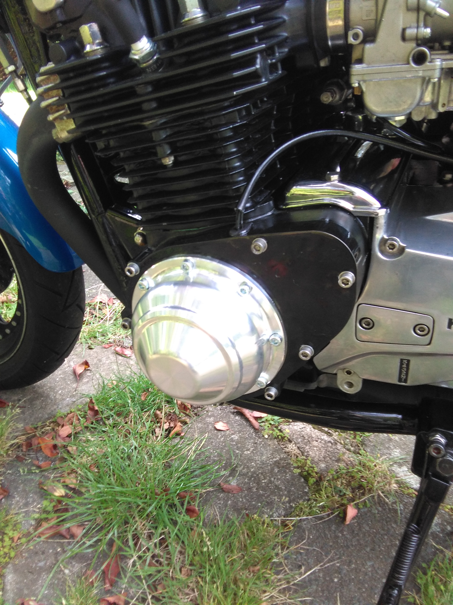

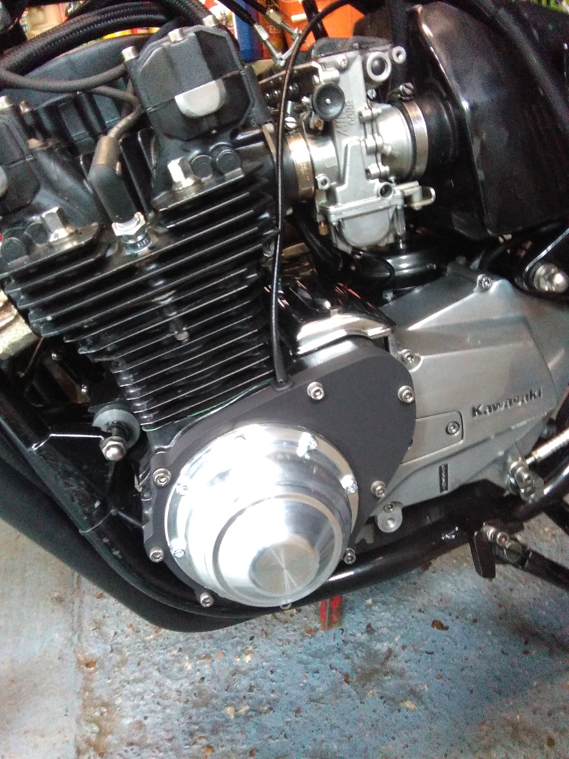

Painted matt black but that didnt work so stripped it.
Painted gloss black. That didnt work either so will be stripped and get satin eventually!!
It runs at about 11.5 volts into the battery at 1500RPM and about 12.6 volts into the battery above about 4000 RPM so ideal for racing and prolonged periods of higher revs. I think its over 13volts above 6000RPM but battery died finally whilst on test so will have to re-do with the other battery.
The REG REC does not get hot or even warm and this weekend will be the first time i can use it properly ; bung, bolt, gasket, paint and new wiring etc.
Never did get any instructions with it nor the puller / extractor, no advice about torque settings and no mention of the standard bolt being inappropriate.
I offered to supply them with photos, dimensions, crank casings and or original alternator cover, drawings for the bung or anything else they wanted and they have declined to reply.
Its somewhat similar to the timing side now so gives a much more balanced appearance.

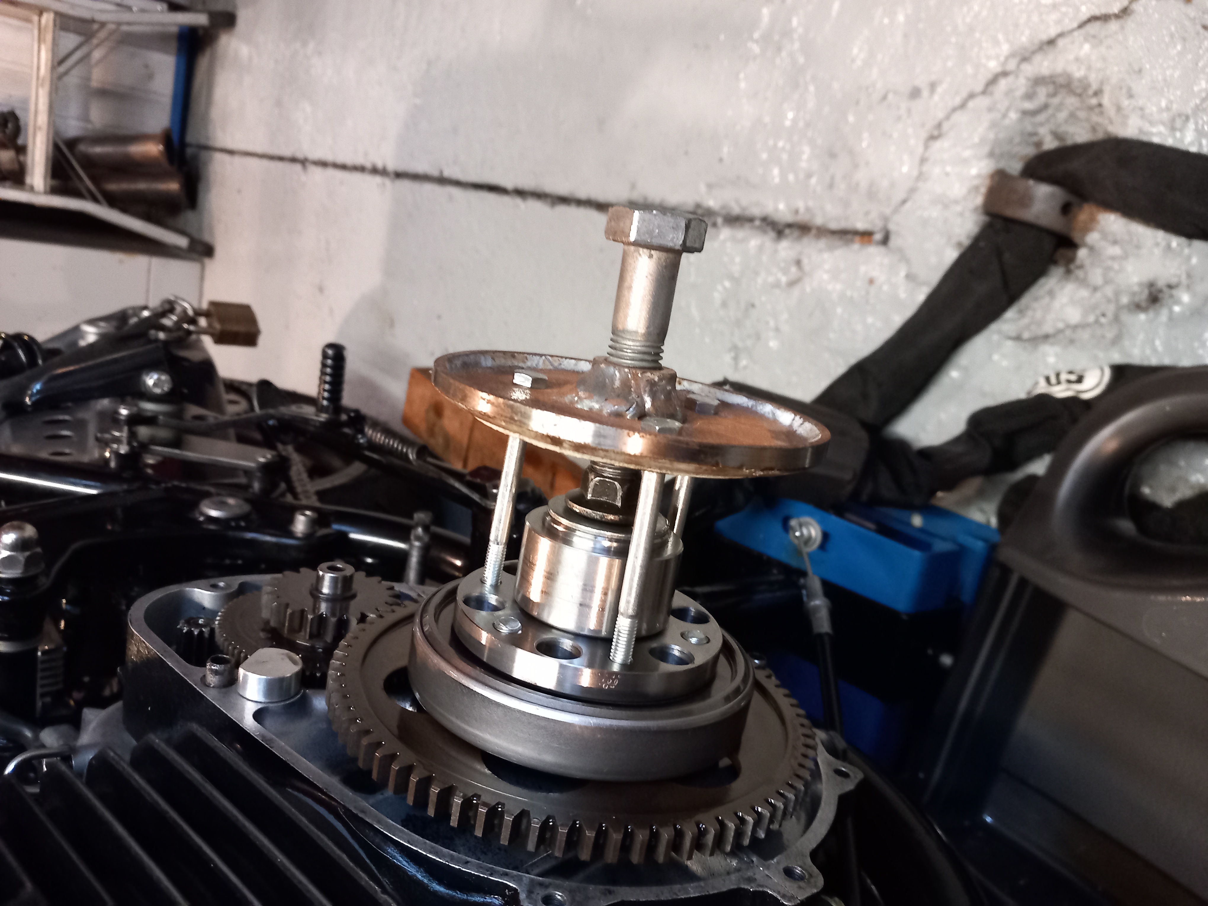

I used this to make the 'holder' which i will modify in due course. I will still need it to make the extractor at some point.
