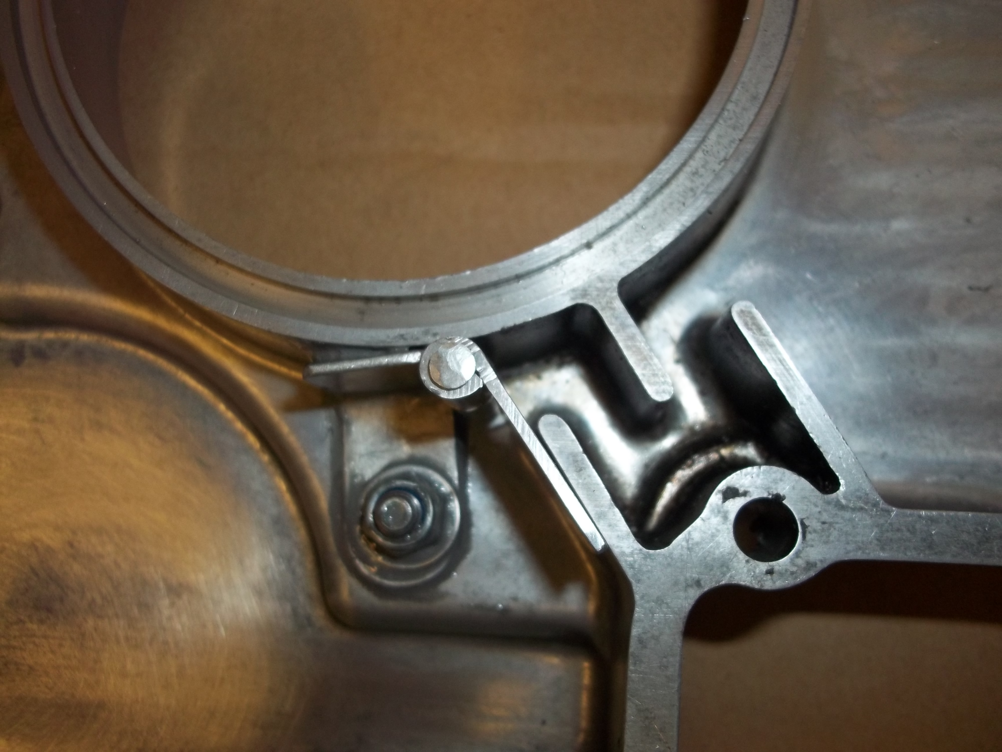

Quelle surprise, more issues...
Here's the two sumps, and the differences are?...
Obviously, one has got a deep 'pocket' below the oil pickup.
The gate open too far is nothing, it now appears that the pressure release valve wants to live where the gate sits...
And the standard pickup is far bigger than the deepened bit in the sump... as this modified sump didn't have the oil level sender in it (like the GPz1100 Unitrak one I removed) I'm wondering if I was sold one from a different model that isn't fit for purpose?

MDM wrote:Quelle surprise, more issues...
The gate has been put in 90 degrees out with the mounting bolt hole drilled in the wrong place.
The hinged upright should be against the wall of the oil filter hole with the gate "door" closing the gap in the sump baffle.
When installed correctly the door usually stops against the mounting bolt and in the case of the Geep pump stops against the pressure release valve .
There's a pic on page 1 (post 14) of the Orient Express build thread that shows one fitted .
As for that so called deep sump I wouldn't bother ( the Orient is just fine with just a gate) it's practically useless and the braided earls hose actually aids surge by allowing a path for the trapped oil to feed back to the gearbox end, defeating the object.
If you used an early pump with the bolt on mesh you could have made a bolt on reduced diameter extension to fit in the hole but that's out of the question as you will have no pressure release.
You could fit a pick up pipe screwed or welded in to the pumps inlet but you would loose the filter mesh unless you made something up for the end of the pipe.
Either way I would get rid of the earls hose link if you use it.

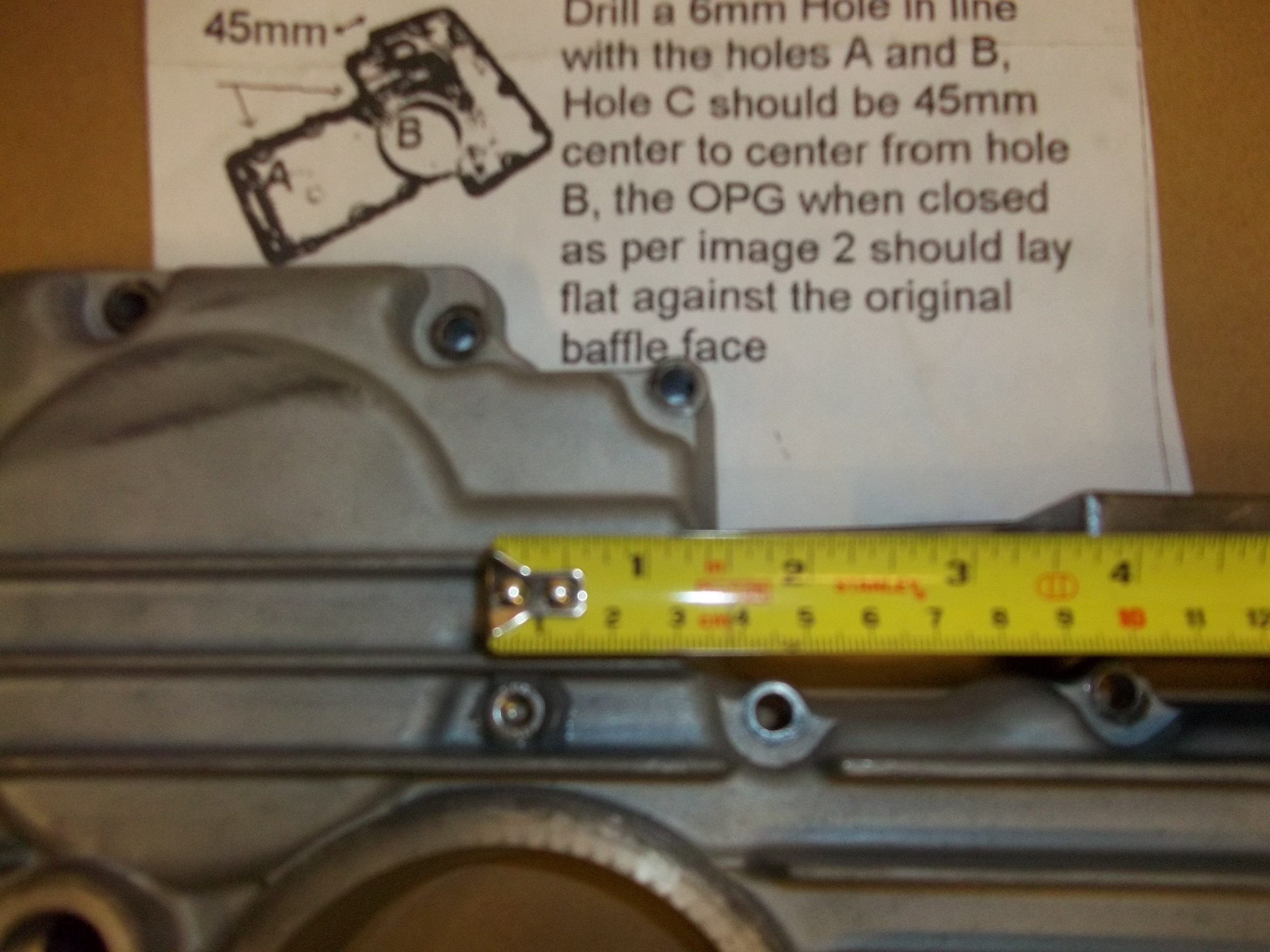

#170 PostAuthor: sanderz » Sun Apr 09, 2017 4:34 pm
If this is of any help I did the 'gate' on mine like this

#171 PostAuthor: MDM » Sun Apr 09, 2017 7:35 pm
Brilliant, thanks Rob and thanks Sanderz! Makes life a little easier with those two answers! Decision made then, original sump with a repositioned gate it is! :mrgreen:

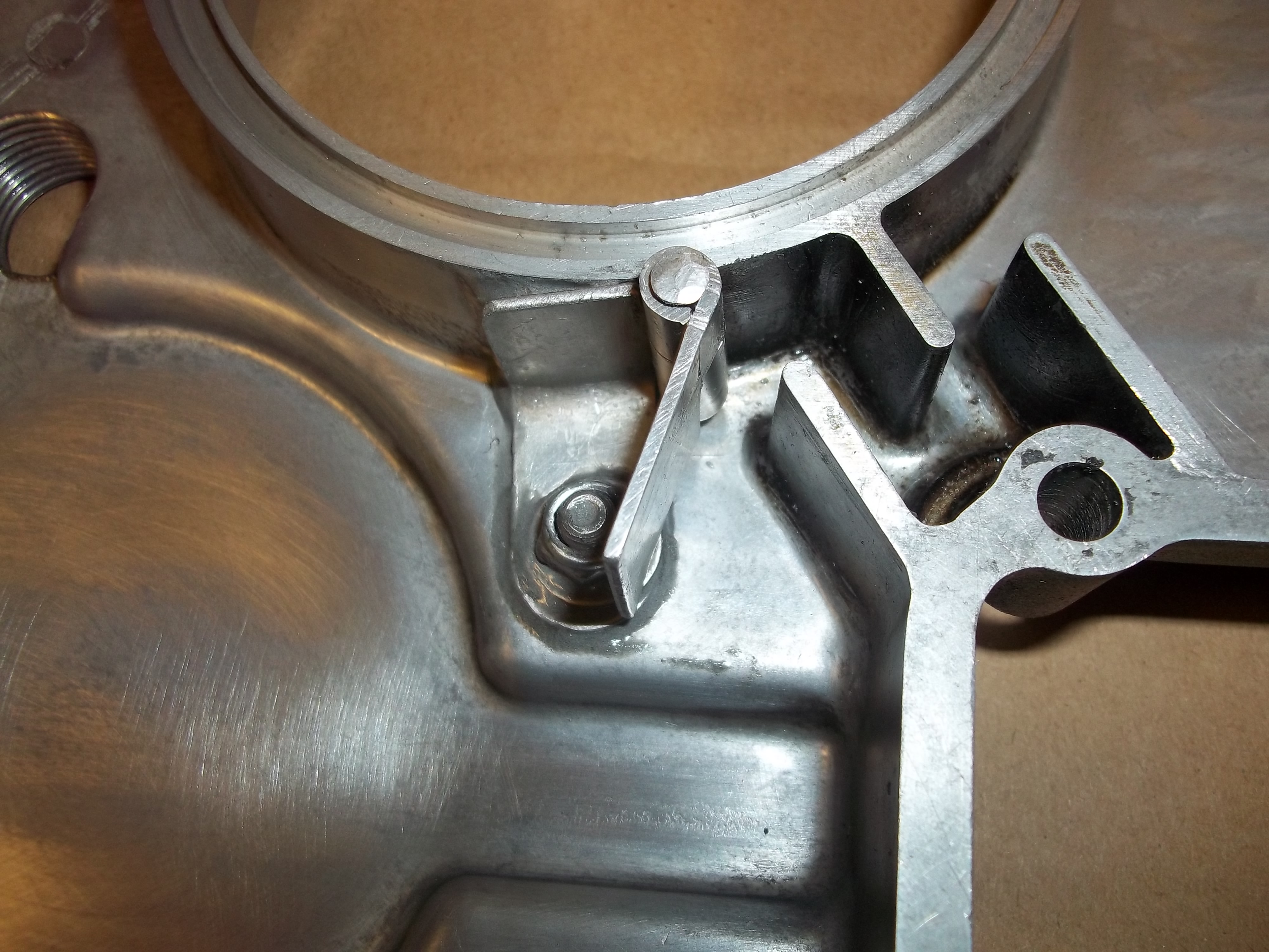

#176 PostAuthor: MDM » Wed Apr 19, 2017 8:14 am
So, with the option of an expensive aftermarket deep sump being well and truly out-the-window, the oil gate was being transferred into the 'good' original sump (complete with now irrelevant oil level sender).
Hole drilled and finning relieved on underside so that the allen-headed bolt would sit flush.
And the gate bolted into place, in the correct orientation this time!
So time to offer it up and see if the sump would fit...

#177 PostAuthor: MDM » Wed Apr 19, 2017 8:15 am
...errr, no.
You can just about see the mark where the body of the pressure relief valve was hitting the nut holding the gate in place...
Hello Mr Grinder? Are you available for a few minutes?...
Enough clearance created and the circlip that holds the spring in place can still be fitted.
