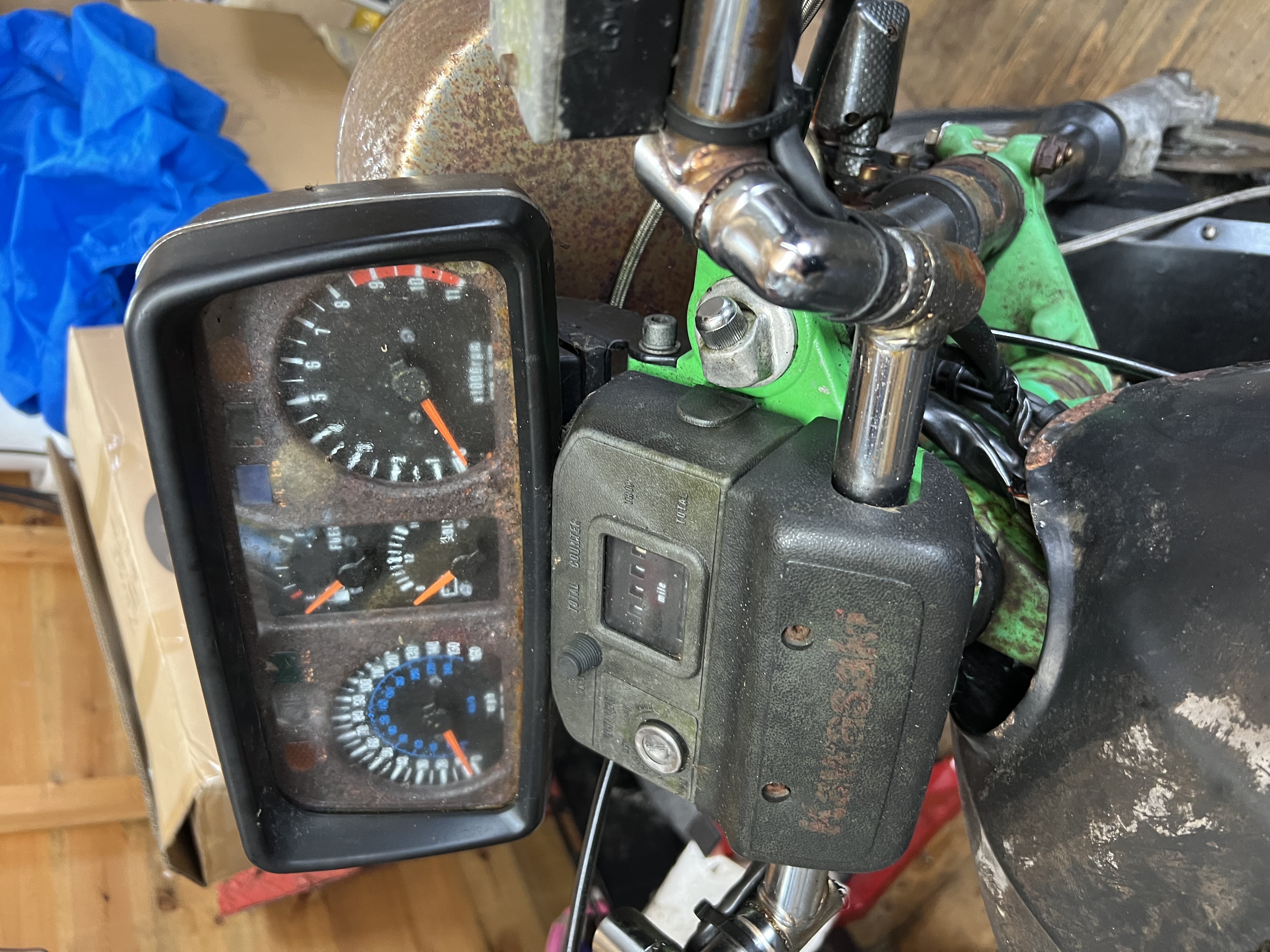

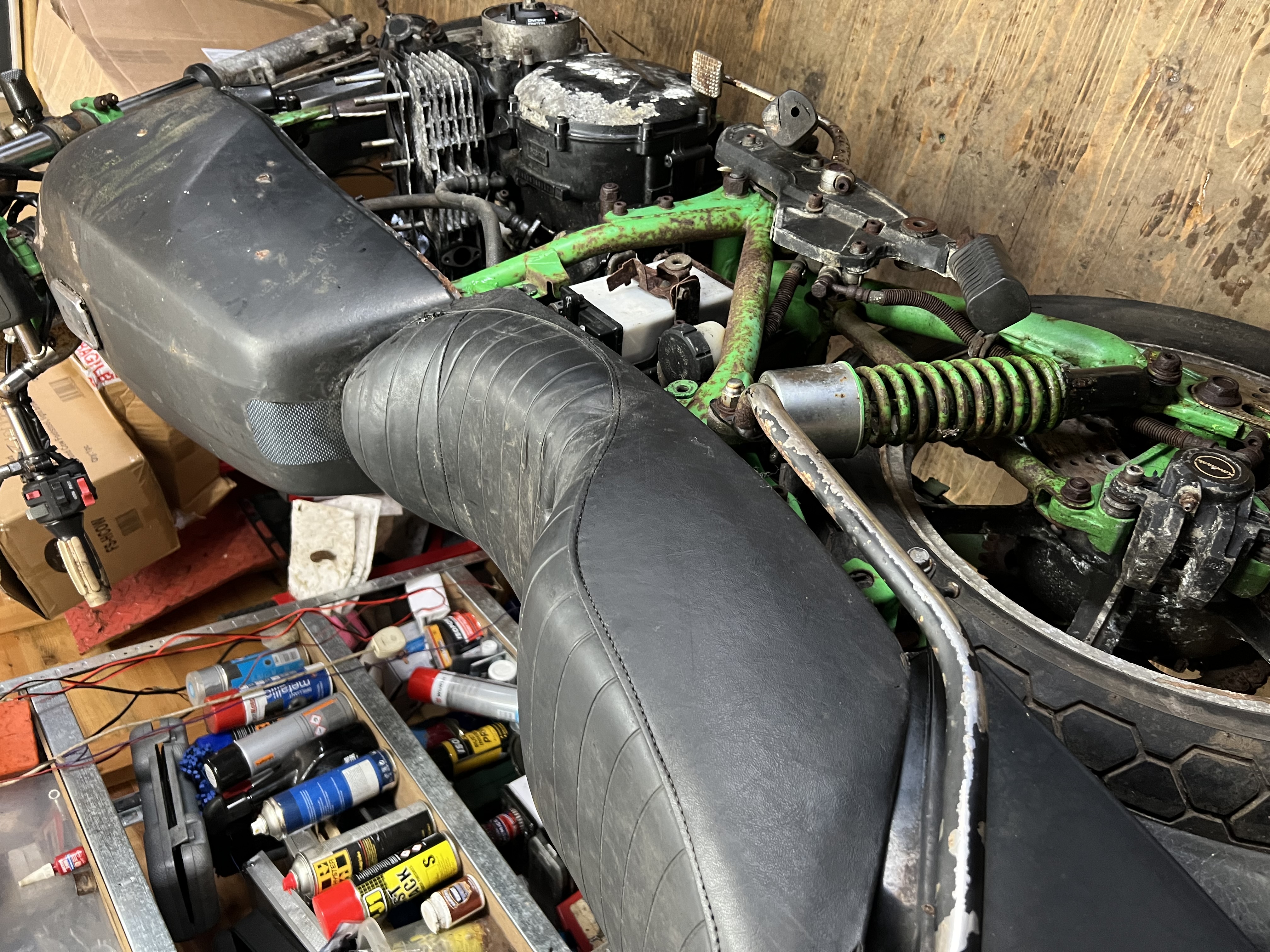

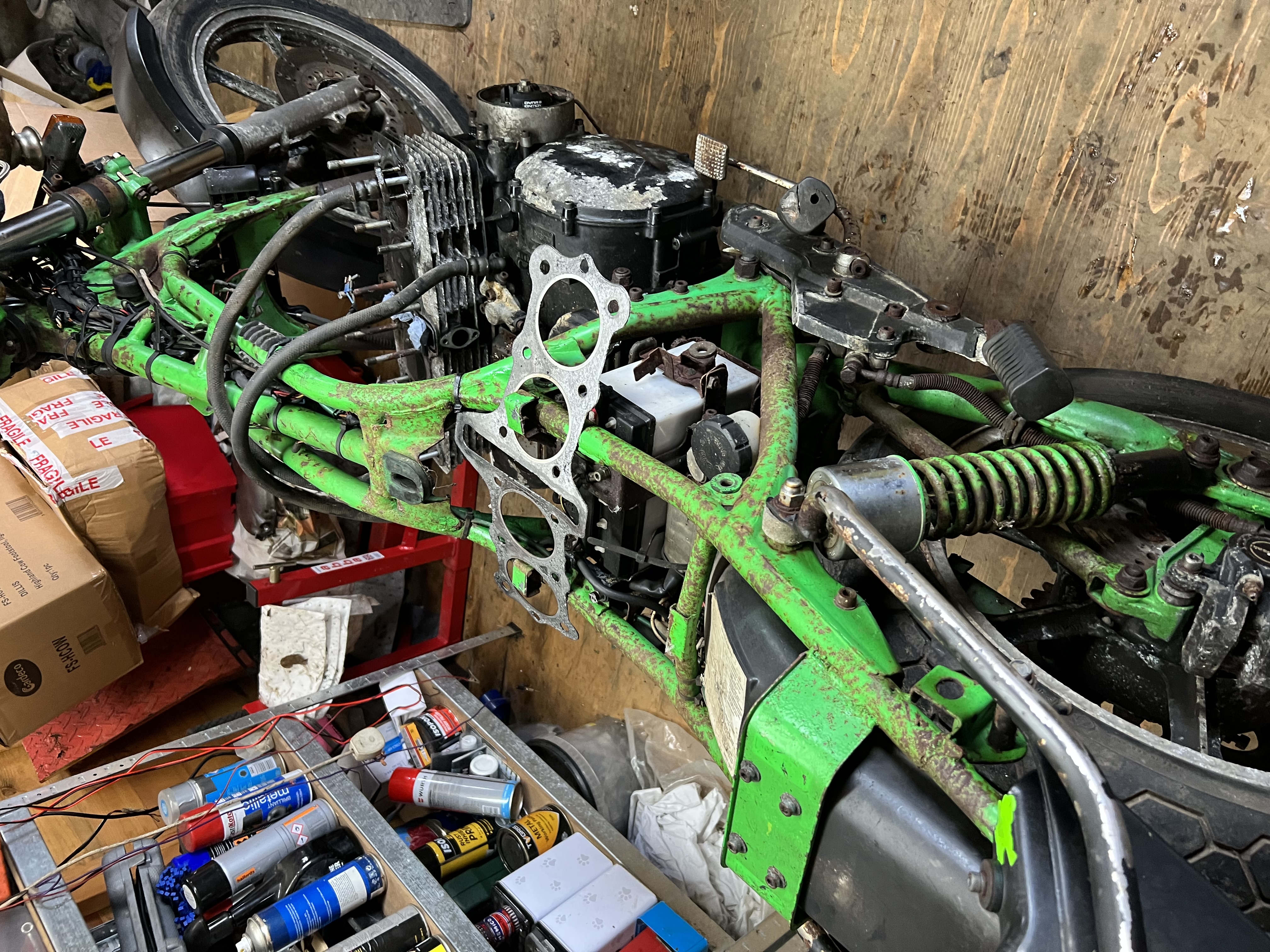

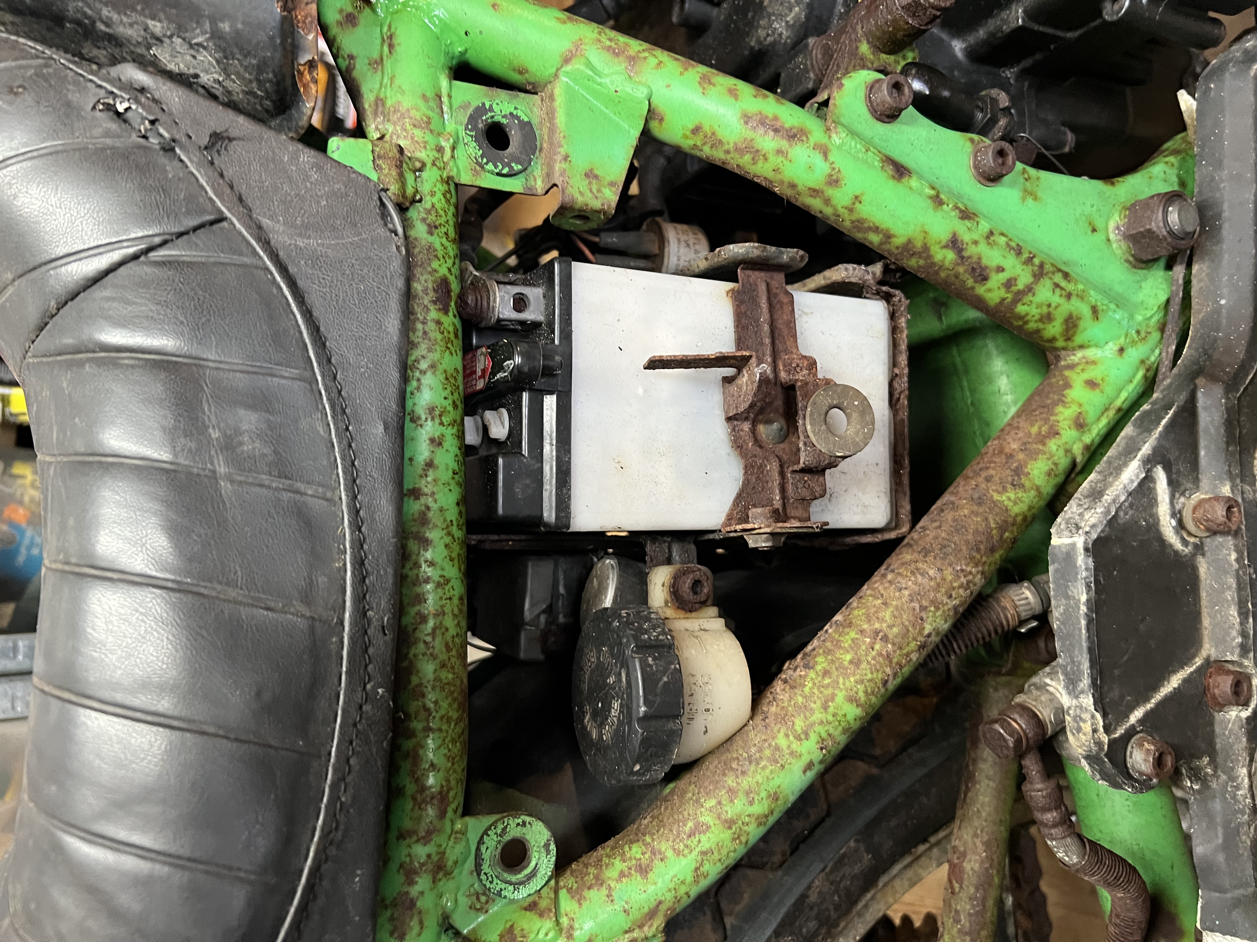

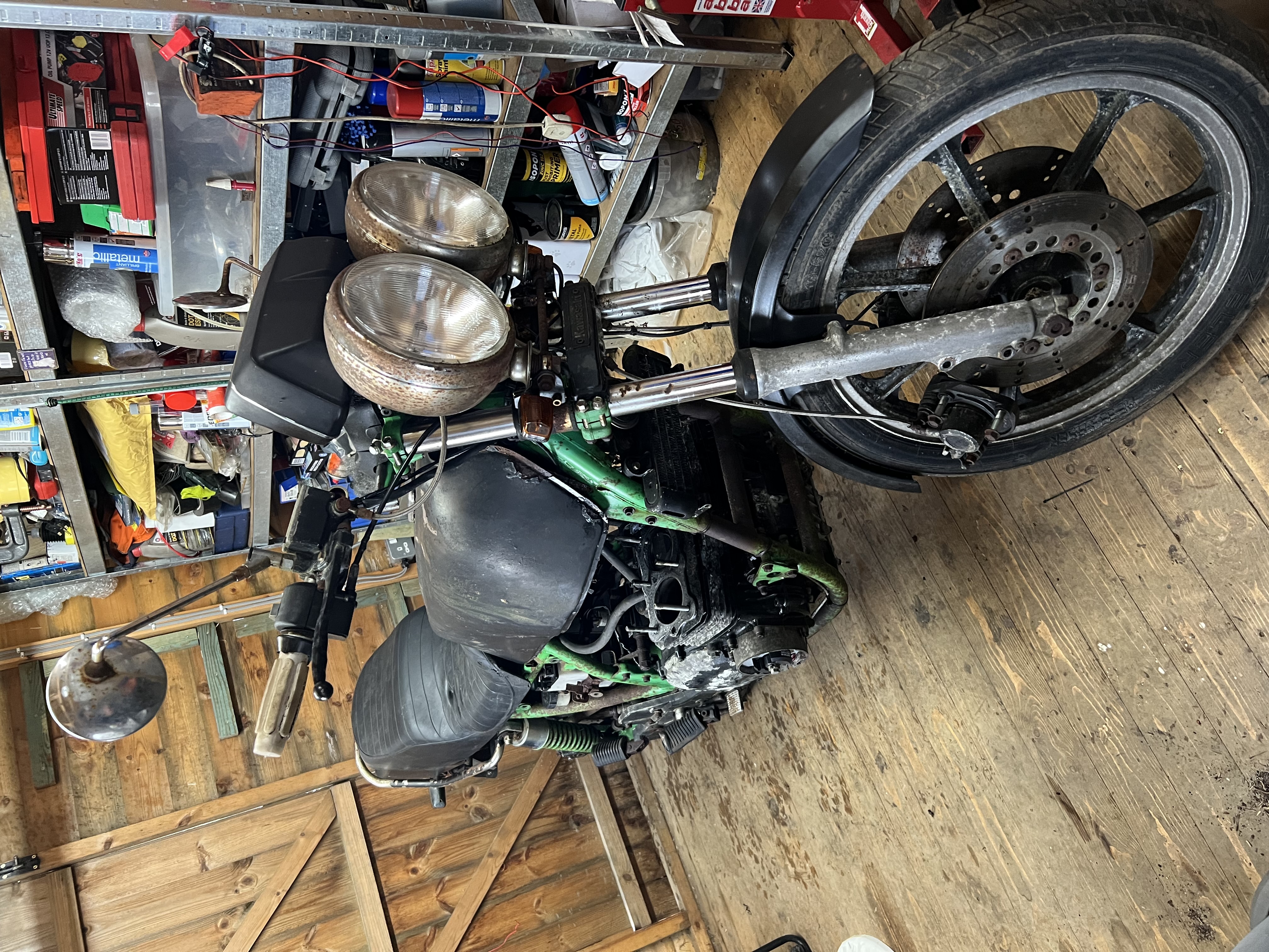

Hi again, i have attached some photos of "Private Pile" as my wife has named it. As you can see it isnt very pretty, but i can see potential.
Neil

Hi Neilzed
it's a "private pile" with a lot of potential, see it as a challenge, don't get discouraged by a rusty frame or an engine that needs to be resprayed.
You'll get there in the end, one piece at the time!
I've restored worse than that.
Good luck
Good luck
