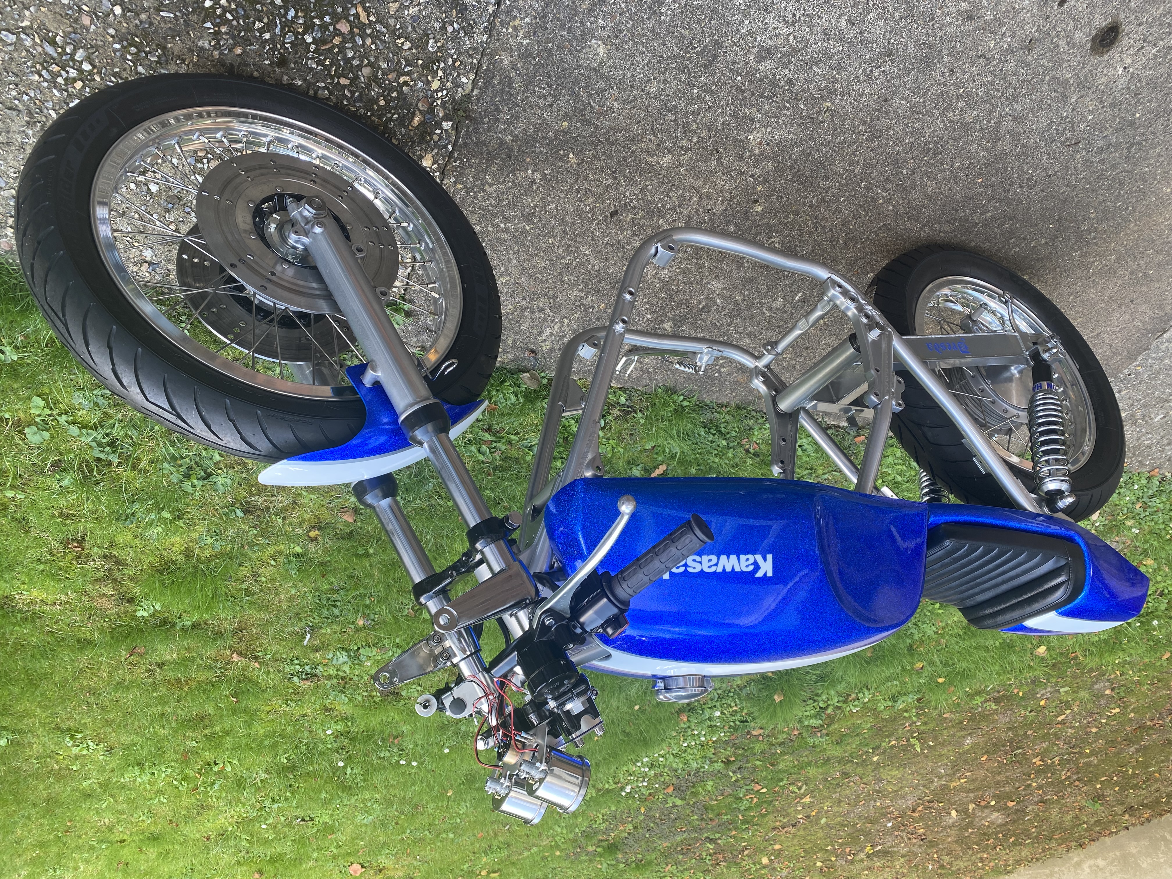

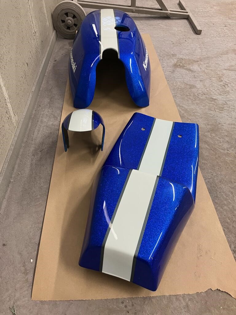

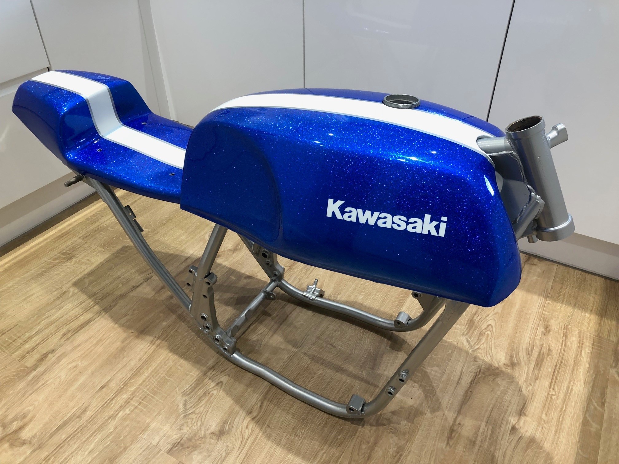

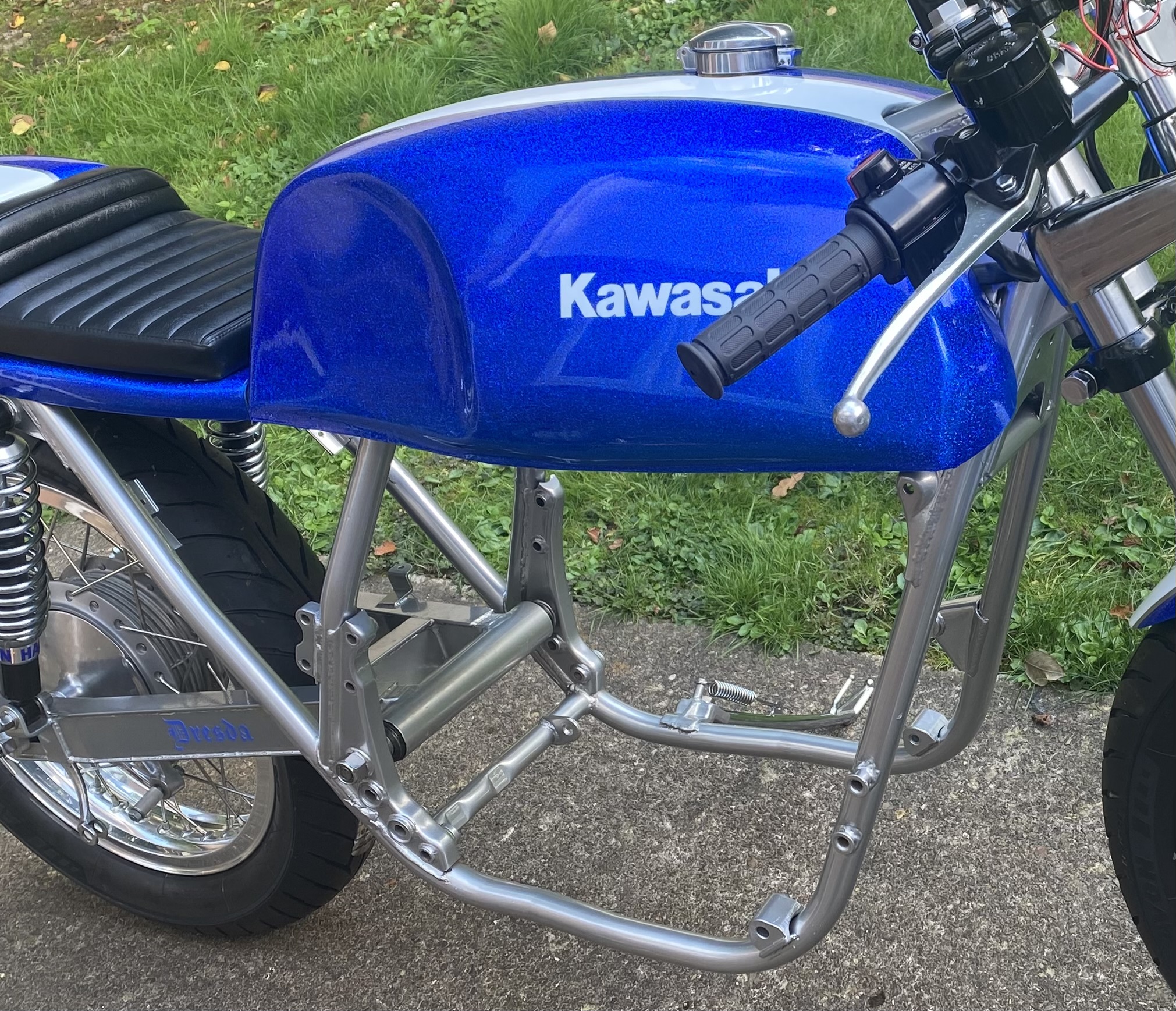

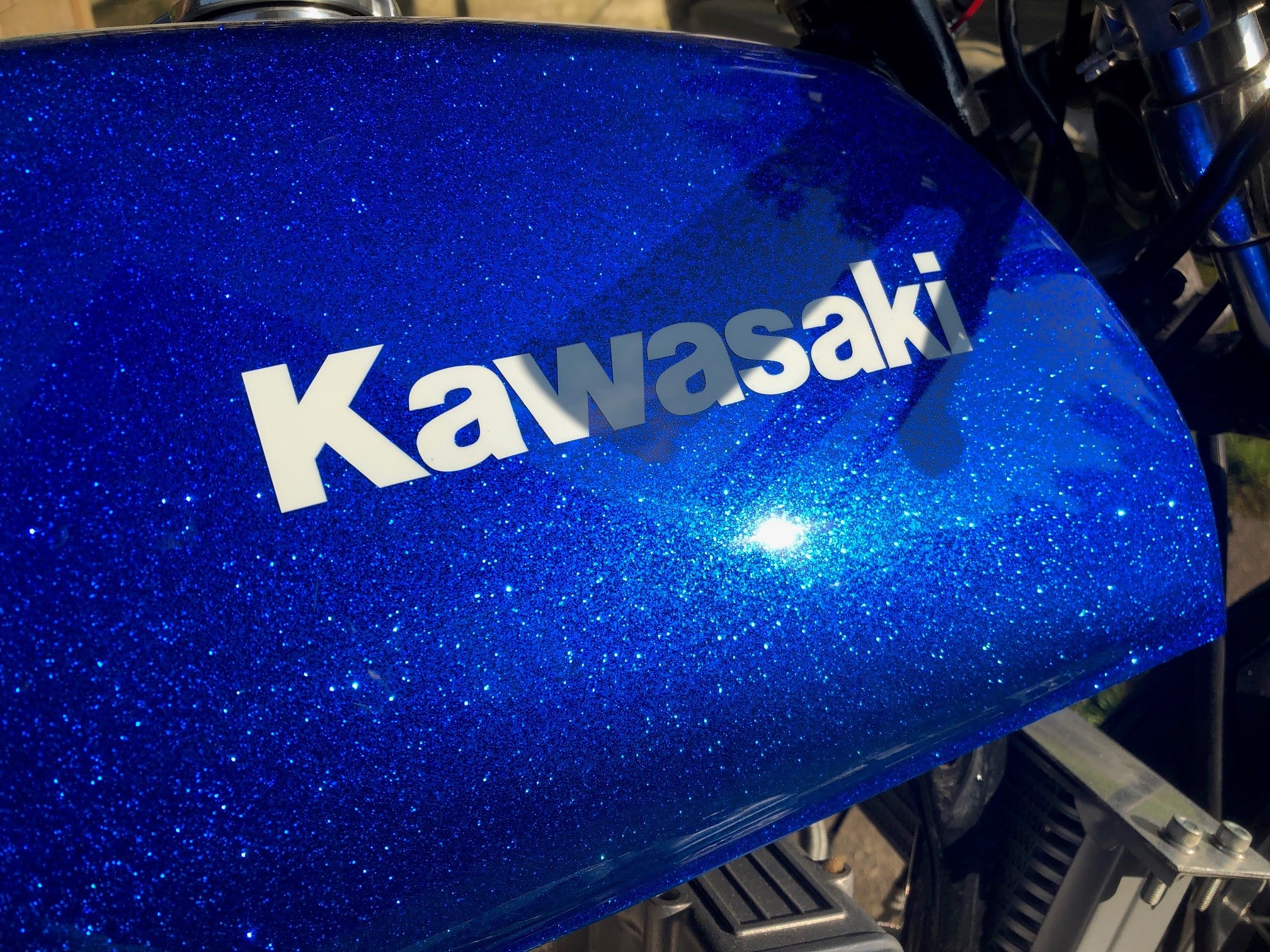

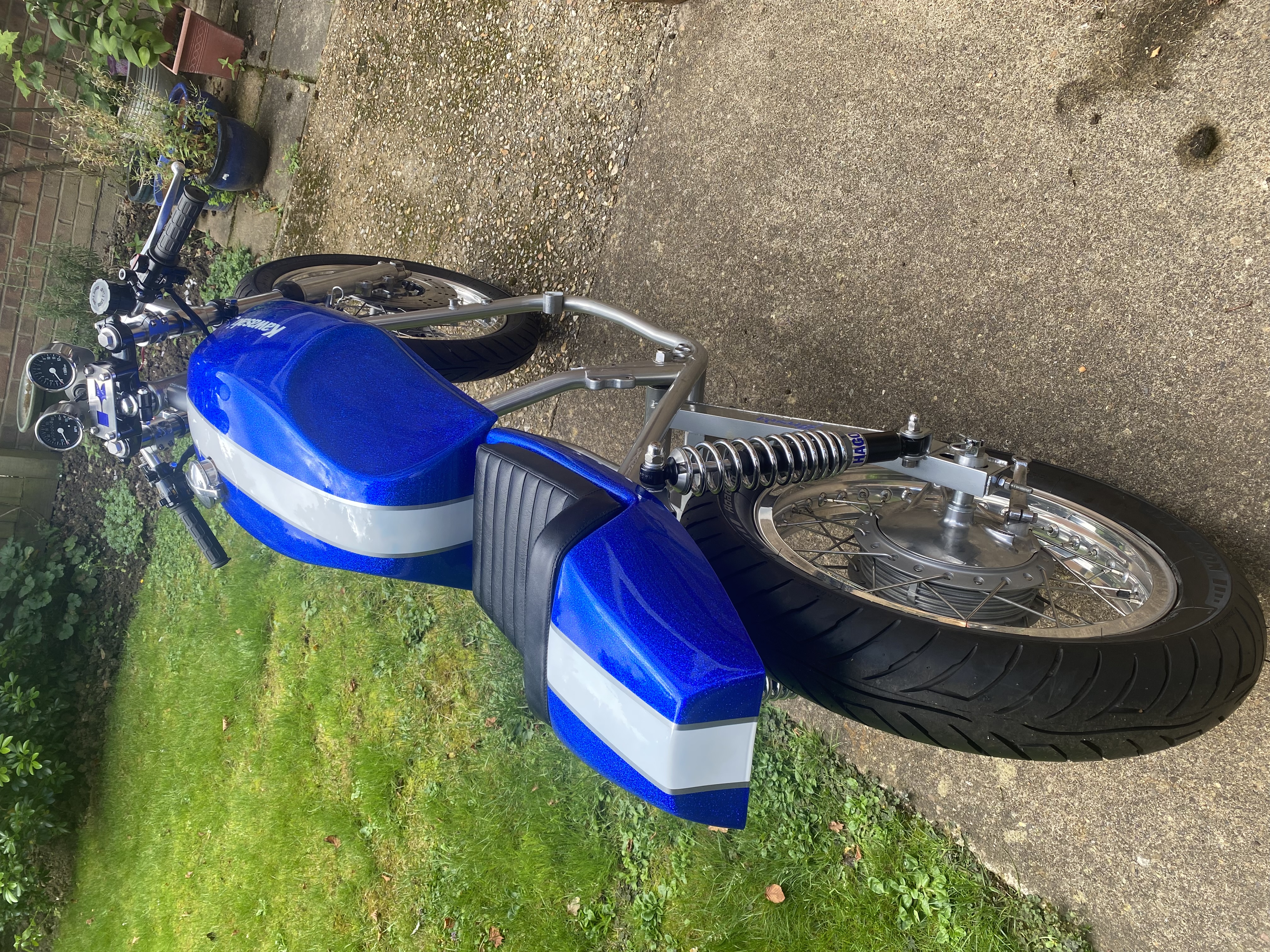

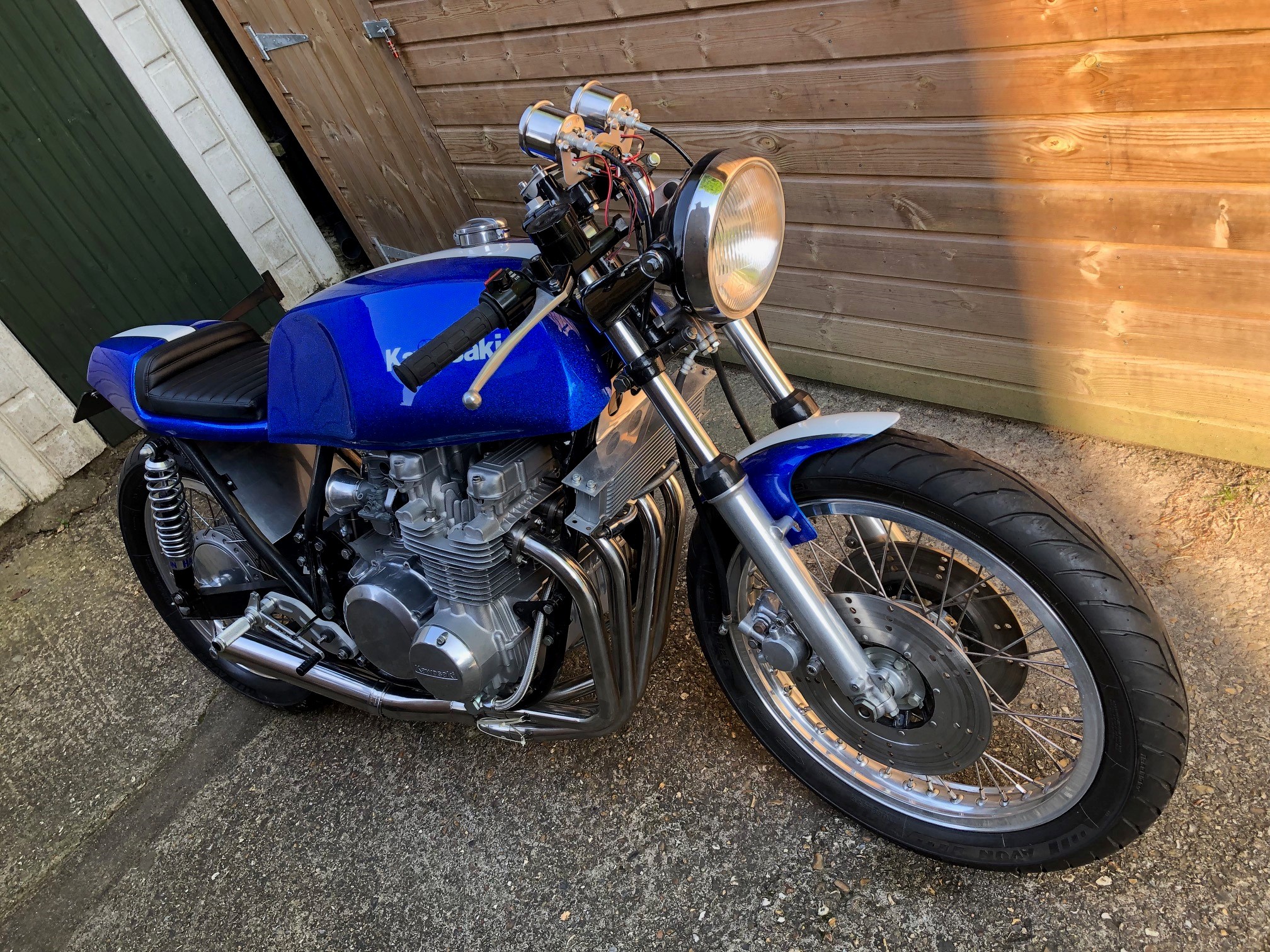

The images of the paintset on the bike are with the bike still in mockup form.
The frame and ancillary parts have been powder coated. Paintset is done. Huge thanks to Stig at Stigs Custom paint in Charlwood (nr Gatwick) for the superb job of the paint. I wanted a heavy `70's metalflake and the white stripe to mimic the Kawasaki race bikes of that era.

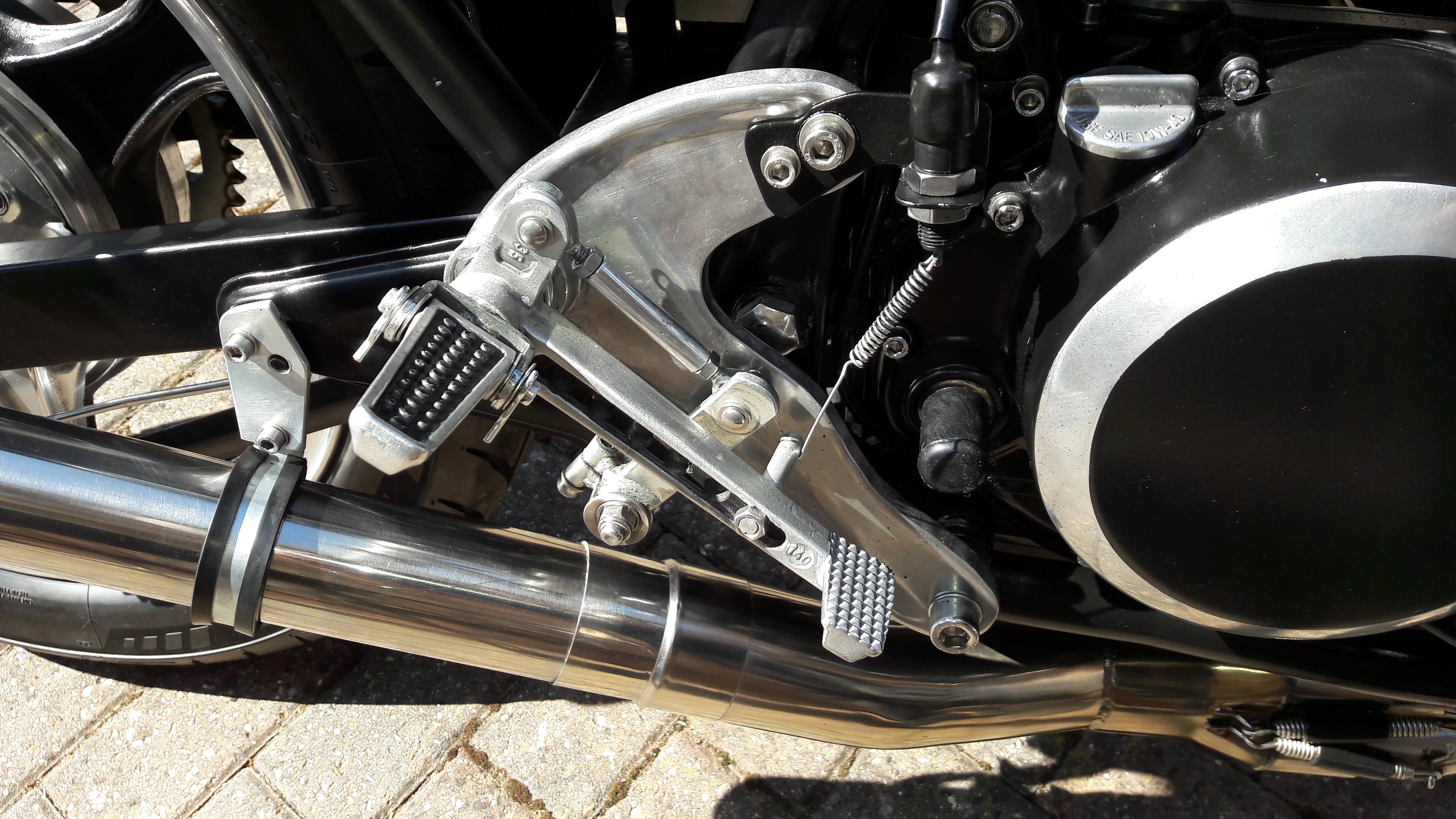

Looks like they mount to the (chopped off) rear footrest hangers.

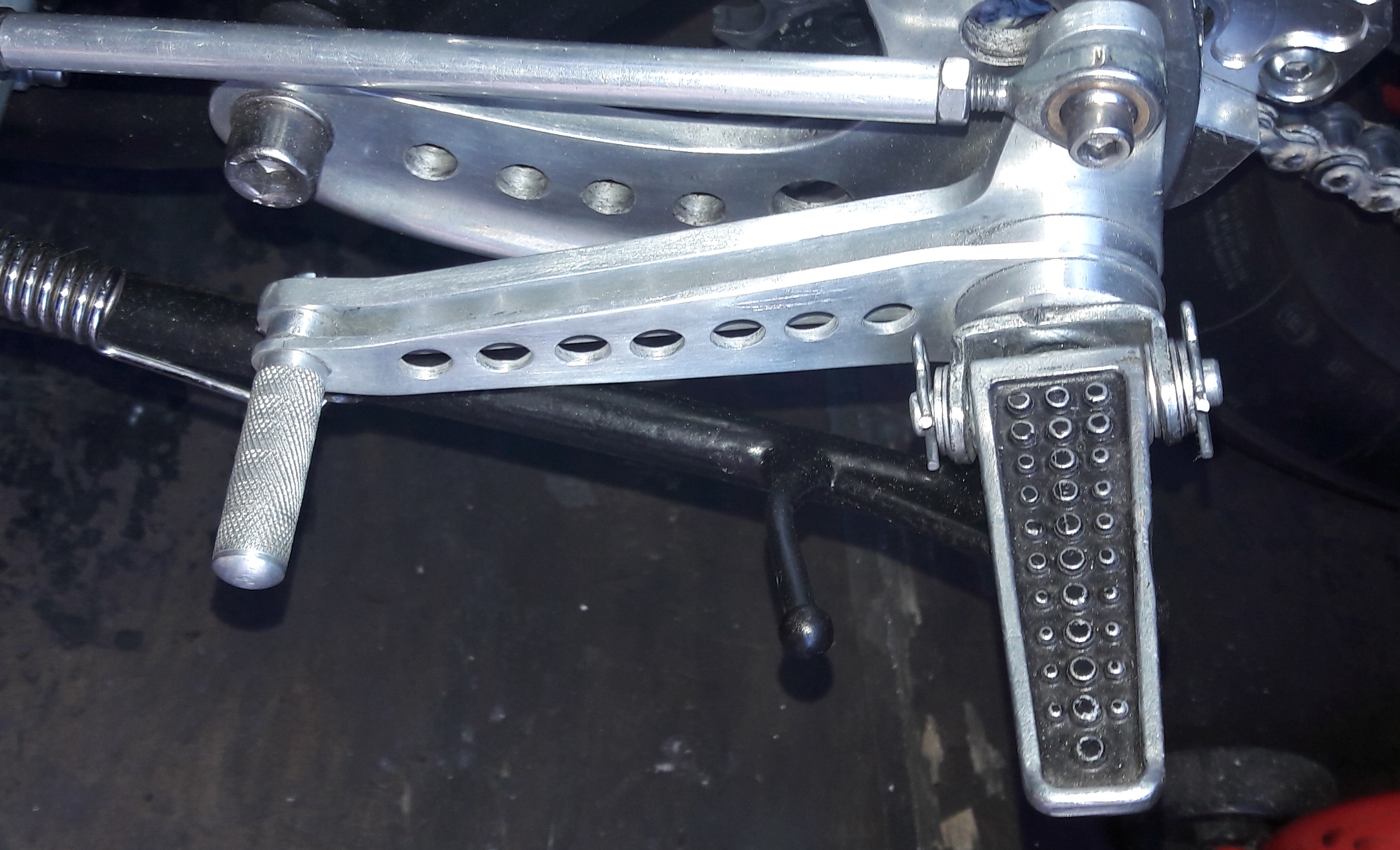

I used Raask rearsets which mount to the existing foot rest frame point and the rear engine mounts.
Then because the levers on Raask are so mickey mouse I replaced them with self made ones and drilled a few holes to make Colin Chapman happy by adding some lightness.
Then added in an extra piece to drop the height and move the pegs back a bit further to fit me better.

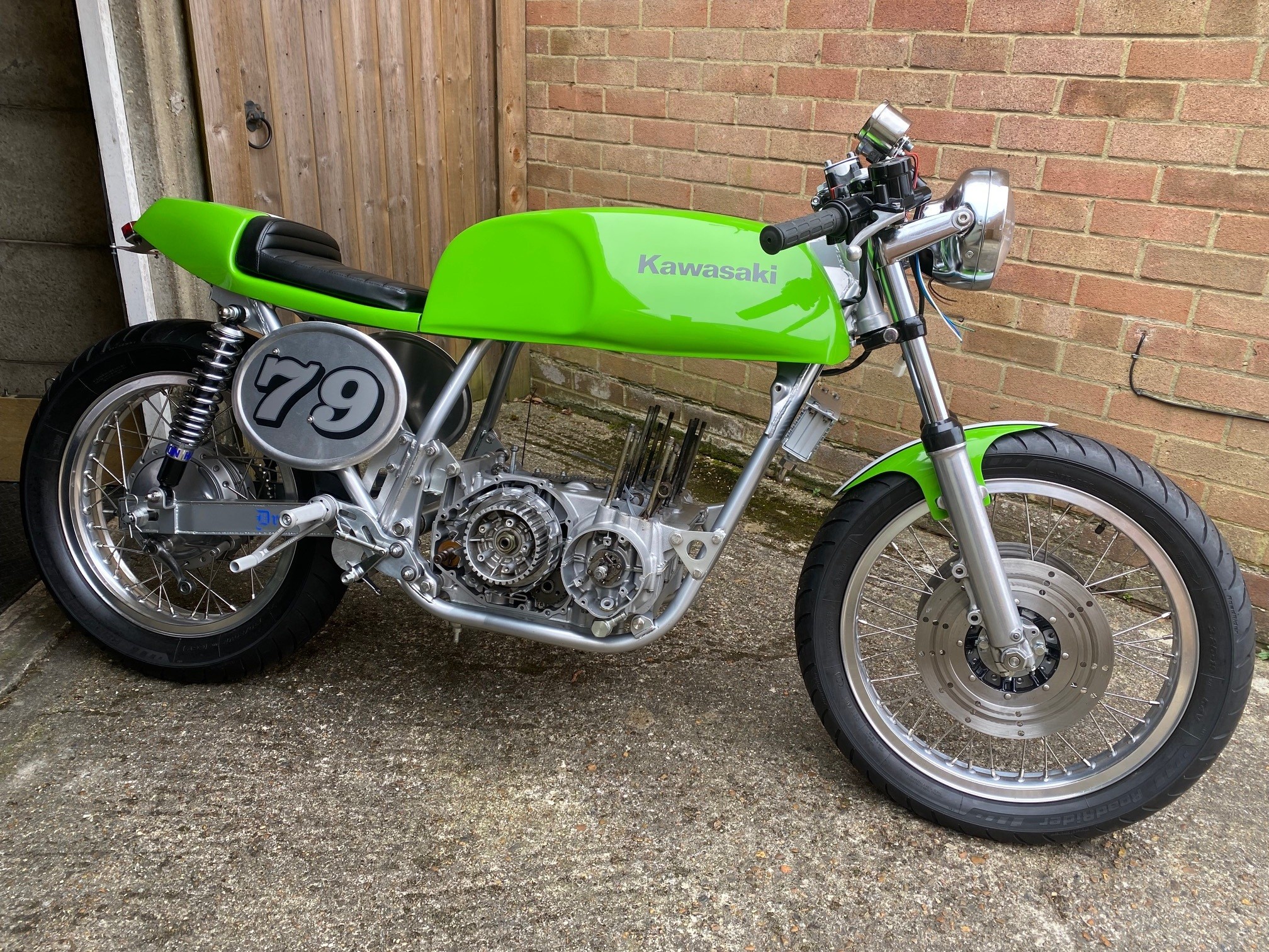

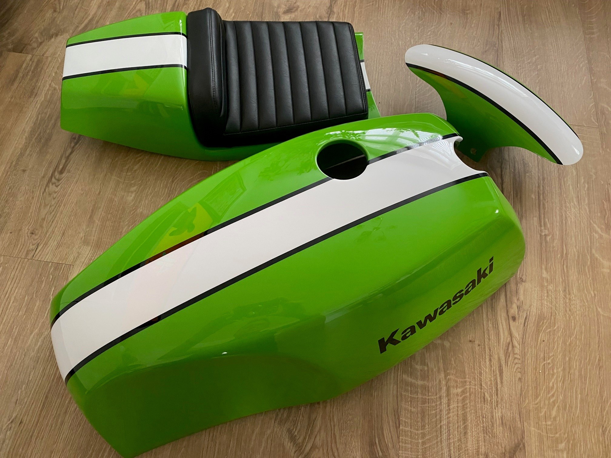

Unfortunately, the bike slipped off the stand when I was working on the rear brake linkage. I'd also had a problem with `bleed` on the previous blue paintset. Anyway, have bit the bullet and gone for the obligatory racing green.
Bottom end is all finished....next it'll be fitting the Wiseco pistons and concentrating on the top end build.
