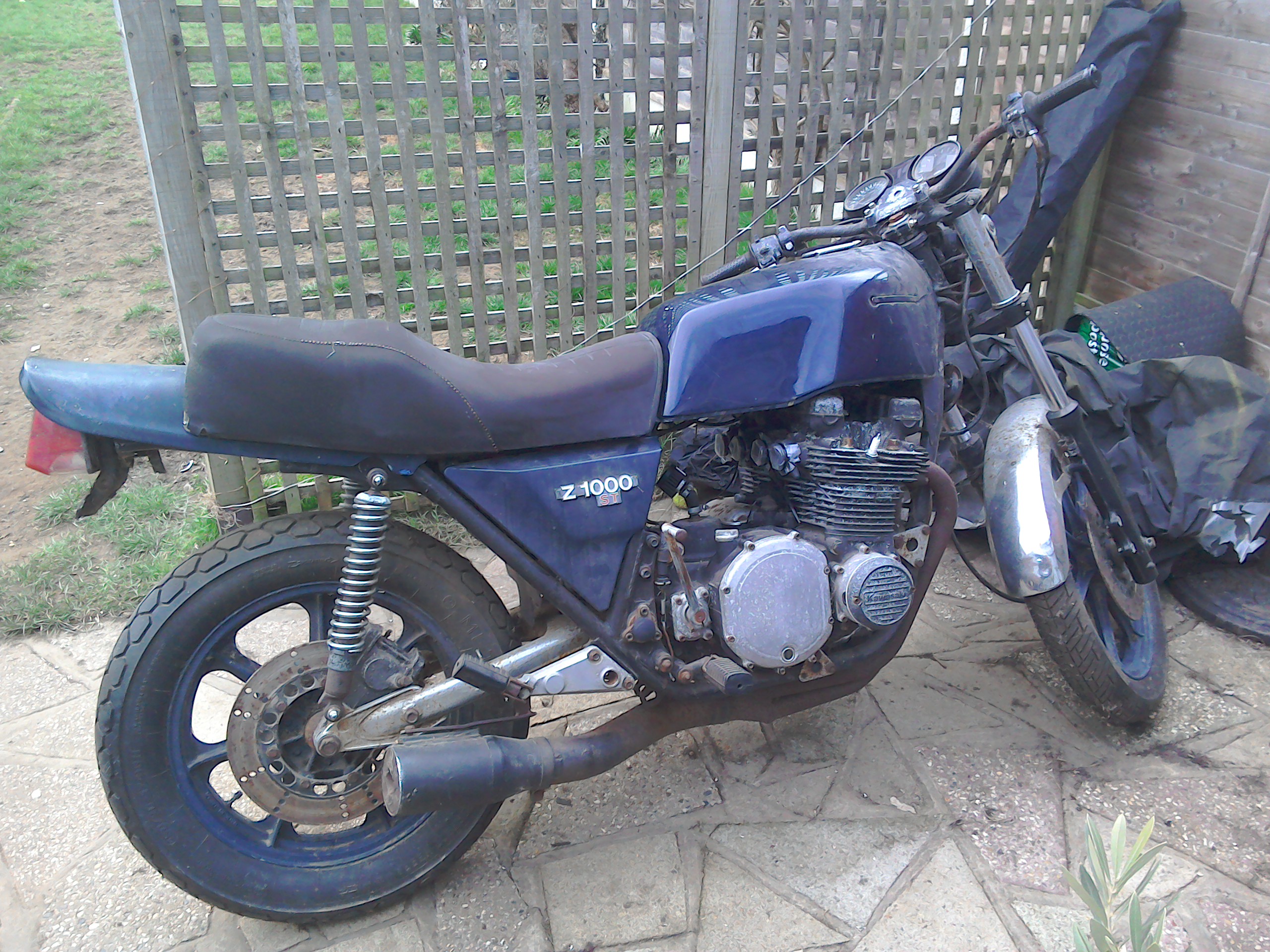

Hello everyone owned this bike for over 30 years but through life stuff has been sitting in my back garden covered up for 20 of those,unloved and neglected (no angry mobs please).
So part one is just to get it going again I have all the parts that I took off 20 years ago....somewhere and I find myself buying parts that I know I have....... somewhere.

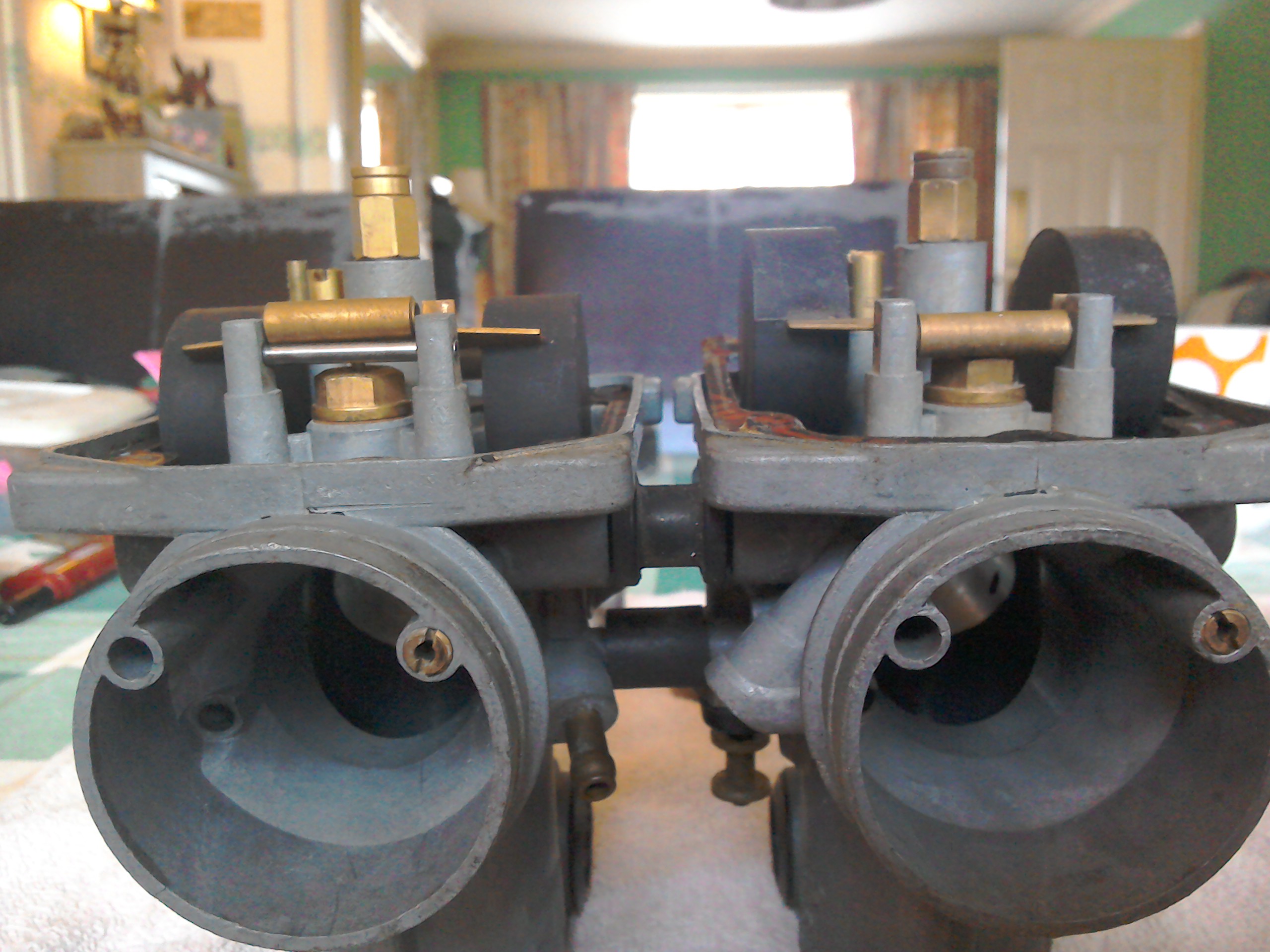

Tried to start the engine after striping and cleaning carbs out but got overflow from No4 and big leak on the t-piece have ordered seals and carb bits to fix must admit really disappointed as wanted to hear it sing again.
Brakes all striped and cleaned out ready for stainless kits had to order new rear master seals as the repair kit (43020-1015) is no longer available anywhere the master itself shows only very light corrosion and will clean up the front master had to put a small rod through the Banjo join and beat the piston out very bad will need re-sleeving all electrics are working though the high low beam switch broke off as soon as I touched it seen a few replacements on eBay but all have the same problem will sort this when I start part 2 well that's it for now just waiting for parts and weather.

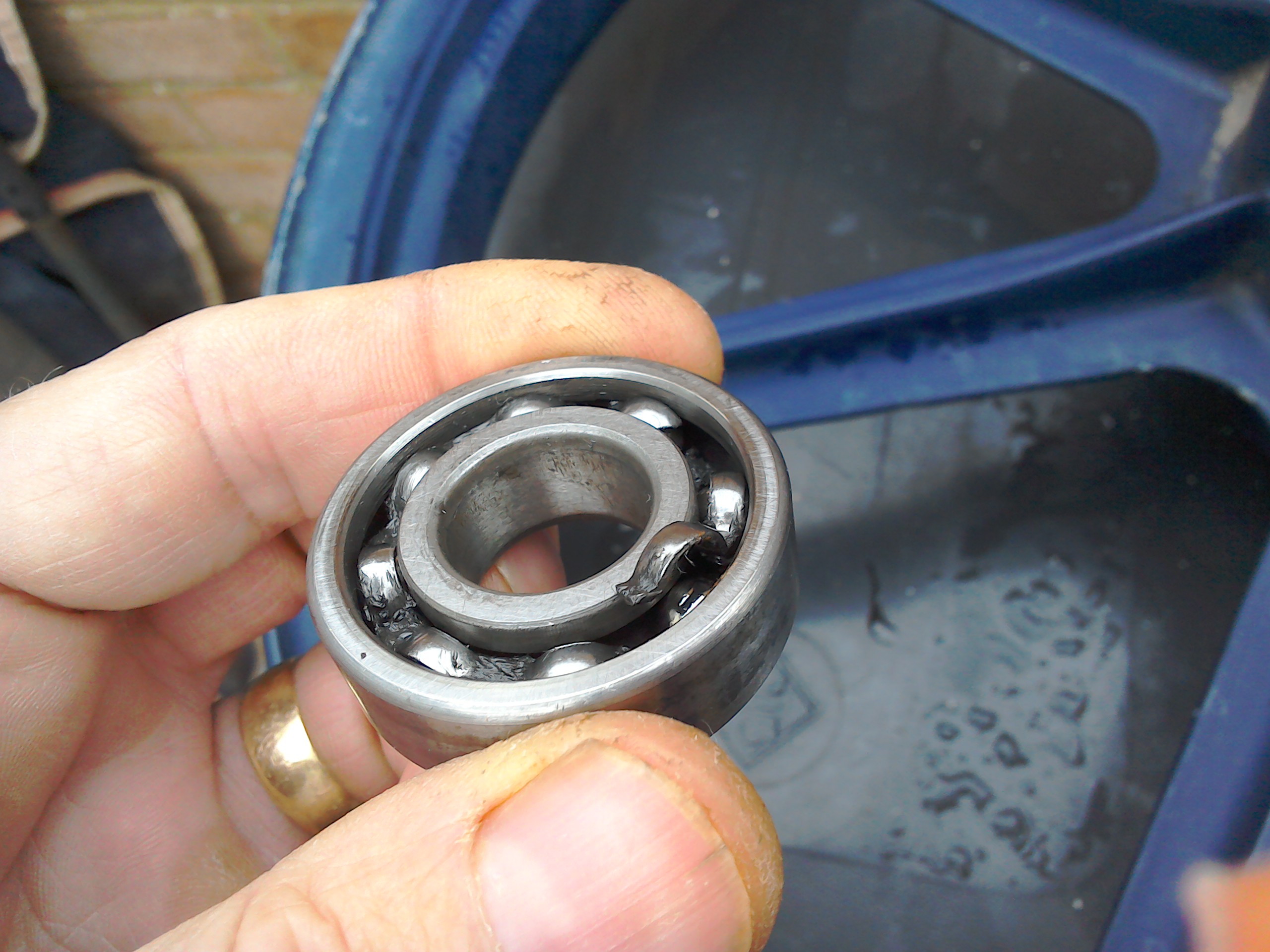

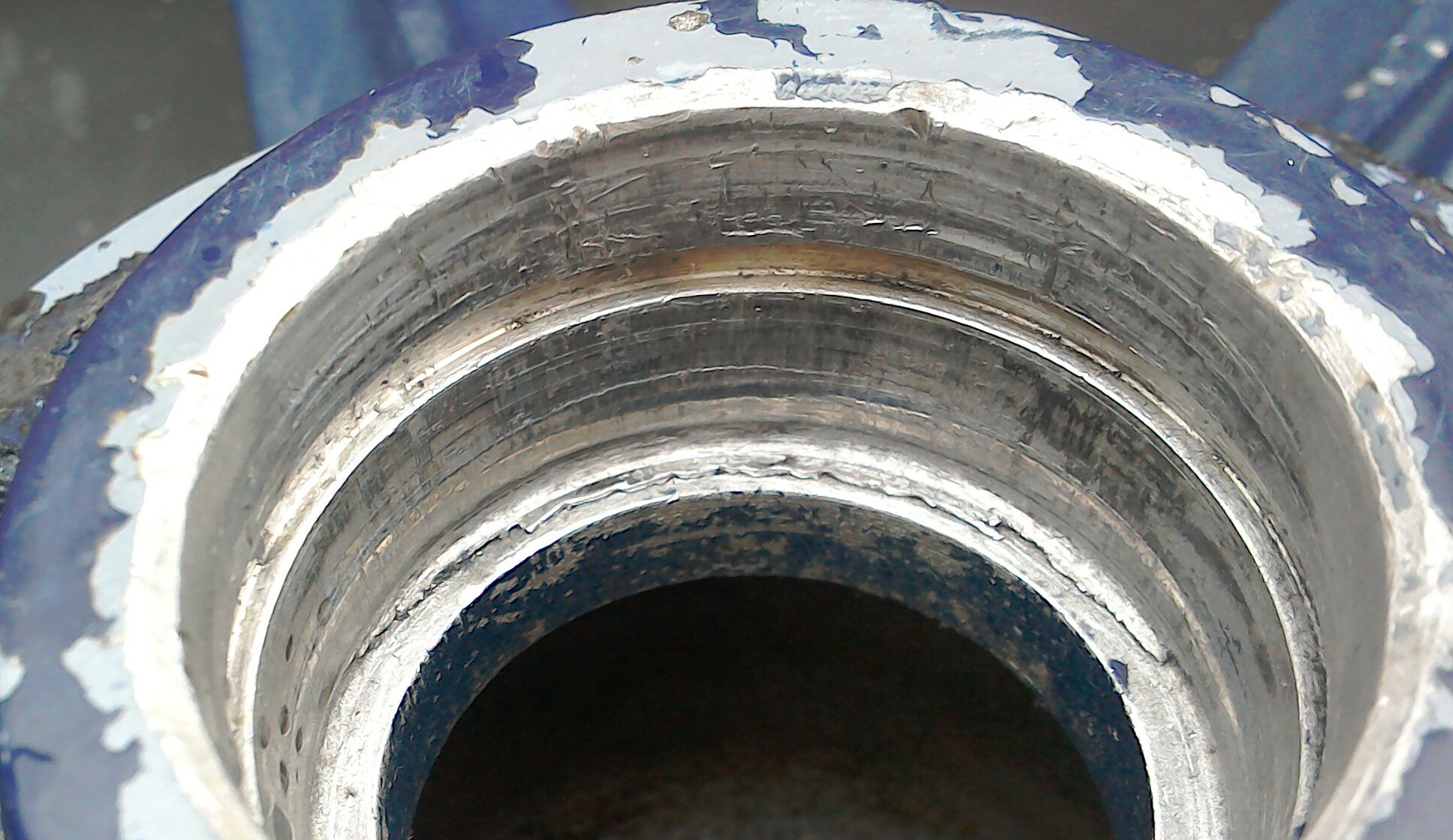

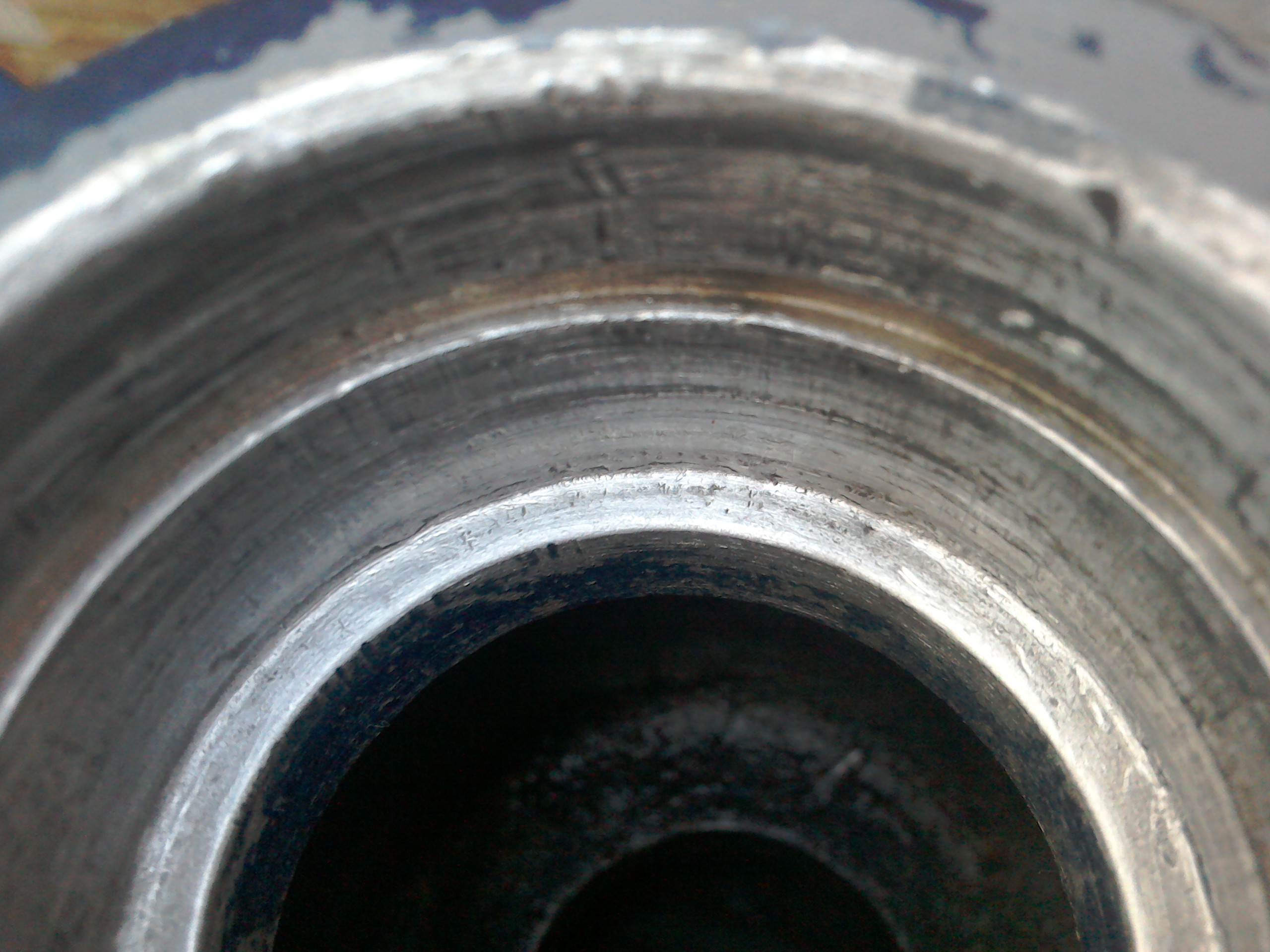

So had some time to do a few bits electrics now all working calipers have new seals and stainless pistons fitted front wheel bearings changed found this
30 mins later
Just the rear tyre to change and check wheel and swing arm bearings and will be on the road again
30 mins later

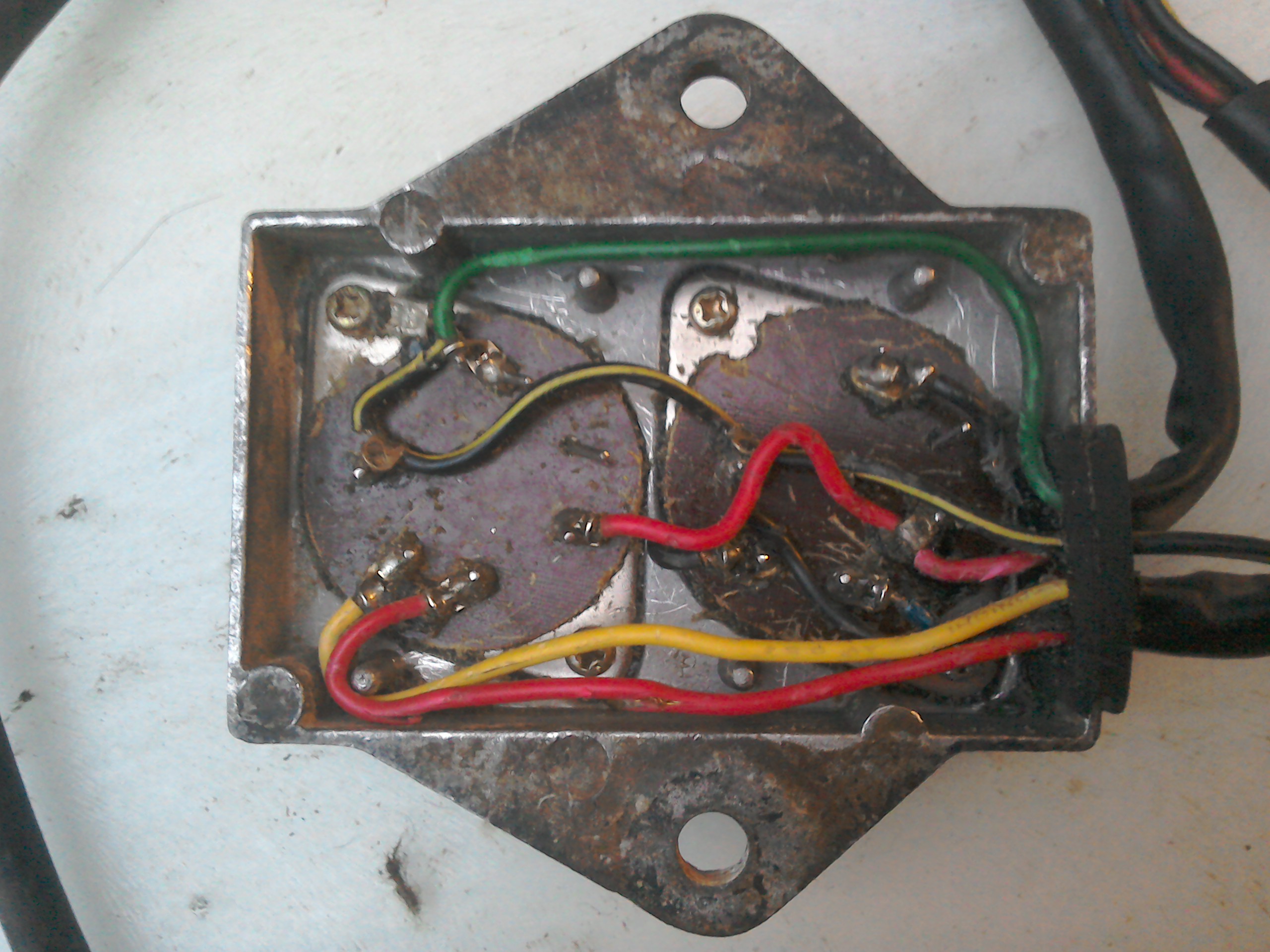

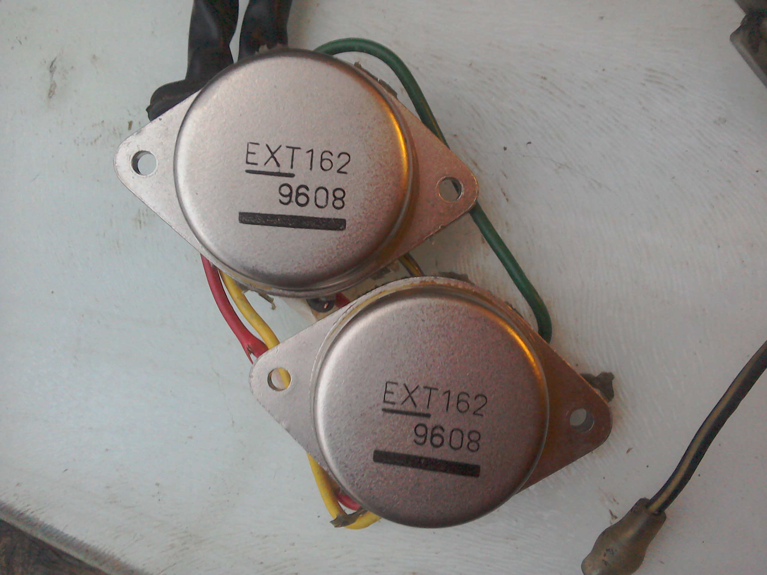

Bike hasn't started well and stalls out with any throttle since I started to get it back on the road found I had a febile orange spark tracked it down to a failing ic igniter I have sourced an aftermarket replacement so thought I would see if I could fix the old one.
So what's in the box?
Two hours of digging out the potting later
Here my quest fails can't find any references to the part numbers unless anyone recognise these?
Re: Z1000st part 1 just get it on the road
Good find the cct diag.
It looks like there is a external resistor in the live feed to each coil so suggest you check these for condition and connection and voltage too.
With ignitor unit already removed you should be able to ground negative wire from coil going to ignitor briefly and get a decent spark to check everything else is working fine.

Thanks guys have checked all the wiring and everything tested ok except the igniter.
The site in Dutch I cannot get to translate looks like he was trying to do what I wanted to do but in all honesty don't expect to find the part for this as over forty years old and things have got a lot smaller in that time.

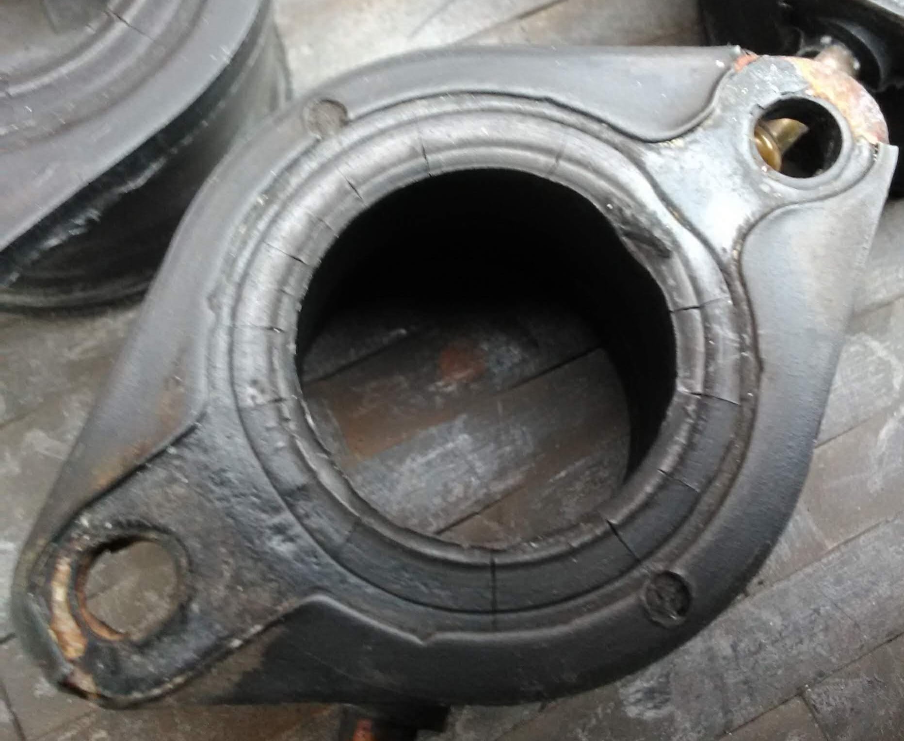

New CDI unit fitted good strong spark much much faster starting now but would only run with choke so striped and cleaned out all the small passages jets ect new intake rubbers as all four were splitting probably didn't help

Refit carbs and new intake rubbers hopefully should sort the running problem
