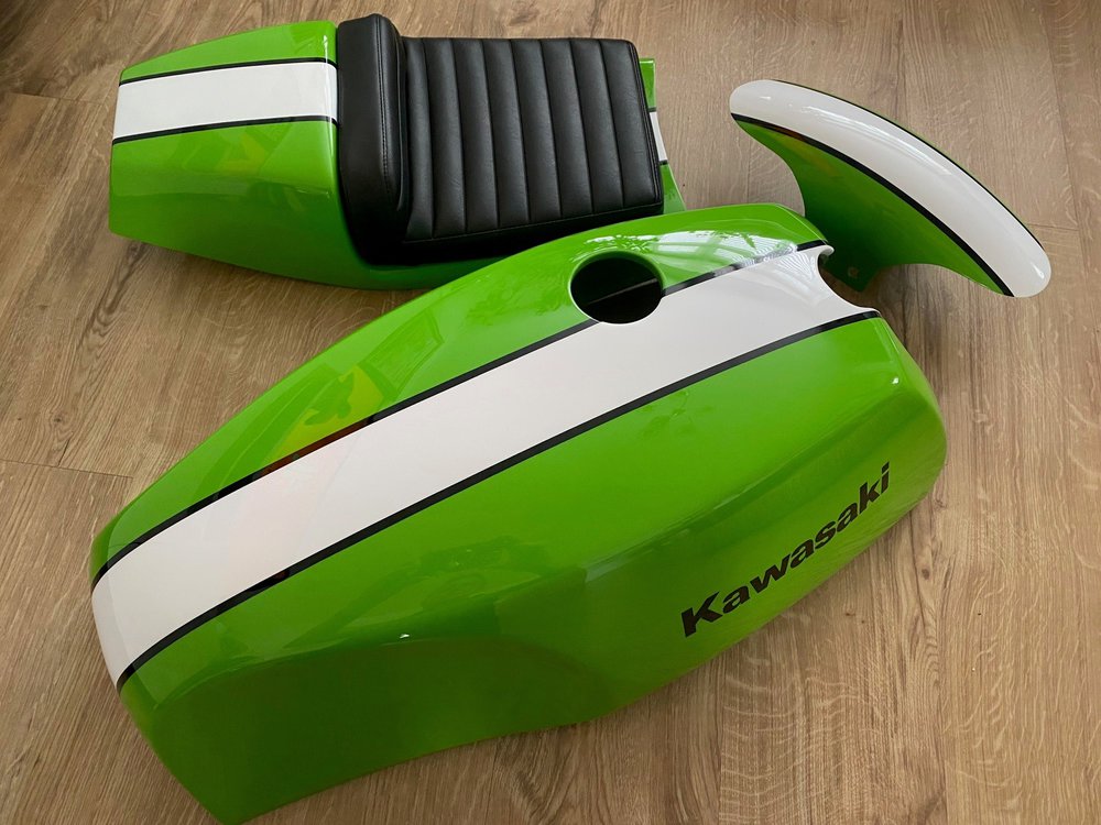

It's been a while since any updates on this one chaps...lots been going on over the last couple of years.
The plan is to, hopefully, have it ready to take over to the IOM for the Manx at the end of August.
Still masses to do but the engine is somewhere near ready to start putting together. Barrels are out to a 64mm bore ready to accept the Wiseco pistons.
The images of the paintset on the bike are with the bike still in mockup form.
The frame and ancillary parts have been powder coated. Paintset is done. Huge thanks to Stig at Stigs Custom paint in Charlwood (nr Gatwick) for the superb job of the paint. I wanted a heavy `70's metalflake and the white stripe to mimic the Kawasaki race bikes of that era.

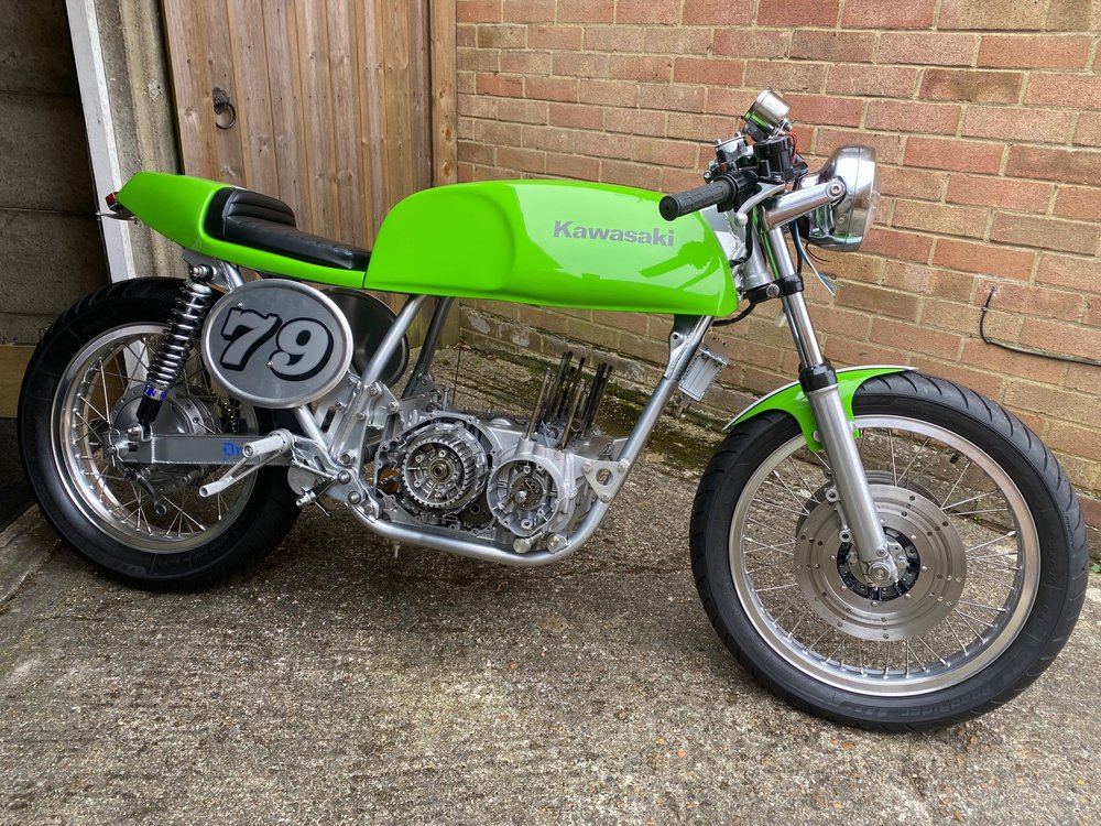

It's been ages since I've posted as progress has been very slow (like most of my projects :lol: )....Anyway, the eagle eyed amongst you may have noticed it's changed colour !
Unfortunately, the bike slipped off the stand when I was working on the rear brake linkage. I'd also had a problem with `bleed` on the previous blue paintset. Anyway, have bit the bullet and gone for the obligatory racing green.
Bottom end is all finished....next it'll be fitting the Wiseco pistons and concentrating on the top end build.

#42 PostAuthor: deka » Tue Sep 02, 2025 9:15 am
the blue was nice but you cannot beat kawa green
