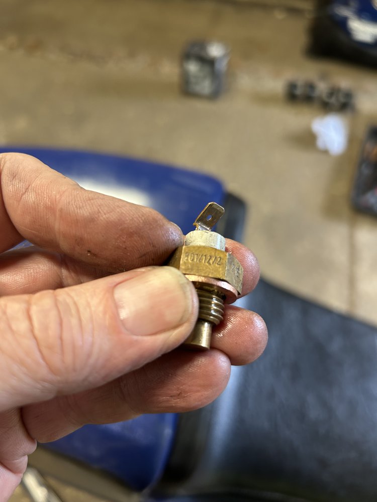

I took a run out with the aim to have a bit of speed fun on my local motorway only at the start of it the oil T was showing 130 already after a steady run then rapidly rose past the alarm and I saw 178DegC which was mad. I mean when does a Z1 lump go super oil T hot with normal riding eh ???
The Oil T Sensor is a VDO one from Motogadget and I couldn't find any other as on the VDO site the short one I have is superseded and it looked too long to fit. So I bit the bullet and forked out €54 for one that promptly got lost in the post !!
Meanwhile, as a precaution, 'cos I wanted to keep on the road; I changed the oil and refitted the Oil Cooler. Out for a run and the Oil T stayed below 100DegC.
New Oil sensor still lost in the post. In the meantime, eBay, was obviously stalking me and showed be an VDO Oil T Sender that I was looking for on the Classic Beetle shop at £14 !! so I grabbed one of those quickly for a next day delivery. It promptly arrived, as did the Motogadget one ! The Classic Beetle one also had the copper washer with it too.
There's a test procedure that I found and a graph of expected resistance so I whipped out the one fitted and tested them and found both new ones had an ambient temperature resistance 200 Ohm higher than the installed one 1100 vs 1300 Ohm which is about 20DegC, which would explain the over reading of the Oil T, maybe.

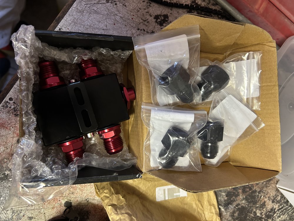

Oil Cooler install - I sort of fitted this temporarily and routed the hoses outside the frame on the fairing brackets and was intending to fit a thermostat at a later date (once it arrived from Alibaba - three weeks for a next day delivery or something). Anyway, I mentioned it on another message board and one interesting answer was 'why fit a thermostat?' So after a bit of a think I didn't fit it once it arrived, I passed it on to another Z owner who had seen Neil Conway's FB post about this particular unit.
Out for a blast and the max Oil T seen was 110DegC even with a bit of spirited riding to try and get the temperature up.

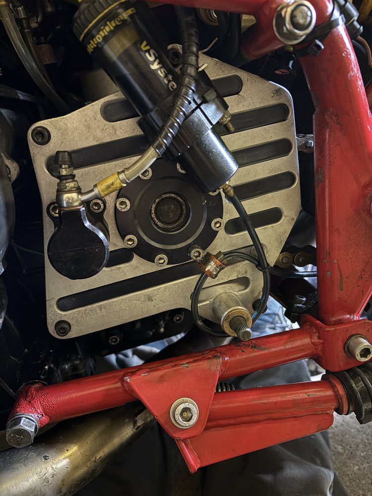

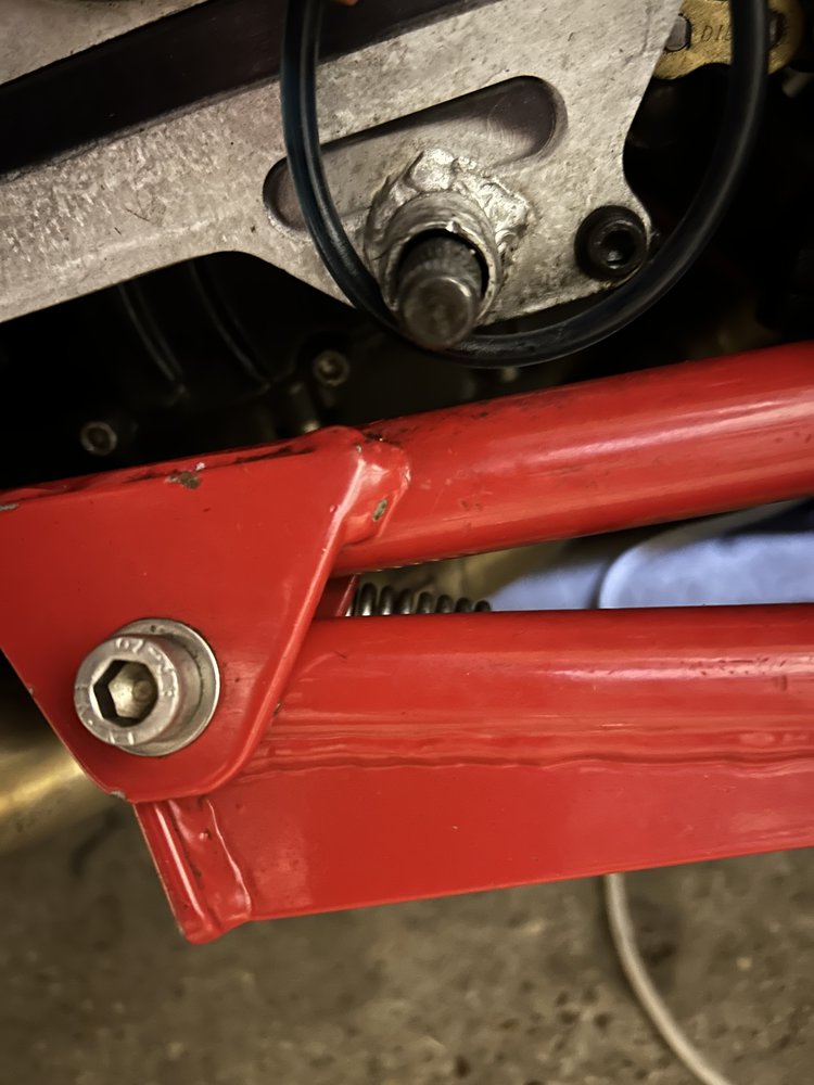

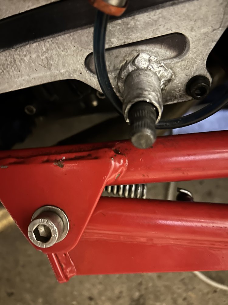

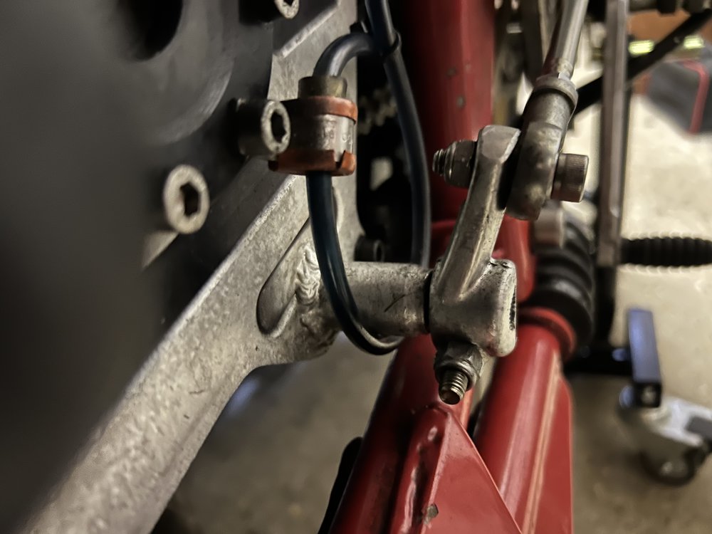

On my last ride out on Horace, I noticed the gear change was even sloppier than previously, even missing gears sloppy.

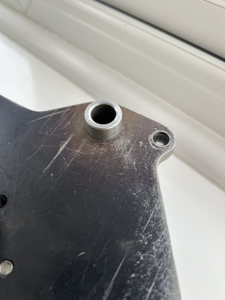

Checking out the mechanism showed me that about 1/4 of the movement was taken up with pushing the Gear Change Shaft forwards. The Boss on the outrigger plate had very badly worn.

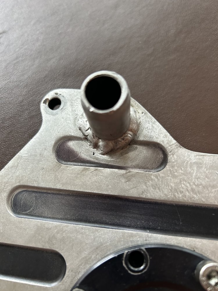

So I took the plate to Rob Meggitt and asked him to have a look and see what he could do.

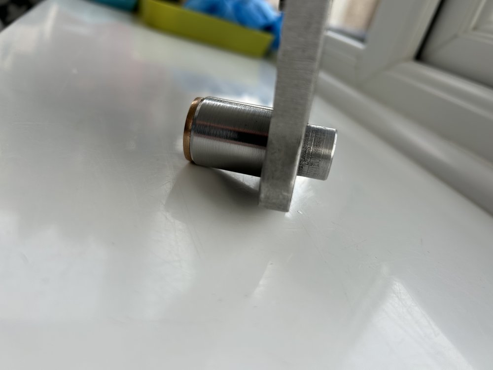

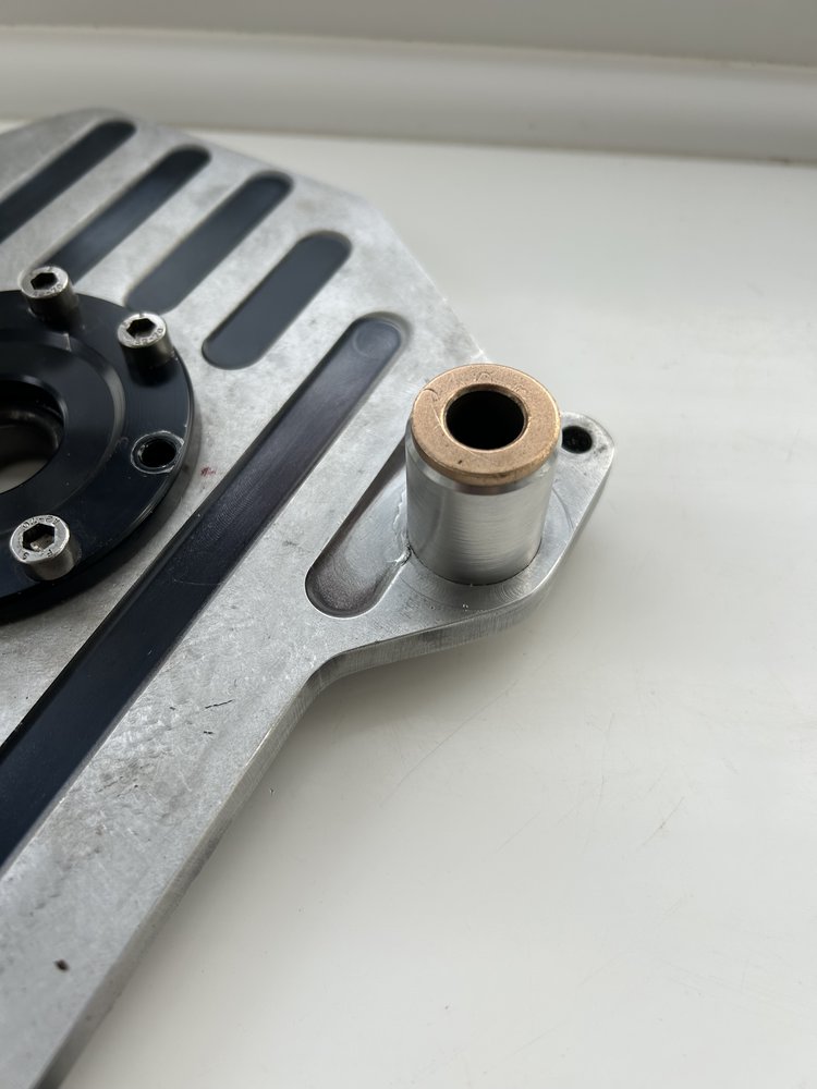

Rob came up with a very nicely machined solution and repair.
Here's the pictures of the worn out Boss:
And here is Rob's masterpiece:
So that's all sorted too :-)
