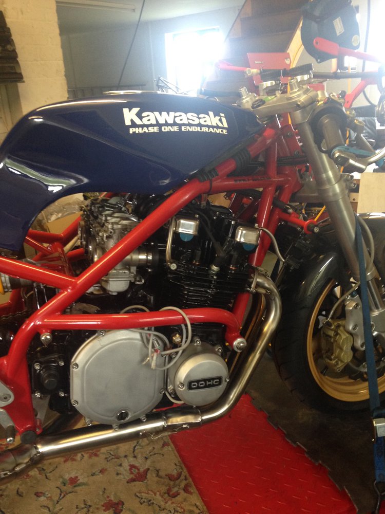

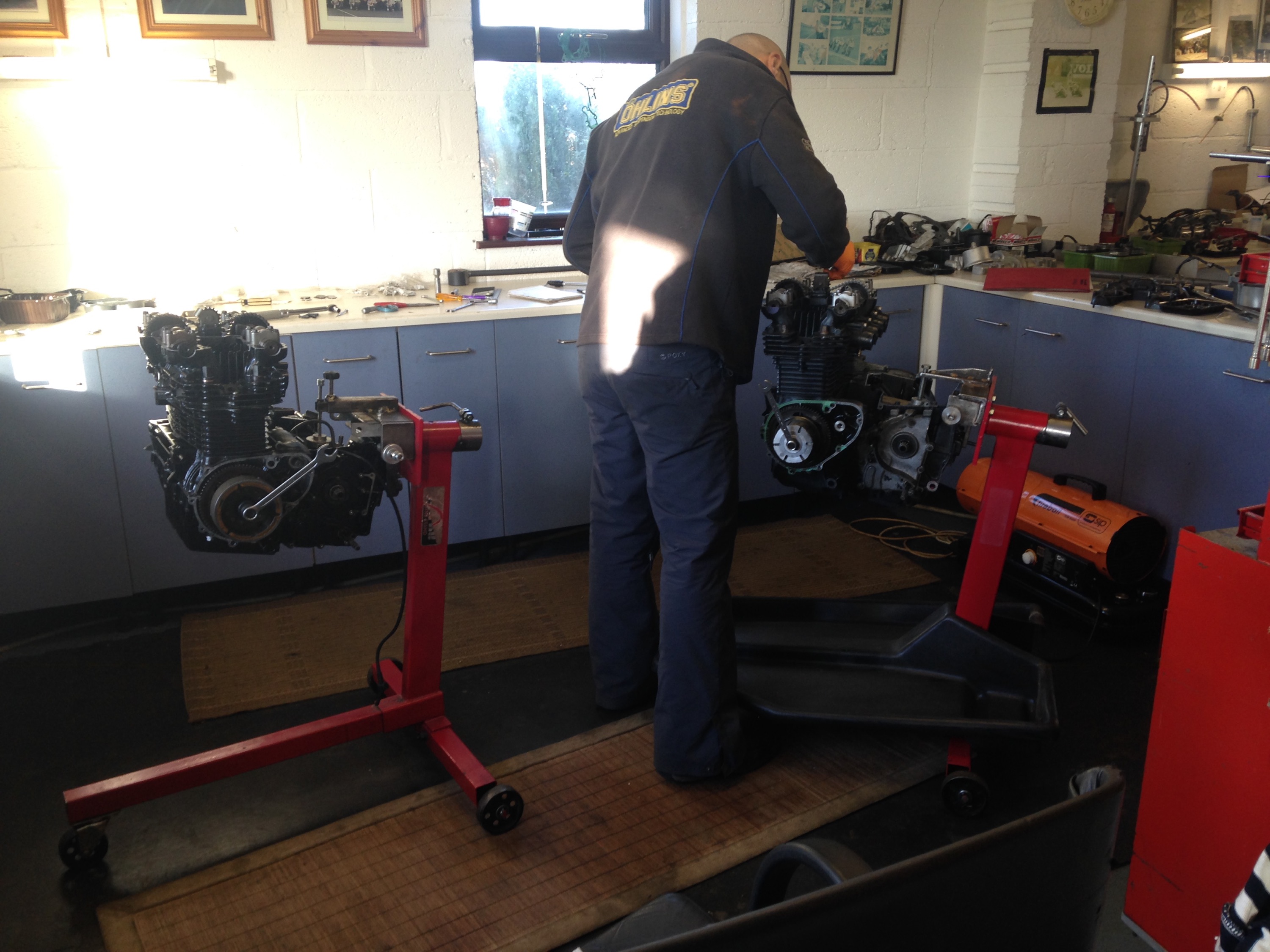

Knowing what a Harris is like, I knew I'd not be able to lift the head with the engine in the frame.

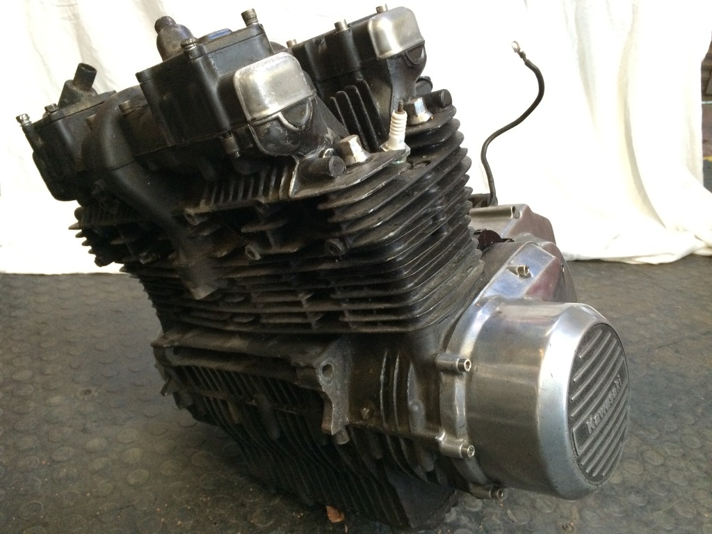

So a bit of research on the www and I found a suitable replacment engine - a Z1000G (USA Fuel injection).
Some measurements showed the Fuel Injected Head puts the Carbs too far back for the frame cross tubes so a MkII Head was bought to suit.

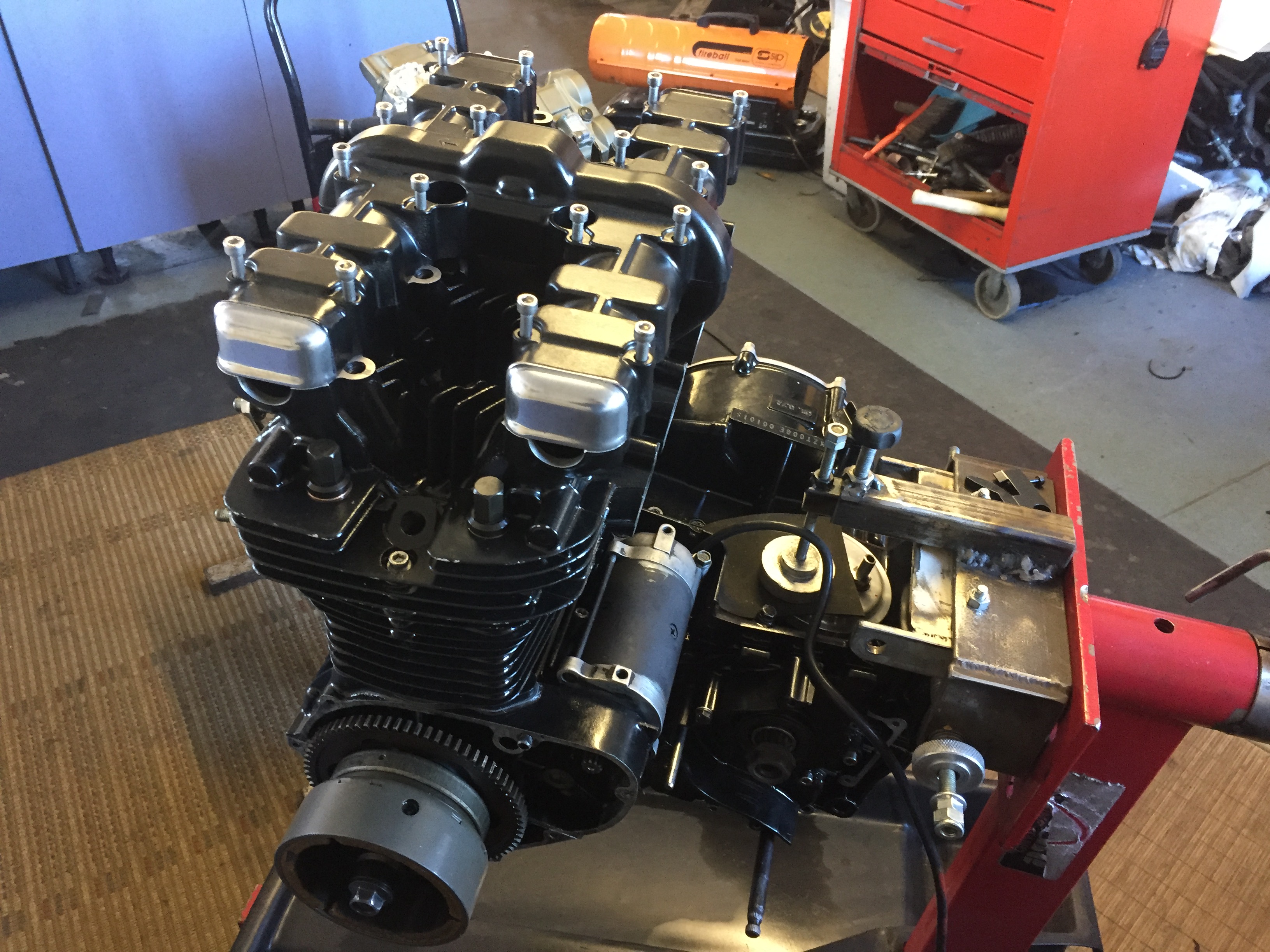

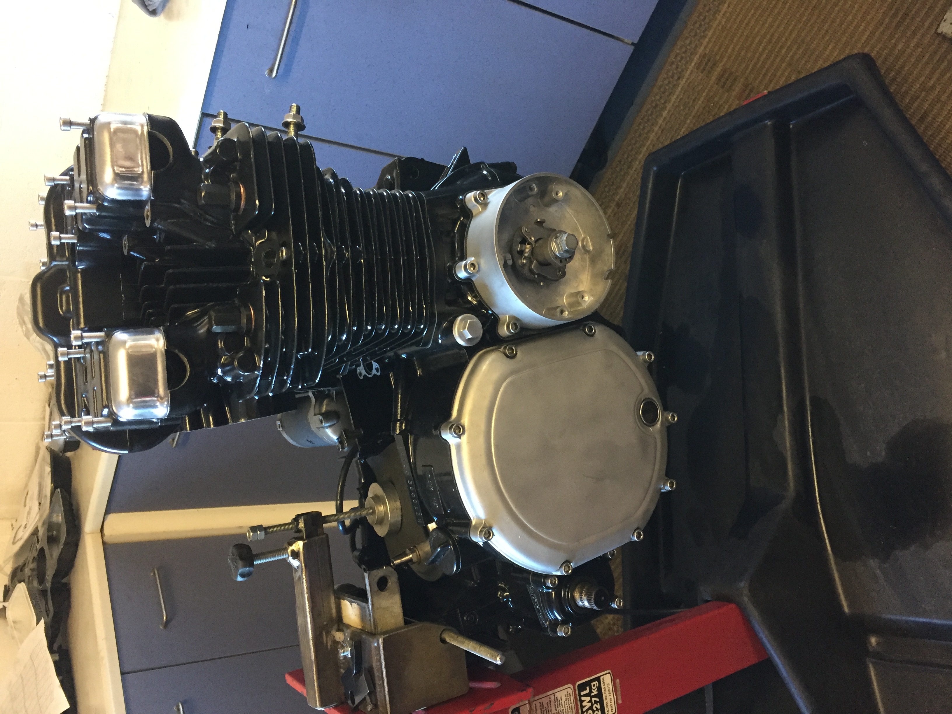

New Engine stripped completly and rebuilt with a 1075CC bore and Wiseco Pistons plus all new original or better parts

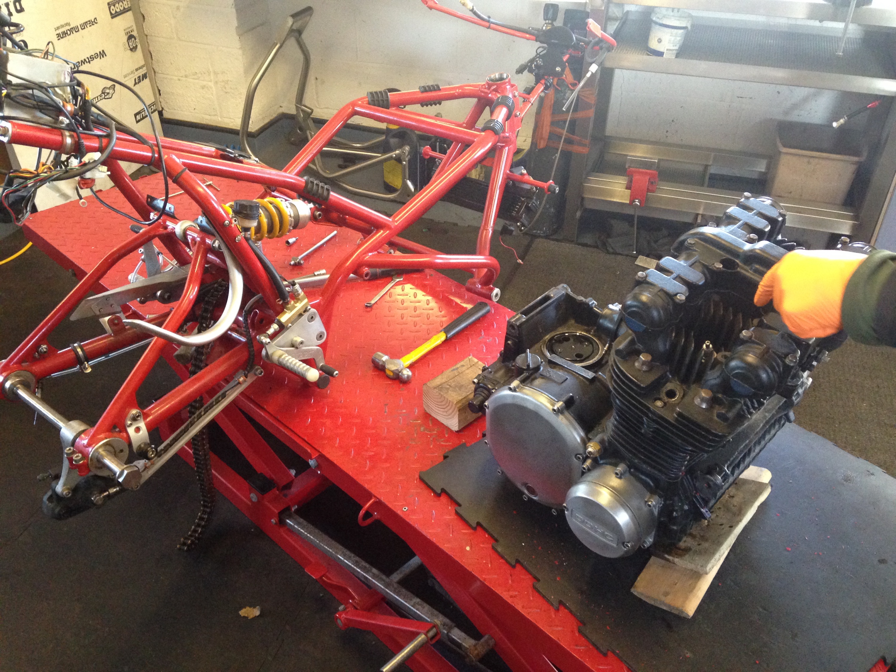

Anyway Engine out:
then a bit of swapping over of the nessassary:
Anyway Engine out:

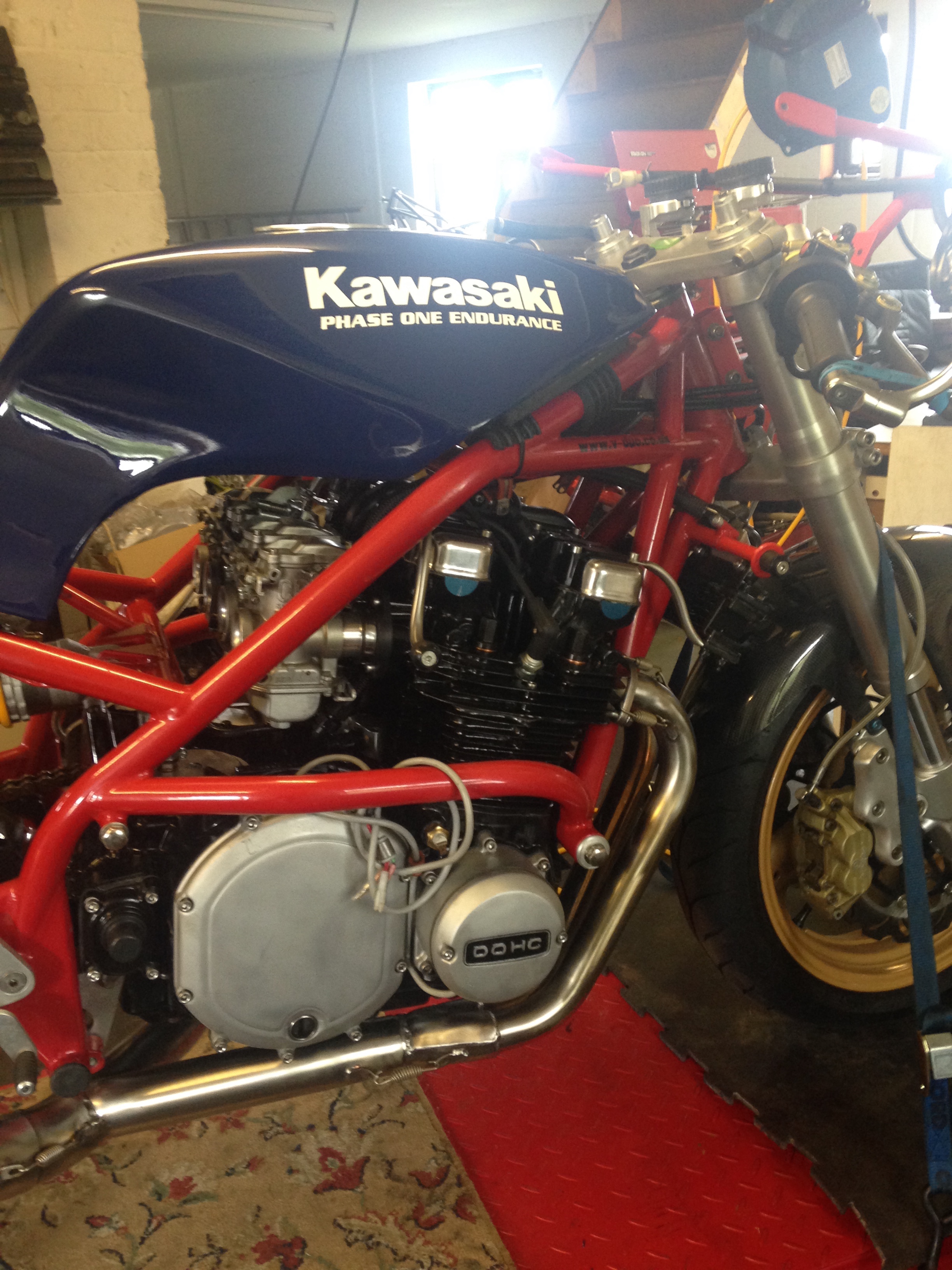

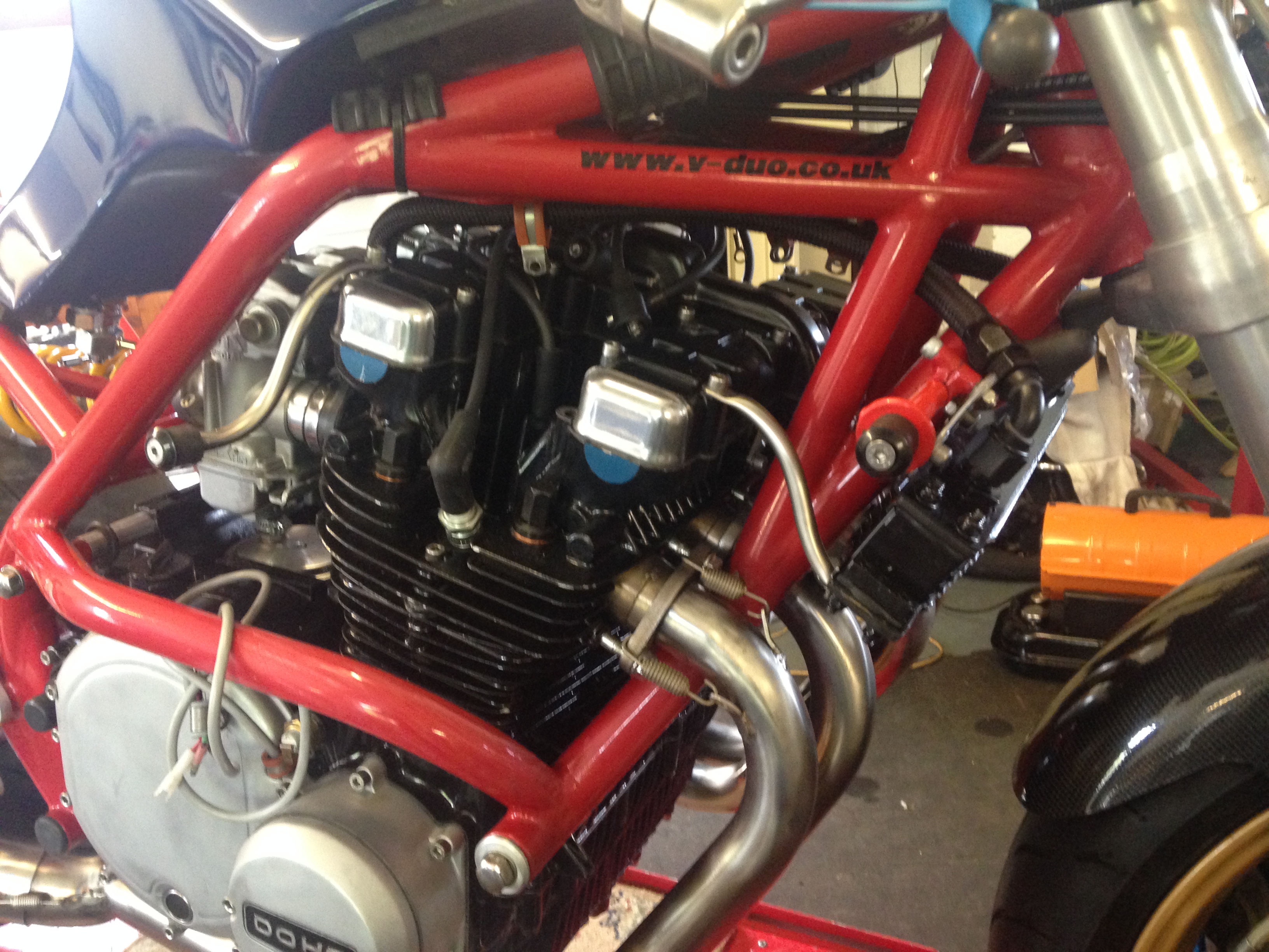

New Engine in:

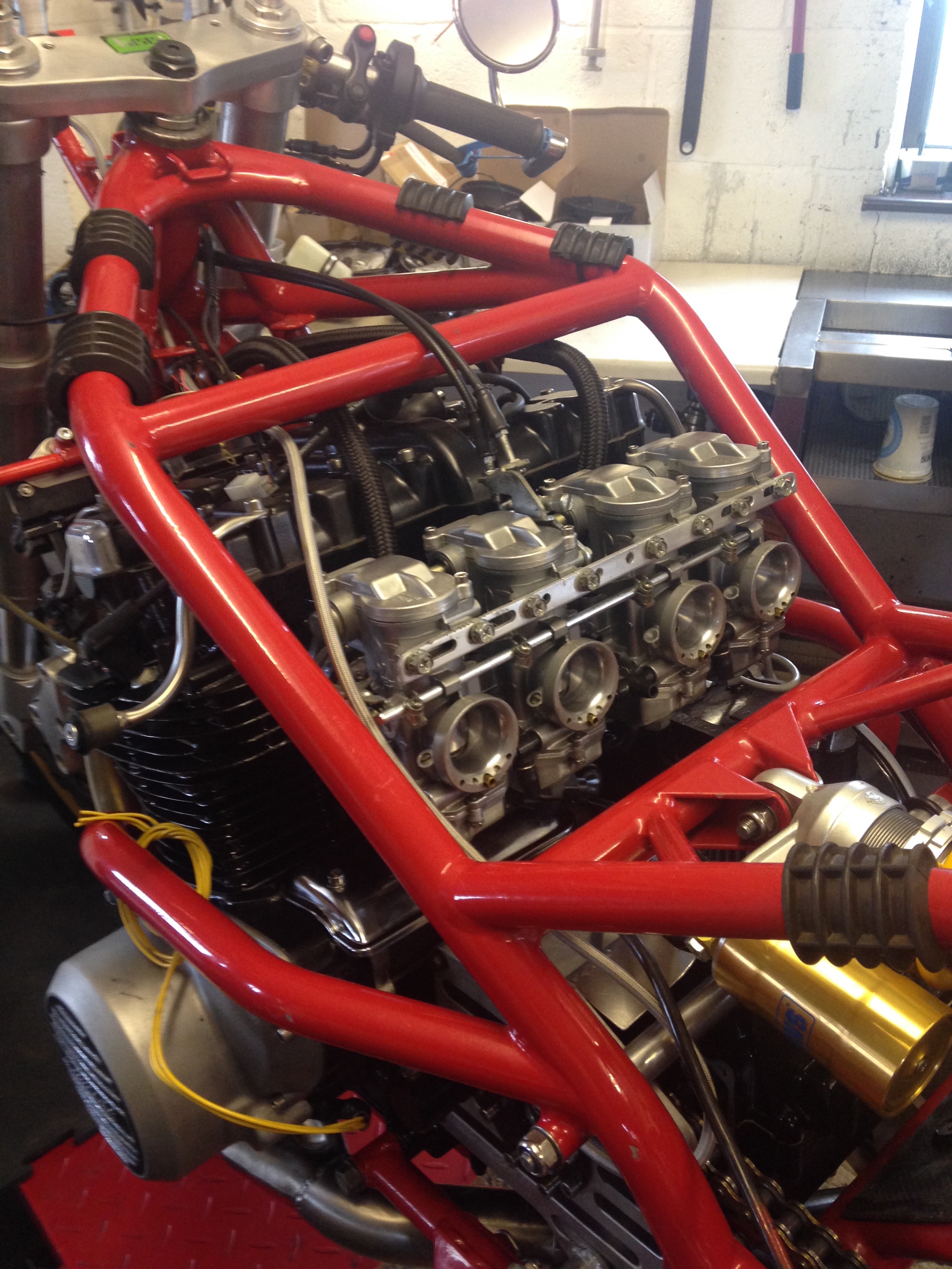

And new carbs to suit the larger engine capacity - CR31 ultrasonically cleaned and overhauled.

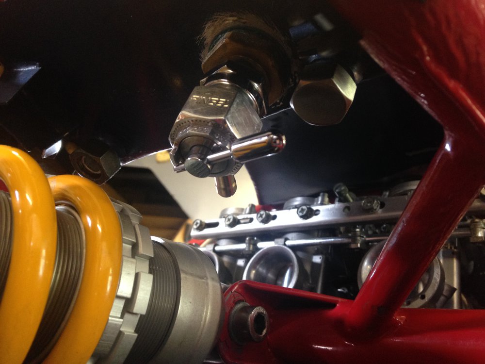

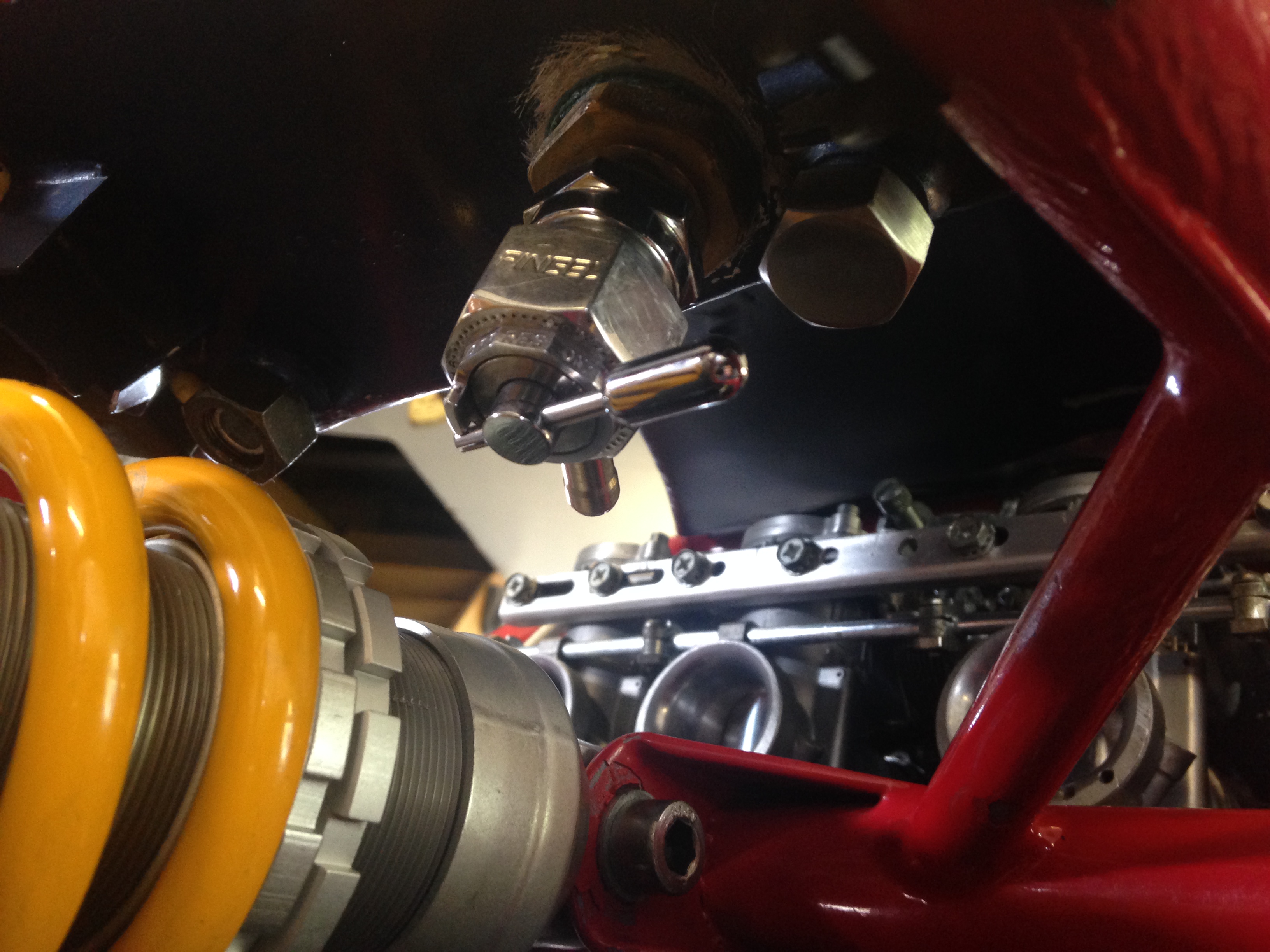

While it was being worked on there was the oppertunity for some other fixes - Pingle fuel tap which required cutting the Tank Base;
Low Profile Oil / Air Seperator and a cheeky little filter:
just waiting for some Jets to arrive that are closer to what is needed then on the road for some running in then off to a Dyno - still TBN !! for propper setting up.

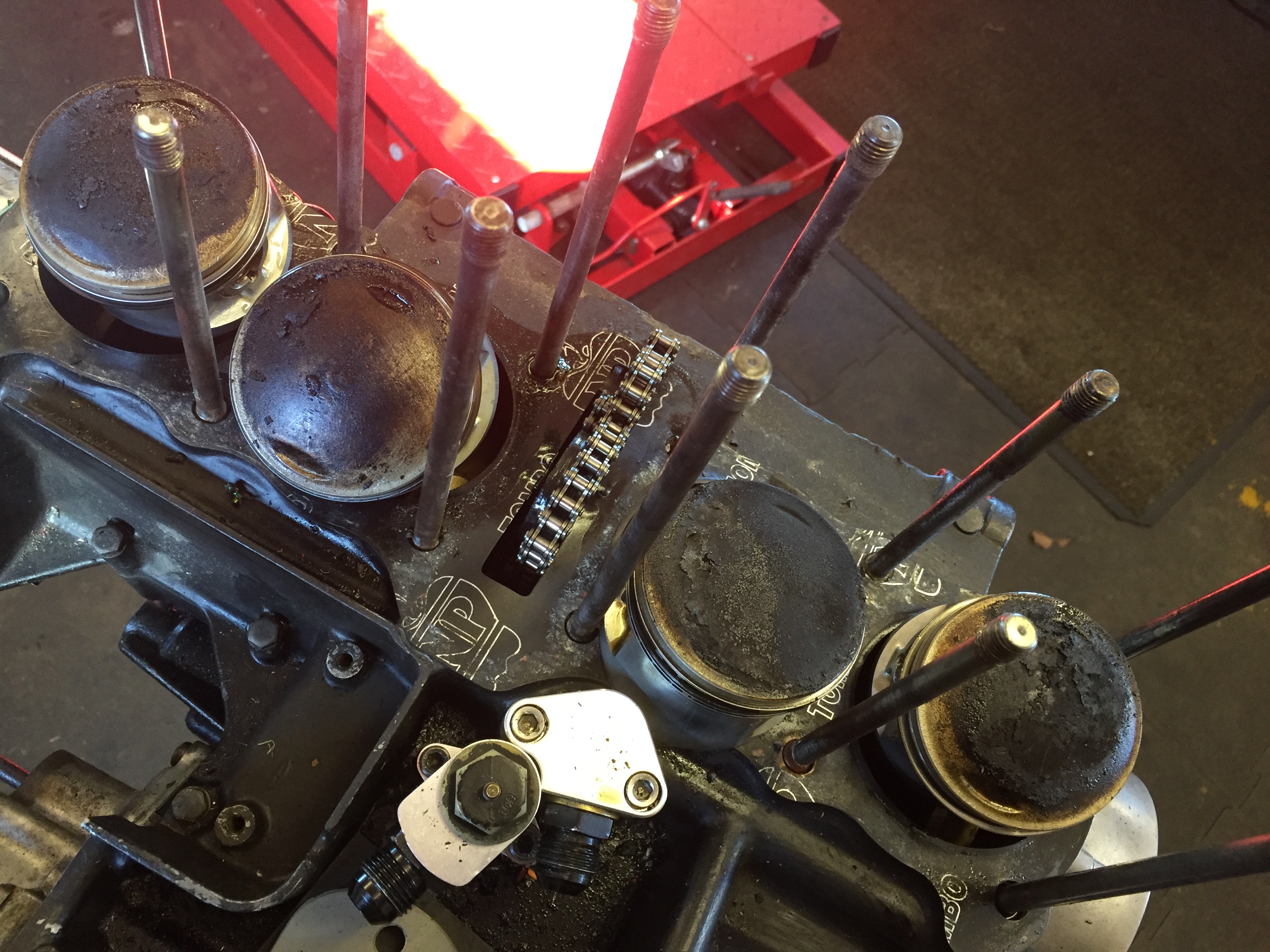

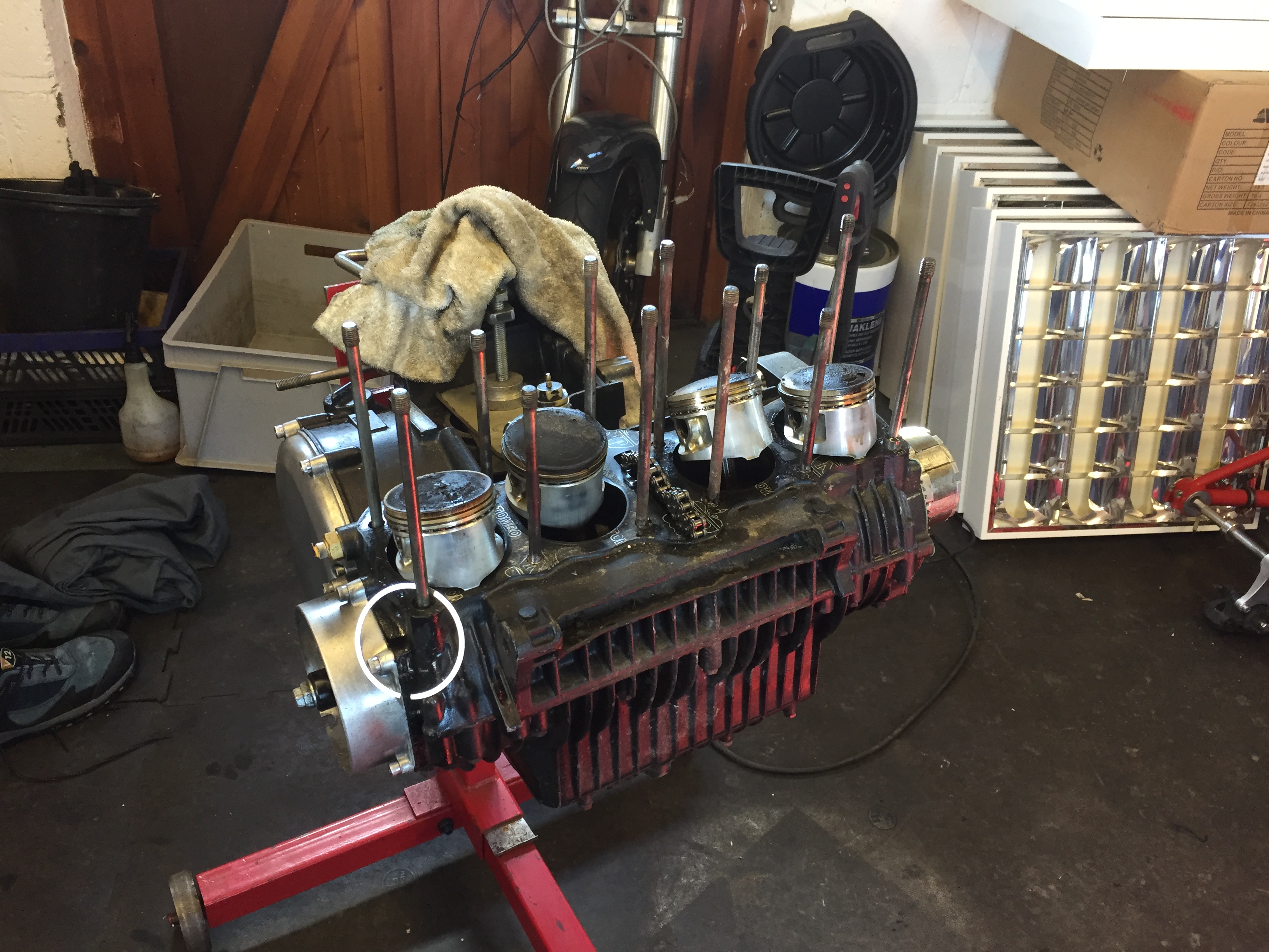

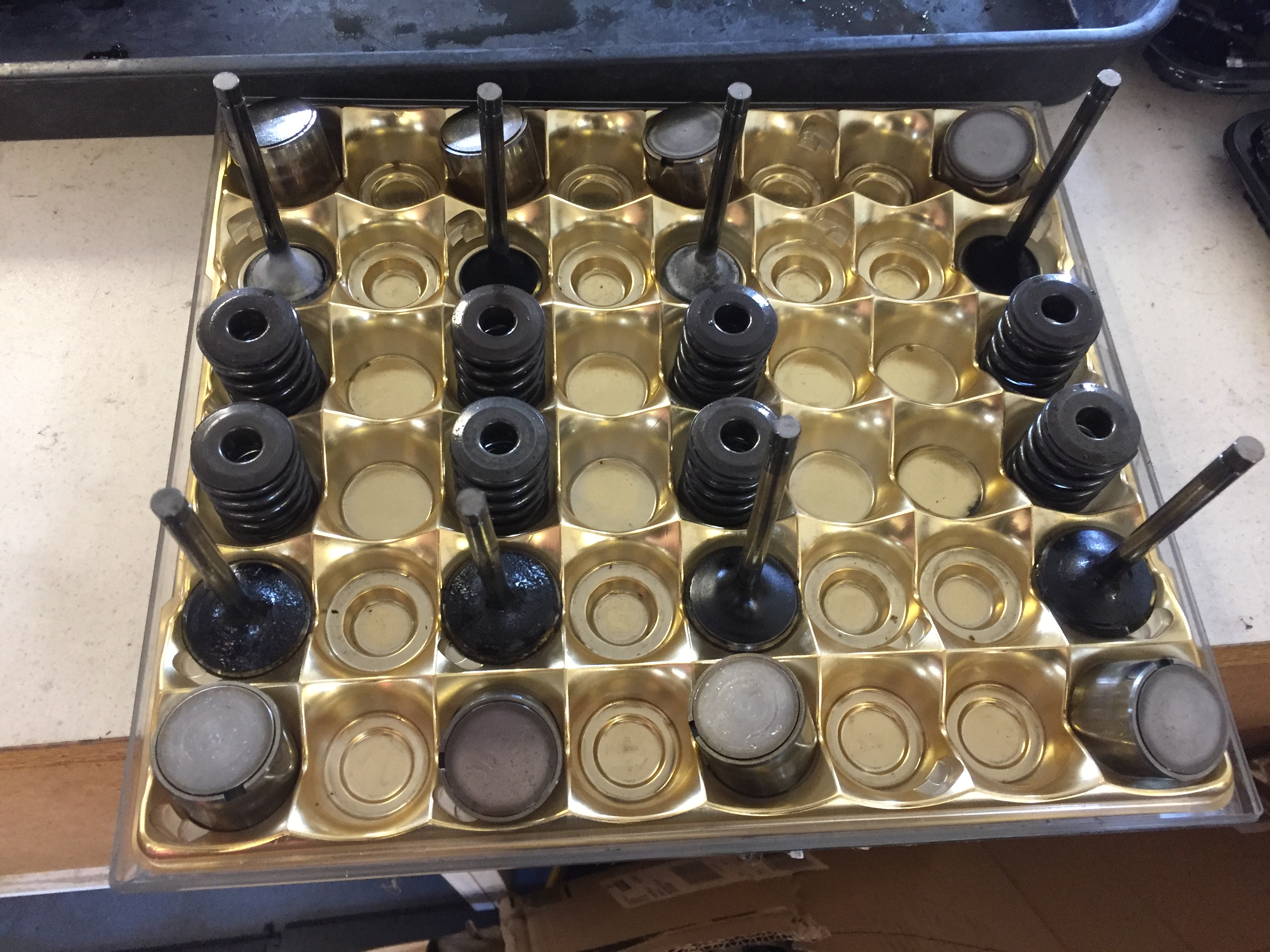

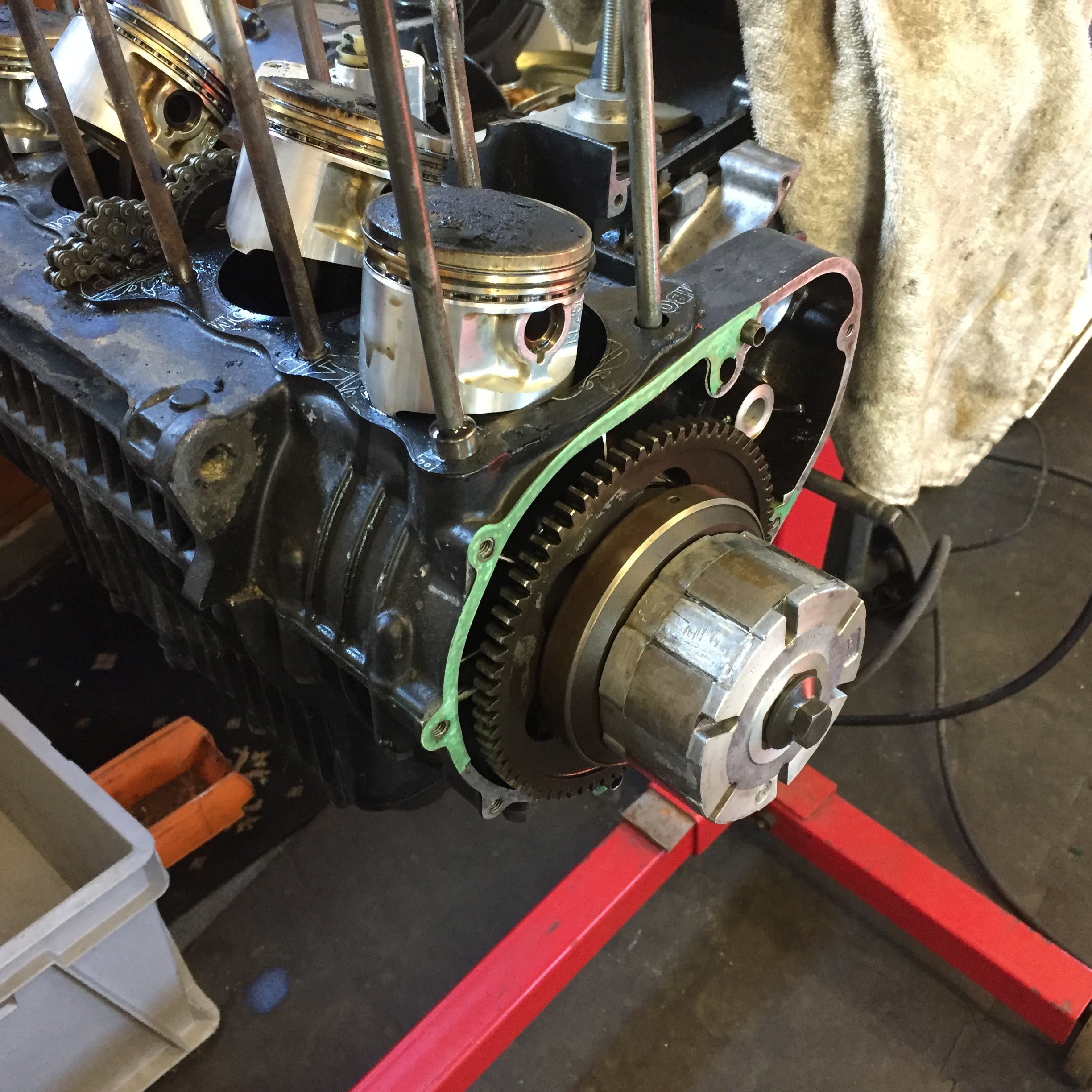

Old Engine strip down:
All the Valve Guides and Valve Stems were worn beyond the limits and the VG Oil seals were hardened. So that is the cause of the oil consumption.
The Block has been bored out to the first oversize and all Valves & Guides will be replaced - already bought along with a first oversize piston kit.

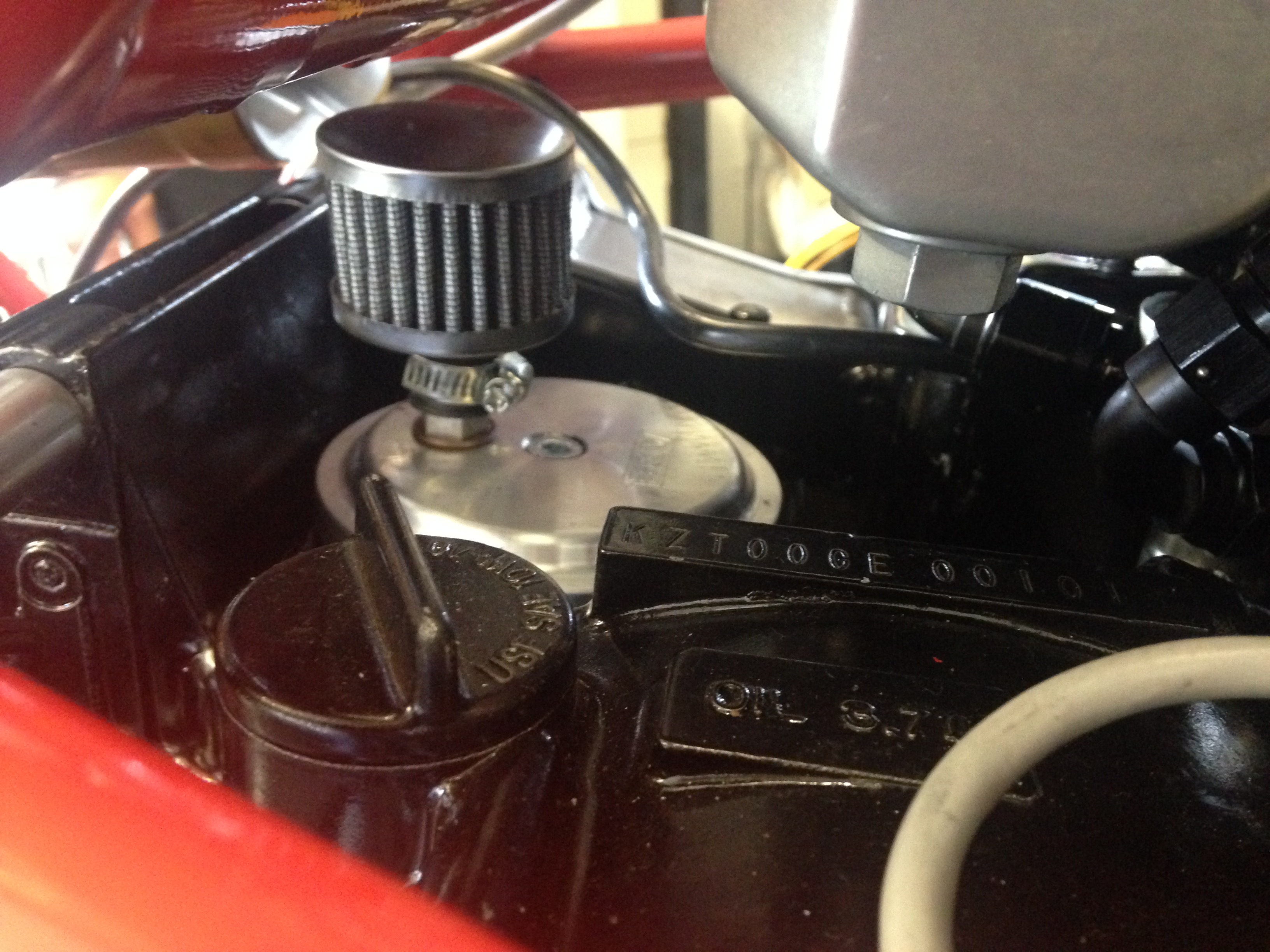

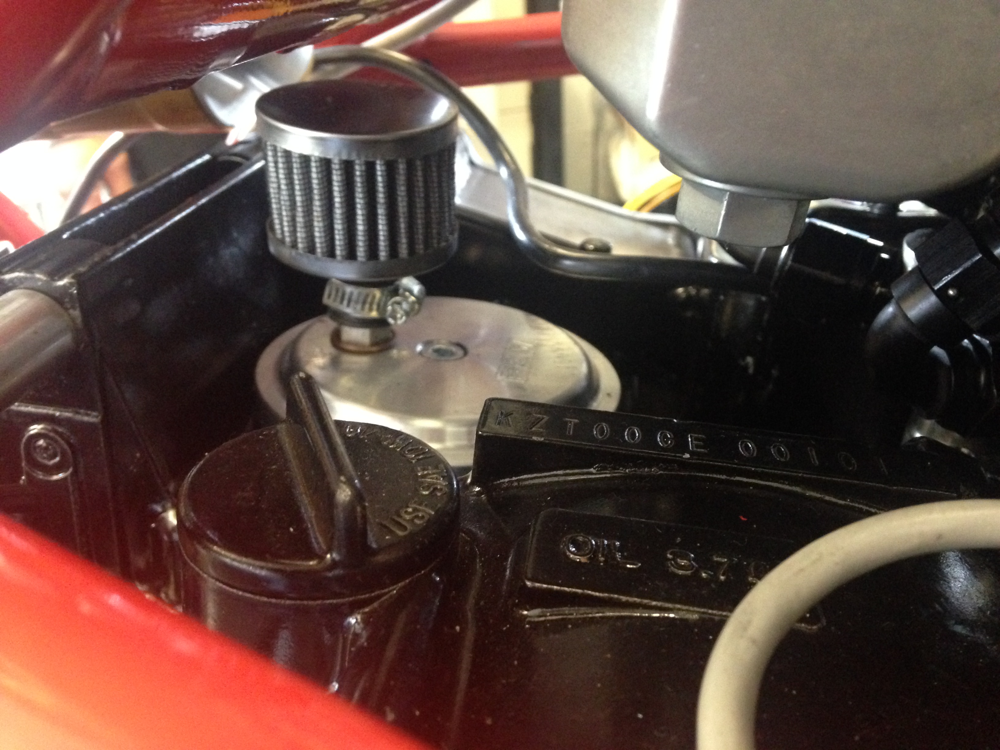

So an update - Out on Horace in June 2017 and after about five miles things get a bit slippy in the Foot peg department. so pulling over to a handy lay-by finds oil is oozing through the new "K&N" type oil breather when I blip the Throttle.
So a quick wipe down and back to HQ for a change of Breather.

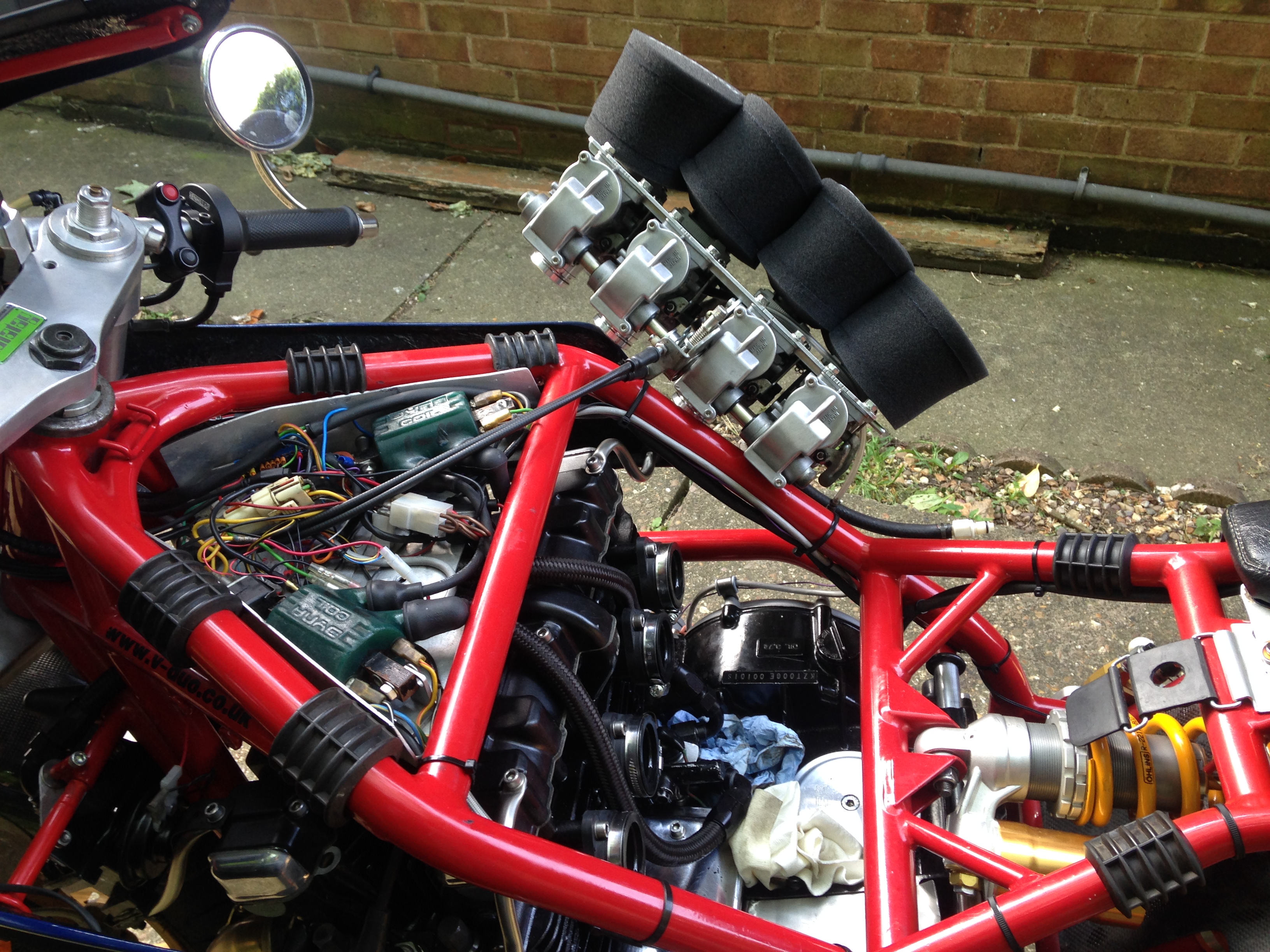

Luckily there's the Endurance mentality to allowing quick carb removal:
A cuppa-tea and a clean up, big long silicone breather pipe reinstalled, then out again to see how far we can get.

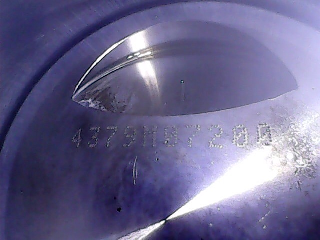

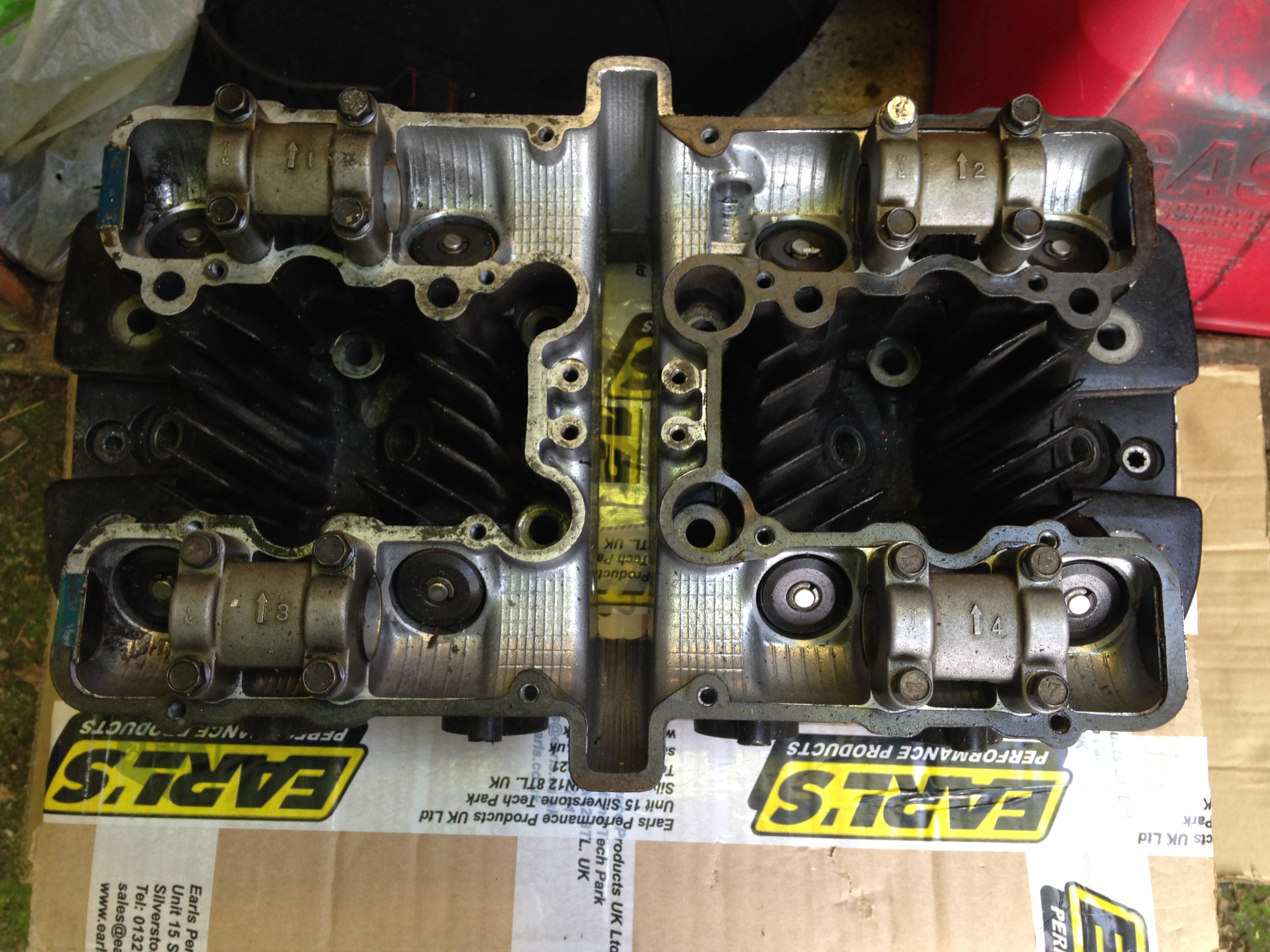

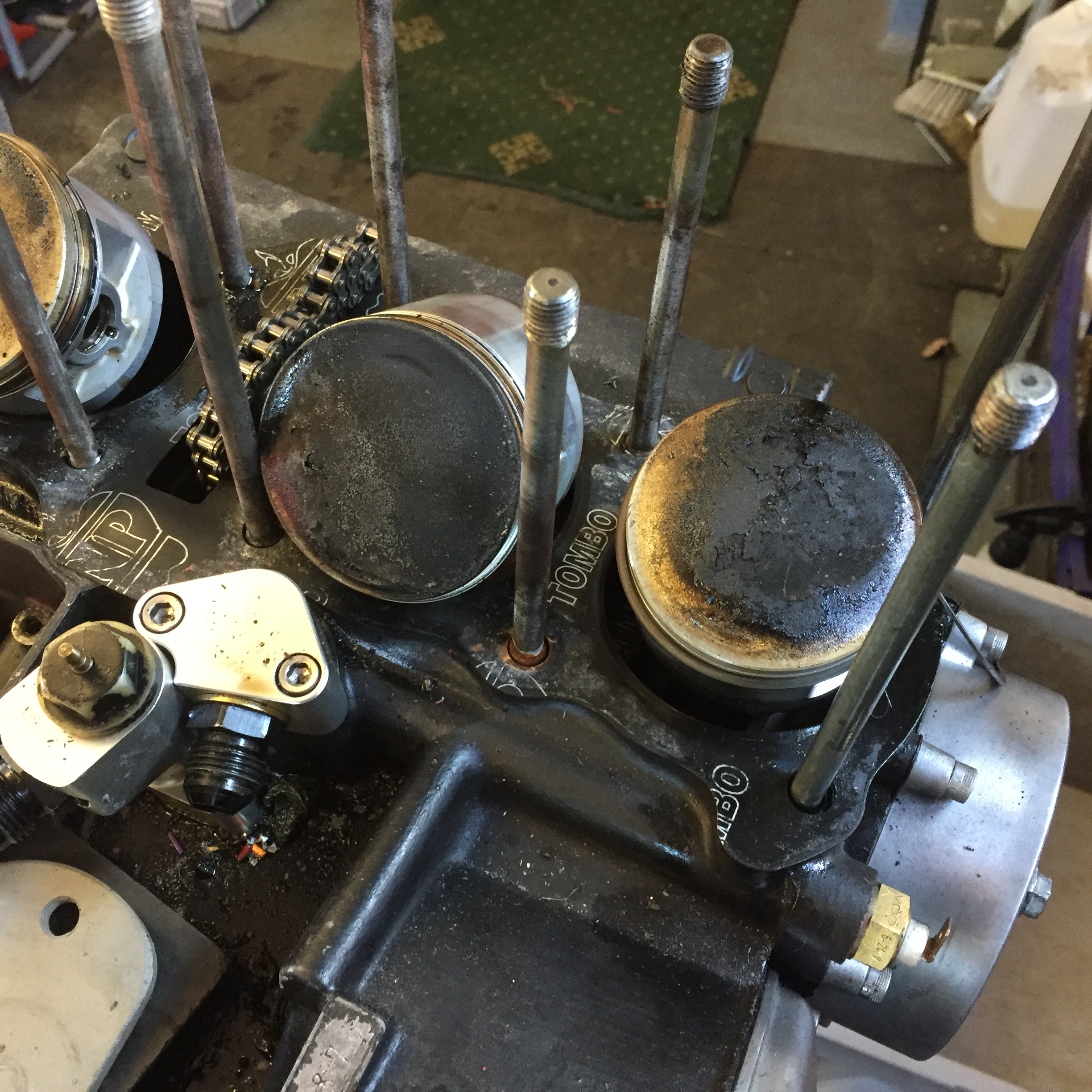

Very carefully return to the HQ for some investigations - when started and running there is air blowing from the #1 Carb starting port making it a bit suspicious of the inlet valve passing.
eBay is a wonderful thing and a £20 endoscope attachment for an iPad delivered a few days later shows that the inlet valve has been bouncing off the top of the piston:
The head is lifted and #1 inlet Valve is indeed bent. The Head is a bit special and has had a bit of porting work and stainless valves fitted. No idea where I'd get a single Stainless Valve from so after a measuring to ensure they were standard, a full set of Valves and Springs on the way from Z-Power which is where we are today.
Not sure why a valve would bend after about 18 miles (total) of running - any ideas ????

If it's just the one valve and everything else, timing, springs etc check out ok then you need to check the guide clearance.
If that one is slightly on the tight side it will nip the stem when hot and the valve won't return under spring pressure once it's been opened by the cam and the piston will hit it.
A light hone of the guide should sort it out and if the valve is stainless it could have been straightened if the bend wasn't too severe.

Thanks for the info. I didn't want to risk another episode later on in life so thought returning to standard metal valves would be a better way forward.

Shouldn't have a problem with stainless valves ,they are superior to the stock items and are one piece not two.
Which valves have you bought.
Some of those cheap £90 a set pattern valves have issues where the stem is too long with the collet groove slightly higher up the stem leading to problems with stem height and valve clearances that can only be cured by trimming of the stem, collets and retainers.
Have had to sort a few heads that have had no clearance once they have been fitted.
If you must change the valves then i'd just do the inlets, check the installed heights first and hone the offending guide if you can find no other cause otherwise you may have the same thing happen again.
